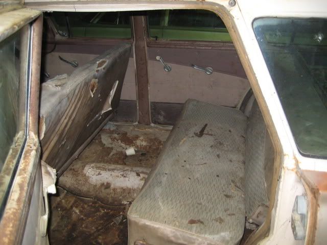

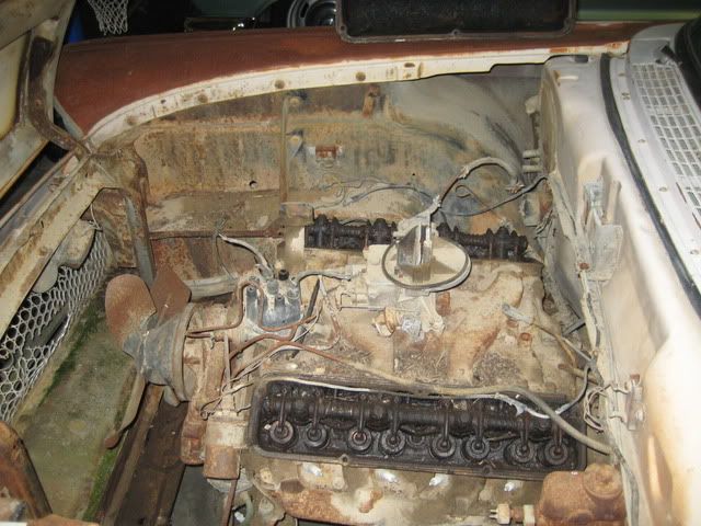

    I’ve had this idea for a while that I’d like to build a car with a group of kids. I bought the car in September 2008 with the intention of building it as a church youth group project. That didn’t take off but I and a couple other guys started picking away at the project over the course of the next year. The first set of pictures represents that progress.
    In the summer of 2009 I pitched my idea to the Seattle Lutheran High School principal and got a class formed. The students will earn elective credits for participating in the build for the full nine months of the school year. In June of 2010, we will drive the car to a couple of local car shows and then sell it.
    I should clarify that we have no intention of actually “restoring” this car in the traditional sense. We’re going to fix it up so we can drive it safely and comfortably.

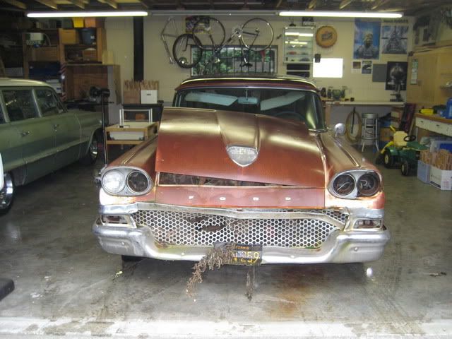

    This is what the car looked like when we bought it:
    It’s a California car (still had the black plates on it) so there’s not much rust beyond the surface rust.

  2. olivepick
    olivepick New Member
    Sep 17, 2009
    121
    Seattle
    Initial cleanup
    Here’s some shots after an afternoon of cleanup:

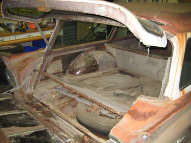

    The early days of theproject
    In the time before the class started we worked on getting the thing cleaned up.
    - Wire brush and paint the floor
    - Remove the old engine/trans
    - Remove bent trim
    - Started removing the surface rust
    - Rebuilt the brakes
    So here’s what it looked like when the class started:
