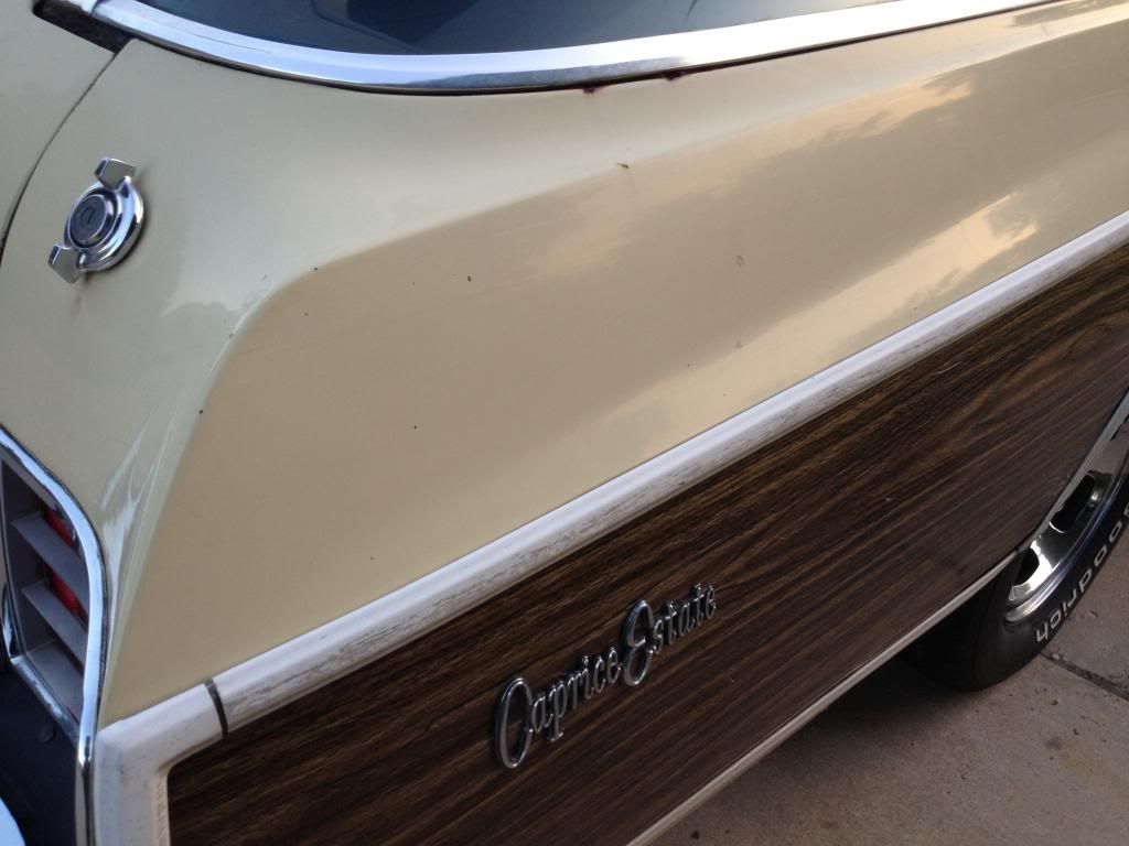

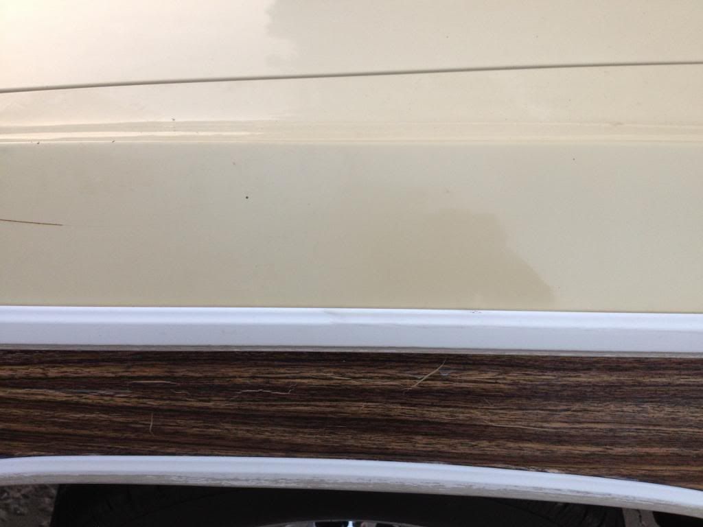

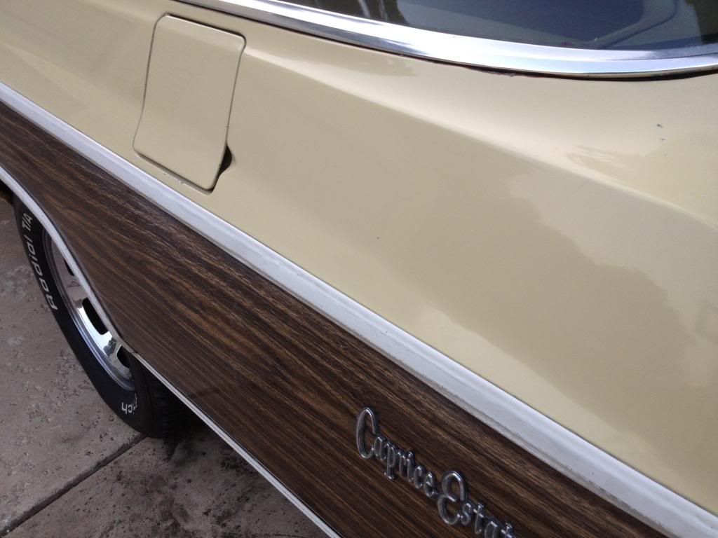

    I did buff one rear quarter on the wagon, and one fender. I took some pictures of it with the new wheels and to try and show the difference in the paint. Hard to tell in the pictures but it really comes to life with a quick buff with rubbing compound. First picture is of the left quarter after I buffed it, 2nd picture is to show how dull it was on the right rear quarter. Third is the front fender, you can see exactly where it was buffed and then stopped. And last is the new wheels
