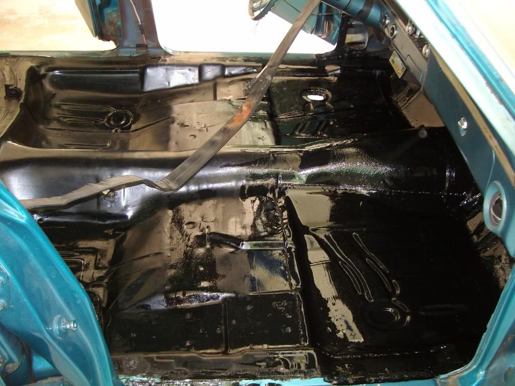

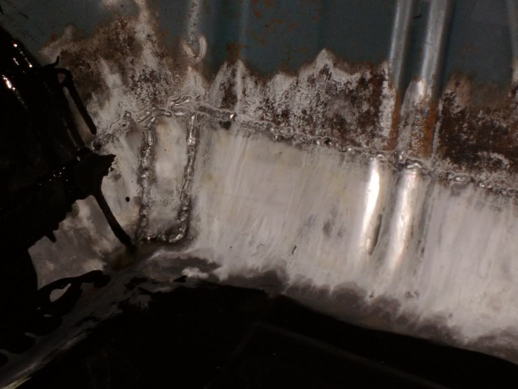

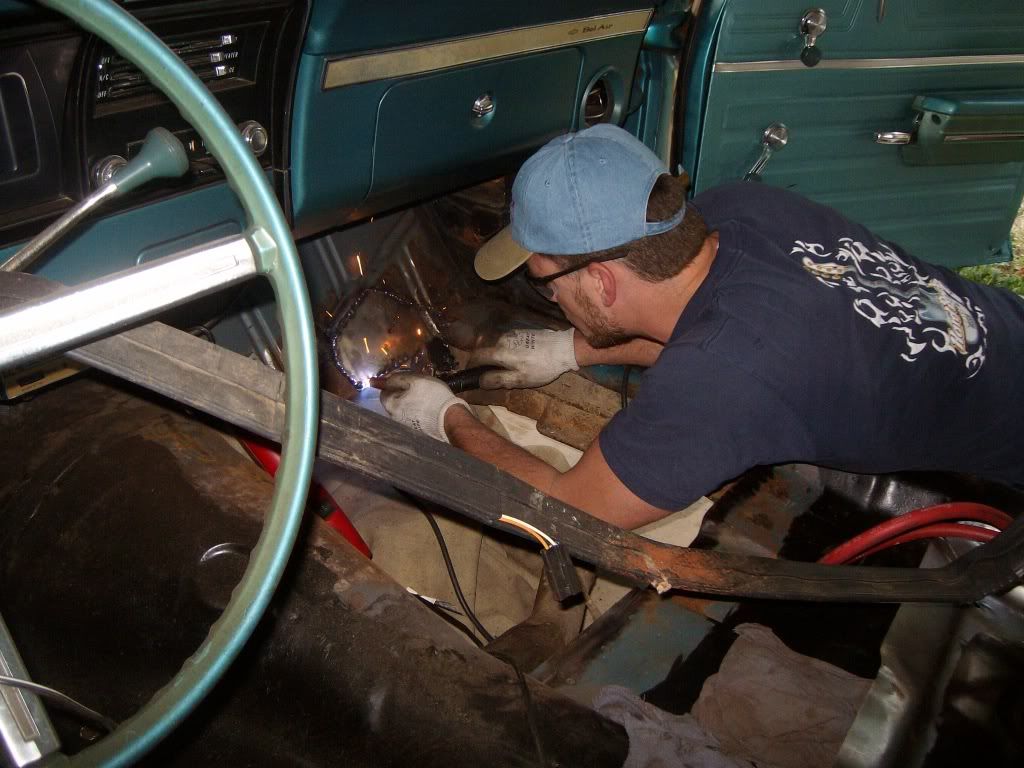

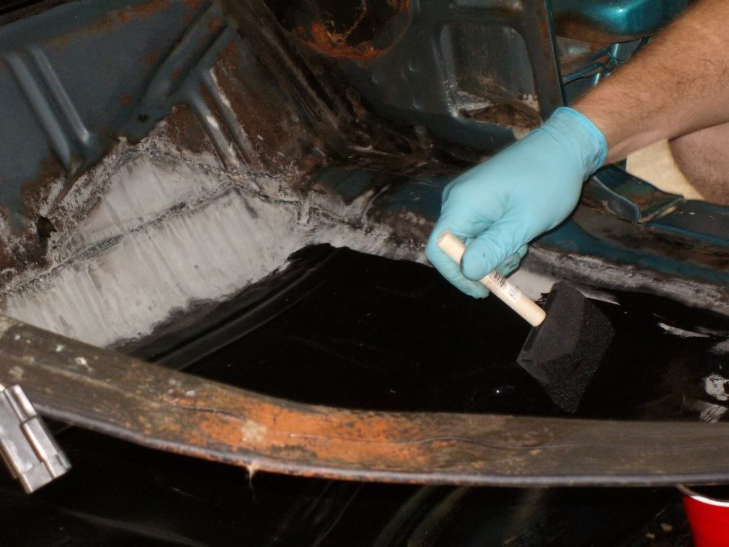

    Hey guys,

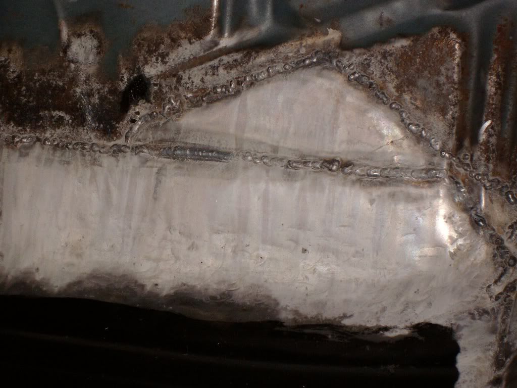

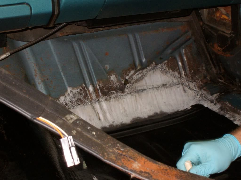

    Got the passenger floor pan cut out and cleaned up.
    Made a patch for the toe board area and got the pan tacked in.
    I'm hoping to have the pan fully welded tonight and everything POR'd and sealed by the end of the of the weekend.

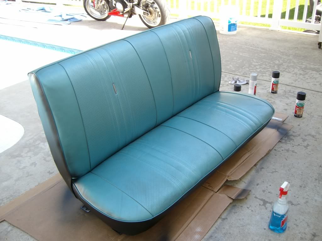

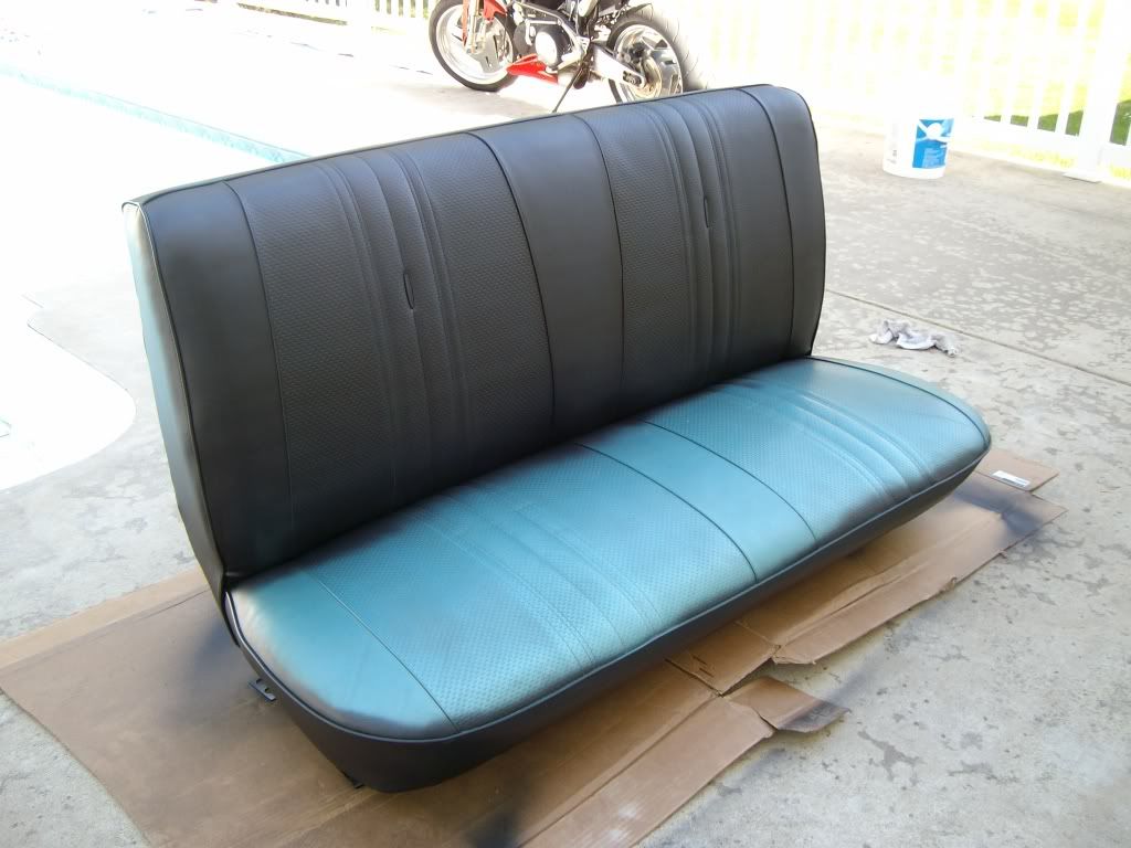

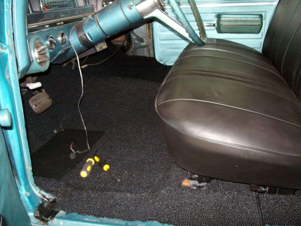

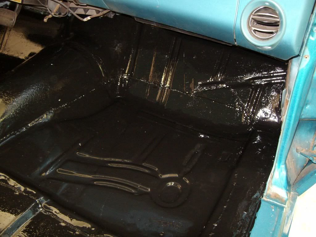

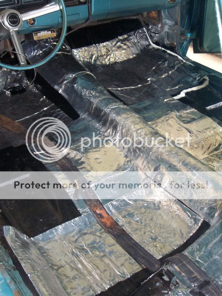

    Got the floor pan fully welded, etched, POR'd today. Still need to seal the seams and then POR'd over the sealer again. I hate POR. What a mess it can be.
    Also go the seats vinyl painted. Wasn't on my list of things to do but managed to get most of it done. Ran out of vinyl paint and Autozone wont have any until tomorrow. I was amazed at how quick the stuff worked and how nice it looks.

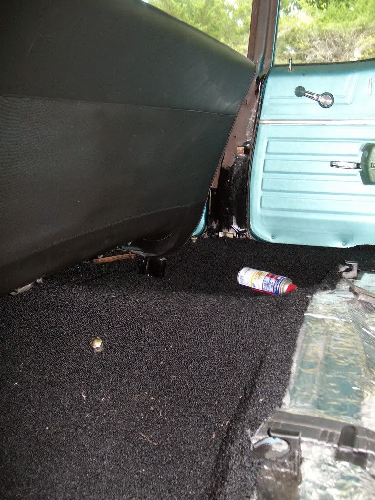

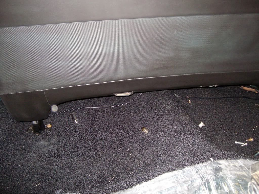

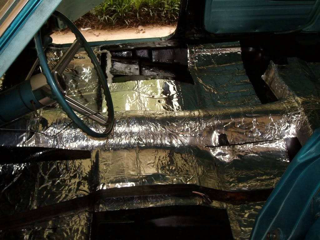

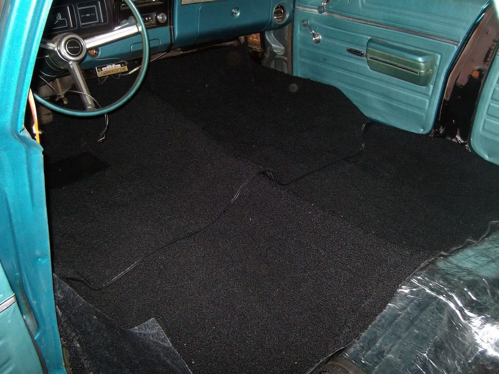

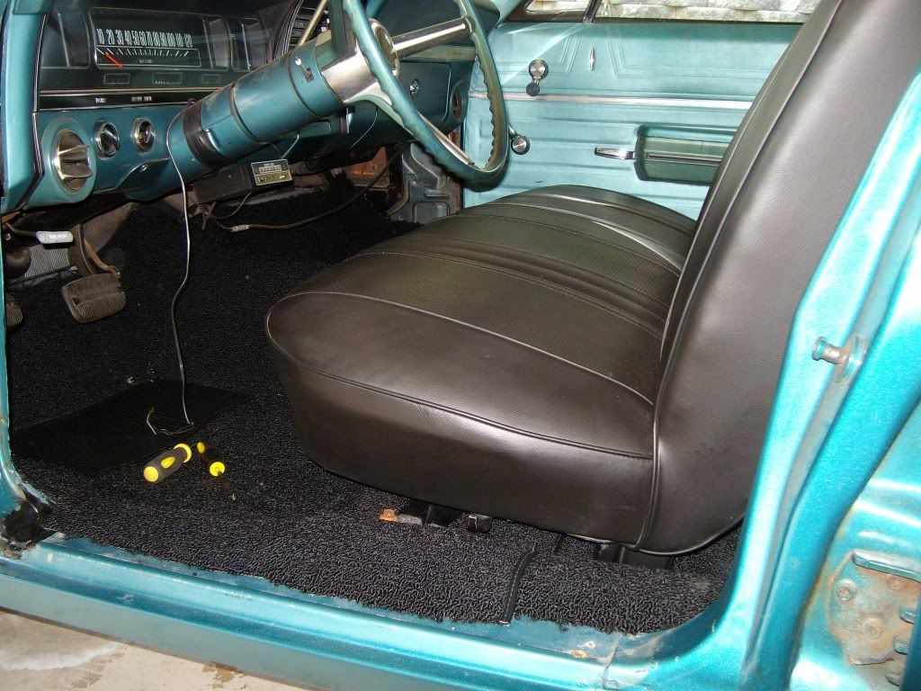

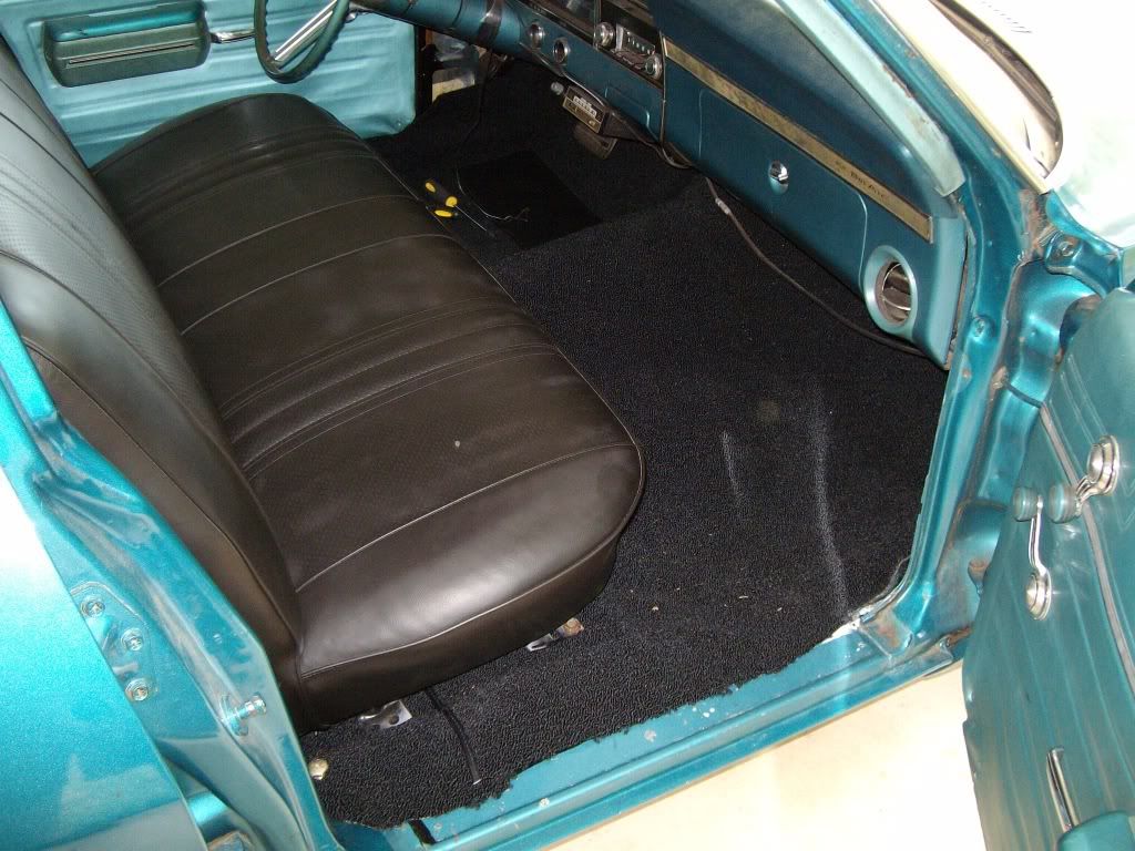

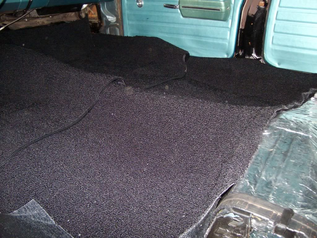

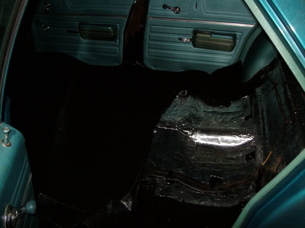

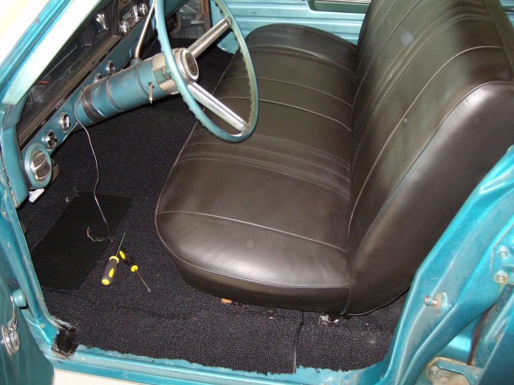

    Got the interior mat down and carpet. Trimmed and glued the carpet and got the seat in this afternoon. The seat is actually more gray than picture lends you to believe.

    That's wicked, Wicked! A lot done in a short time. Nice work.(y)
    Funny about digital pictures online. I wonder why they still can't do colours properly. Apple and Microsoft have been generating colour standards since at least 1988, and its still screwy. :idea:

    Well they looked a little brown on the camera and my computer as well.
    I was using the flash. I think without the flash they'd be fine.
