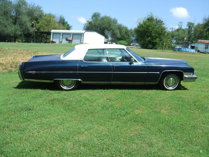

    This ^^^^ Caddy for the wagon?
    If it as at least equal mechanically take the Caddy and run, err drive.

    Ross, the guy had already sold the Caddy, so thats out.
