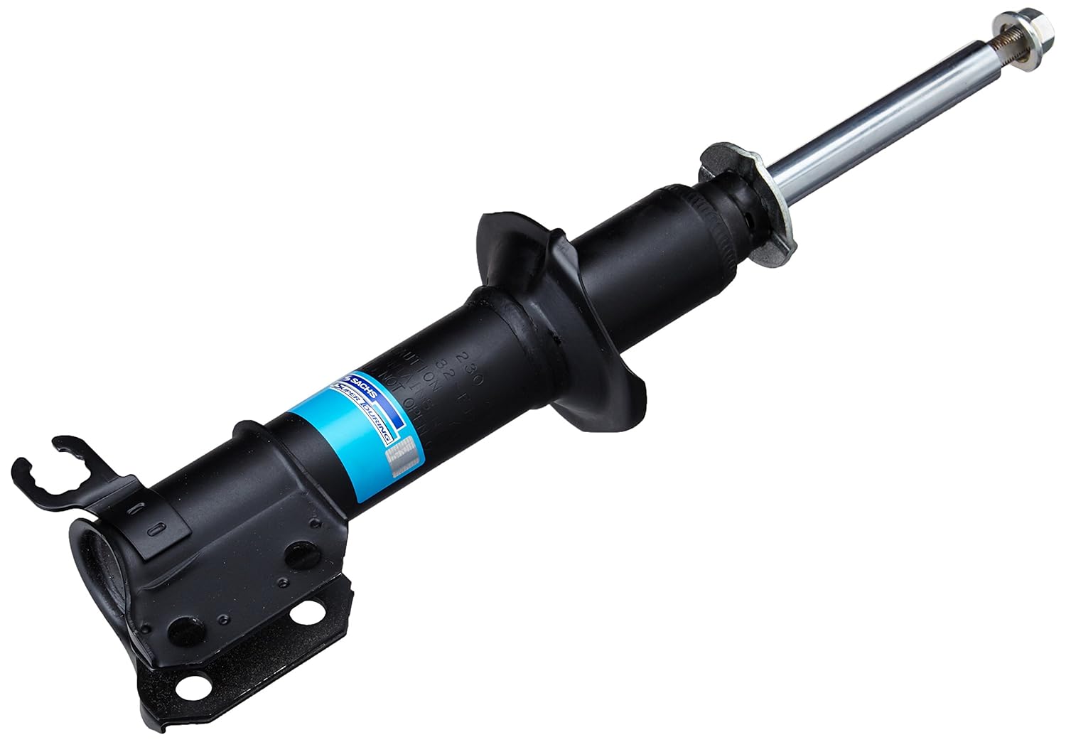

    The local parts store can get me brake discs. But, at 66€ each, i might as well order everything from one place. Therefore, saving through the free shipment for ordering parts totalling over 100€. For 66€ on-line, I can get one of the best discs. TRWs, Brembos, ATEs and another German one are available for less than the parts store will sell me them for. Problem is, I don't know this one outlet which has everything except the stabilizer bar bushings. Some of these outfits are fakes. I guess, I could try ordering a couple of the less expensive parts and see if they arrive. Here's one of the tempting sites. I could choose between strictly oil Monroes or go for the gas-filled Bilsteins. Performance isn't as important to me as is comfort. Longevity is also a playing factor. Methinks, the gas-filled are likely to leak much sooner than the strictly oil-filled. What do yous think?:

    I think you're right on the Monroes. Bilsteins are a great shock, but overkill for a basic people mover that you don't plan autocrossing with.
  9. Poison_Ivy
    I've read good and bad about Monroes, in this forum. MAK recently mentioned them getting pushed by a Ford dealer, instead of the house brand. If they're Made in Chinas, I don't want anything to do with them.
    I tested mine, today and they don't rebound more than once. So, I think that the inspector condemned the one for having a rusted through dust cover and the other, because they should get replaced in pairs. Japanese shocks do hold their oil pretty well. But, I suspect that they are kind of hard, because of that. I could save 81,20€, if I were to go with the Monroes and less expensive brake discs of identicle brand. I'll have to see about the difference in shipping price. If I don't try to save money, right now, I'd be going with Sachs gas-filled all the way around. Which should provide a comfortable ride and not overkill the suspension with performance Bilsteins.

    I ended up ordering the Monroes, afterall. I have no time to wait until the Sachs are again available. At least, the Struts will be Sachs. There looks like a screw cap for replacing just the cartridge (I hope), like it used to be on Vee Dubbs

    The Made in Poland Monroes were the first to arrive. They're only slightly longer than the ones that were on there and they're fatter. They also need more force, to move in both directions. We learned, at auto tech, that if the vehicle doesen't bounce twice, the shocks are still good. So, it'll be interesting to find out if the ride will be stiffer. Actually, good shock absorbers should be controlling rebound more. That's why I was hoping for the combination gas and oil Sachs shocks
