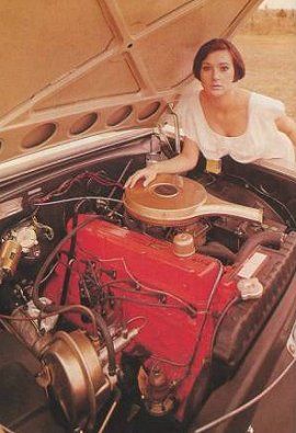

  15. Poison_Ivy
    This almost looks like a Chevy six with an unknown air cleaner and a Harrison radiator cap
