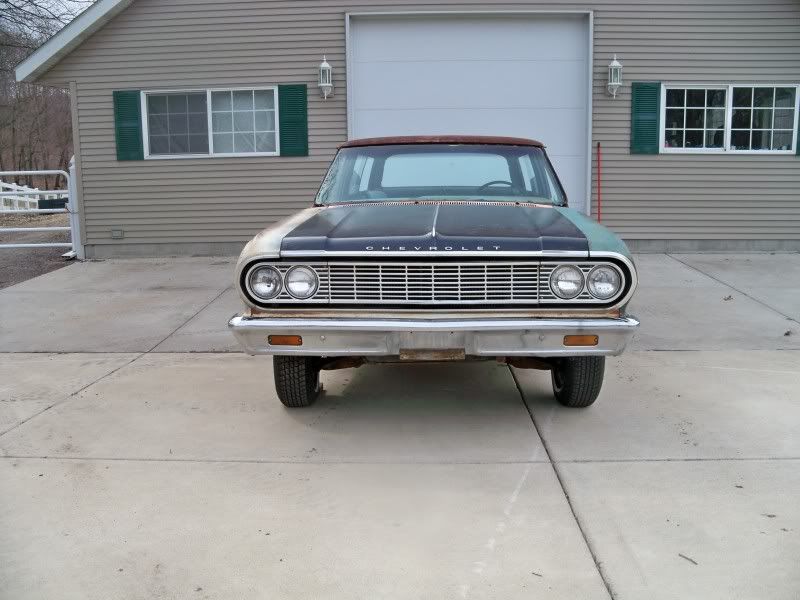

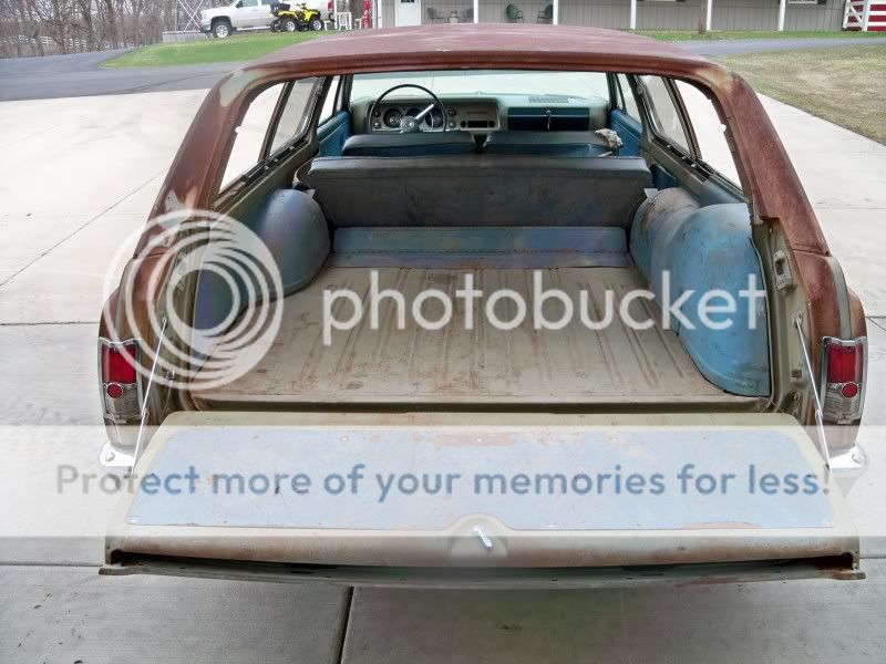

    Just picked up a 64 2 Door wagon project, going to be more of custom / pro-touring styled car. Not much original about it.
    Got no here hoping to get some help finding weatherstrip for the tailgate of the car, it didnt have any and I'm unsure whats supposed to even be there?
    -Gary

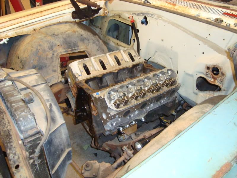

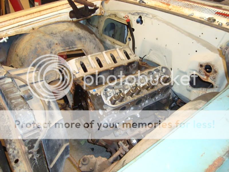

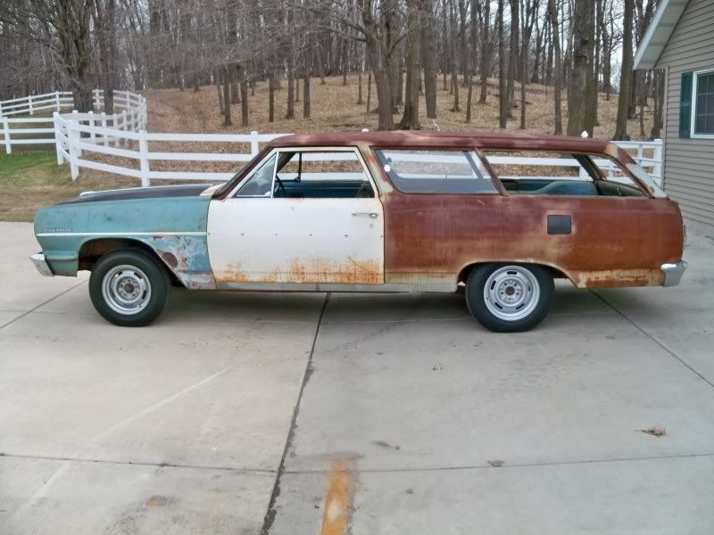

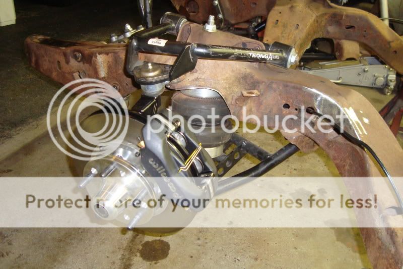

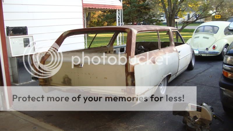

    So the plans are so far,
    403 LS Stroker carburated
    2004R, trans
    Moser 9" ford, 3:90 gear
    Air Ride & Hotchkis suspension
    Vintage Air
    and a whole list of other goodies
    Planning to run 17" and 18" wheels
    -Gary
    Heres some pics....

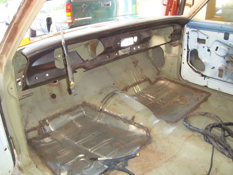

    floors patched and the start of the nova dash

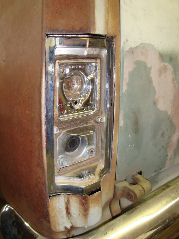

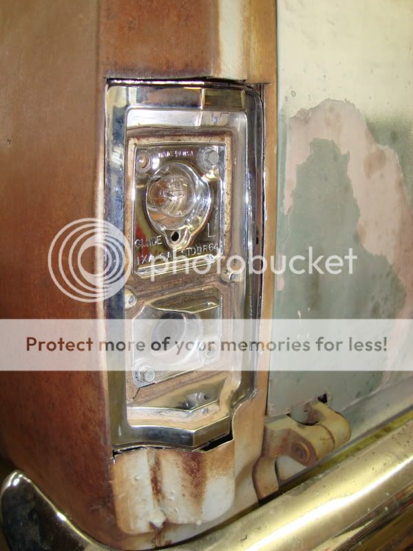

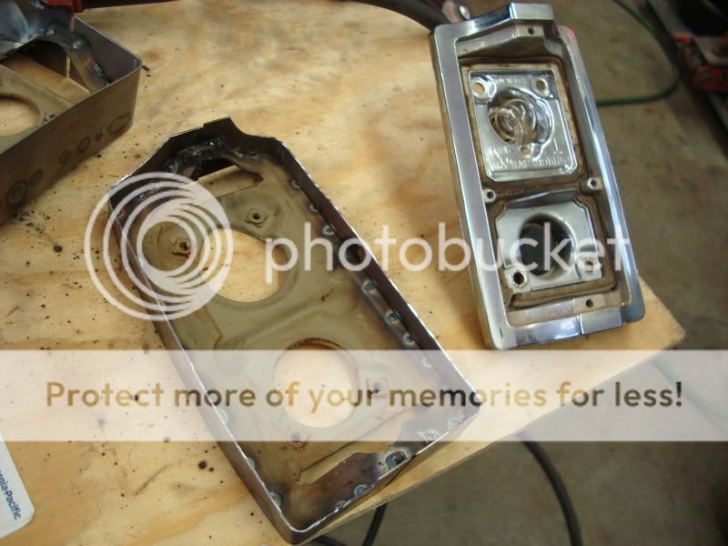

    flush fit the tail lights
    mock up engine set in place with a 2004R trans

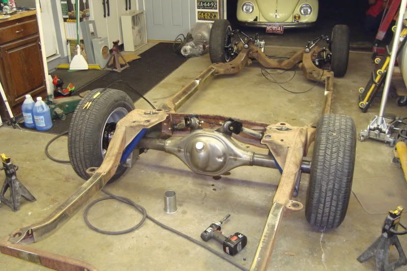

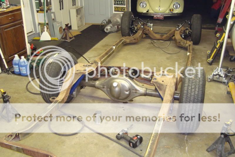

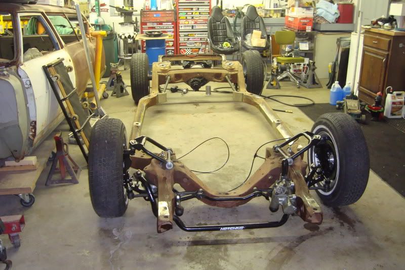

    Been awhile, got frame boxed, suspension all on, set the body on, lots of mock up and planning, next is to build tubular xmembers and mounts for engine and trans.
    -Gary

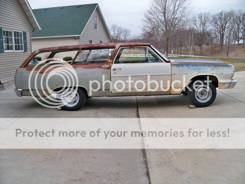

    Been awhile, some progress....
    Got the body back off the frame, get it ready for the media blaster. You can see the frame all boxed in and the tube x-member we made up for it.
    The floor pans & new trans tunnel
    Body back from the media blaster, only found a couple small surprises, nothing big though, turned out good
    The 62 Nova dash (whats left of it lol) looks good in there, I'm glad I used it
    starting to put it all back together again so i can start fitting and reworking all the panel gaps, etc.
    The widened 67 Nova bumper fits pretty good, still needs some tweaking but looks like it belongs
    Looking like a whole car again!

    O.K. Gary, I like what you're doin' and how you're doin' it but I've got a question. Looks like you've closed in the gas filler door, and the new fuel cell pretty much conferms that you have new plans for the filler location. You planing on dropping the gate every time you take on a load of fuel or are you hiding it behind the license plate location in the bumper and we just can't see it?:yup: Keep up the great work Man. It's good to see someone preform that knows what their doing:thumbs2: Jer
  15. hotrodgary
    hotrodgary New Member
    Jul 19, 2011
    Swartz Creek, MI
    originally i was going to lower the tank down to use a passenger car tank style, behind the license plate fill. I didnt like how the tank hung down past the rockers when looking at the car from the side.
    I dont have a pic of it up here yet, but I moved it behind the drivers tail light, so the light swings out to access the fuel cap. I will be moving the fill on the gas tank itself back to the factory location for the wagon on the side.
