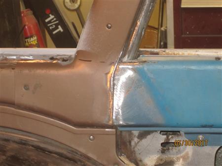

    Now to trim off what wasnt needed from the wagon so I could get that other quarter and the "B" pillar mounted

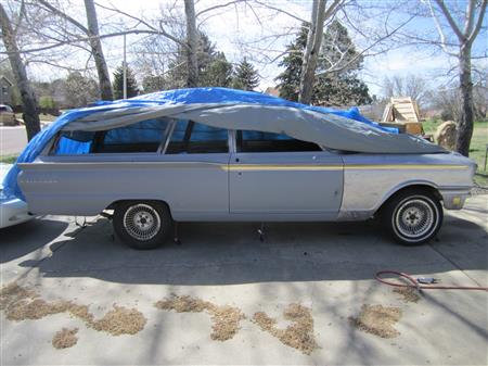

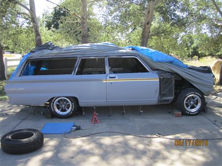

    Now, do the same thing for the passenger side and get it all welded up!! Sure wish it was a s easy as it sounds, lol
    [​IMG][​IMG][​IMG]
    Gonna be a cool ride IF it ever gets done!!

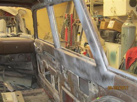

    I used all the original inside structure from the 2-door sedan, will have the roll up windows. As far as the interior goes, I think I will leave that up to the interior gurus, but will be using the same type inside trim panels.
    Couldnt see myself just welding up the rear doors...that seems pretty hokey-doke to me, I wanted the real deal. The donor 62 was in bad shape, turns out the only good parts were the doors and quarters, ha.

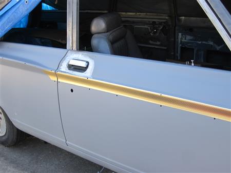

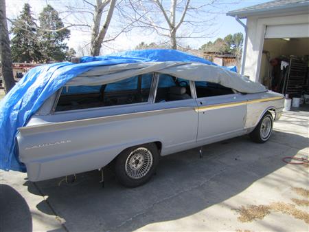

    More pics, I changed the outer door handles as well, fox mustang style, with thumb arthritis its very difficult to push the buttons on some of those old cars. And I kinda like these 15" wheels as compared to the 17" mustang wheels I also have, havent decided yet.
    [​IMG][​IMG][​IMG]

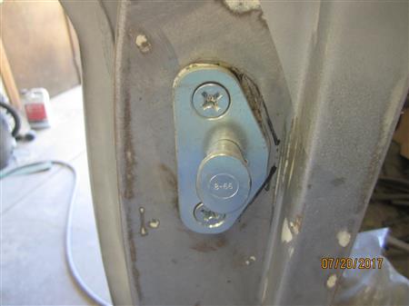

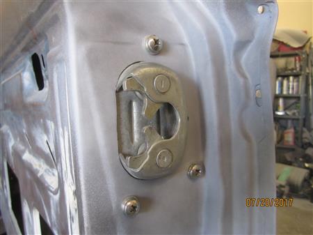

    Replaced the outer door handles, SO, I guess I'll replace the door latches, never liked the way the early 60's fords doors closed and the sound they made, "thud", so I installed latches from a maverick, and the striker plates as well, I did this to my 65 fairlane in 2005, and they worked great.

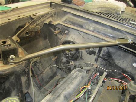

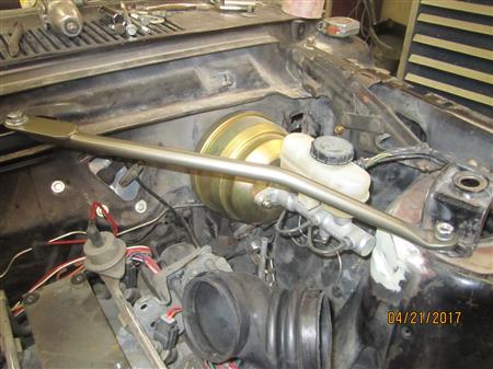

    New shock tower braces needed to clear the intake plenum, and new saginaw p/s pump, goes with the cavalier rack[​IMG]

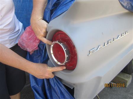

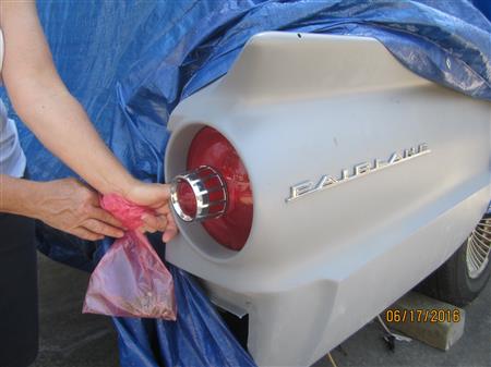

    cant decide which tail lights to use, 56 ford or 63 galaxie? Think I'll make the holes for both and switch them out as desired.
    [​IMG][​IMG]

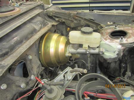

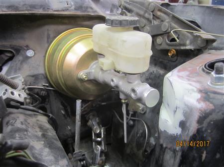

    Am going to be using an 8" dual diaphram booster from ebay,
    http://www.ebay.com/itm/8-DUAL-DIAP...UCK-HOT-ROD-/300803456966?hash=item4609487fc6
    And the m/c is from a 90 mustang. The whole assembly was too long to fit in the space provided so I "notched" the shock tower, just a bit, think it'll work fine. In my 65 fairlane I used a 7" single booster and am thinking that because the wagon is a little bigger and heavier than the sedan, it could use a little more stopping power.

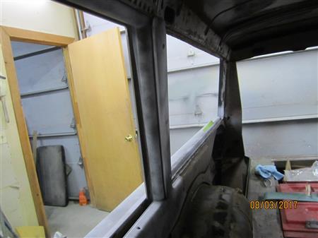

    What to do with the interior so it doesnt look like a conversion? , well I decided to weld the inner trim pieces around the "middle" window together, and make one out of the two, think it looks pretty good. And I added some steel around the window opening to give it a cleaner look, and once the headliner is installed it should look awesome.
    [​IMG][​IMG][​IMG][​IMG][​IMG][​IMG]
