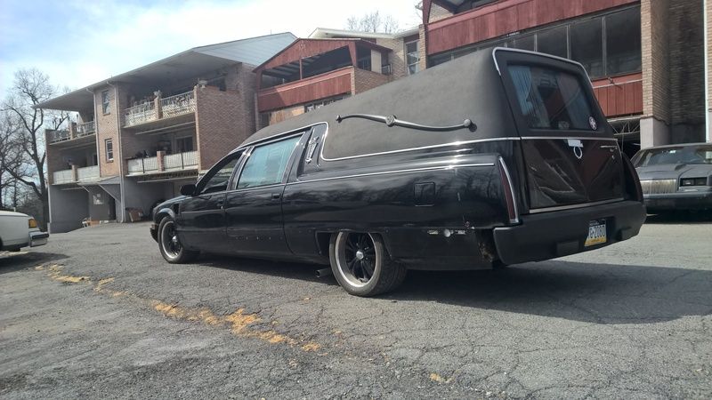

    Well It is about time I started one for this car. And the car has already cost me blood. I cut my finger/hand with the grinder. My room mate Sarah was there and saw my hand and said I definitely need to go to the ER. Now she didn't tell me at the time. But she told me after that she could see the tendon. The Doc said I just missed it. Pretty darn lucky. I was cutting a bracket off as I was doing an LED light install in my bumper. I installed 4 inch LED's that are frenched into the bumper. The stock grill and bumper are being used as I like them better than what was on it when I bought it. Here are some pics. The first is the before pic. A video will be posted at the bottom.

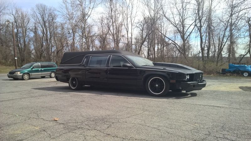

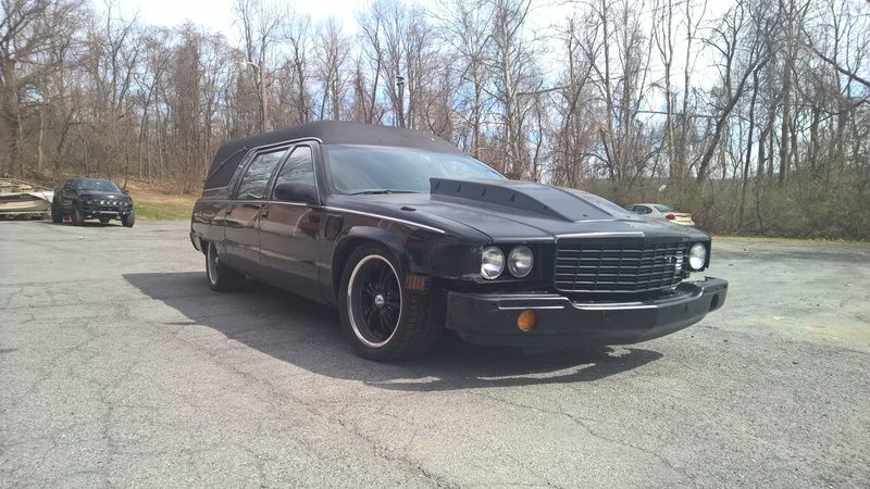

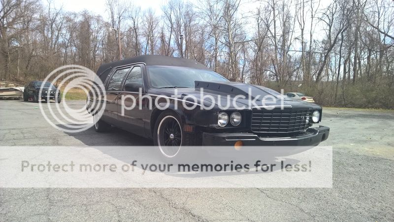

    Ok time for an update. I have done a few more things to the front end to clean it up but it still needs lots of work. Also have the wheels and tires for it but the tires aren't mounted on the wheels yet. Hope to get that done this week. I have also gotten Blue LED's for the dash which looks rather cool if you ask me. I am very pleased with that. I also put in the front Eibach springs from my old Custom Cruiser. Dropped the nose down where I want. Hope to get the rear springs in this week too. I just hope all the extra weight doesn't make it sag in the rear. Here are some pics.

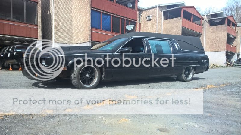

    Now sitting level and fully lowered. It is really getting there.

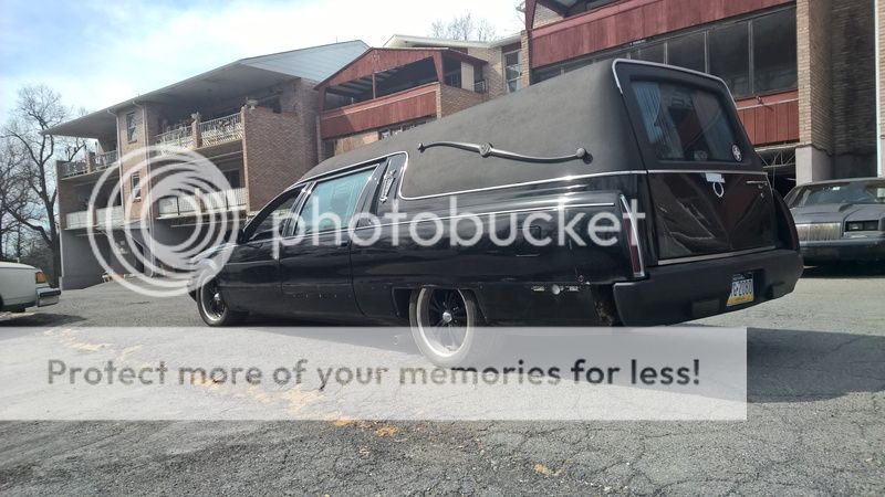

  15. The Stickman
    Nov 26, 2008
    1,316
    9
    111
    Lehigh Valley pa

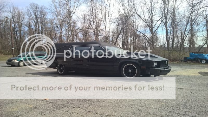

    I have some new pics with the new wheels and tires on. Slight rub on the right rear but that should be fixed Saturday. They are 17X9.5 JNC's with 275/40-17 BFG G-Force Sports Comp2's
