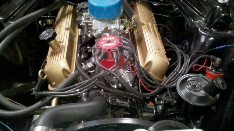

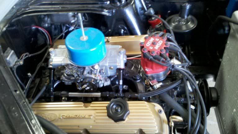

    Friday update with pics yeah!
    Well I have been in San Luis Obispo for 2 weeks so no work on "Kathy". This was the first Friday in a while. While I was away the guys at the shop had Kathy towed to the trans shop to flip the something or other? Valve body I think so the column linkage would work, and also to the exhaust shop for "duals"
    I had grand plans today as i hadnt been to the shop in a while, I was hoping to get the fan and shroud on, run the upper and lower house, finish the wiring on the MSD ready to run, put in some more heat insulation in the interior on the firewall, install the horns yada yada yada.
    So i started with the fan n such, wow it took me quite a while to put on and take off spacers to check their compatibility with the stock style 6 blade mustang fan and metal shroud. I ended using mounts for a 2 row radiator and got that part done after 12, whew!!!!!!
    I then ran the ground and the ignition and the coil wires to complete the electronic ignition, I put on upper lower and by-pass hoses, then I seperated the plug wires with a trick I saw on Hot Rod TV using zip ties, I will try to get a close up next time.
    I helped one of the guys with his car for a little bit then I had to leave just a bit early to pick up the mustang, (new front tires and alignment)
    I will be in Vegas next Friday but will work on Kathy on Monday, Holiday for us govt workers!!! Everyone have a great weekend, Ryan
    FAN SHROUD N HOSES
    A LITTLE CLOSER
    MAYBE YOU CAN ZOOM INTO THE PLUG WIRES?
    SHOT OF THE EXHAUST EXIT PASS SIDE
    A VIEW FROM THE REAR WITHOUT THE BUMPER INSTALLED
    A VIEW BACK TOWARDS THE MANIFOLDS

    Don't you love it when you actually accomplish all the things you want to get done in one day.
    That MSD set up looks slick and those pipes look really professional.
    It's turning out great. I love how you guys work together and help each other out.
