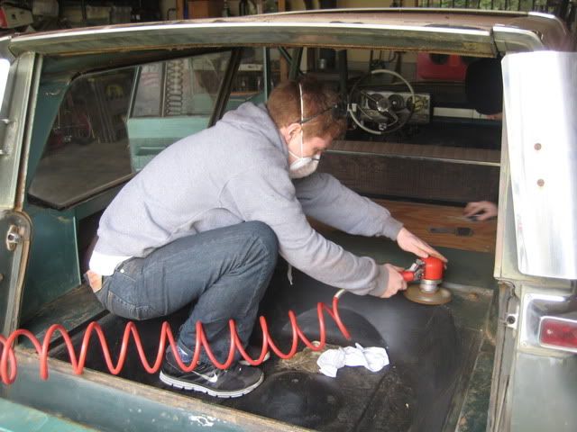

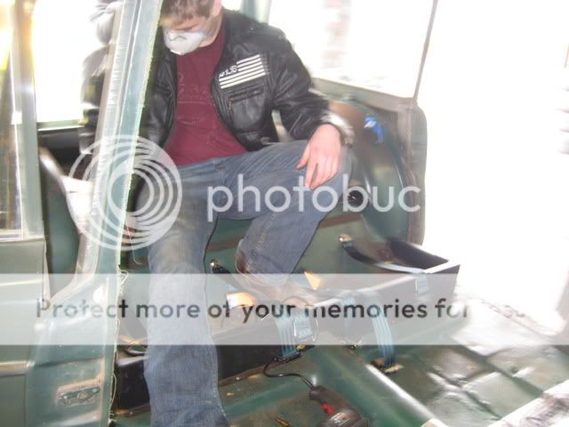

    This week we focussed on the interior - sanding rust off the ceiling, installing the seats, putting in seat belts, cleaning up the rear cargo area.
    I set Kris loose with the sander and had him clean up the ceiling. It was a dirty job, but he stuck with it and then took the sander to the cargo area when he was done.
    Kris was making a lot of dust, so we were all wearing masks... Here's Ransom doing the easy side of the rear seat belts. Ian is underneath the car turning the wrench.

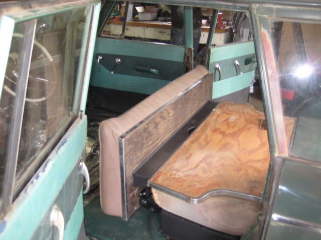

    The seat frame and hinges are all cleaned up now and installed. We'll probably take some sandpaper to the wood on the seats and then put some kind of finish on it. Somehow we ended up with a brown rear seat and a green front seat (that matches the rest of the interior).

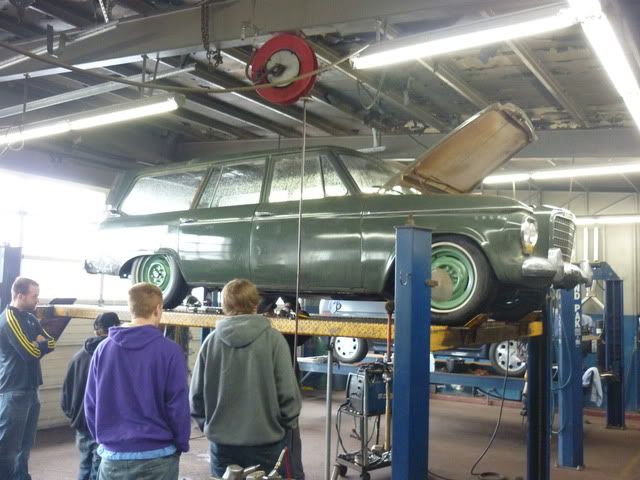

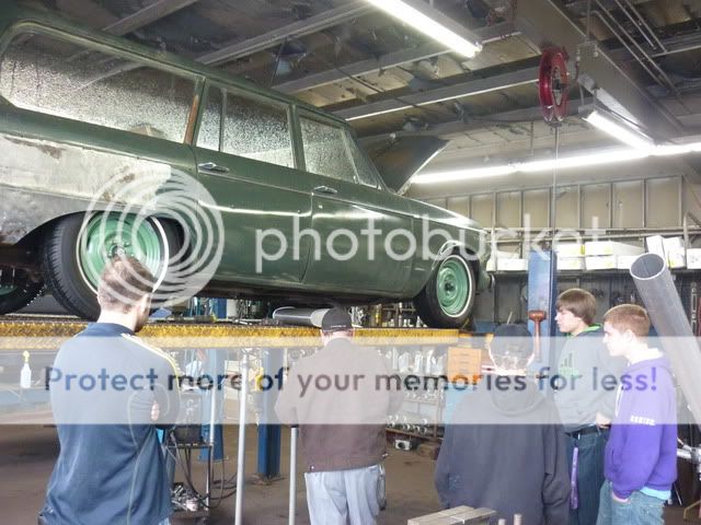

    Session 14
    This week we had class on Saturday so that we could take the Stude to an exhaust shop near by that is willing to let the whole class into the shop.
    The car already had a Y pipe on it, so we just ran a single pipe back. I know some will say we should have put on dual exhaust, but we're on a tight budget.
    With the car up on the rack it was obvious that the front end alignment was WAY off, so I did a quick adjustment of the toe in. We still need to adjust the camber as the tires are leaned in.
    Someone pointed out that lowering these cars can be a bit hazardous, and indeed we are getting a little tire rub on the fender if the wheels are turned when you come to a stop.
    Now we're off for a couple weeks for spring break, then back at it with only four more classes left.

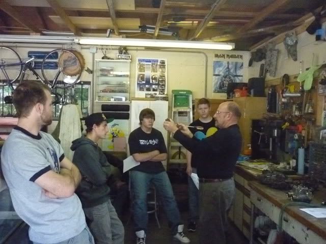

    Our 16th class session was on June 6th and we were lucky enough to have a Studebaker collector that I know from church come to visit and teach a little.
    We mostly worked on the interior today. Ian reinstalled all the trim in the rear cargo area while Kris masked off the ceiling so we could paint it.
    The spare tire cover on these is a sheet of plywood and our original cover had long since rotted away, so Ransom and Zach got to do a little wood working.
    Ben also gave a lesson on how carburators work and helped us diagnose some carb issues with our car.

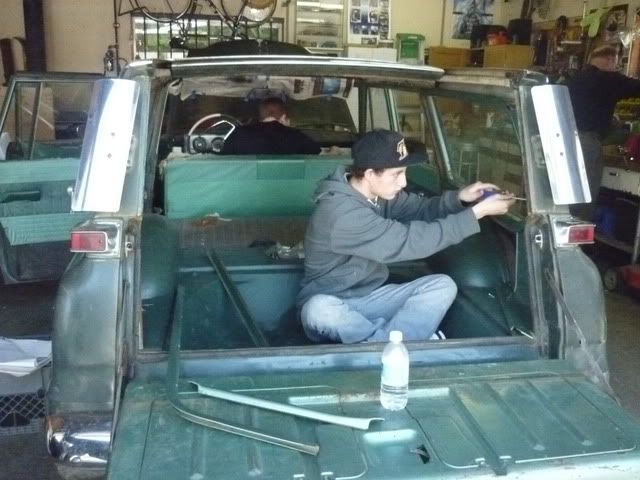

    Session 17
    Our 17th session was mostly spent chasing down starting issues. The starter wasn't engaging so we took it off the car, cleaned it out, and lubed the Bendix. We also replaced the starter solenoid after it got stuck and tightened and cleaned up all the connections.

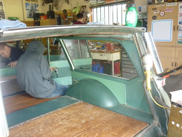

    A couple of the students finished up the spare tire cover and Zach made some new panels for the rear cargo area.
    Here's Ian installing the new panels - I think they turned out real good.
