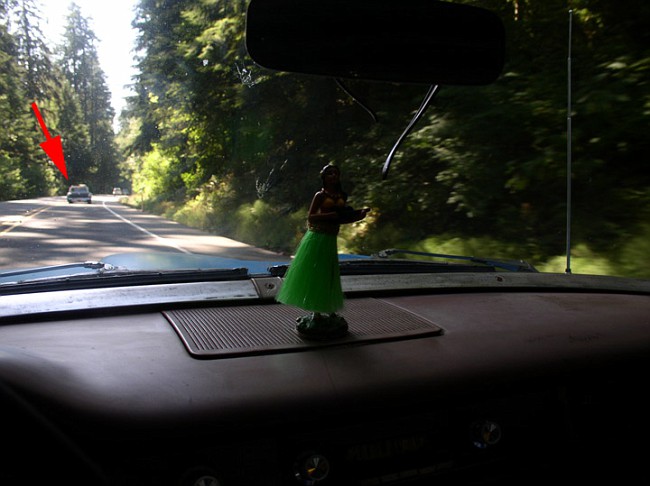

    Got myself a dash mascot
    Sure there are a few things I missed. And sure are a lot still left to do like clean the cowl drains, lube the diaphragm in the wiper motor, replace the twisted rear bumper, check the heater core... etc, etc. but for now it is a dependable driver that starts every time and runs beautifully which is a lot to say for a car that is 53 years old! Lots of people say: When are you going to paint it? I tell them that the blue is growing on me and I might put the chrome back on and leave it for now.
