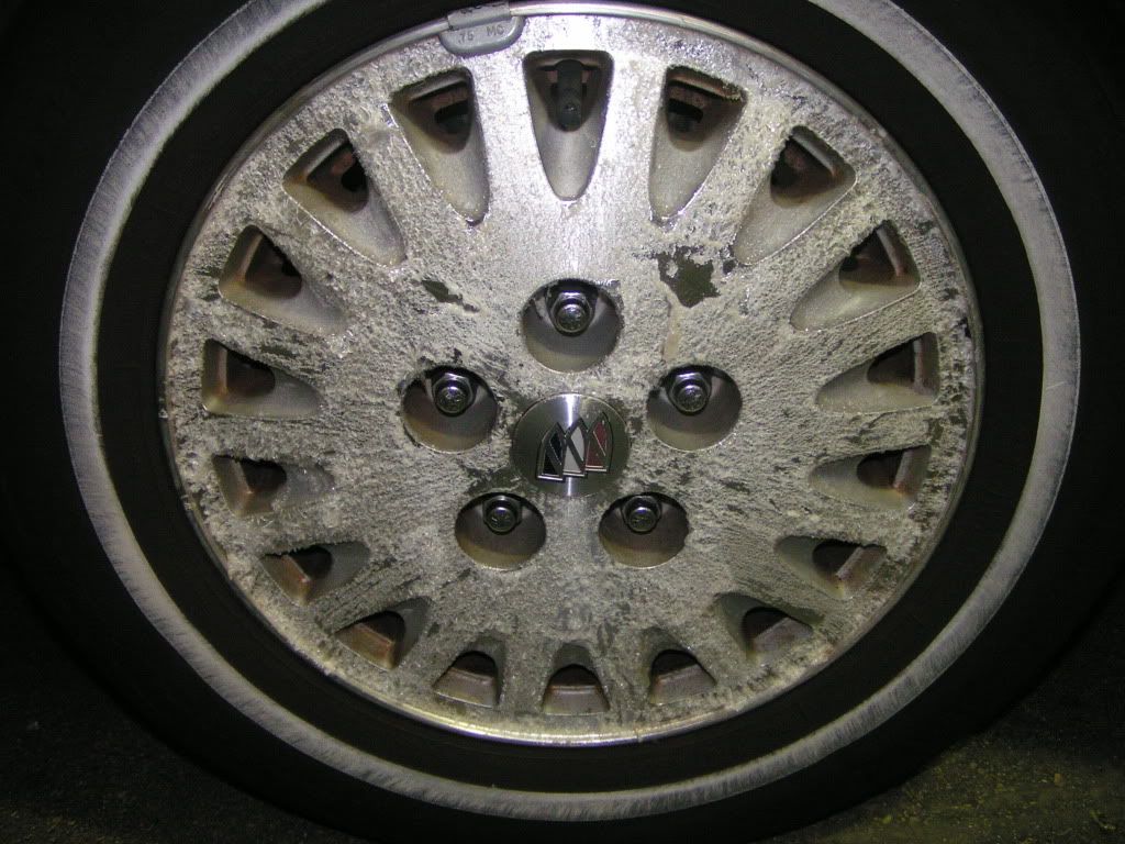

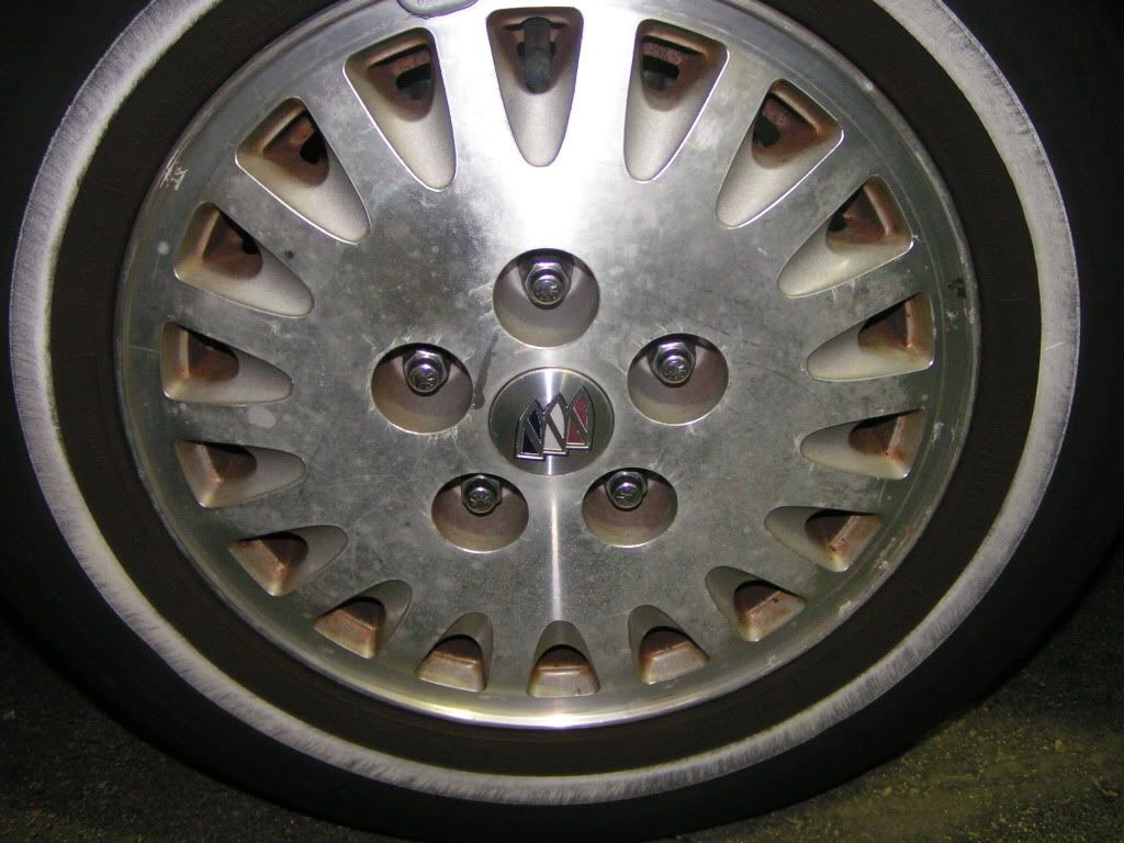

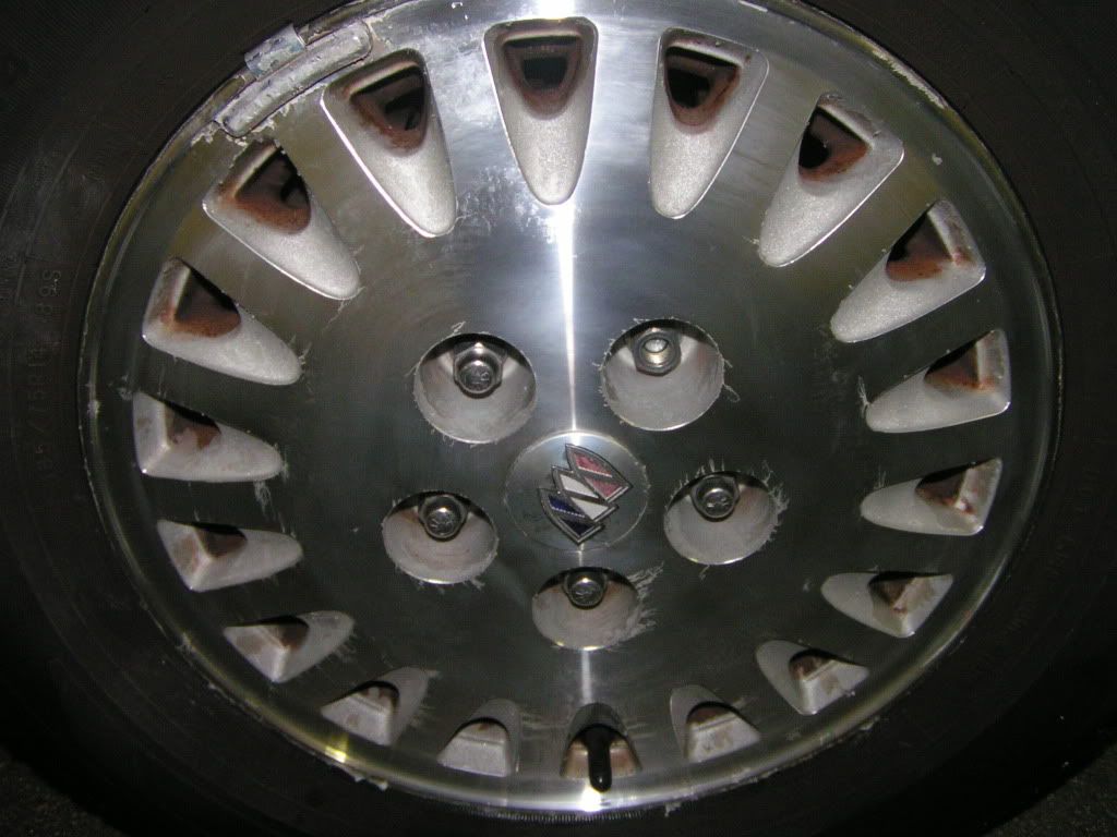

    Decided to tackle the wheels on my '94 Buick Century wagon. They were looking dull and splotchy and my attempts at polishing up the clearcoat did virtually nothing to improve the appearance. It seems the aluminum underneath had oxidized and I would need to get to it to achieve any success. First, I needed to remove the hefty accumulation of caked on brake dust. I tried a name brand wheel cleaner and it didn't take off much at all. Rather than risk another possible failure on a stronger acid based product I decided to just make my own by mixing one part hydrochloric (a.k.a. muriatic) acid to two parts water and it worked great. The results can be seen in the first pic. Didn't get every bit, but the vast majority of it. Next I got some heavy duty semi paste stripper and brushed it on. It took three applications to get all the clear to lift as can be seen in the second pic. A power washer removed it all easily. The third pic shows a wheel after I did a quickie pass with some polishing compound by hand (it was getting really late). There's still some work to be done to complete the project as you can see, but the bulk of it is out of the way.
