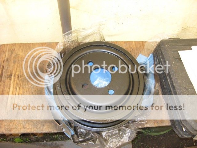

    I used VHT on the drums after I cleaned them off:

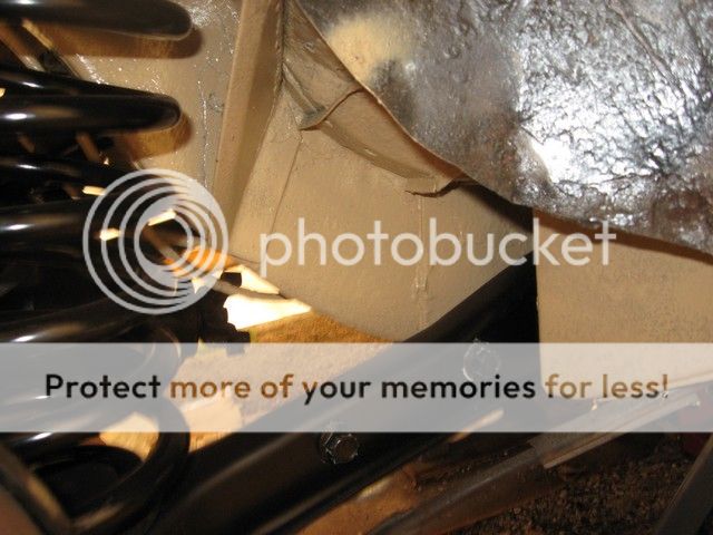

    I got these Lower Control Arms from a good used parts yard in Nebraska, and dusted them off - no rust! Then after I cleaned my own Upper Arms off, I realized that mine were pretty crusty, even after a thorough cleaning, so I got them to send me the uppers from the same 1979 Capri. Too hard to find good ones, but I'm set for the next Fox-body.

    I wire-brushed the old undercoat off, and any rusty areas, then primed with cold-galvanized spray, then paintable undercoat, then the actual top car colour. A light colour under there sure makes it easy to see what I'm doing, lying on the ground with mosquitoes wanting to kiss me..
