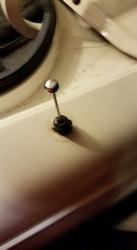

    The FINAL project, hopefully...other than some last detailing/cleaning, will be this...fix the power antenna that WORKED when I started this car's refurbishment. I've never done a mast cable...have to drill out the rivets and split the motor case. Wish me luck!

  5. Silvertwinkiehobo
    2,995
    I'll look up the mast procedure on-line, because you're not supposed to have to do anything but install the drag line and mast, and that's it. Give me this afternoon, and I'll see what I can find.
  6. Silvertwinkiehobo
    2,995
    Yeah, you have to take it apart. This is a YouTube video of the repair procedure.

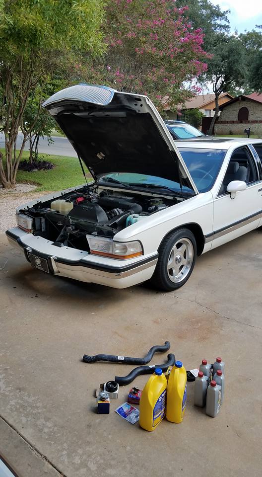

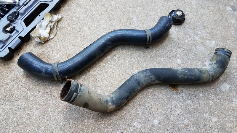

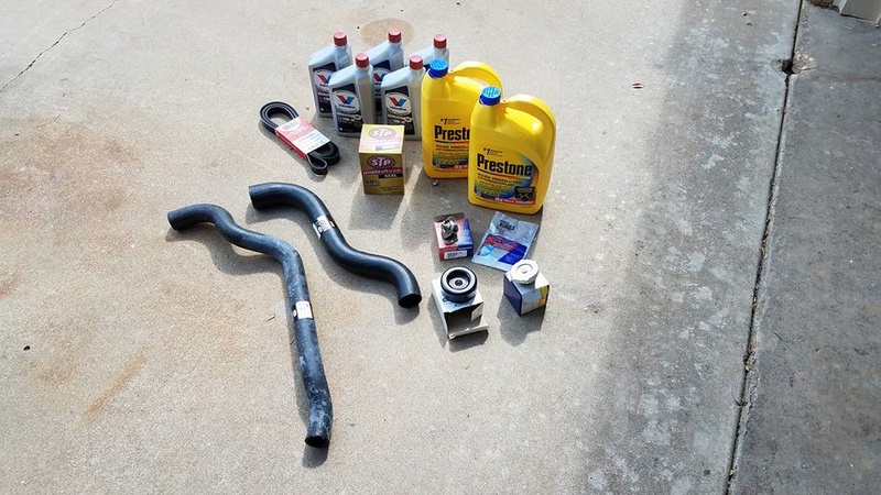

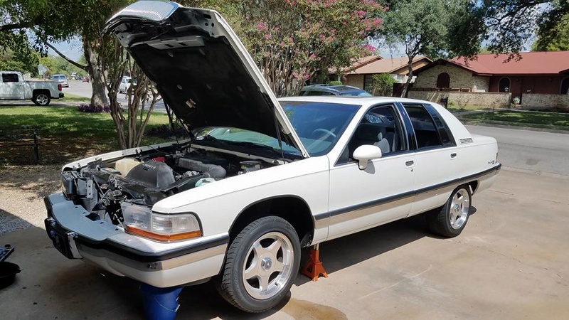

    9/23/17 - Saturday Projects! Flush radiator, install new upper and lower radiator hoses and new thermostat and radiator cap, replace noisy belt tensioner pulley and install new belt, and change "break-in" oil and filter with full synthetic 10W30 oil.

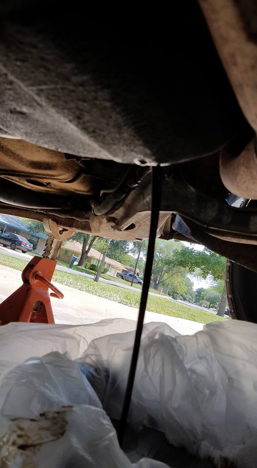

    My FIRST project of the day was siphoning out some fresh transmission fluid...doh. Overfilled when doing to filter service...my 96 Roady Wagon with the 4L60E takes 6 quarts with a filter change...this car, it seems with the 700R4, takes only 5. Oh and transmission fluid still tastes as horrible as I remembered. Yuck!

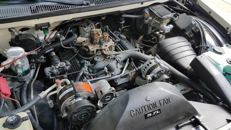

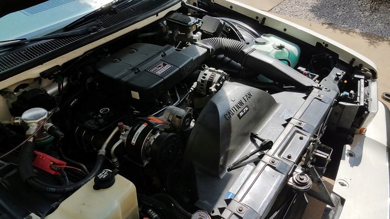

    Tools out, ready to take things apart! At least it looks clean under here now. Big change from when I first got the car home.
    Air cleaner box removed to access the thermostat housing. I wish GM had just used a traditional round metal air cleaner on these....the plastic box..is goofy..and frankly it's easier (and cheaper) to replace a round filter.
    81K mile original thermostat...yucky.

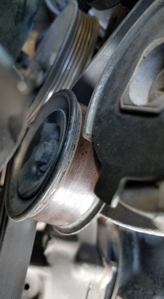

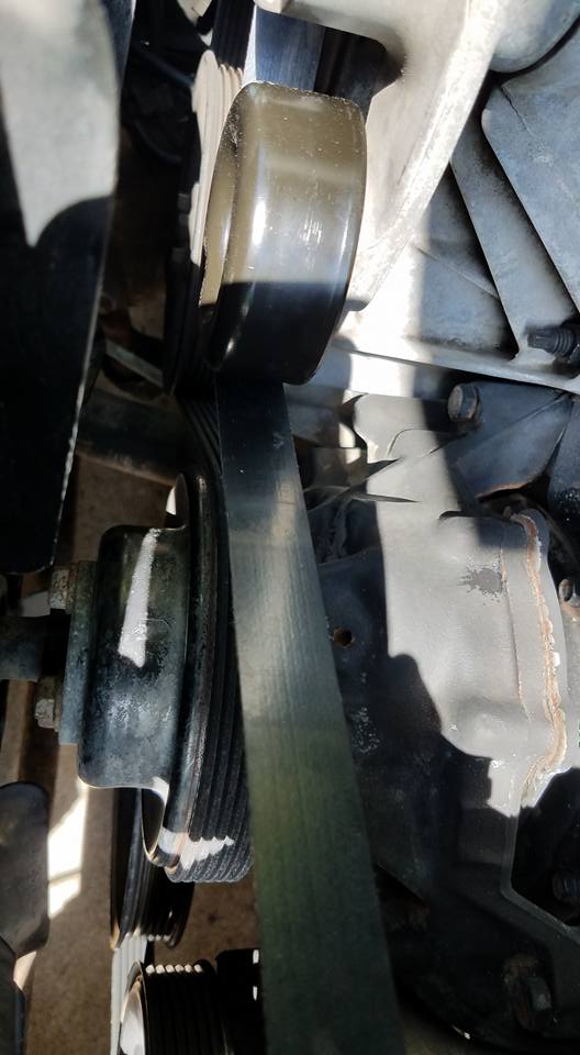

    Belt tensioner pulley growling...bearings failing.

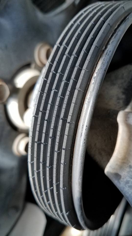

    You think the belt needed to be done? 81K mile, 25-year-old original serpentine belt!
    New belt tensioner pulley and new serpentine belt installed. MUCH quieter!
    Cleaned and painted the thermostat housing semi-gloss black.

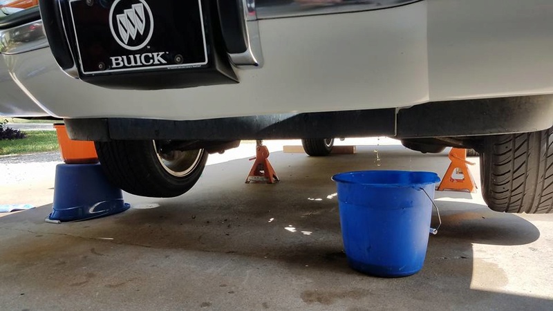

    Now to flush/drain the radiator coolant and engine oil.
    Nasty old coolant draining.
    The radiator hoses were both original to the car...the lower one was especially nasty.
    While laying under the car I did notice that it has a newer starter. Nice to see that's been done.
    When I brought the car home, the oil in it was at least 5-years-old. I changed it right away...it was nasty, and THIS oil draining is only 500-miles old here. I'm hoping this "break-in" oil worked to clean out this motor. Replaced with 10W30 full-synthetic...was told to go from 5W30 to 10W30 when switching to full-synthetic on these LO5 Chevy 350 motors.
    After doing the thermostat, hoses, flushing everything, cleaning the overflow bottle and adding fresh coolent, I put the new cap on it it was leaking almost right away! I thought it was a bad cap, but NOPE, the actual neck on the radiator cracked right there the cap clamps on! Car needs a new radiator! Frustrating!!
    SO I did make SOME headway but got frustrated over the radiator issue and didn't make it to the antenna project....instead parked it until next weekend. About to order a new radiator from Rock Auto...and will plan to be working on this car again next Saturday.

    That's another first for me...I have never seen a brass stamping fracture like that. That really does suck. Oh, and before I forget, the t-stat housing bolt/stud with the ground wire on it? the bolt hole threads need to be cleaned so that ground has better continuity. Very important to the car running, without turning the CEL on. I can't remember what the ground is for, but I did always clean the nut, bolt, the threads, and a dollop of black RTV just under the bolt head, before tightening, to help keep liquids out.

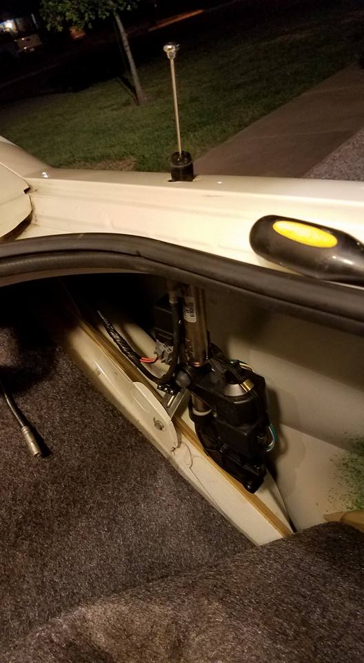

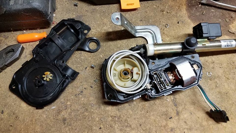

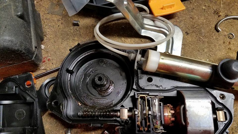

    9/25/17 - Evening project, replace the Power Antenna Cable.
    Replacement Antenna cable from TheAntennaSource.com

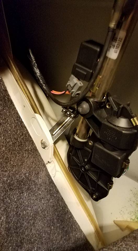

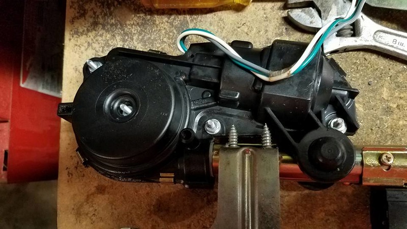

    Was able to get broken antenna down this far to remove it. Used a flat-blade screwdriver and rubber mallet to tap the chrome retaining nut loose.
    Now removed the black plastic angled trim bezel and washer.

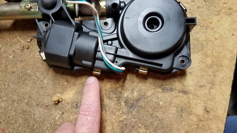

    Next unplug the grey power plug and antenna cable, and finally remove the #10 bolt on the lower mount and carefully slide the antenna out...don't scratch the paint or bend the mast.
    Remove #10 bolt here.

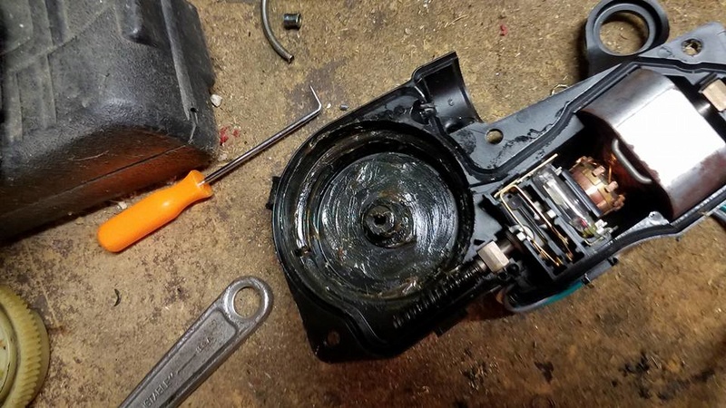

    Antenna removed and ready for surgery.

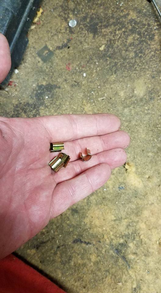

    Carefully pry off the gold clips...these suckers will fly away into space if you are not careful!
    Gold clips removed

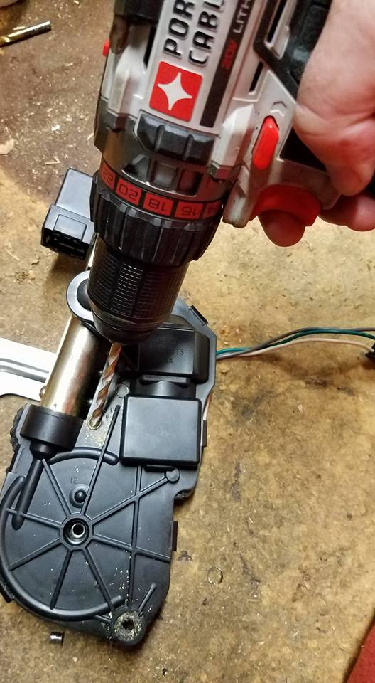

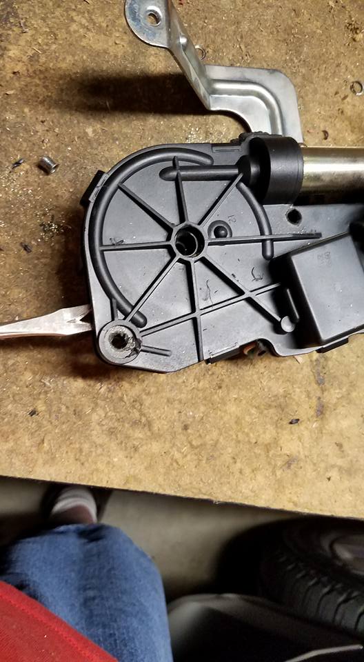

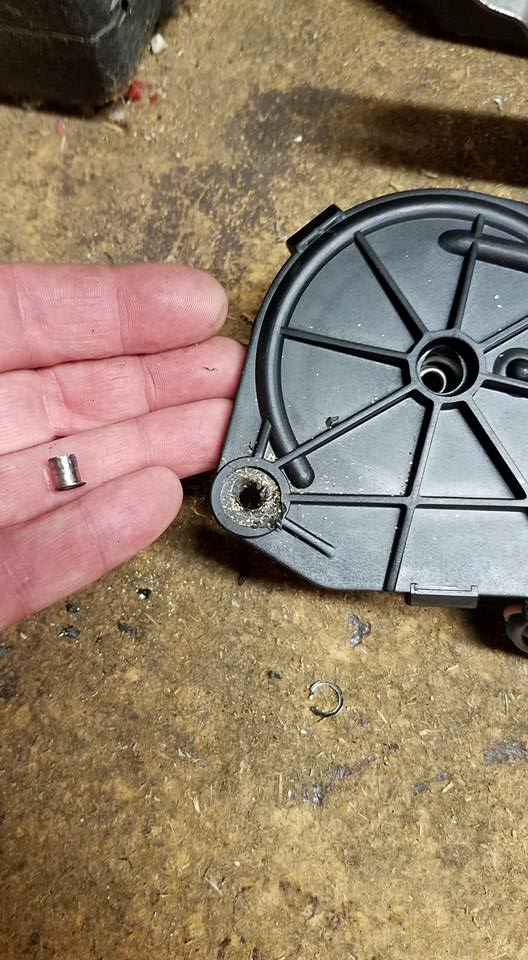

    Now you need to carefully drill out the case rivets.
    Stubborn rivets!

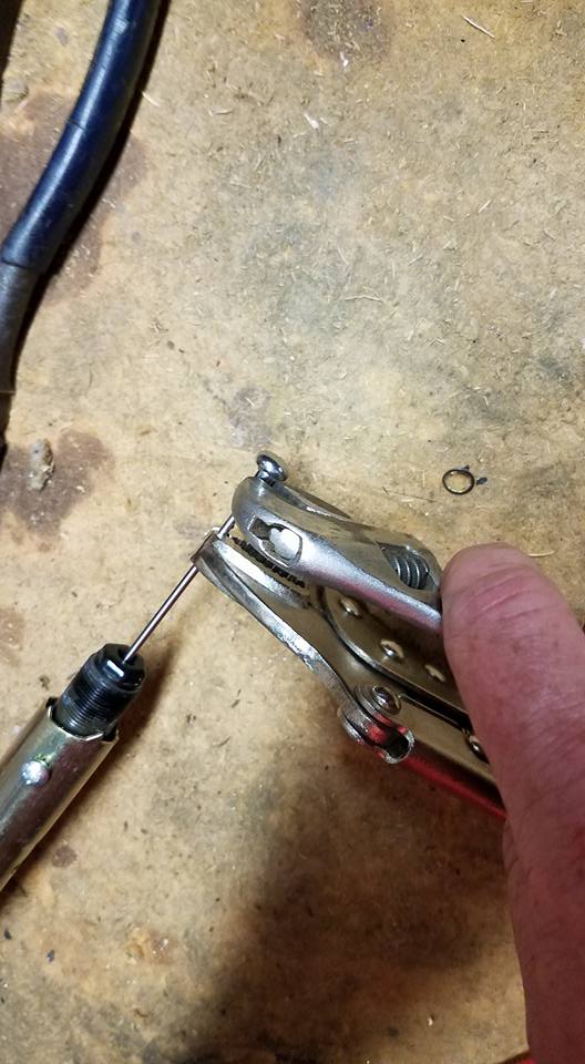

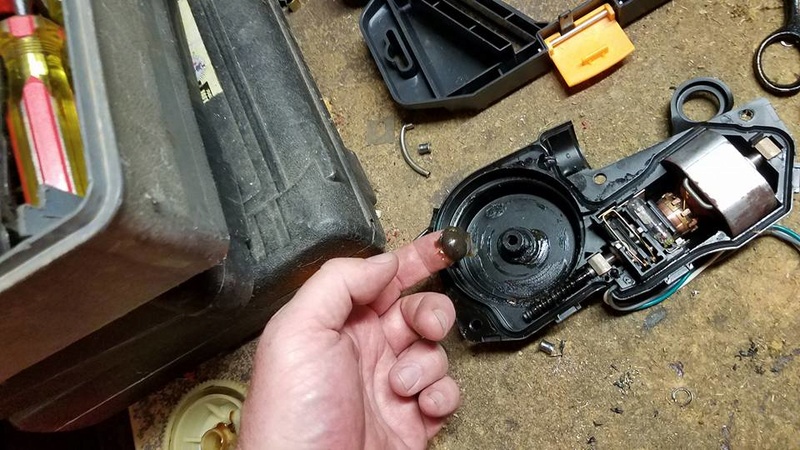

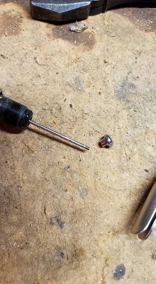

    Now use vice-grips to hold the old upper mast and unscrew the button from the end.
    Now carefully pry the case apart

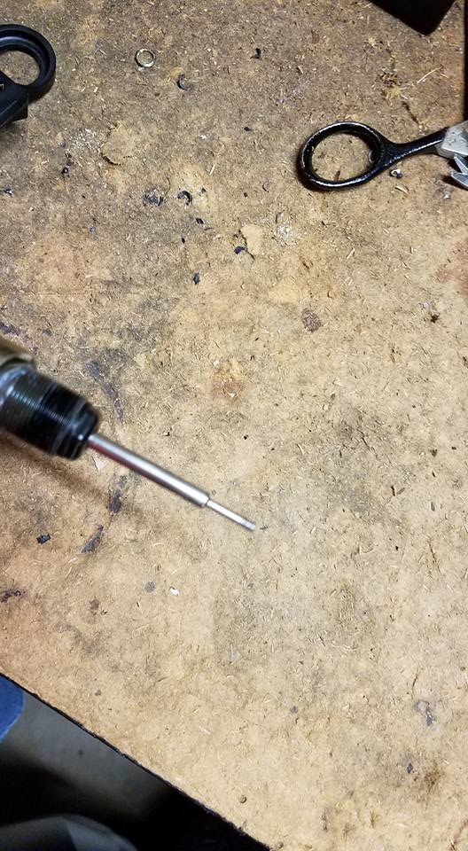

    Case removed...where was this old cable broken??? Looked to be all there...but look closer...
    The old cable broke off at the very end, right where it fit into the metal "fish-hook".
    Mast tube removed and gear removed

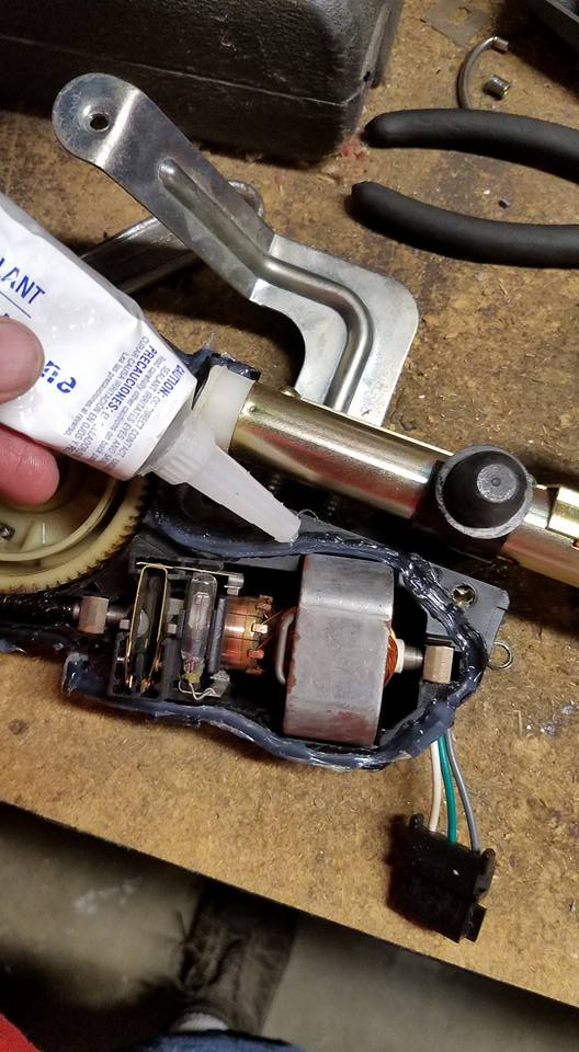

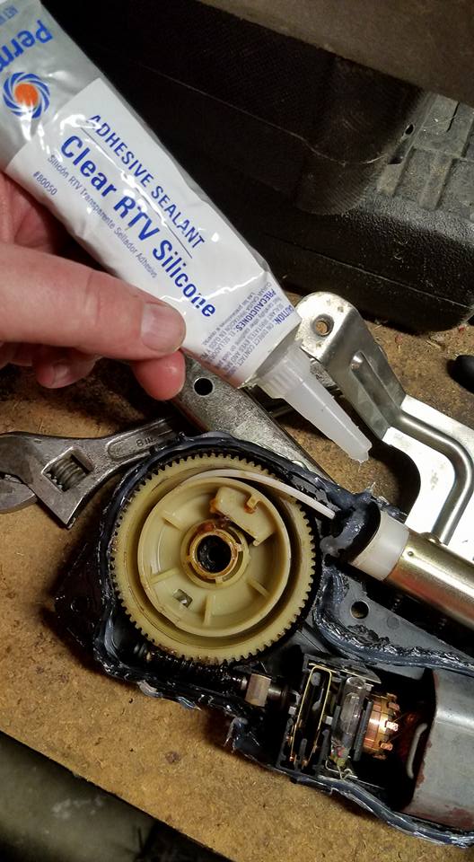

    I added lithium grease to the case and gears/gear teeth. Not a lot...but a nice thin coat.

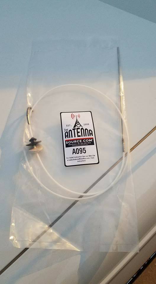

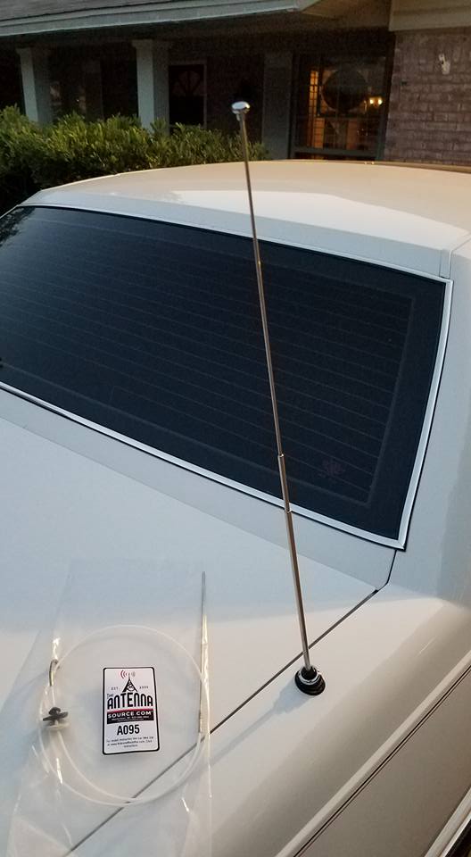

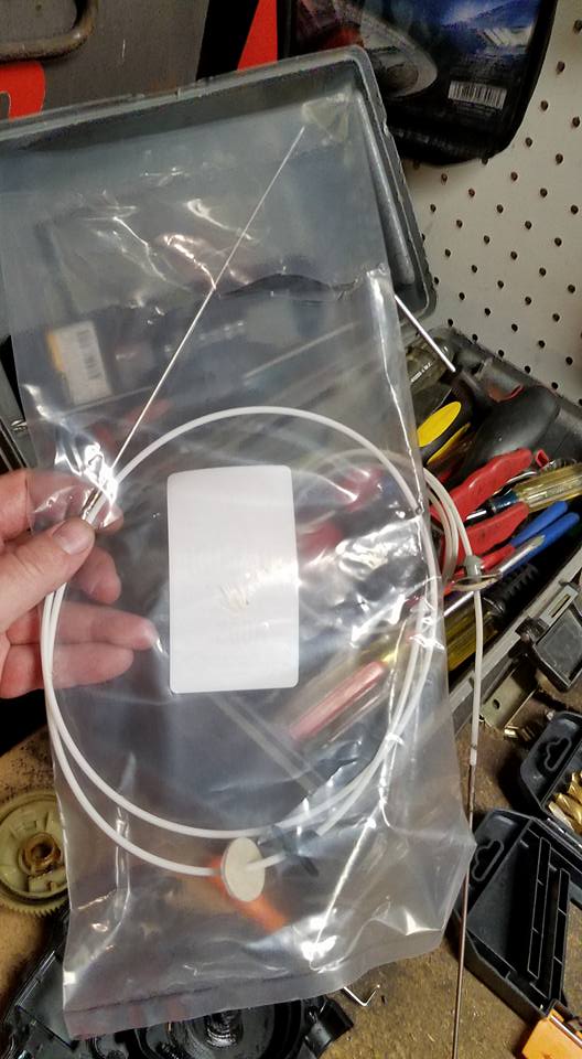

    9/25/17 - Next I removed the new cable from the bag.
    Threading the new cable through the mast tube
    New metal end of cable through old mast, ready to re-install chrome button tip.
    Chrome button tip screwed on new cable end.

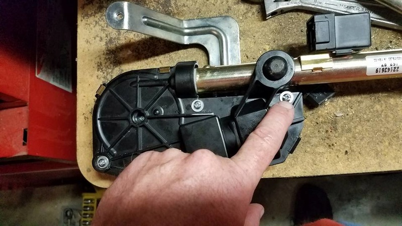

    Next I extended the mast fully so only the end with the fish-hook was out, clipped the hook end into the white plastic gear spool, and carefully fitted back into the motor case. Then I added a thin bead of clear silicon to keep moisture out. There was silicon here when the case was opened, but it tore apart when the case was separated.

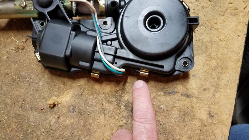

    Case back together and clips installed. At this point I went back to the car and plugged the antenna in, and had Eddie turn the radio on to pull the antenna back into the case, and then to test that it would re-extend. Once you know it works, go back to the workbench with it.
    Found four screws, washers, and nuts to bolt the case back together where the rivets were drilled out earlier.
    Case all screwed back together and antenna is ready to be re-installed on the car.
    9/25/17, 11pm, repaired antenna re-installed.
    Radio on, antenna going up...
    ...and up....
    ...and up...
    Radio on, antenna fully-extended and working like new again!
