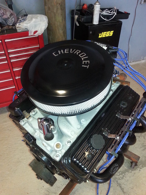

    Had to work 6 days this week and had Sunday dinner with the family (sister, brother in law, mom, dad ) so not a whole lot accomplished on the wagon. I did slip out after dinner and at least run the other plug wires, put plugs in, bolt on carburetor and water housing. Have to finish putting one end on my wires. I also hunted down my new starter I had still in the box but I have at least done something, no matter how insignificant it may seem, to it last 3 weeks in a row. Which is more than I have done with it in a few years. This is what the motor is looking like now.
  13. Bdsammies
    Bdsammies Well-Known Member
    Feb 24, 2014
    159
    47
    Black Diamond,AB,Canada
    VERY nice!!!!!!!!!:thumbs2:

    One step at a time; it'll get done.
    Engine looks great!
