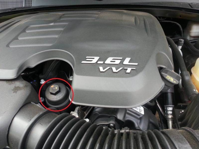

    OH and more to the POINT of this thread, check this out.
    YES our 300 ONLY has the Pentastar V6. I bought this car for my wife and she was more concerned about mileage (averages almost 30mpg on trips) than speed. Still it has 300hp and is quick for what it is. The Pentastar V6 is a LOT stronger than that GM 3.6 that was in the Enclave.
    Best part, the Chrysler 3.6 V6 has the EASIEST oil change I've done in years. Has a traditional oil pan bolt that is easy to reach under the car, but the BEST part is the oil filter is a cannister-type that sits top-front-center on the motor under the hood. You can change it in no time, and with no mess. ALL cars should be like this, it's a brilliant design!
    See the red circle...filter is inside there, just unbolt the cap...fantastic!
    Again we'll just see how reliable it is...Chrysler scares me...Fiat scares me more. Ha!

    Speaking from experience, I'm gonna be clear: that filter setup is not all that clean. And, you'd better invest in the little metric socket needed to undo that cap, otherwise, you'll be posting on here that you strained your milk attempting to undo that cap with no success. When you do undo the cap, have a pile of rags laying next to it, and a small container to drop the entire assembly into...do not try to walk it over to the bench, as you'll leave a trail of dots. Use the provided o-rings every oil change, and ensure they are properly lubed before reinstalling the assembly. Turn it by hand to ensure the threads are not crossed, and use the shortest ratchet you have to snug it, otherwise, it'll be a bastard to break loose next time. That's my experience with those.

    I wasn’t gonna burst his bubble with all this....I’m not a fan of that Style filter either...granted it still beats the heck out of that enclave filter location. I bet if you let your motor cool and your oil settle you could avoid a huge mess. Warm up the car, pull the drain plug and go make a sandwich or something. If you don’t have time to burn that canister will likely be full when you open it and it do get a little messy. I second the suggestion that you use that extra rubber ring for the cap and lube it up before installation the same way you would oil up a traditional filter. If not you will be fighting. I’ve seen them where that soft plastic cap has been stripped out and destroyed because it was on there so tight and that ain’t no fun. Especially when it’s underneath the car in a weird spot. But since you handle all the oil changes you don’t have to worry about working behind some dip at the oil change place. I would like Andrew said, buy the socket that’s made specifically for that style cap. Your a thorough and thoughtful man though! You got this

    I've done the first oil change already....yep my wife managed to put 5,000 miles on the 300 just since we bought it in March....she drives from Austin to Dallas many weekends to see her family. Happily the oil change, especially after doing the Enclave...was CAKE! No issues getting the filter out at all, installed a new O-ring, and was OCD-enough to use my torque wrench to re-tighten the cap to book specs. The filter itself clips into the actual cap, which is neat, so when you take the cap off the filter comes with it. With the pan sitting on the radiator suport, I just held the filter over the pan when I removed it, no fuss, no mess. I love this setup so much!
    Hope the car holds up! Zero complaints so far!
