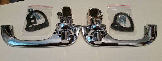

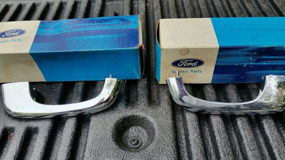

    The door handles on my wagon are original and show their age as the chrome has nearly worn off from use. These NOS Falcon handles, without push buttons or hardware, are currently available on eBay for $300.00. If I were building a Concours d'Elegance contender I could justify the price.
    The great thing about 1960-63 Falcons is 1965-66 Mustang parts can be modified to work and are usually much less expensive. I found these complete Mustang door handles with excellent chrome for $20 on eBay.
    The following reviews the simple modifications required to make the Mustang parts work on my Falcon wagon.
    The Falcon push pin attached to the button that opens the door is longer than the one for a Mustang. A vise and pliers made easy work of removing the Falcon pin from the button. The great part is the Mustang buttons pictured already have an unused hole drilled in that accepted the Falcon push pins perfectly. The original Falcon spring replaces the Mustang's and the original Falcon retainer the pin moves through is installed upside down which completes the modification. It was quick and easy to modify the Mustang door handles to work on my Falcon and saved me $280.00 in the process.

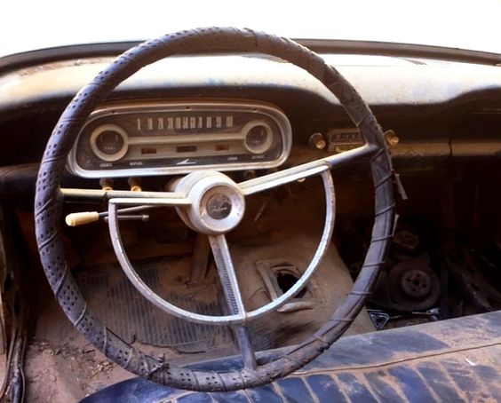

    Your '62 2 door Falcon wagon had lower production numbers than my 1960 and would have been great to have been able to keep. Even in California, rust can destroy cars if left to the elements. Fortunately my Ranchero was found in the California desert and was 100% rust free. However, there was sand everywhere so I always wore safety goggles whenever I turned a wrench underneath the truck. Here is a picture of my Ranchero's sandy interior when I first brought it home.

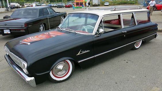

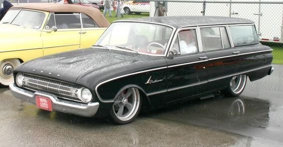

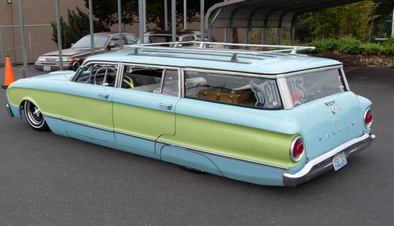

    On a related tangent, these Falcon wagons were built with different design directions but all look great.

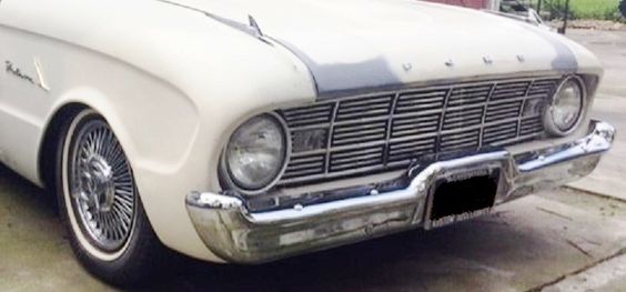

    With the day off for the President's Day Holiday, I installed the NOS grill, and new bumper on the wagon.
    NOS F-O-R-D letters and NOS turn signal lenses completed the refreshed front of my project.
