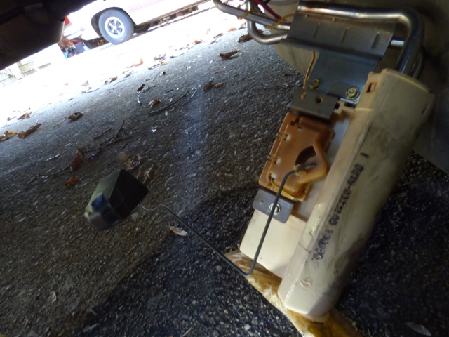

    Ford said the number is e1az-9275a but that isnt the same.ugh.
  2. Silvertwinkiehobo
    2,993
    What about it is not the same? I know, engineers can decide to change a design at a whim, but this is a setup that was used for both carbed and EFI cars. Do you have an earlier unit to compare to the later unit? My thinking is that the earlier unit can be modded to fit correctly.

    If it's reading empty chances are with that float design the solder around the edges has cracked and is filling it with gas and thus it is sinking in the fuel. You can let it drain and re-solder it, or you do what I did:
    Nitrophyl float from a quadrajet jammed on the end. Problem solved.

    Will have to try.

    You can try to resolder it, or use older-formula nail polish. That's what my old boss at Autocents used on carb and gas tank floats. Also, I remember securing a brand-new NOS 'barrel' float for a 91 F250 once, from Green Sales (my apologies, I plum forgot about them) in Ohio. Just google "obsolete Ford parts."

    Don't try it unless you know that it's your problem. If the float is leaking, it will have gas inside of it. If it's dry, you can check it by submerging it in alcohol. HEET gas line deicer works good for that and it's cheap.
