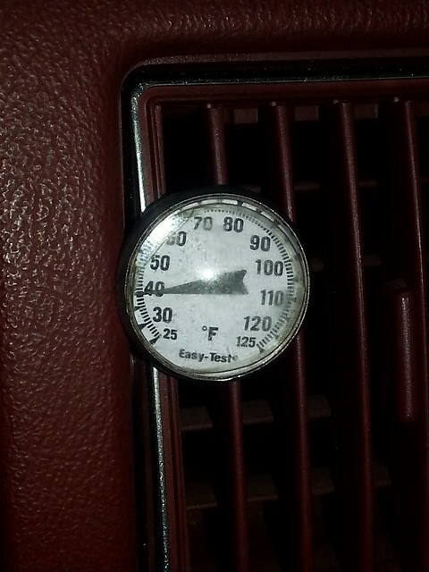

    I have A/C today! Air wasn't cold and I noticed where lines go into compressor was damp and dirt sticking
    to it. Hardest part was finding the seals. Got them changed and Mr. Walter my mentor at work vacuumed
    it down, held a vacuum so we charged it up. It is blowing cold!

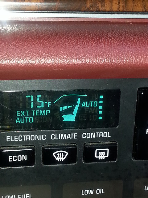

    Had to edit this, everytime I use A/C when I turn car off then start it back
    up I have to reset control head...can I assume control head bad? Don't know
    so I am guessing but if anyone has experience chime in, I'm all ears!

    Everytime I reset it, it works for a little while then it quits. The "F" for
    Ferenheight (spelling?) flashes until I reset. I found one on ebay with
    free shipping I may get. I appreciate the offer but may check the
    local yard tomorrow as I am still gathering pieces parts for my '83
    Caprice project. One things for sure I have gotten too old and fat
    not to have my A/C. Everything else has been working beautifully and
    have really enjoyed driving it all week to work.
    Well I reset it again today to show my dad it will work and get cold just a matter of figuring out if it is the control head or not, has Freon, compressor cycles so we sat outside left it running 45 minutes and worked great. I turned A/C off before shutting off car, started back up put A/C on and it still worked but I will see if it works a little while longer.

    I got another control head for my A/C but haven't had a chance to change it but noticed today it goes into the ECONOMY mode when driving and you can't switch it back to AUTO until you stop. Then the compressor kicks back on, very strange. Asked 3 different people got 3 different answers but since I got the control head I will change it since none of the 3 people I talked to about it said they really couldn't rule it out...think I will get the A/C guy at work to check it out again for me.
