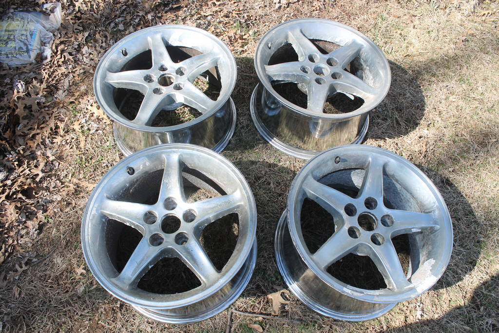

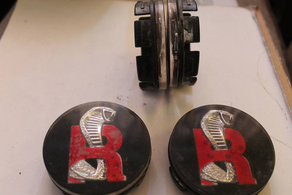

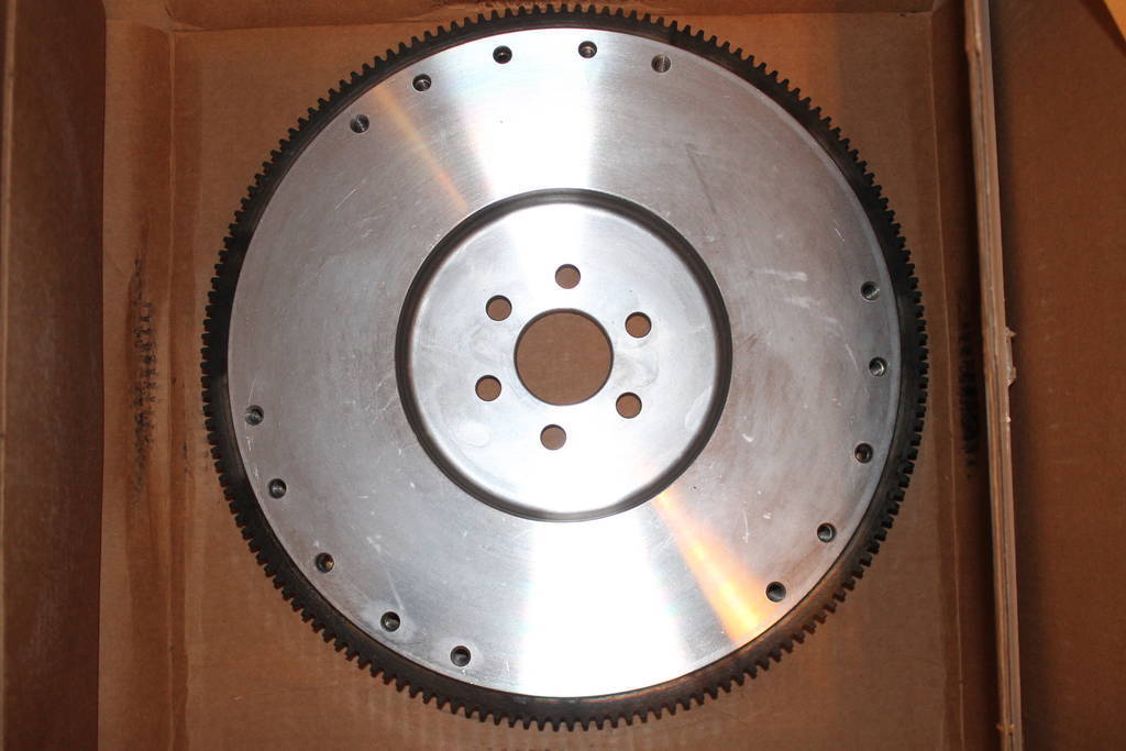

    Thinking about restoring 17x9 cobra r rims front and rear.

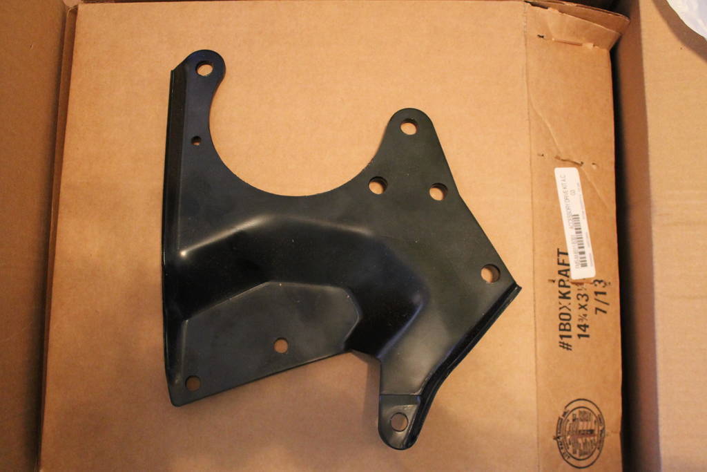

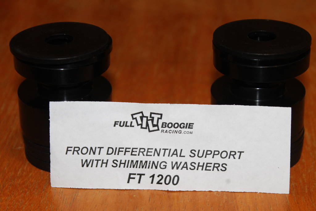

    Bought these to try and adjust pinion angle to pull driveshaft away from transmission.

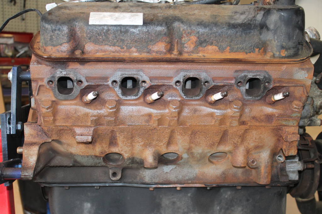

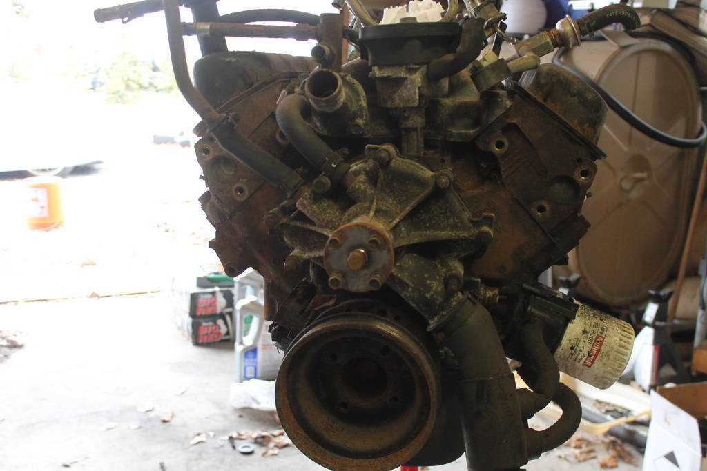

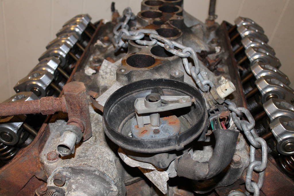

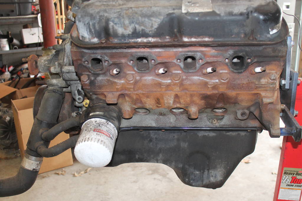

    Bought a 351 Windsor out of a 1995 lightning pickup truck. It's a roller cam block, so I am going to take advantage of a mustang cam grind. Maybe even stock 1986 speed density cam.

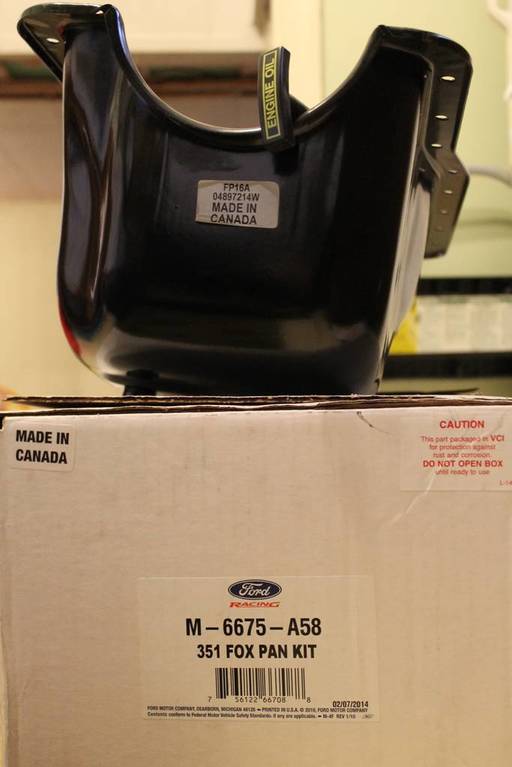

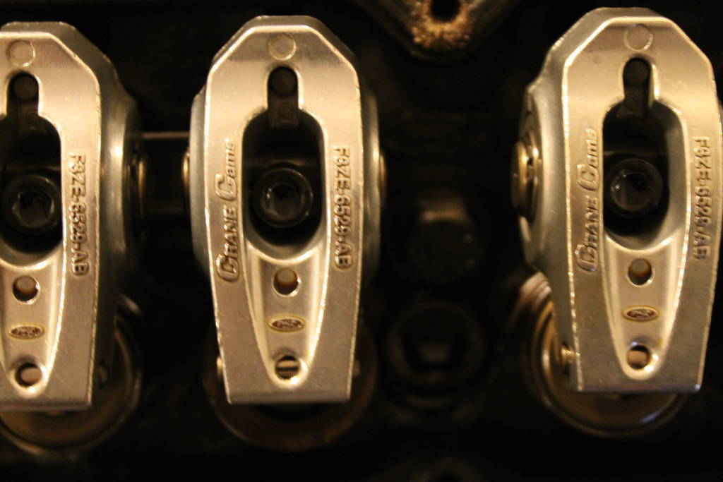

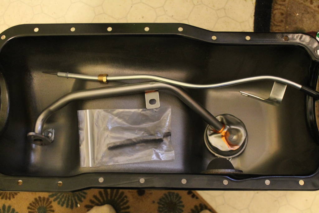

    My 351 windsor out of a 1995 Ford Lightning has Ford/Crane Cams roller rockers! In order to put a 351 windsor where a 302 windsor used to be, you need certain pieces to compensate for the fact that you now have an engine with a taller deck height, as well as a different rotating balance. I started to buy a few of those pieces.

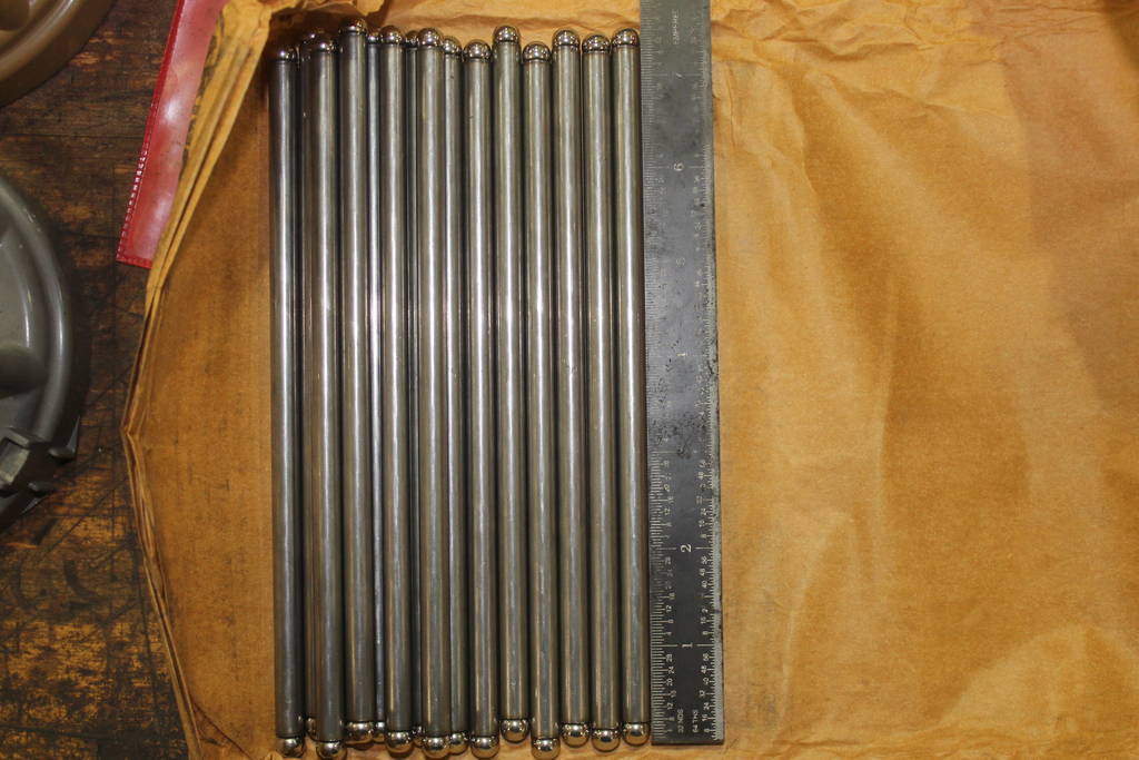

    Oh! I also started the roller cam conversion of my engine which necessitated the purchase of new pushrods.

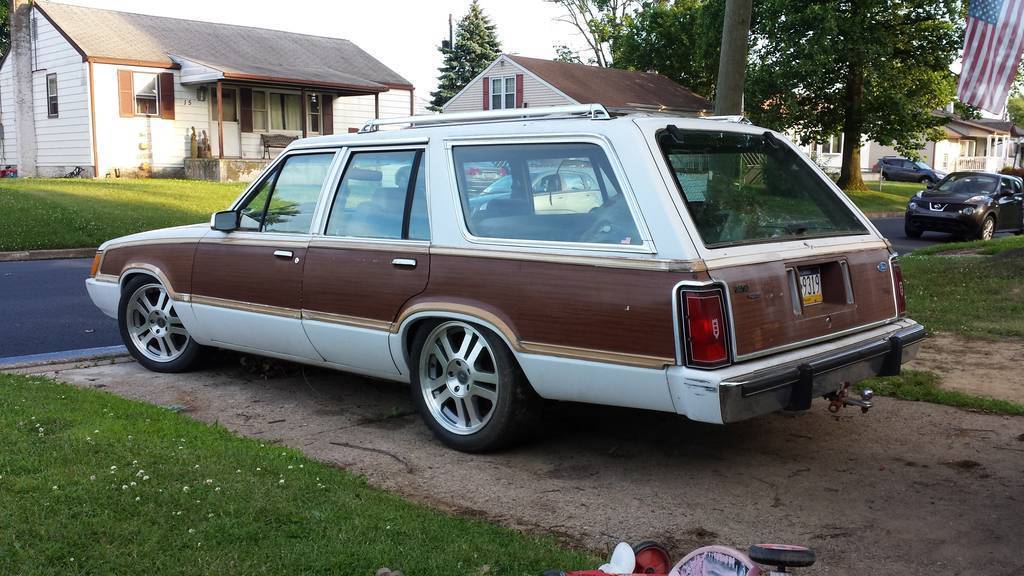

    Tires that are too tall.
    Tires that are just right.
  10. ModelT1
    1,439
    Well at least you are still working on it. :yahoo:
    Too tall? Darn those look nice on there. A Sawzall will open those wheel wells up like my 55 Chevy wagon did. Of course salt and rust started mine before I bought it.

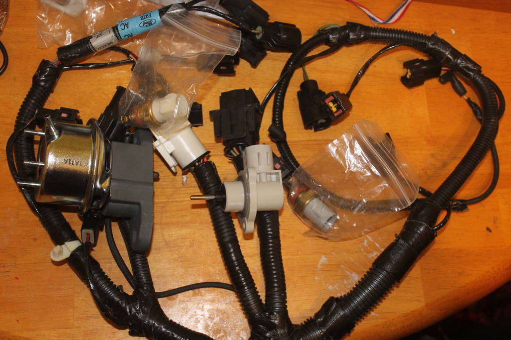

    Mustang wiring harnesses, so that I can retain emissions.

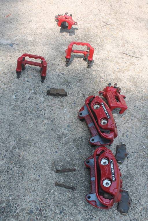

    Brake caliper paint which I laid on there a little too thick.

    That's exactly how I feel about wiring, which is why I ended up buying all of this stuff.

    I put the painted calipers on the car.
