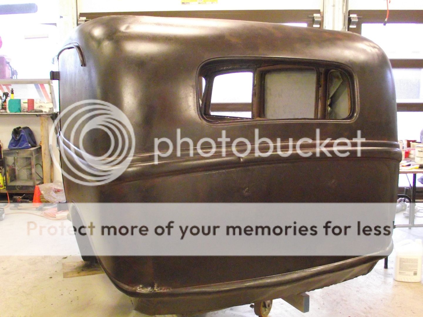

    Once the rust has tacked up, its time to give it a coat of semi gloss black and also gloss blacks.
    Again, a roller in one hand and a bunched up rag in the other, the paint is applied and the rag is rolled over the wet layer to blend in and remove the extra at the same time. The semi gloss and gloss are randomly put over the surface after a partail reduction to allow it to be thinner. Even distribution of paint isnt wanted here, just enough to deaden the under colours. Stay out of wells and away from high spots.
    The next day I'll finnish up by bringing out those open metal highlights.

    Stage 6
    a light scuff with a brillo pad where the silver was placed brings out the worn areas.
    outside with a little spring sunshine upon it.

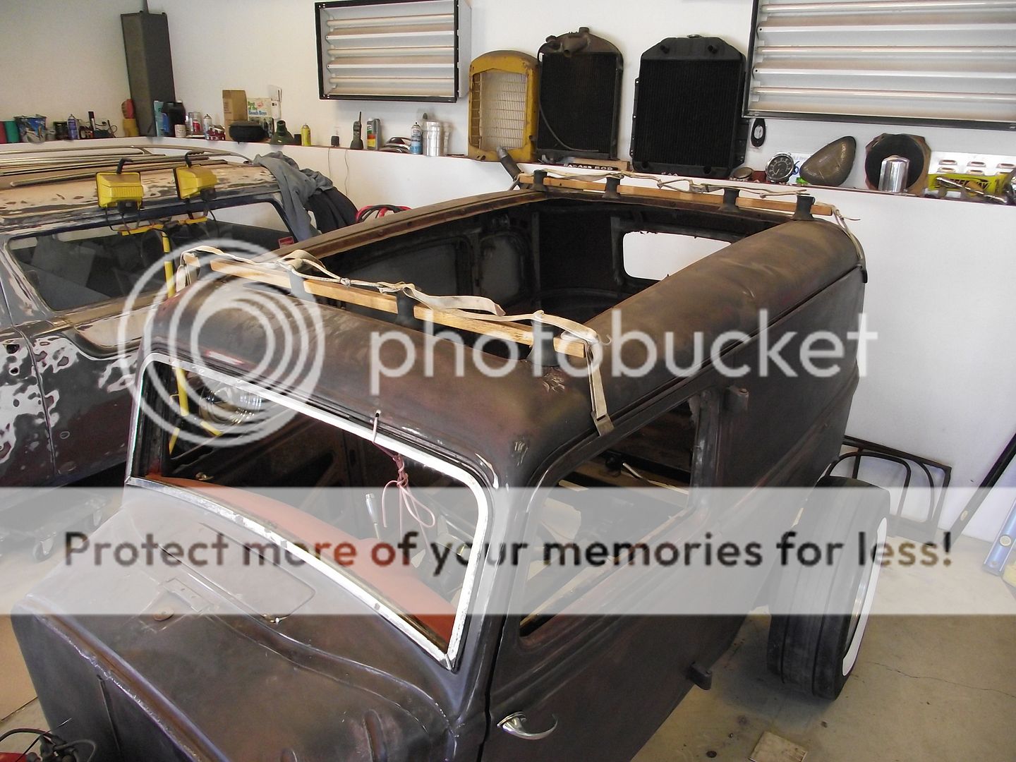

    So that kinda brings it up to where it is today.
    I've been busy focused on the 57 Ford wagon so she's taking a bit ofa rest. I've added a couple things though that will keep with the Tiki theme.
    a rad ornament..
    roof racks...
    And a friend is making me 2, 11 foot long boards which will make up the greatest coverage for the roof. It should look something like this...
    They should look something like this;
    Like I say, Oddball all the way. And just plain fun to build with no limitations or rules to follow. I call it colouring outside the lines. :tiphat:

    But then there's also the roof filler...
    Hmmmmmmmmmmmmmmm.........................
    that's just a few of them. I need to sew these into the steel and then fill it in completely.
    :banana: It's all about having fun.
