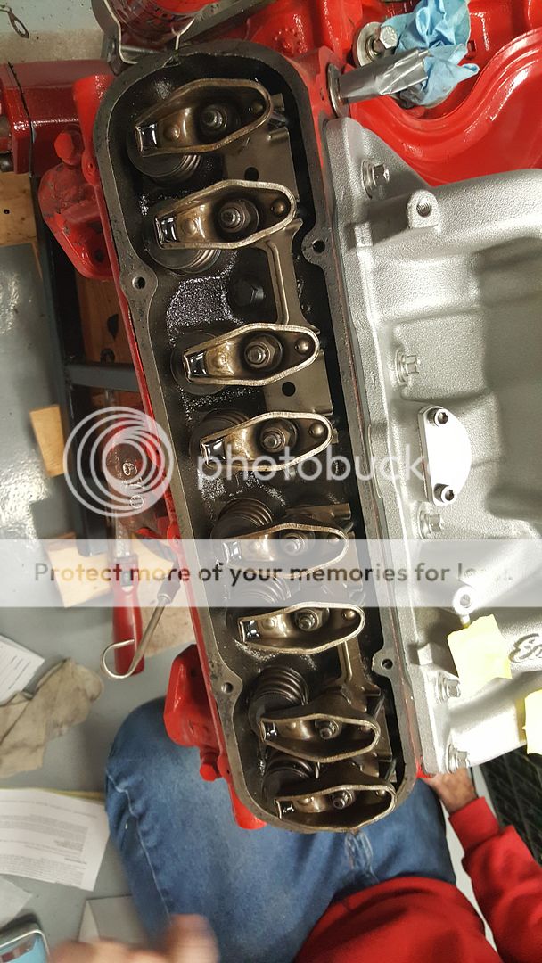

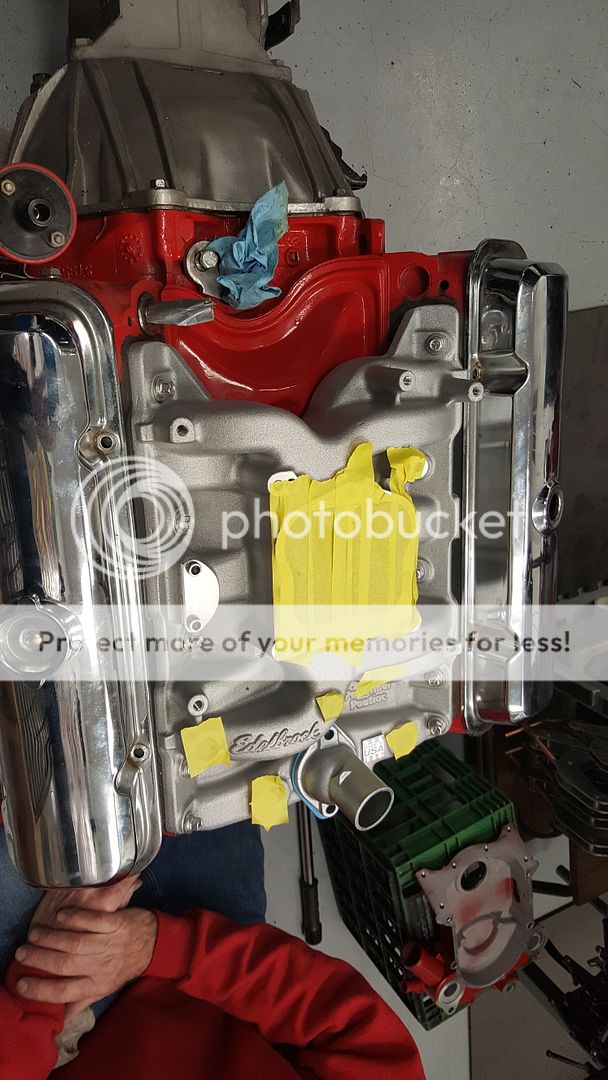

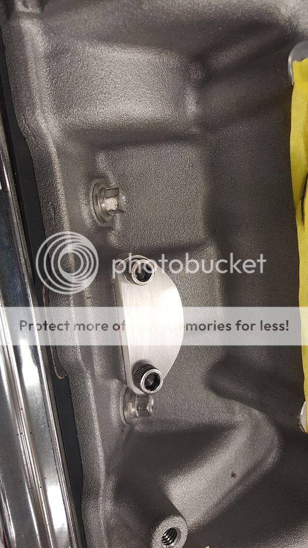

    He CNC'ed a few block off ports for my intake
    New intake is installed. He didn't want to get any skin oil on the intake, and make any smudges. He literally bought a new pair of white gloves to use while handling the intake. He cleared it with some high temp clear, to make it easy to clean in the future
    Looks pretty clean. Head studs are a plus

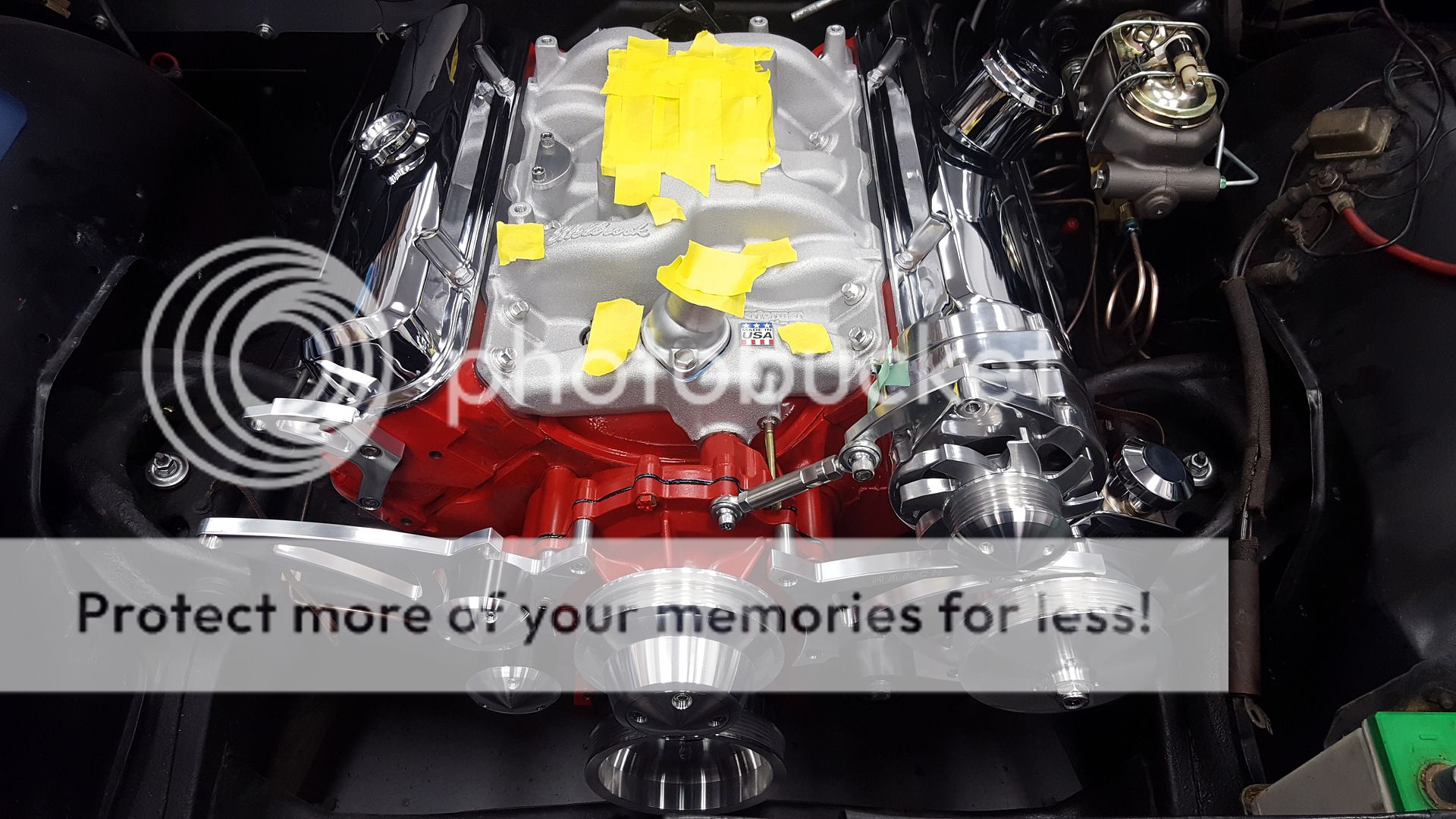

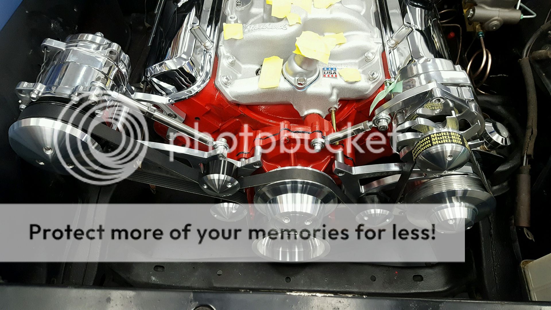

    Engine and 4 speed are back in the car. Exhaust is hooked up. March serpentine system is going on. Valve covers have been super polished and look better than new

    Serpentine setup....AC compressor is installed. Looking great :)

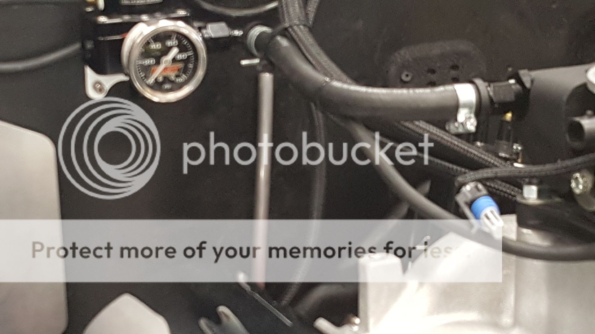

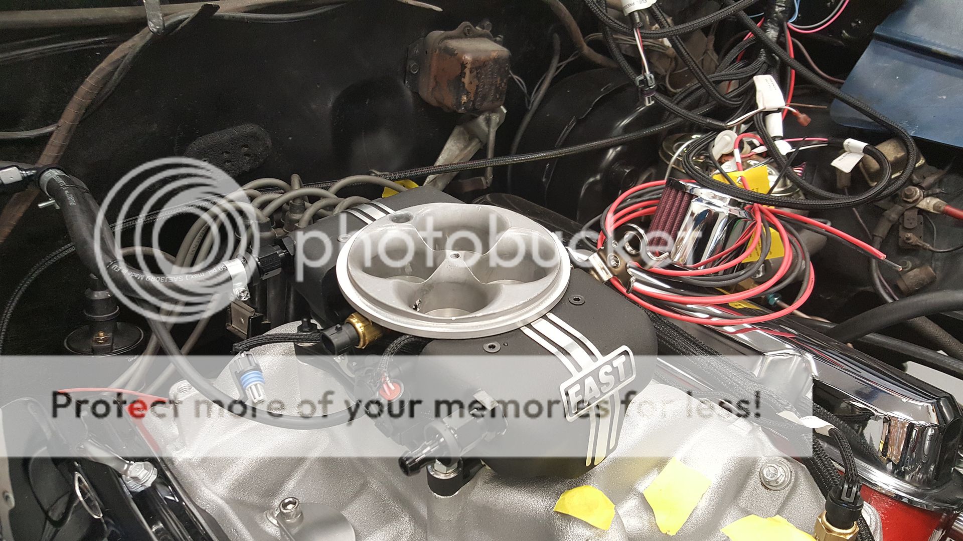

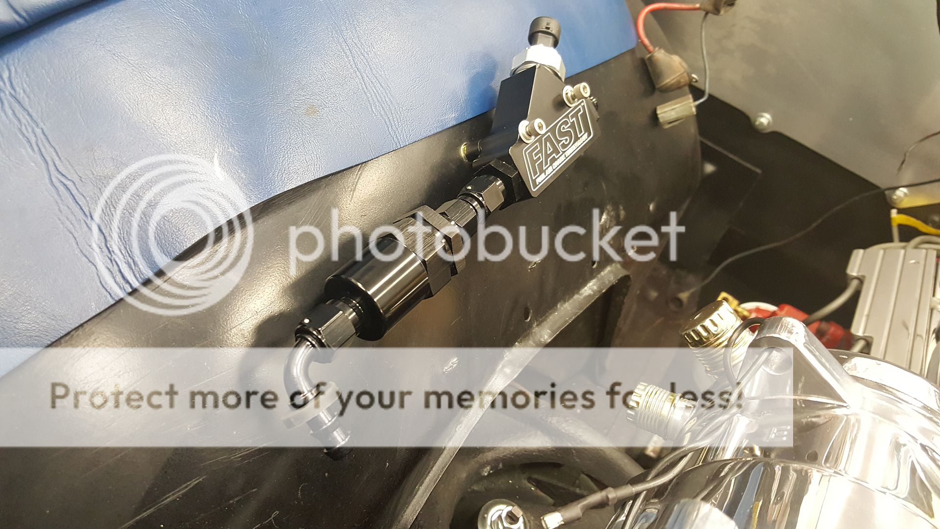

    EFI is going in. Fuel pressure sensor on the right. Round cylinder on the left is the fuel filter.
    This of course is the throttle body
    vacuum referenced fuel pressure regulator
    Shiny plug wire covers (came with the motor)

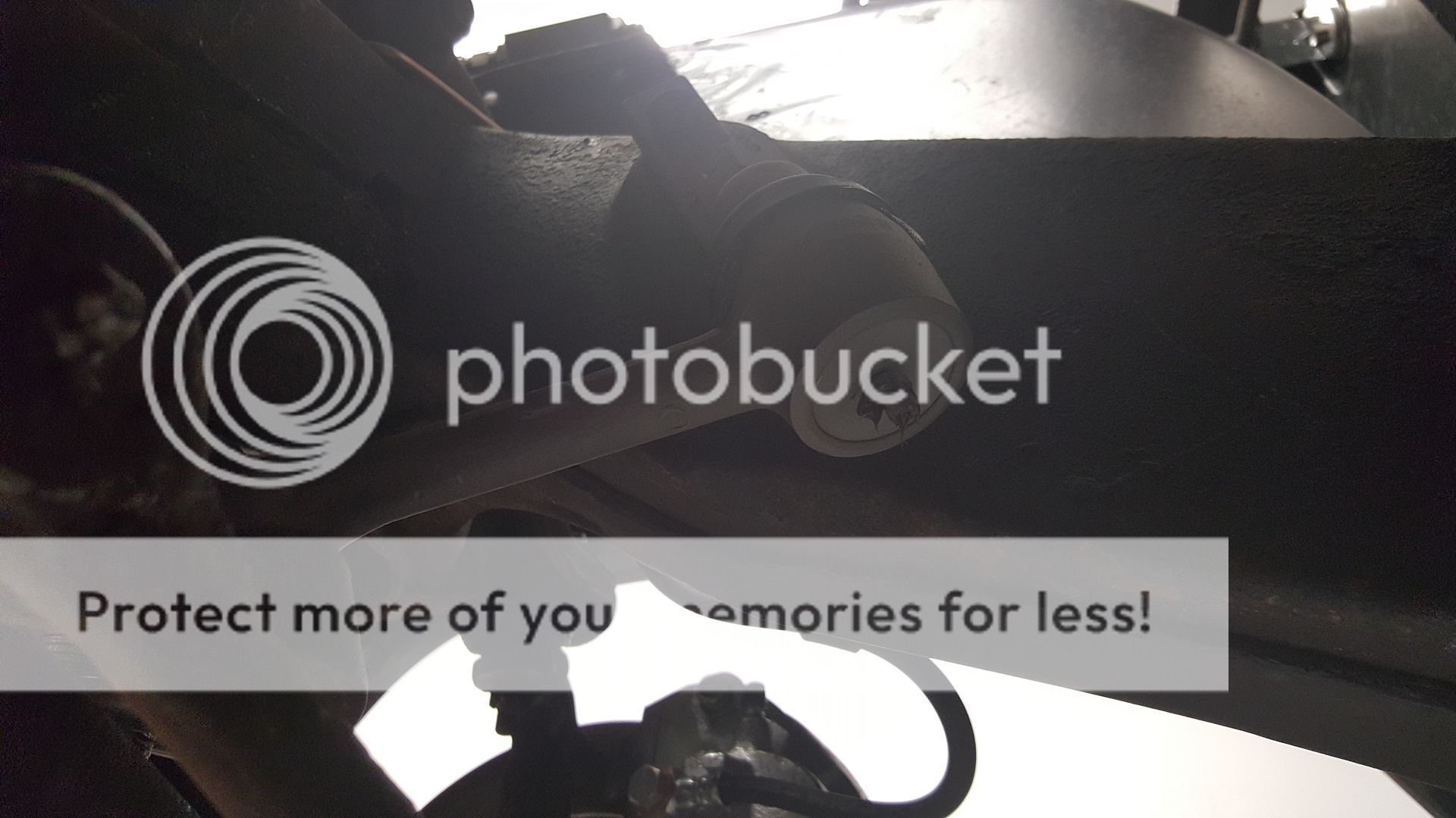

    New ball joints
    New pitman arm

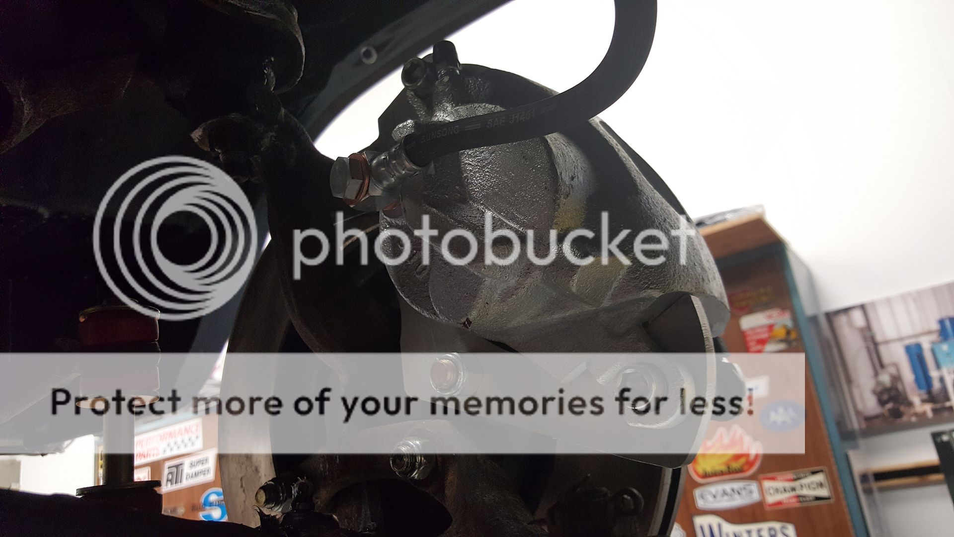

    I dont think I've taken a shot of the back of the disc brake swap...

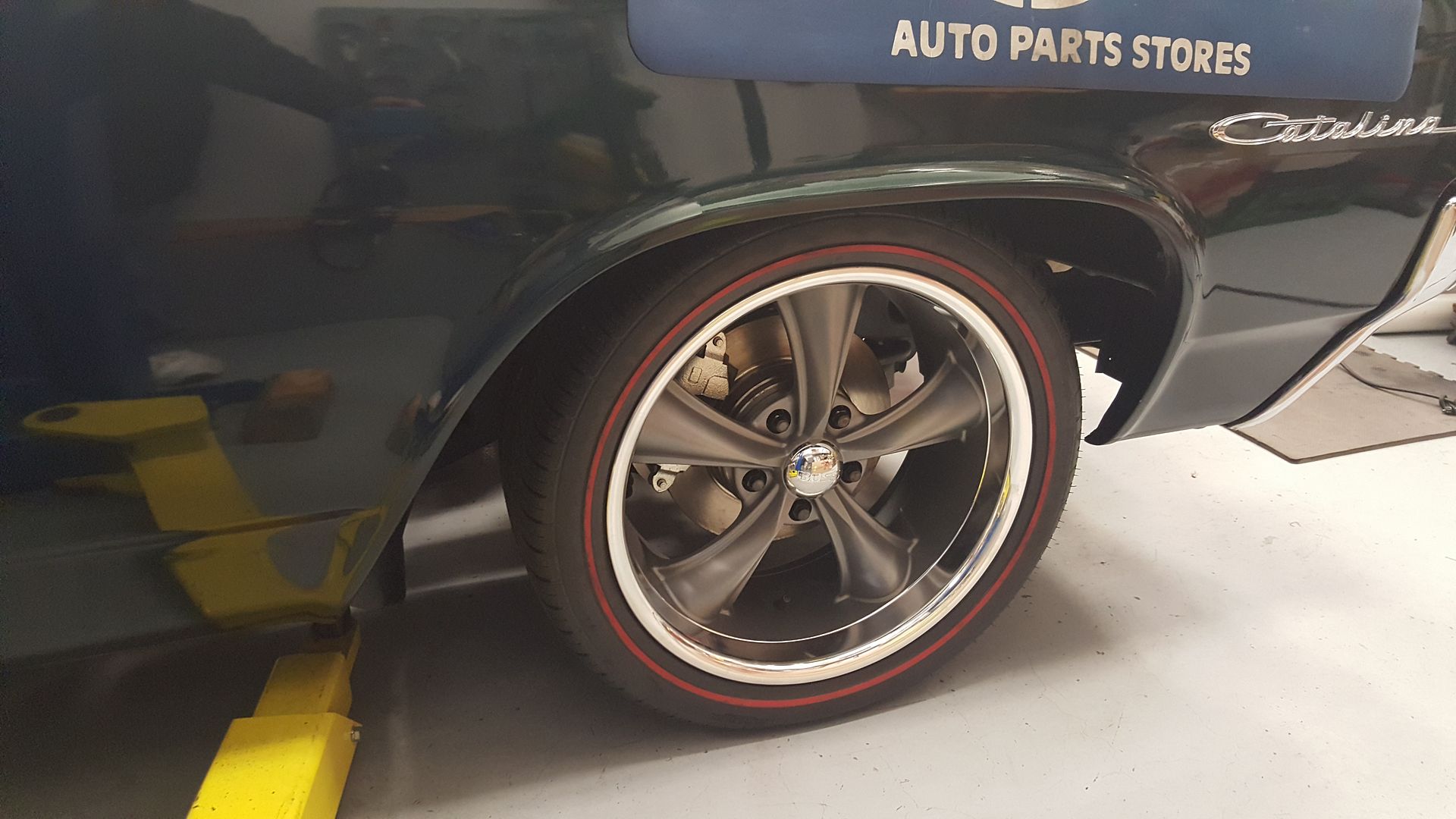

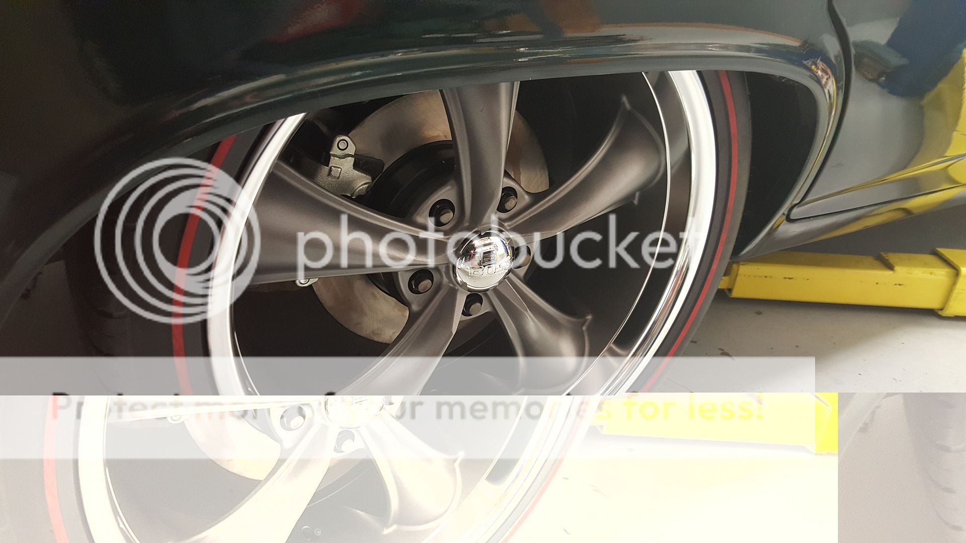

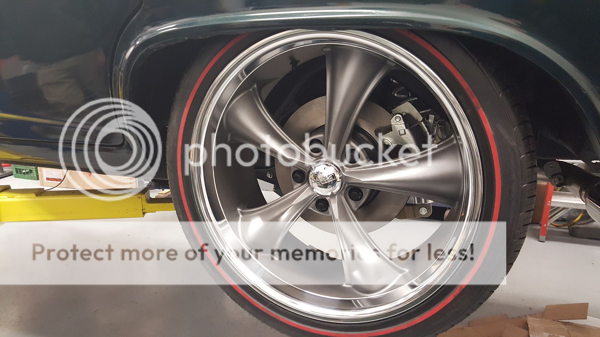

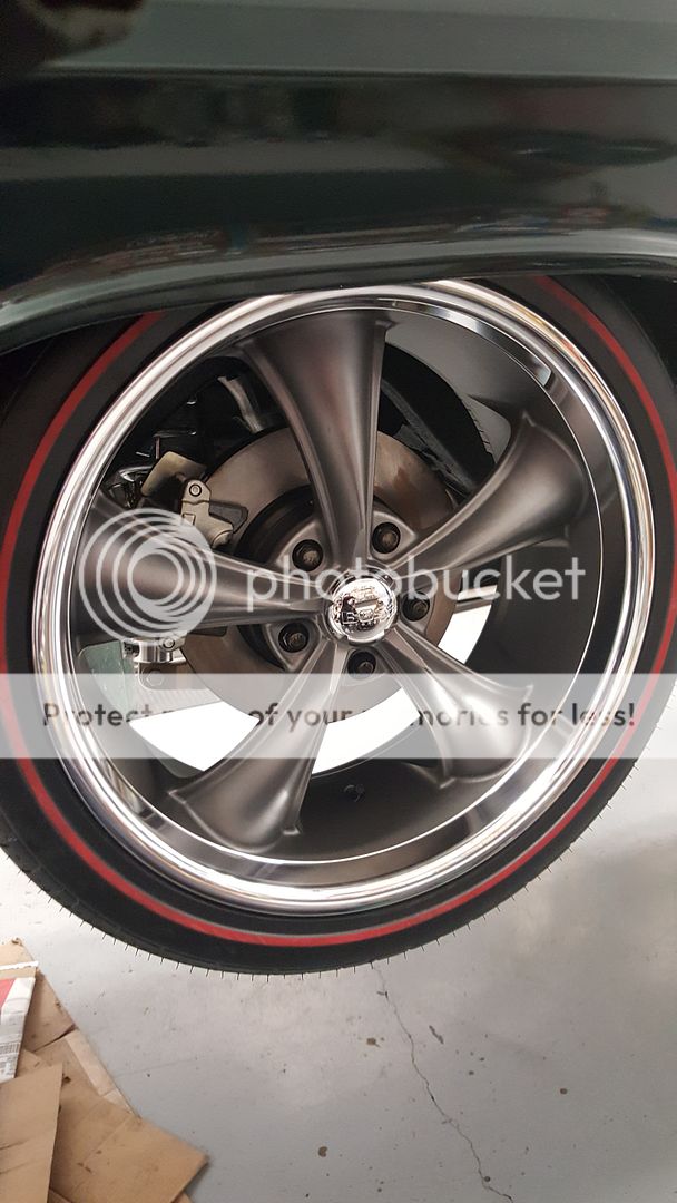

    New wheels! They fit! Same size (18x8 front with 4.5"BS and 20x8.5 rear with 5.25" BS instead of 4.75" BS on the other wheels.)

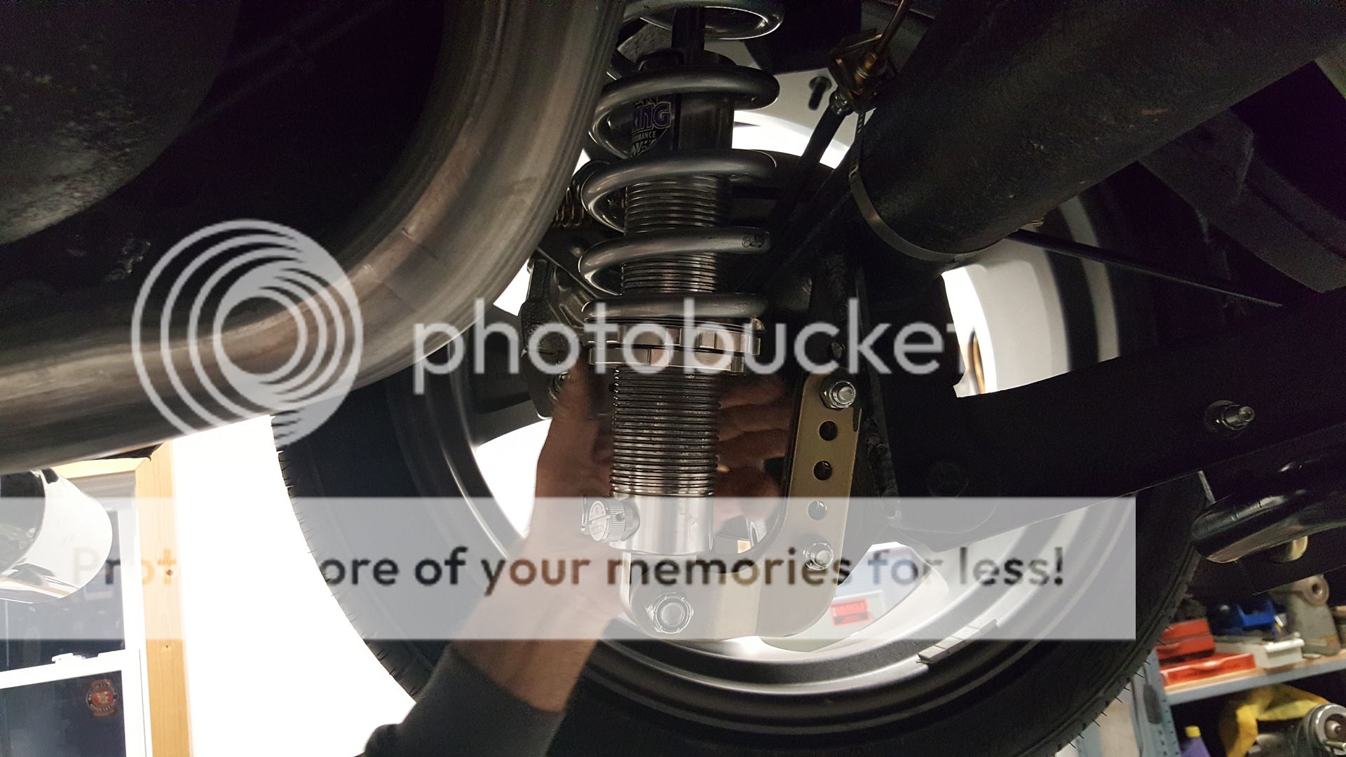

    Adjusting the rearof the car up a tad. 1 Turn on the coilovers seems to equate to 3/8"
    The car is pretty level now. Once the radiator/water/hood etc are installed, it should be about dead nuts on

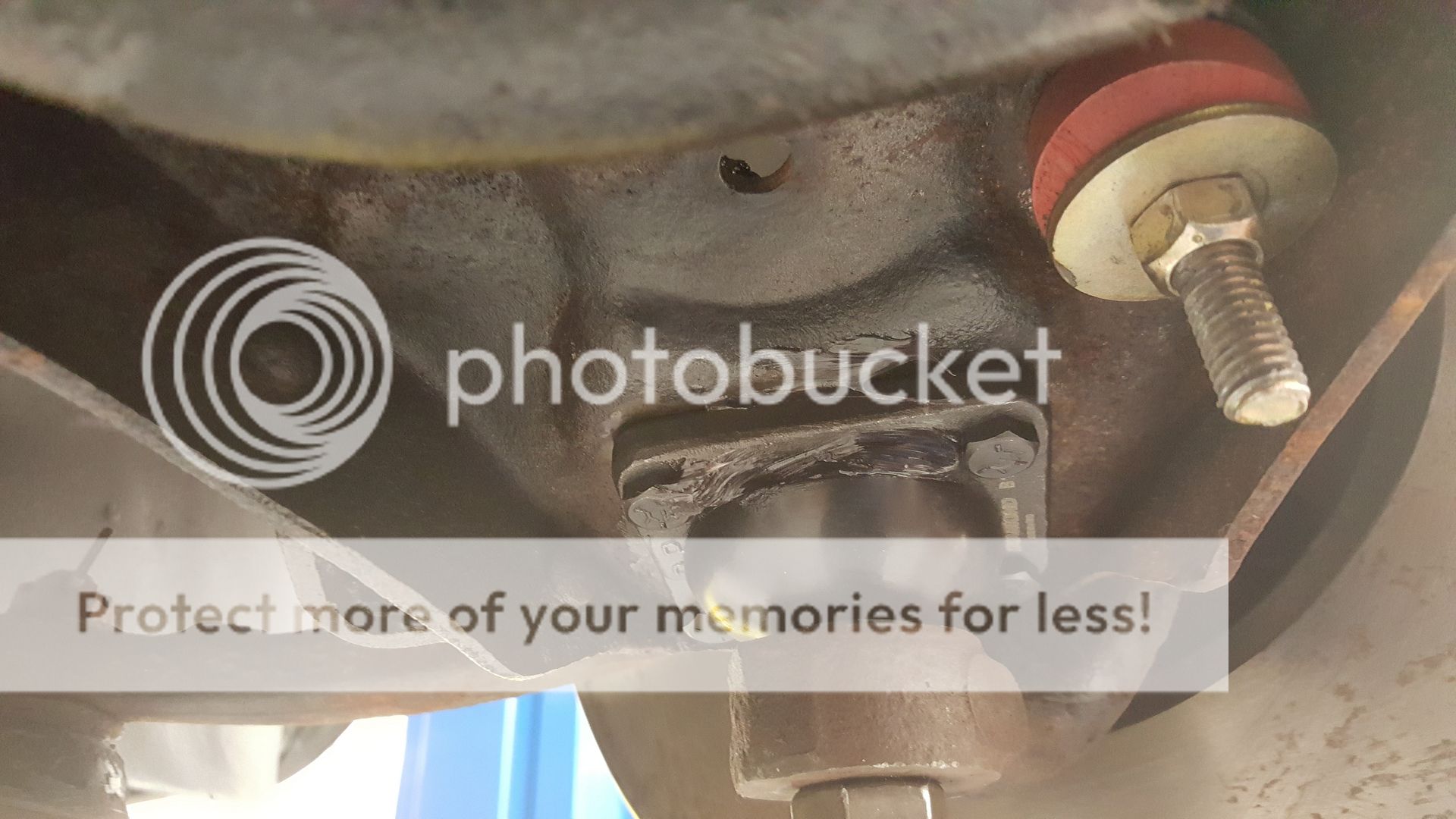

    Fuel pump block off plate

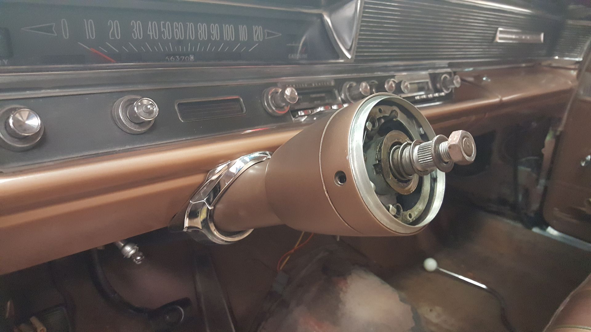

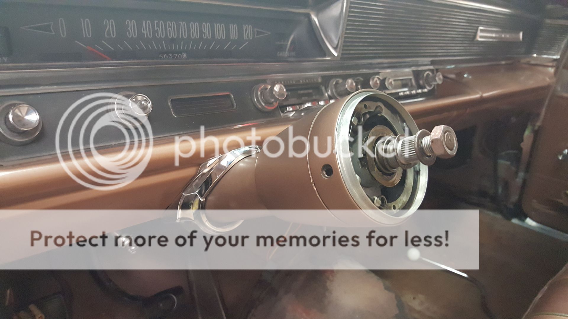

    New column installed. Nothing wrong with the stock column, but its not "correct" for a floor shift 4 speed car, to have an auto column in it. My OCD costs me lots of money sometimes. This column alone was $250 since they are so hard to find :(

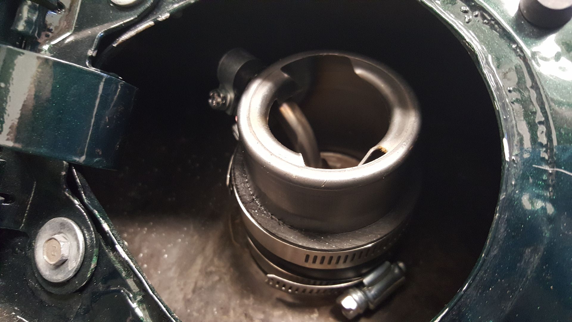

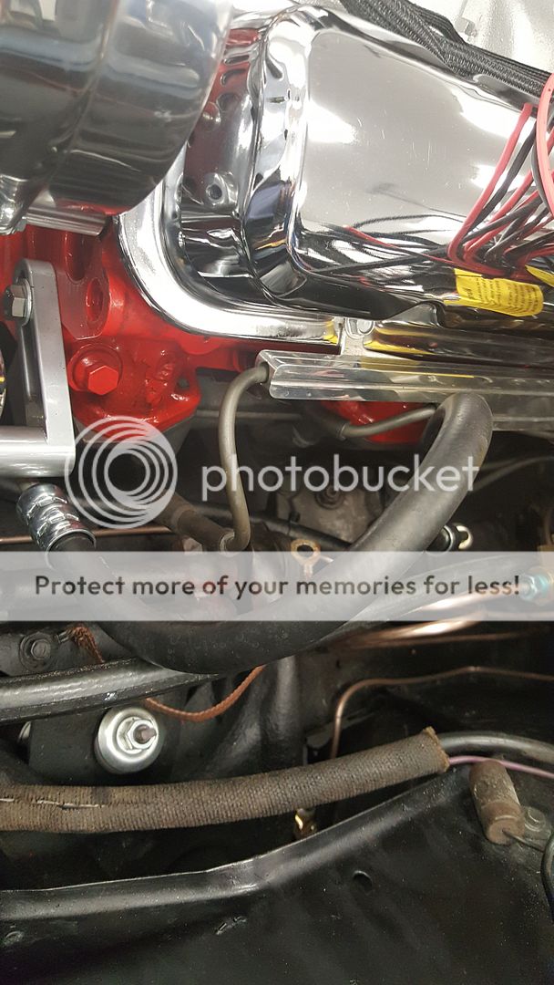

    This is the return fuel line from the EFI. I forgot to take a pic of how this will work. My buddy found a rubber collar and a couple inches of filler neck to put over the stock neck, and it will allow him to TIG weld a nipple to it, put the hose on, and the return fuel flows back down into the tank. Hard to find a better solution as there is no room under the car for a universal tank, and literally nobody makes a replacement. Thats why I had to pay a thousand damn dollars to refinish the stock one.

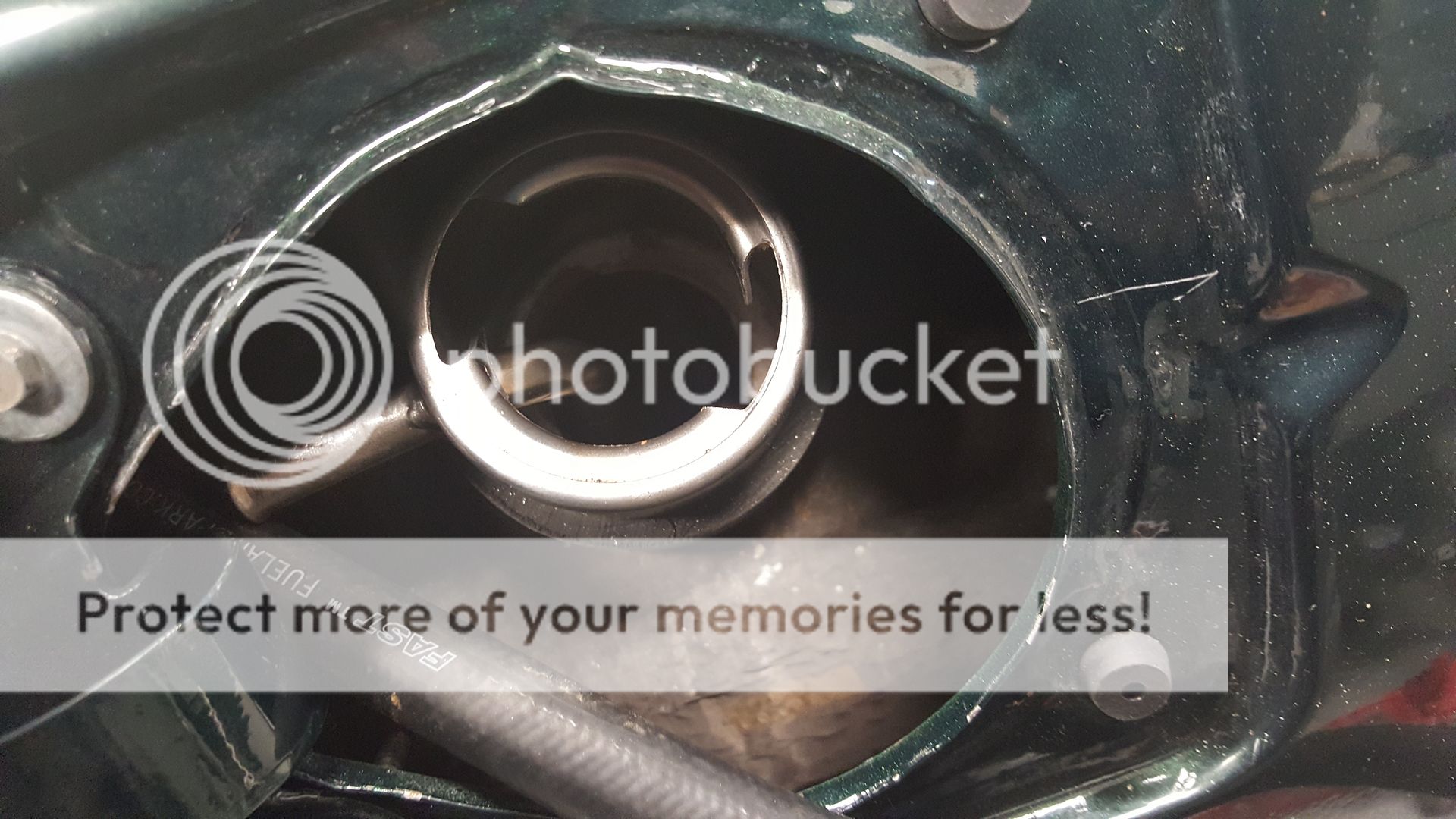

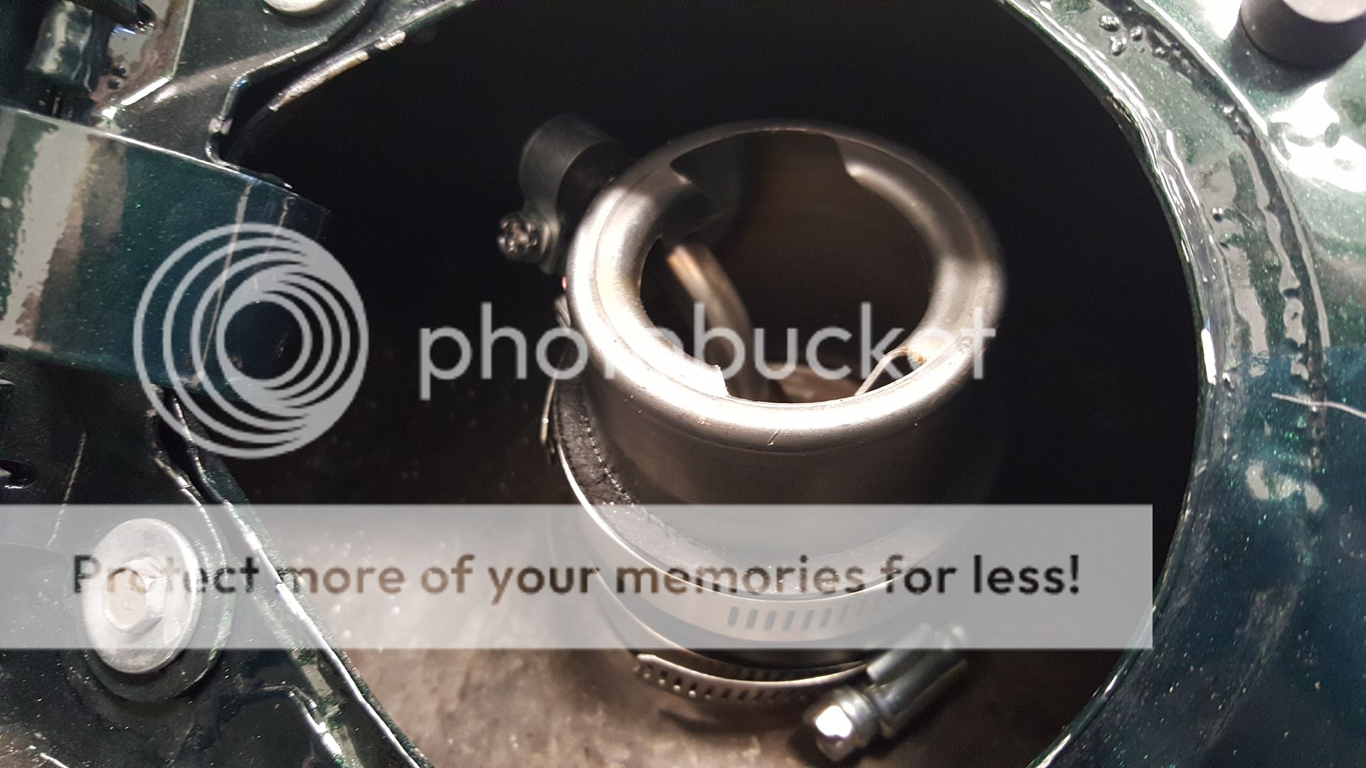

    Now to elaborate on this random fuel line
    It is the return fuel line for my EFI. It works like this. You remove the factory gas cap, and install this over the fuel filler neck
    It is a fill neck extension, held by hose clamps. It provides a return fuel hose where unused fuel will be recycled back into the tank.

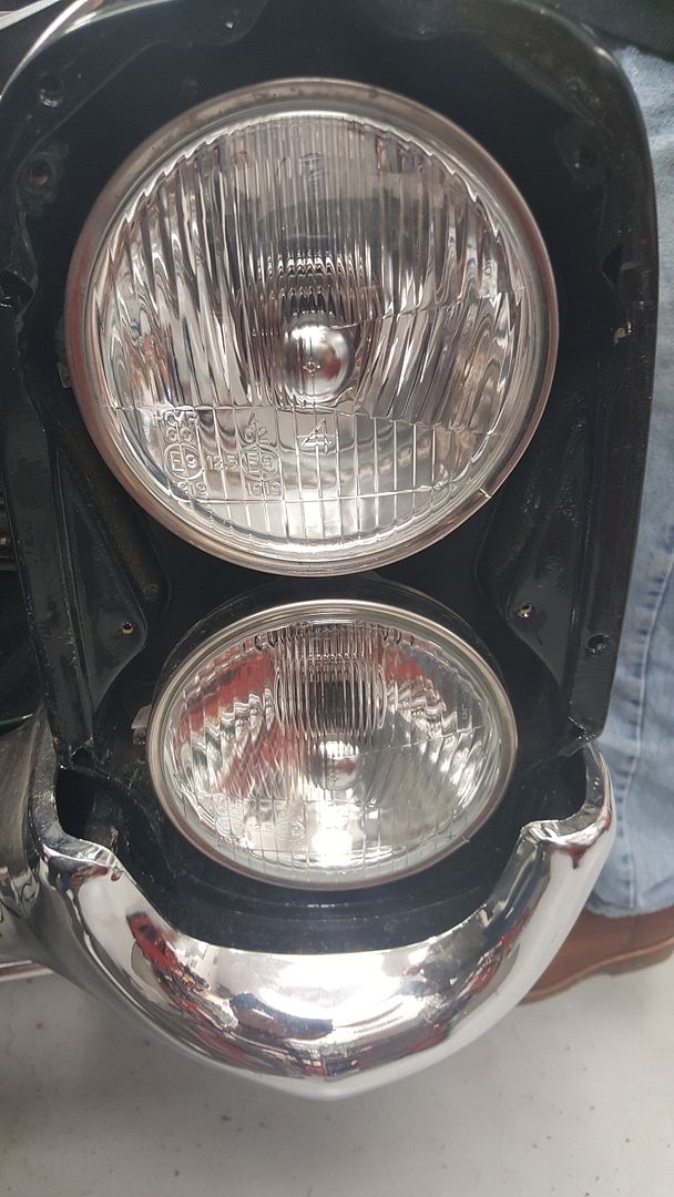

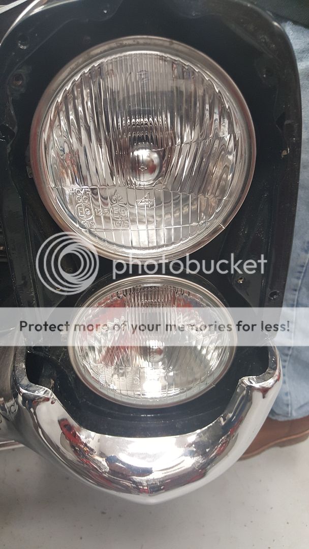

    HID headlights are in and temporarily wired

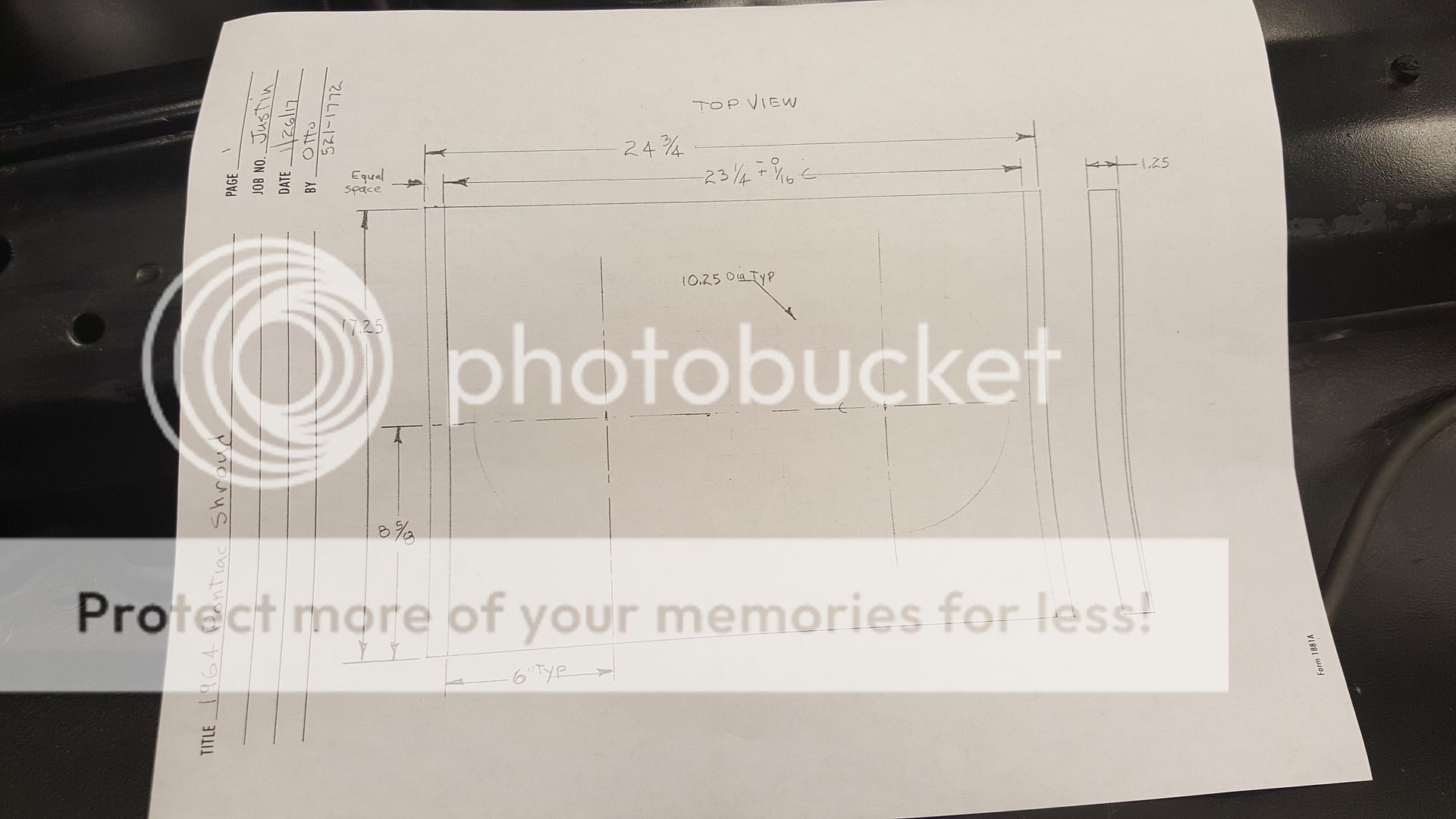

    Here are plans for a custom fan shroud for my dual 10" fans

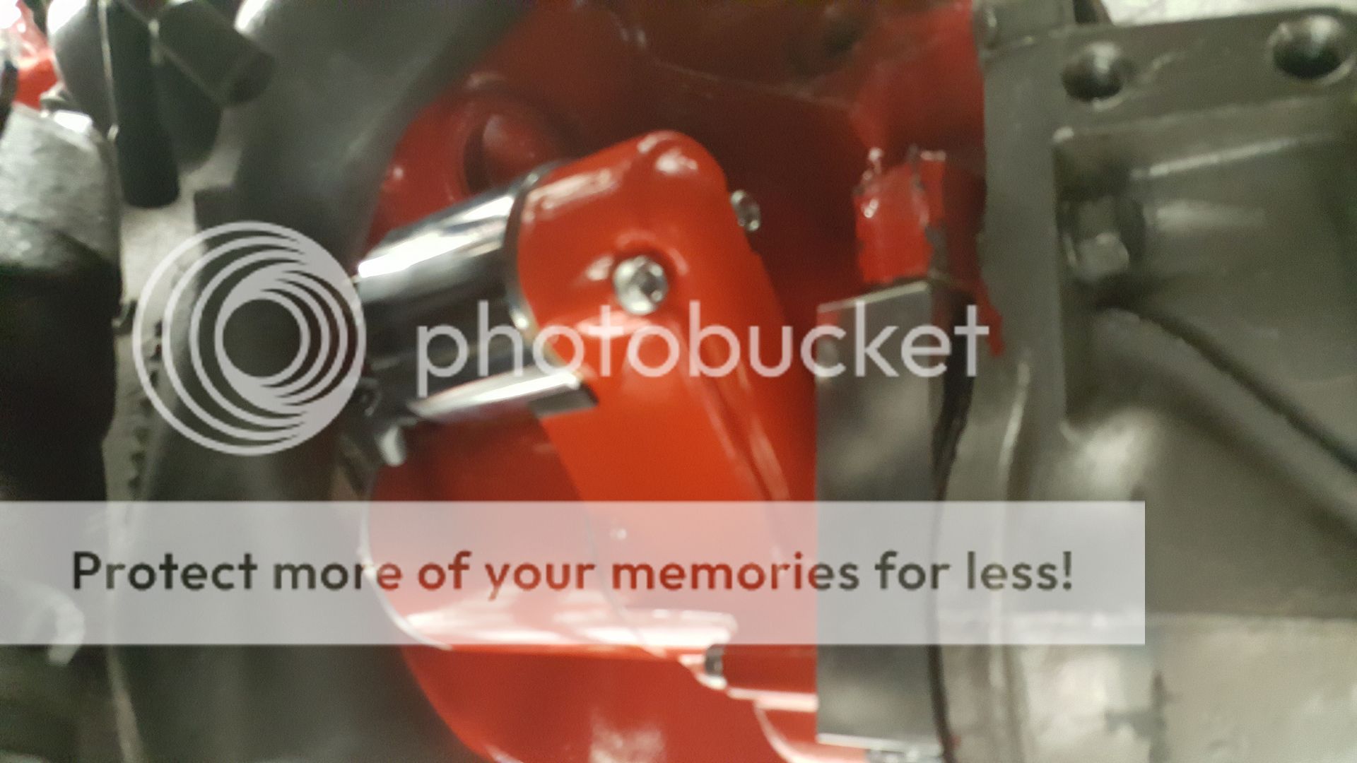

    MSD Mini Starter installed

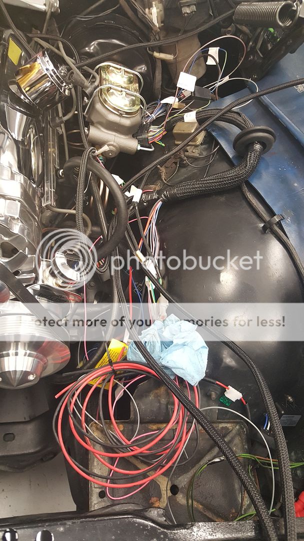

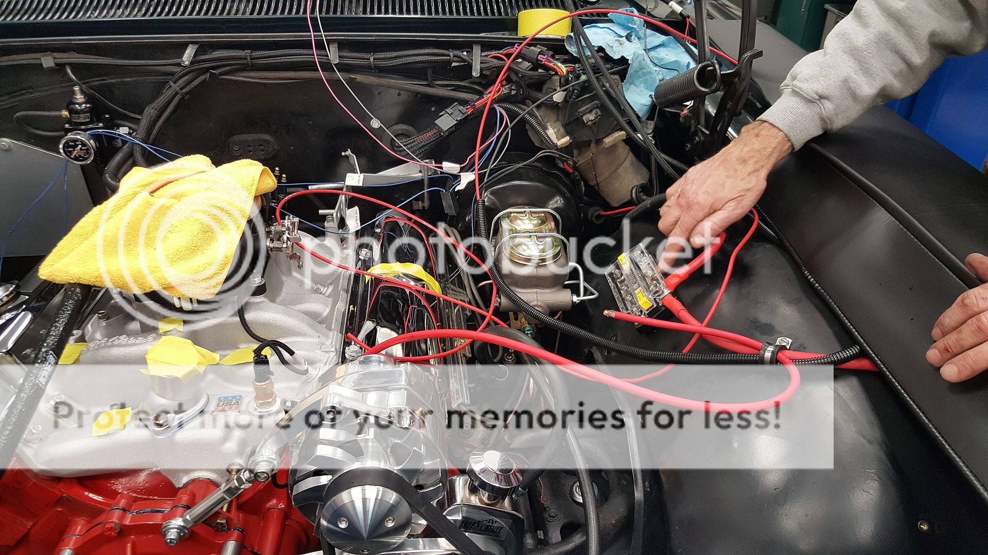

    More efi wiring progress/mess

    Wiring lol
    Computer mounted under the dash
    Wiring is being routed

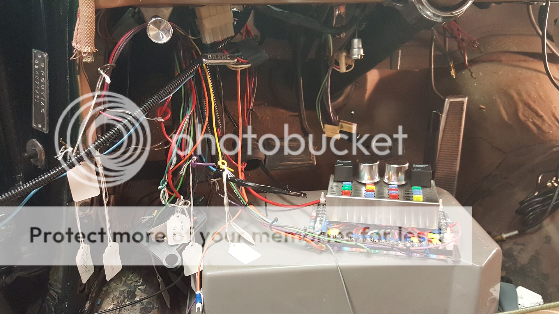

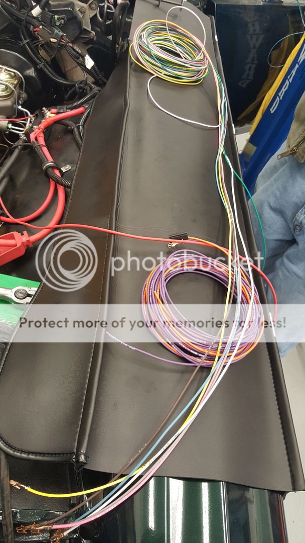

    New wiring system recommends larger positive and negative cables.
    distribution block
    the wiring is turning out nice. you can see the main loom going through the firewall

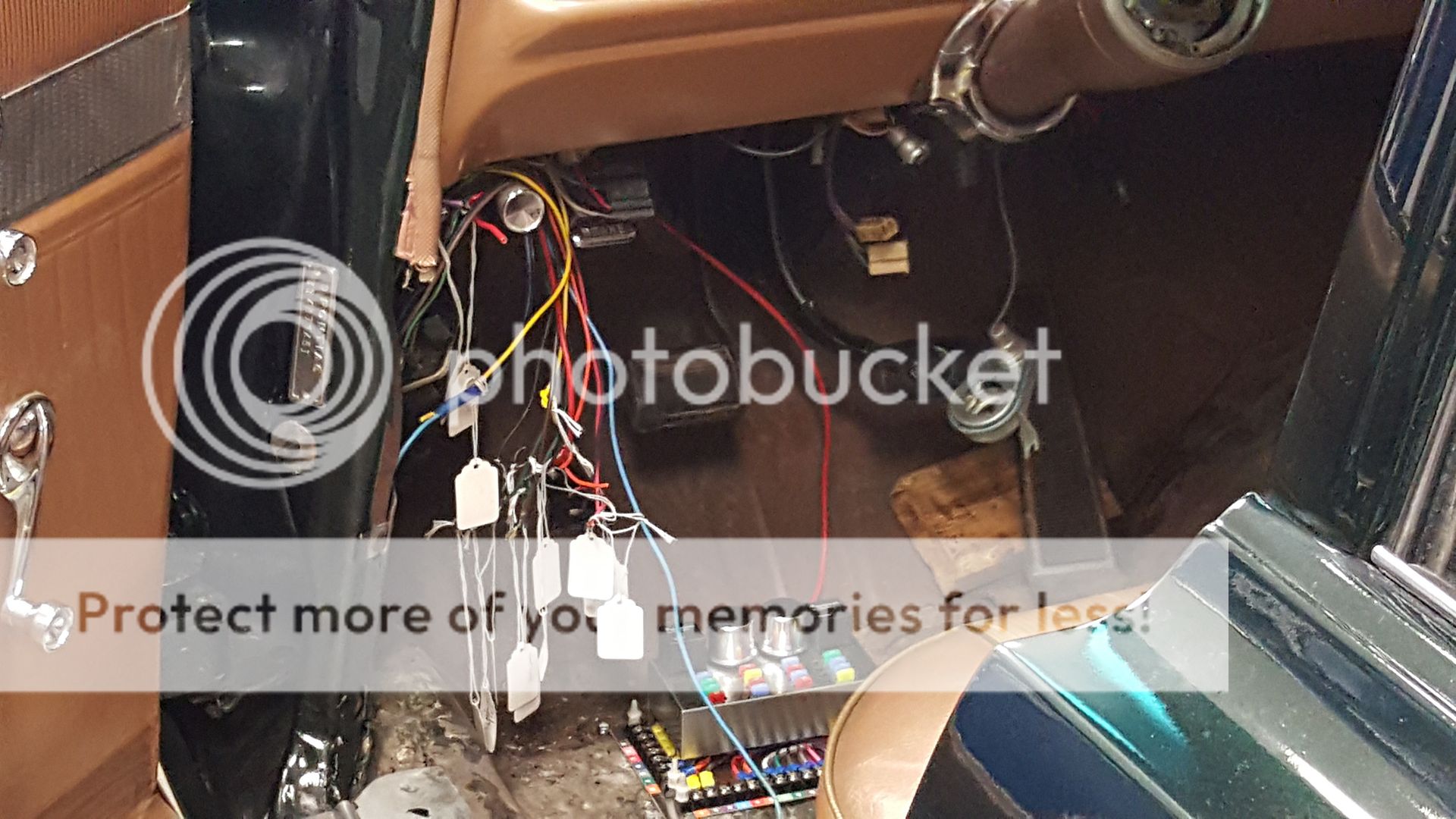

    Here is the new main fuse panel. you can see all the wires hanging down, labeled.

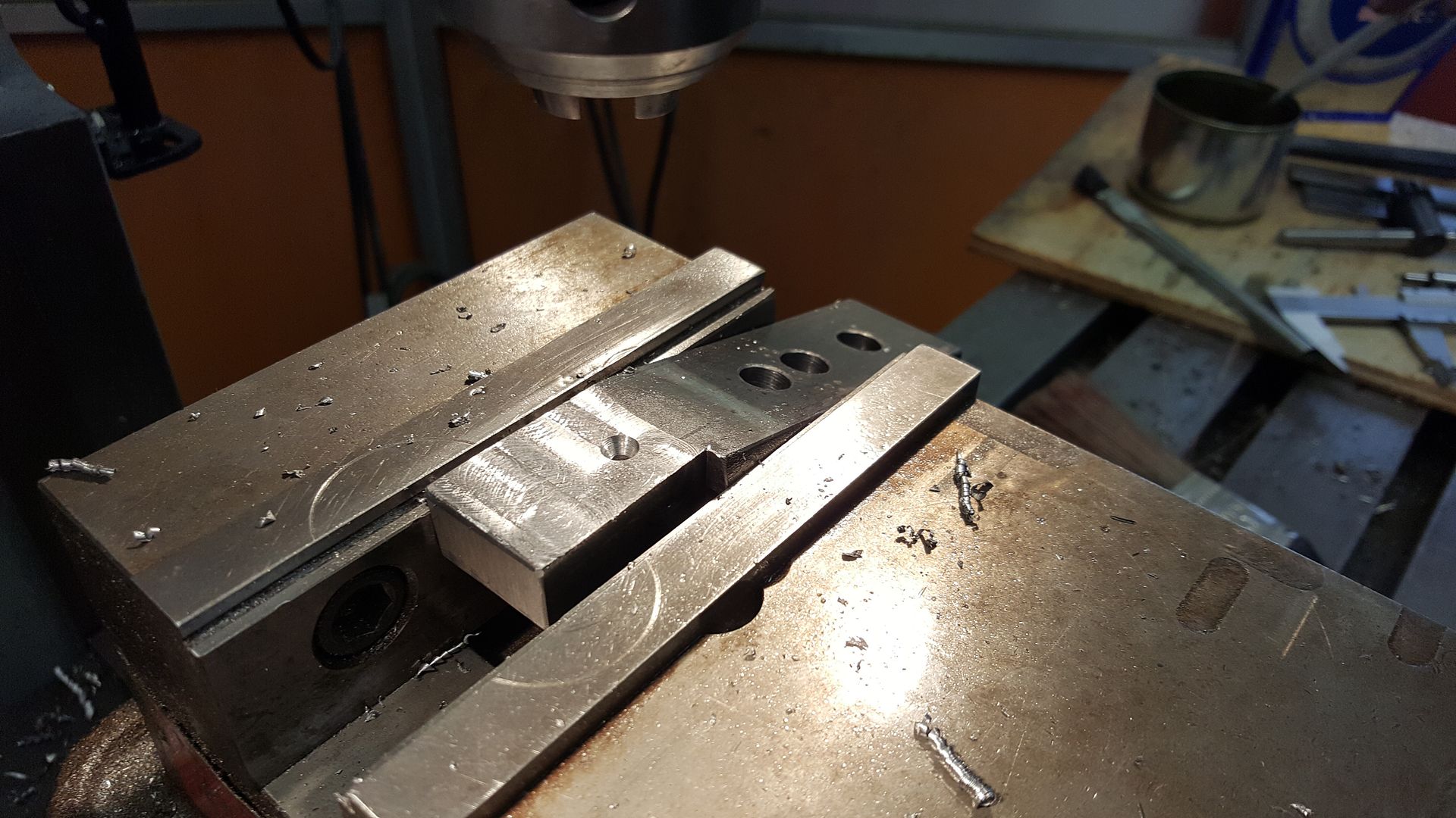

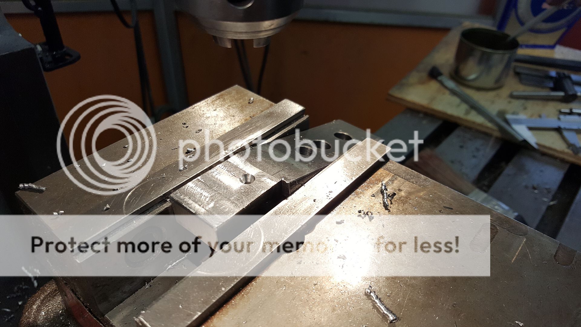

    Here is the start of a custom clutch linkage bracket. He was in the middle of making this when I showed up today.
    Sorry it looks like it was filmed on a Potato. Otto is a very talented man and has all the right tools for this kind of work

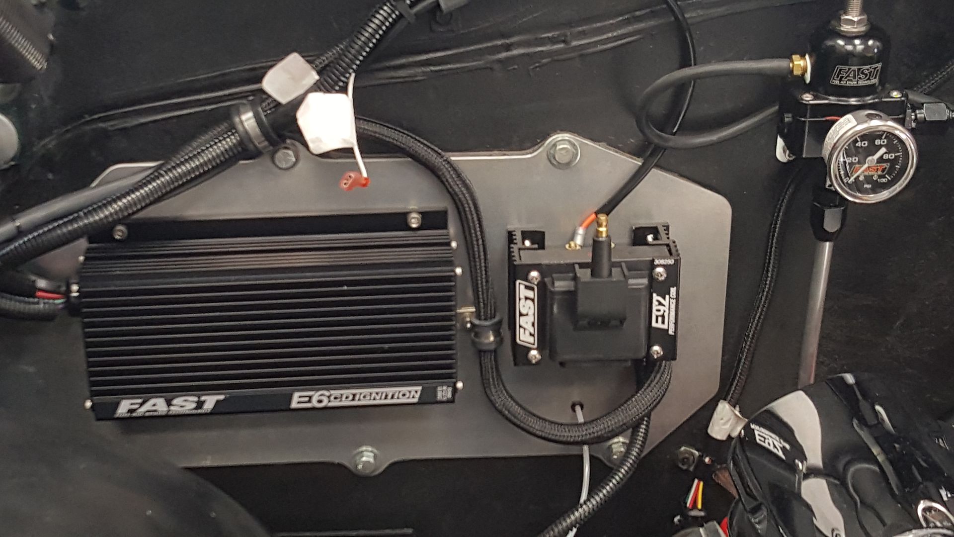

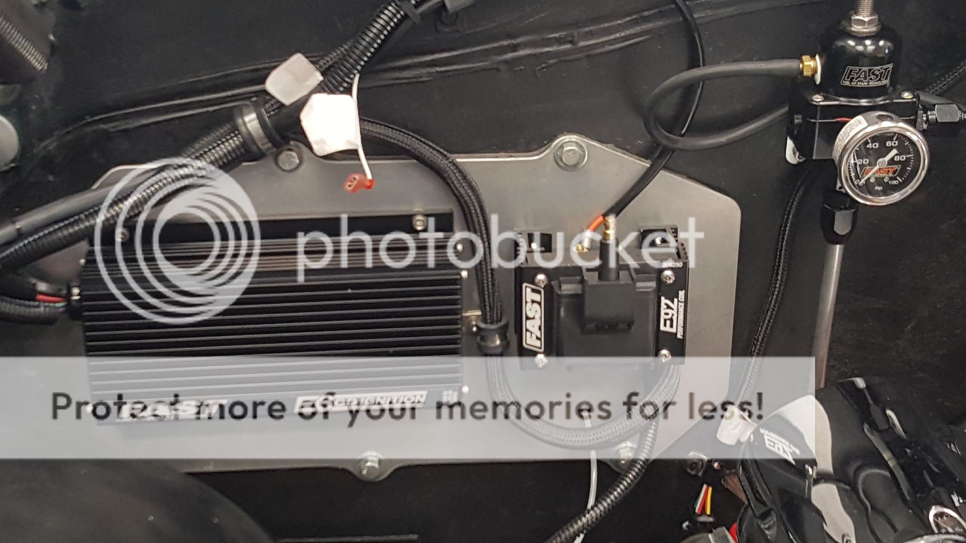

    Ignition box and coil are mounted on the heater delete box

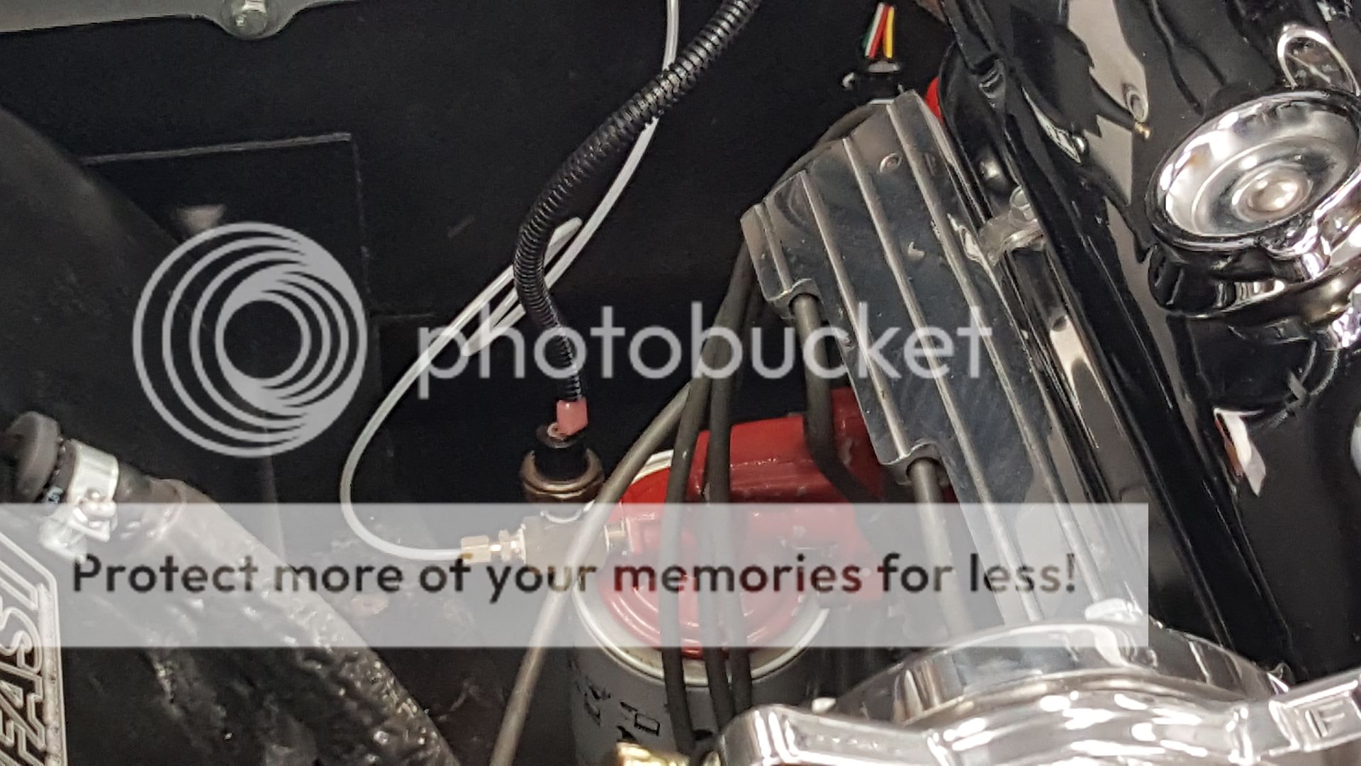

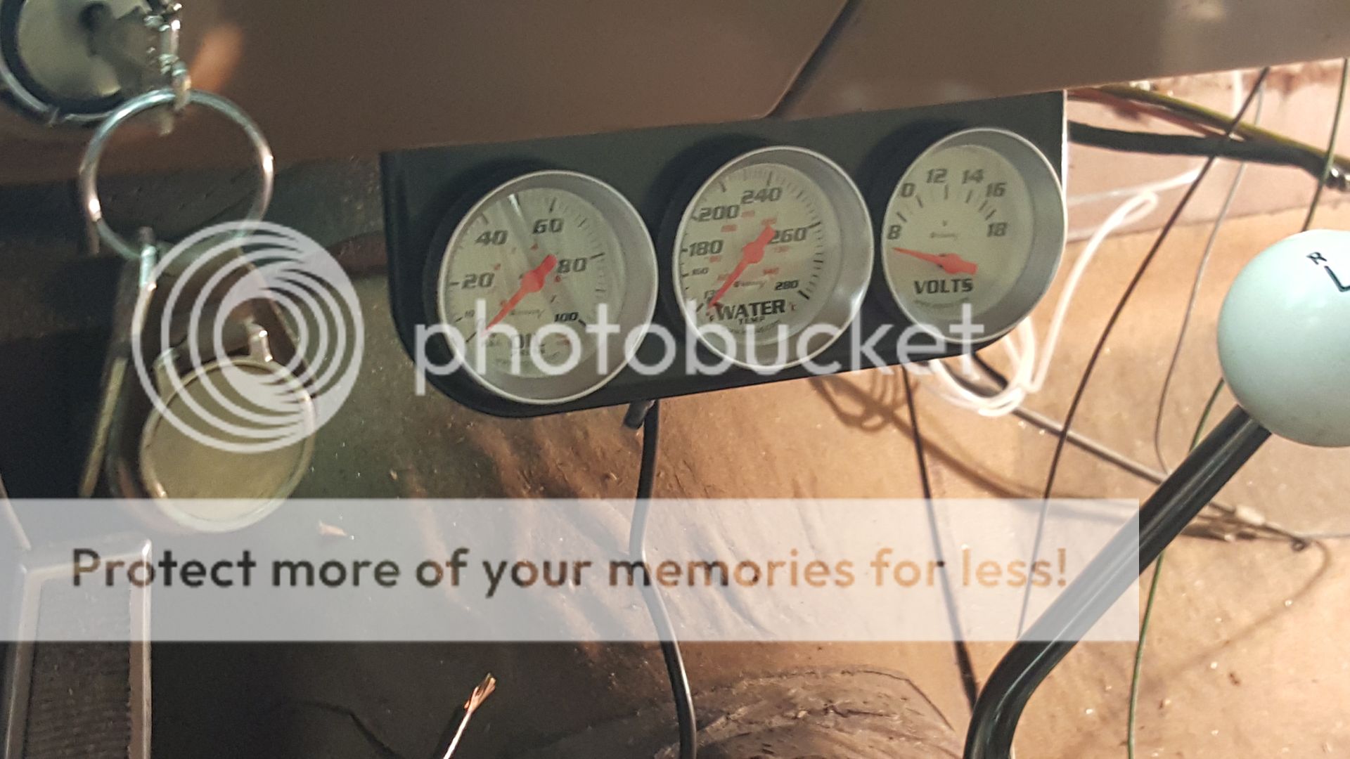

    Oil pressure gauge supply line. One day I will replace the gauges with Autometer that have electrical senders.
    Less and less wires! I believe these are for the rear of the car (lights, etc) and will be left for the upholstery shop once they tear it apart

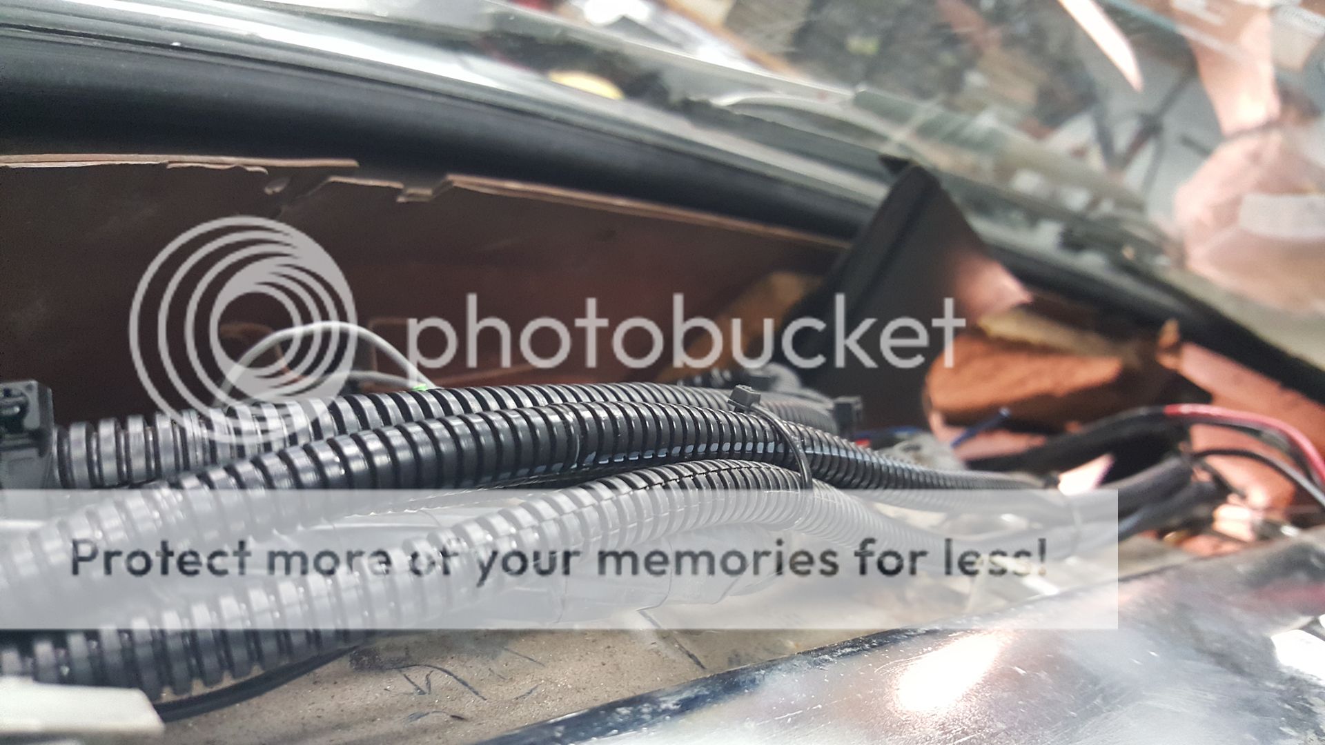

    Loomed up under the dash pad. Found some scary previous repairs that needed to be fixed.

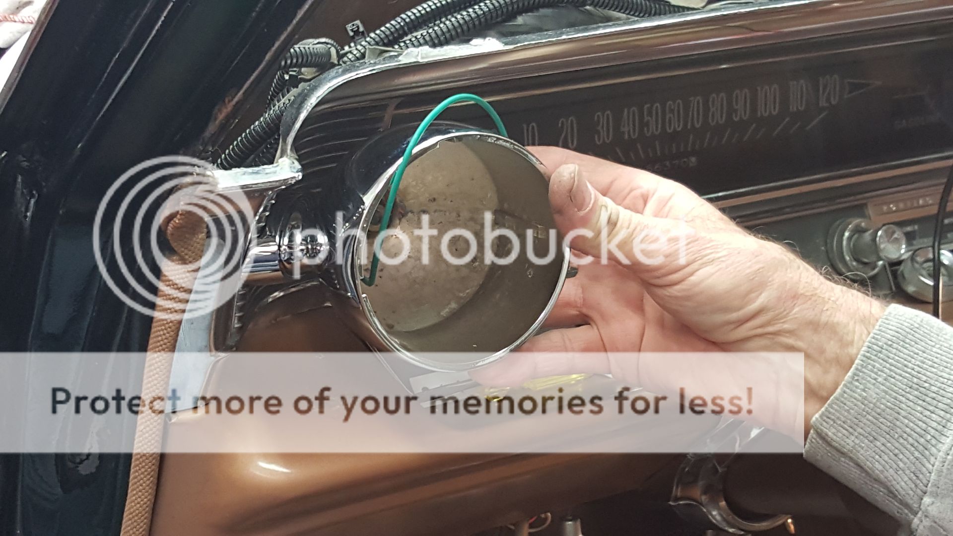

    Factory tach mount holes are drilled. This thing fits perfectly. The tach I found looks good as new...its in amazing shape
    Gauges
