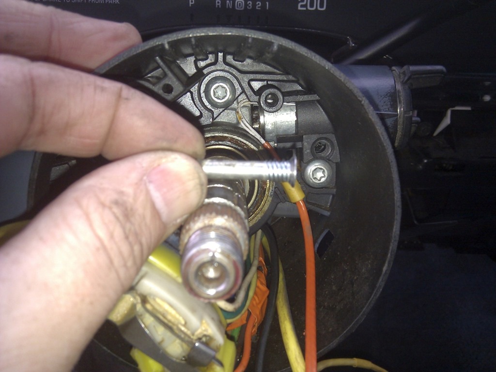

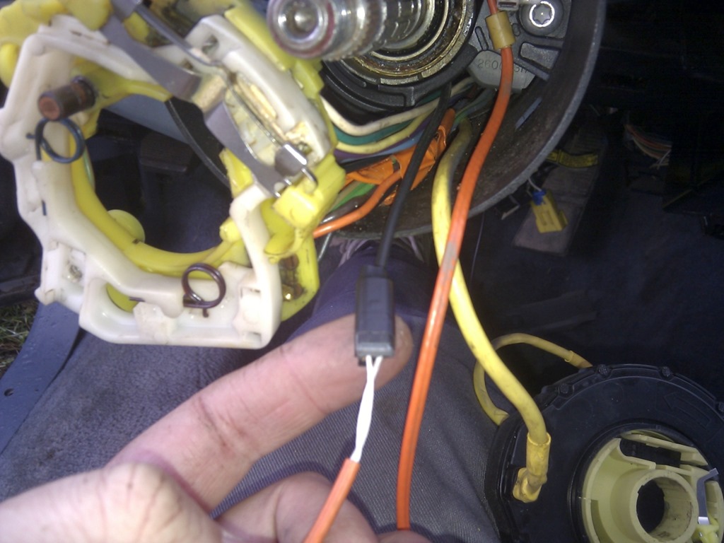

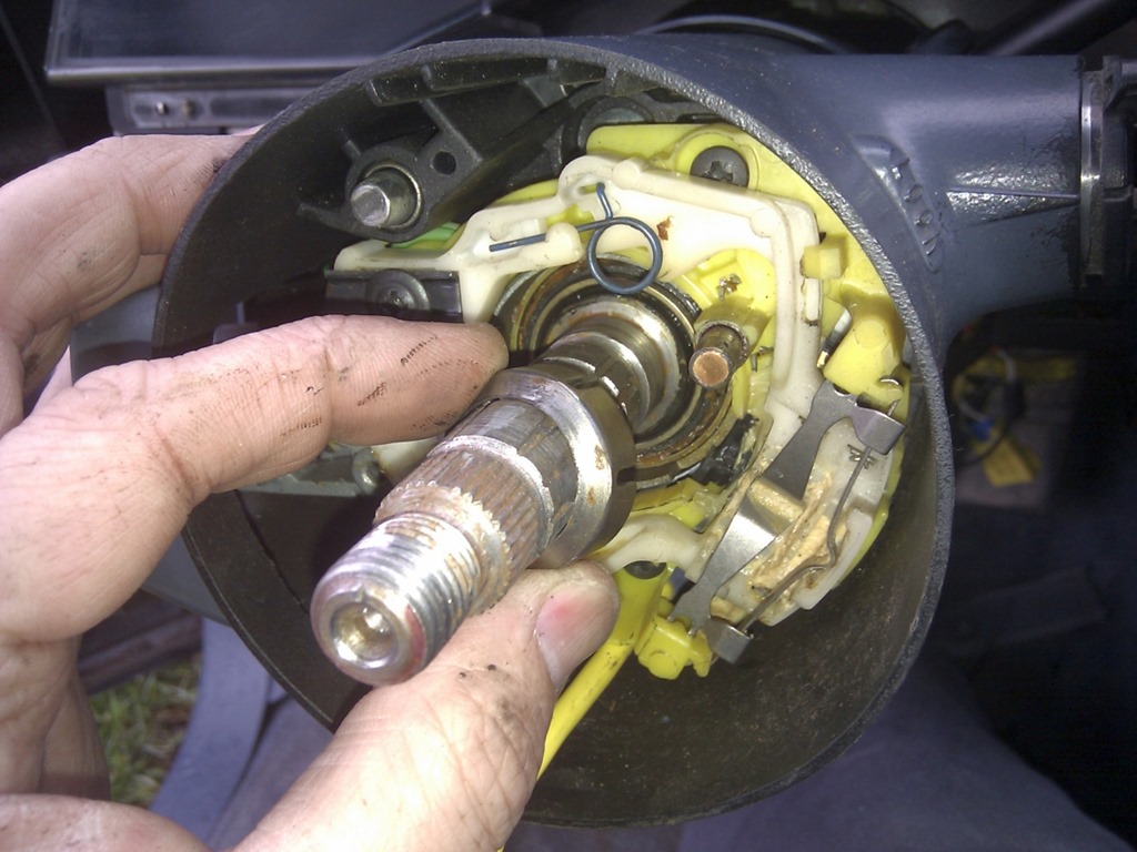

    I wrote this up for my blog and figured it would be handy to repost it here.
    Part of changing the interior colour of my wagon was to change the plastic moulding on the steering column. Since those parts aren’t particularly easy to swap, I figured it would be simpler to swap the entire steering column. While that’s not a simple process for us neophyte car guys, it’s not a terrible task to perform either. I’ll write up a how-to on removing the column itself later. What I want to cover here is the snag I ran into after moving the column from my wagon over to the donor car.
    As everyone is probably aware, there is a security system in most cars that ensures that the key inserted in the ignition switch matches the one that is supposed to go with the car. These ‘91-‘96 GM B-Bodies are no different. The key is both cut to match the ignition cylinder as well as configured with a resistor the value of which is matched to the Pass-Key security module. Since I swapped out the steering column along with the ignition cylinder but not the Pass-Key module, the key to my wagon now fit in the ignition of the donor wagon but the resistor in the key wasn’t the correct value to permit the wagon to start. I had two options; replace the Pass-Key module, or swap out the ignition cylinders. The Pass-Key module is located well up under the dash so as to be difficult to reach. I thought it would be easier to swap out the steering column. While the web appears to be flush with folks who’ve done this, I had a lot of trouble finding a definitive set of instructions for it. My factory service manual covers the process but it cross references several other sections and an end-to-end process of how to do the swap isn’t something the book can do. I’m working on different steering columns so my pictures jump around a little between different cars but the information is consistent. I don’t recommend that anyone try this repair without a GM Factory Service Manual. The book contains a lot of assembly details that are really important. Many screws and nuts need to be torqued to specified values in order to assure proper fit and function and the book provides those specs.
    To get at the ignition cylinder, we need to remove the steering wheel along with a surprising amount of equipment. Make sure that the front wheels are pointed straight ahead, the ignition cylinder is in the locked position and let’s get started!
    Before beginning any work on the steering wheel it’s important to remember to take some safety steps and disable the Supplemental Inflatable Restraint (SIR) system. The early 90’s B-Body cars have two airbags as part of the SIR system. One is located on the top of the dash on the passenger side of the car and the other is mounted directly on the front of the steering wheel. Obviously if we’re going to remove the steering wheel, we need to make sure that the airbag doesn’t go off. Having something trigger that small explosive and make that airbag slam you in the face at close range is dangerous and can be fatal! We can disable the airbags either by disconnecting the battery before starting work or by disconnecting the airbag connectors on the steering column under the dash. The factory service manual recommends doing both. I’ll assume we all know where the battery is located so I’ll consider disconnecting that to be a no-brainer. The airbag connectors are made to be easily identifiable and therefore are made of bright yellow plastic with large labels on them identifying their function as SIR equipment. After disconnecting the battery, disconnect both of the two yellow connectors under the dash by the steering column.
    With the battery and airbags disconnected we’re good to go.
    Start by removing the hazard light switch.
    Next locate the two Torx head bolts on the back of the steering wheel. These two bolts hold the airbag onto the steering wheel.
    Take care when removing the airbag. Take care when handling the airbag in general. For all intents and purposes, that airbag is an explosive and can pose a danger if mishandled. When removing the airbag, do so gently and slowly both to ensure that the airbag is handled correctly as well as to avoid damaging the connectors underneath. If the airbag is allowed to drop, the horn connectors can be damaged (…as I learned from experience). Once the airbag is removed from the steering wheel, disconnect the horn switches and the airbag connector and put the airbag aside.
    Remove the large nut holding the steering wheel onto the column shaft. Remember that a torque wrench will be required to tighten down that nut later. Check to see that one is on hand now to avoid having to get it later. The ground wire for the horn switches is just a copper clip that inserts into the threaded holes on the wheel that are used for the steering wheel removal tool. The positive horn connector passes through the steering wheel. Simply grasp the plastic shaft surrounding the red wires, gently press it into the wheel and twist to remove.
    Even though the steering wheel mounting nut is now removed, the wheel is still firmly mounted on the column. Do not try to pull or lever the wheel off as it is possible to damage the internal mechanisms that handle some of the numerous functions of the steering column. In order to remove the wheel a Steering Wheel Puller is required. This is a handy little tool that is an absolute necessity for removing steering wheels. It’s only a $20-$30 item at the local parts store but many local auto parts stores will loan them out for free.
    Assemble the puller using the center bolt and the two threaded bolts that are correct for this wheel. A puller kit will have a small collection of bolts that vary bo vehicle make. Don’t thread the two outer bolts in too far, just thread them in a few turns so that they have enough grip to let you pull the wheel off. Before removing the wheel, put a small mark on the steering wheel and the column to assist in getting the wheel back on correctly later. Using a wrench or socket, steadily snug down the tool to extend the center bolt against the wheel center and the steering wheel will slip off of the column shaft.
    The steering column assembly gets a little more complex from here out but, like any project, if we tackle it one step at a time it will go pretty smoothly. The next step once the wheel is removed is to extract the SIR Coil Assembly. This unit is held on with a snap ring so a snap ring removal tool will be instrumental in getting this part out properly. Once the snap ring is removed, the coil will slide out. Pull the coil gently. The yellow connection cable is stretched tightly down through the column to the connection point that was disconnected at the beginning of this process. if the SIR coil is pulled gently that connector will snug up against the base of the column assembly and give just enough slack to let the SIR coil dangle by it’s cable while the rest of the work is completed. Note the arrows circled in red. It’s important not to let the SIR coil rotate during the process. I marked the two arrows with a marker to remind me to not let them turn.
    With the SIR coil removed and dangling free by it’s connection cable, we’re faced with removing the steering shaft lock plate. Slide off the Wave Washer to start working on the lock plate. This piece requires another one of those specialized tools. Much like the Steering Wheel Puller a Steering Lock Plate Removal tool will run you around $20-$30 or can be borrowed freely from most auto parts stores. Thread the center shaft of the tool onto the steering column shaft and snug down the wing nut to compress the lock plate. Once the lock plate is pressed down far enough, the retaining ring will be exposed and can be removed. GM recommends that this retaining ring be replaced after removal so it’s wise to have another one of these on hand during reassembly.
    With the Shaft Lock Plate removed the Turn Signal Cancel Assembly can be simply slid out of the steering column along with the Upper Bearing Spring and the Inner Race.
    Unfortunately, in order to get at the Ignition Switch we still have to dig a little deeper. Now undo the mounting switch to remove the Signal Switch Arm. Make note of the greased area where the Signal Switch Arm seats into the switch assembly so that it gets reinstalled correctly.
    It seems that my photo of removal of the turn signal switch assembly didn’t turn out and now that it’s all reassembled I’m loath to take it apart again for one picture. I presume that you’re now looking at a naked turn signal switch and can see the screws circled in the below photo that I’ve cleverly re-used. Accessing the top screw may involve manipulating the turn signal switch somewhat but it’s pretty easy.
    After removing the turn signal switch, it can be left dangling from the steering column much as the SIR coil is. It may require disconnecting the turn signal connector mounted on the steering column under the dash (shown below) in order to gain enough slack on the wiring to pull the signal switch out over the column shaft.
    The next piece to remove is the Buzzer Switch Assembly as its plastic flange directly covers up the ignition cylinder locking screw. The Factory Service Manual is very vague on this part. It advises only that the switch be removed but doesn’t explain how that is done. It turned out that the piece can just be pulled straight out. I gently wiggled it a bit while pulling on it with a pair of long nosed pliers. There seem to be a few different models of these switches so the picture below might not be accurate.
