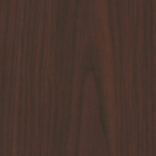

    Hi Guys, i am currently going through replacing the wood-grain on my 70 Buick Estate Wagon. Its quite the headache trying to get something even remotely close, I like a few of the stripeman colors but I don't think the gloss is going to look good once the car is done. I notice a few of you guys don't like the new D-noc? does it actually repeat to much? some of the samples I have have the closest matching colors and that nice satin finish. between the woodgrain, vinyl roof and other bits I would hate to try do a proper restoration of a 60/70's wagon!!
  15. 90merc
    90merc Well-Known Member
    Apr 16, 2010
    785
    65
    New Jersey
    Hi Spencer. For color and grain match for your '70 EW, the 3M Di-Noc architectural series comes close with style FW-1020 (the FW is for fine wood.) http://multimedia.3m.com/mws/mediawebserver?mwsId=SSSSSu7zK1fslxtUoxtSM8_xevVSeChshvTSevTSeSSSSSS-- I have a sample and it is definitely not too glossy and it would look dark brown on the wagon, with some reddish tones throughout. My BIG concern is that it is really intended for wall finishing systems and is very thick, so cars with pronounced wheel arches and other complex/compound curves are a challenge and would require a 3M primer in those spots for proper adhering to the paint. I really don't think it's flexible enough for the job.
    You could check out Phoenix Graphix http://www.phoenixgraphix.com/custom/wood.htm and Auto Trim Design http://www.autotrimdesign.net (put in a search for woodgrain).
    I just got a sample of ATD's cherry oak and even though the sharpness is right and it has a decent grain pattern, overall it's way too bright red-orange. However, they do a Marine Teak that looks good (from the website) which might work, depending on your wagon's paint color. http://www.autotrimdesign.net/detail.jsp?item=ATD-591GWMT&category=75145 I have a sample of ATD's cherry oak for Wagoneers and it's different from the generic cherry oak I just mentioned, and even though the grain is crisp, the background is too yellow, so I don't recommend.
    Always get a decent sized sample before ordering for the whole car.
