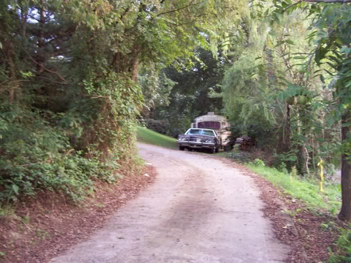

    Here is the grade that the car wont pull up from a stop... here is the "bend" first of our driveway...

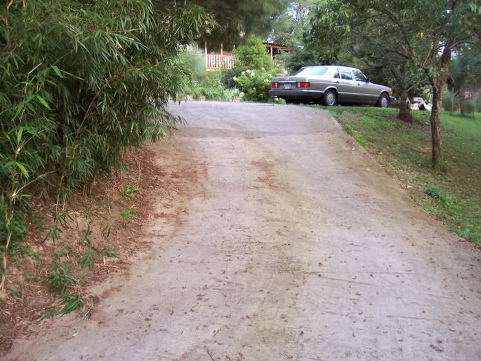

    and the grade.... I have to get a running go in the wagon... the Grand Ville will pull this hill easily.

    Don't know the newer GM trannies, but it probably has a vacuum valve to assist the shifting points. That's one part. The other is the Distributor Vacuum advance vacuum valve. If either one is old or toast, that will make it shift like sludge.
    The hesitation sounds like valve seals need replacing. Try another distributor valve to start with, and then the tranny vacuum valve. Seals aren't a big deal, but you could find out for sure with a vacuum gauge, if its seals or valve stems, etc.:

    The clue, for my suggestion, was that it pulled itself together when you dropped it into a lower gear and it picked up some oomph. Yeah, that would do it. One of those vacuum valves isn't getting enough vacuum (carb or Manifold source) or isn't working right.
    One way to test them is to put the vacuum line (engine off) to your mouth and try pulling the valve back, or a manual vacuum pump (cheapies work fine). A vacuum gauge is the best when the engine is running.

    Yes,an additional vaccuum problem could cause the car to have problems moving.When my family's 74 LTD was having it's vaccuum hose problem,top speed on level ground was 15 to 20 mph.And it had to be pushed up a hill no steeper than the one in your pictures.
