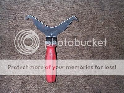

    It most likely has the steel clips for the window trim that slide over rivets welded to the body so you'll need a trim clip tool. You slide it down between the glass and trim then slide the pointy end under the clip then pry the tool against the body to pull the clip up enough to get the trim off. The clip just pinches the trim between it and the body to hold it. Best to tape up the trim tool blades with a layer of duct tape to keep them from scratching the glass or chipping the paint where you pry against it. You can buy the tool at any parts store.
