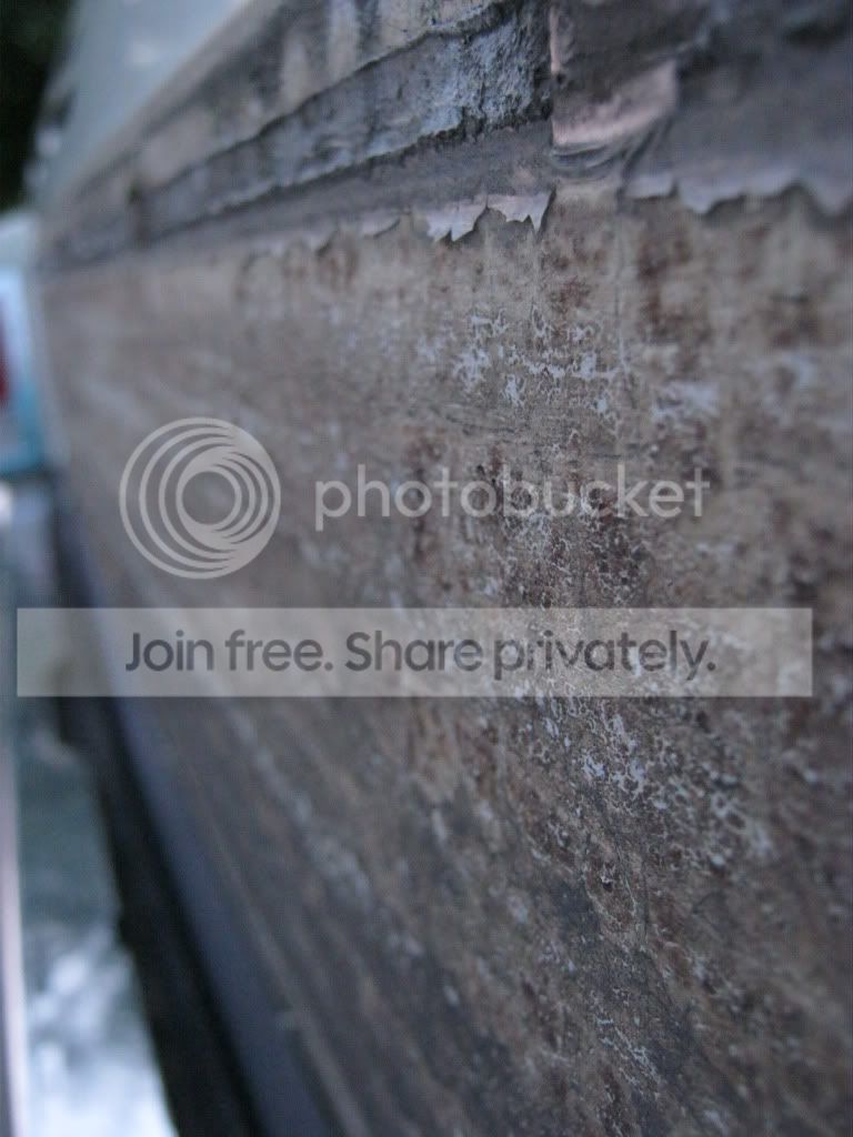

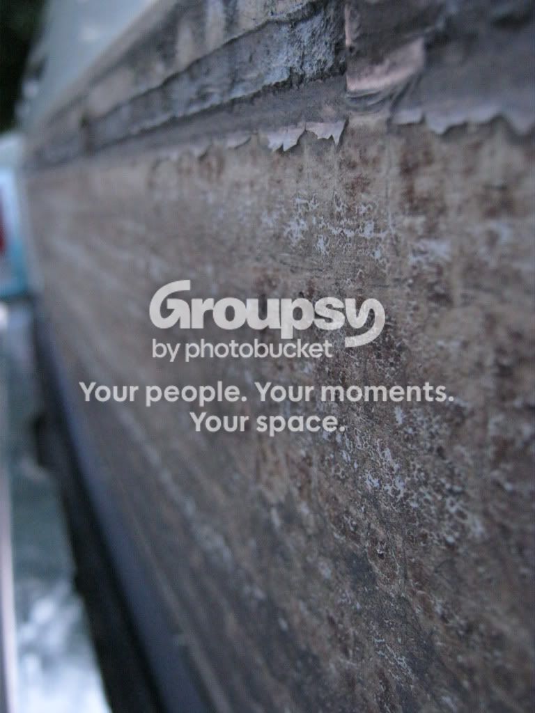

    The long dreaded roof insulation was finally on the agenda today for the '37, but first I had to go take care of the business of the new compressor that, after one month, went bad on The Caprice. I essentially replaced all the air conditioning components to get the air working on The Caprice. Yesterday, the new compressor locked up. When this happens it's required that you replace the dryer, too. Since the dryer and compressor were bought at two different places I have the hassle of dealing with getting the two different places to warranty each piece. This doesn't seem to be entirely too uncommon with parts houses today for their new or remanufactured parts to be bad or quickly go bad. With as much money as I spent for these pieces and the labor it cost to have the dealership put them on it's pretty frustrating to deal with having the 134A removed from the system and now having to make time to take all the old parts off and install them back myself and then having the system recharged. If the world were right, the parts house I bought the compressor from should have to cover the cost of the parts and the labor to make it right.

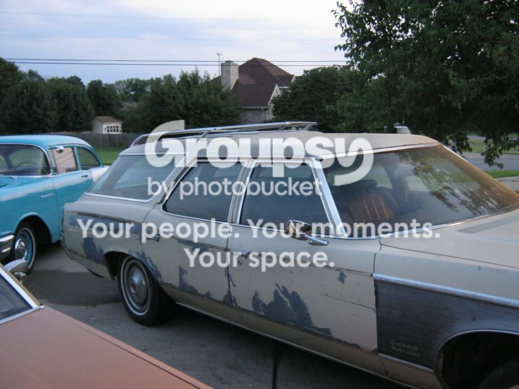

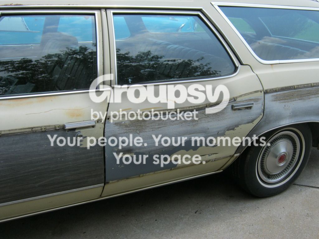

    When I finally got home I started on getting the old vinyl woodgrain off of the sides of the wagon. This. Is. Terrible. I borrowed a heat gun from work and tried some yesterday. Even just getting the trim off is pretty difficult because of the bolts and screws that hold on some of the parts.
    [​IMG]​

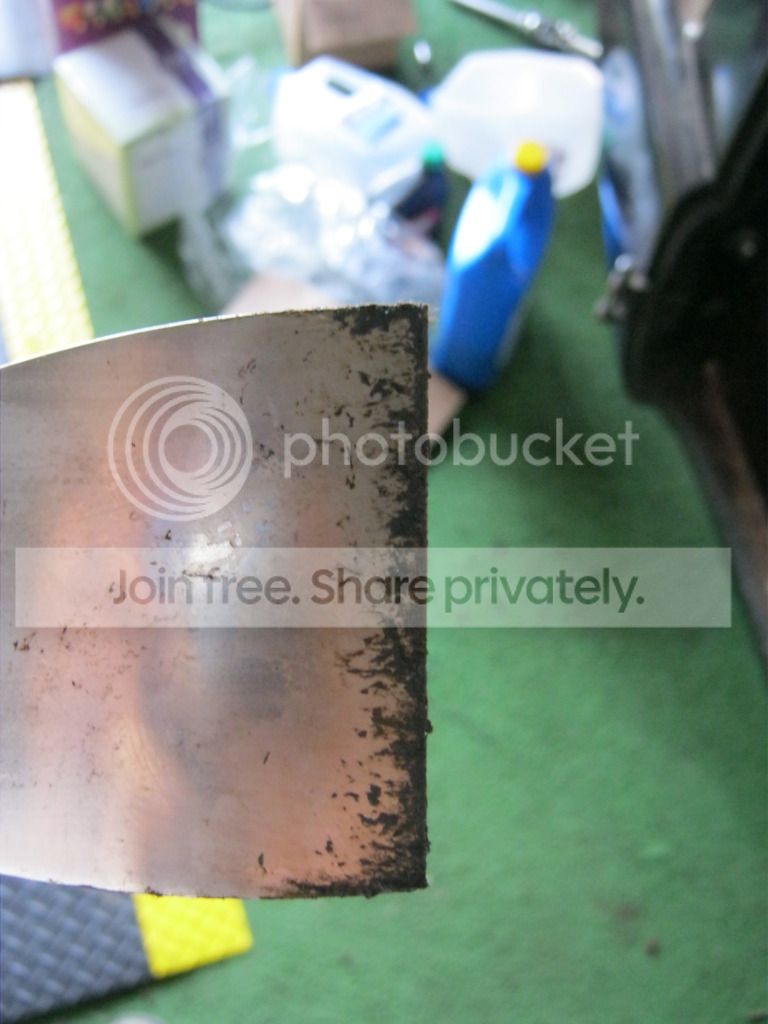

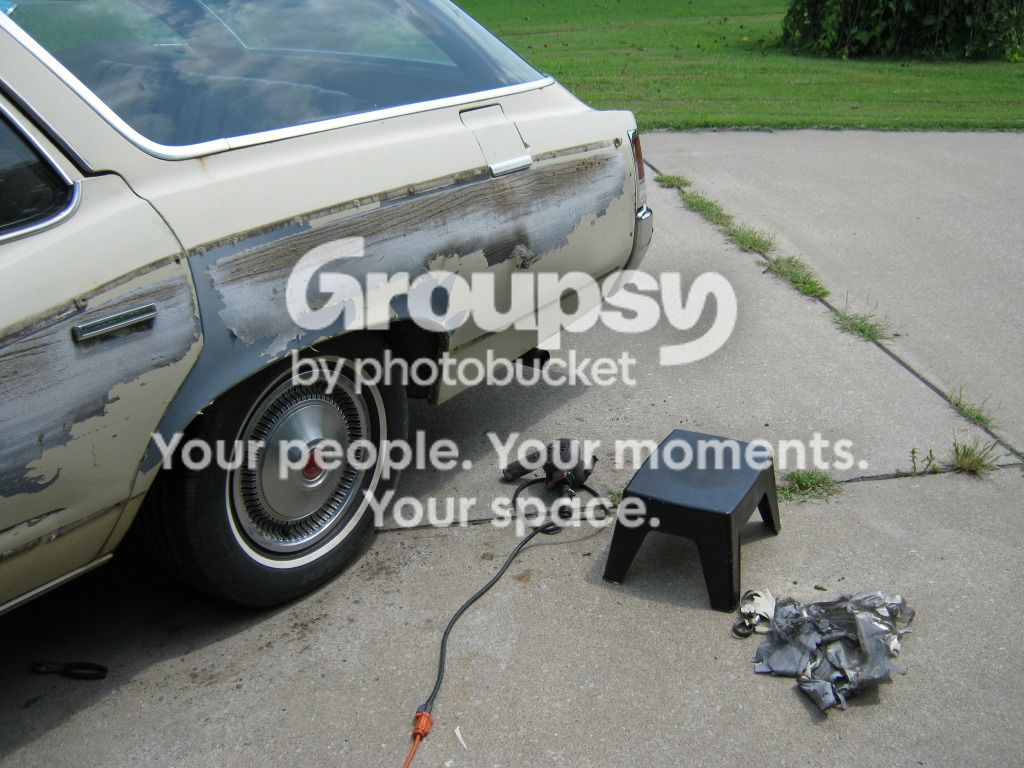

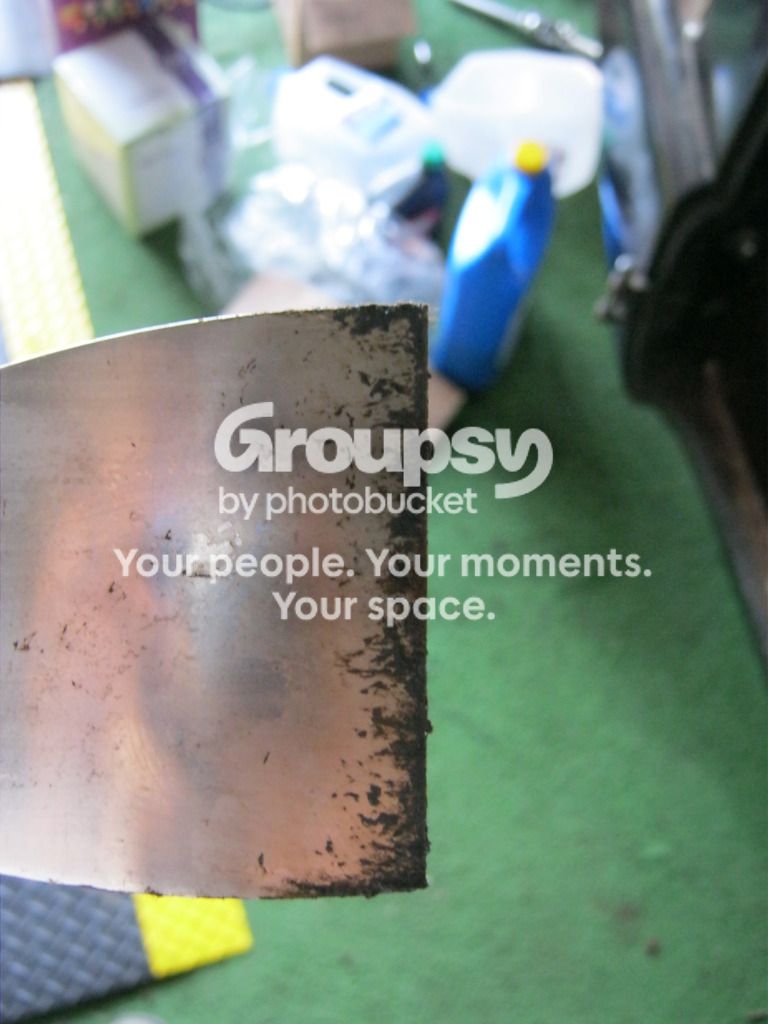

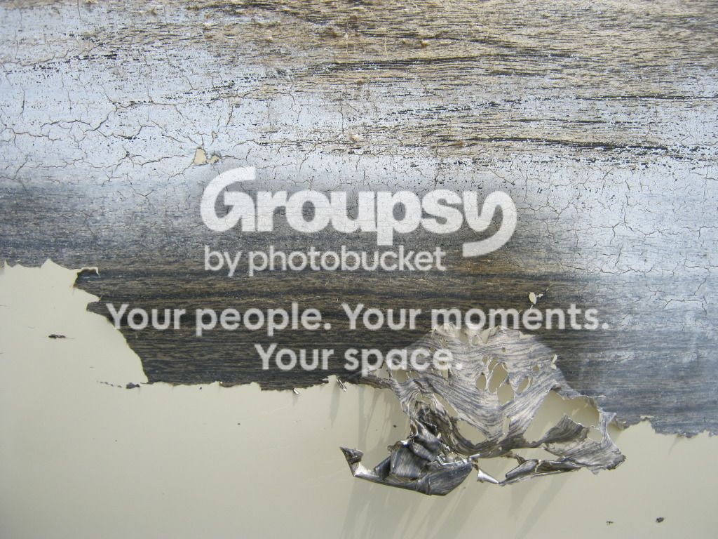

    I bought some plastic scrapers, but in order for them to do any good it requires getting the vinyl so hot that it melts them. In some places the vinyl took the paint with it.
    [​IMG]​
    [​IMG]​

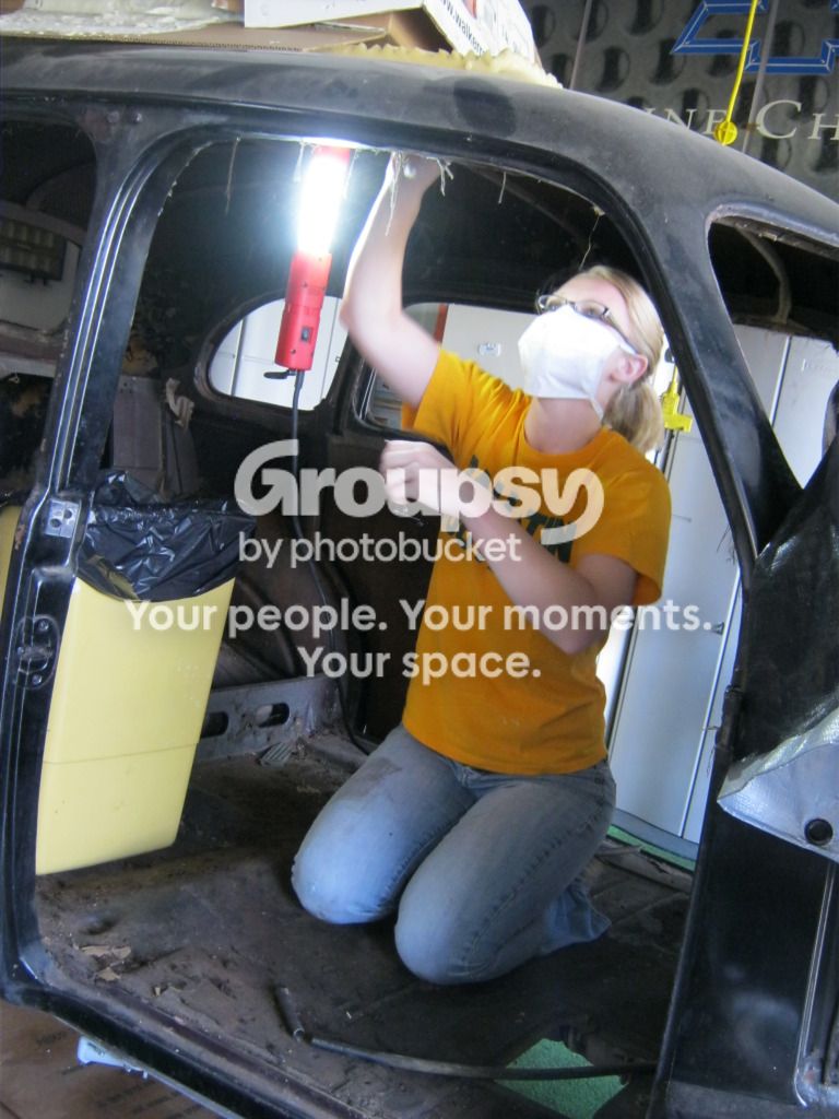

    April came out later on and started scraping on the roof insulation inside the '37.
    [​IMG]​
    This stuff is absolutely terrible. It's a toss up between what's worse, the vinyl or the insulation. It's made out of a thick, tar like substance.
    [​IMG]​

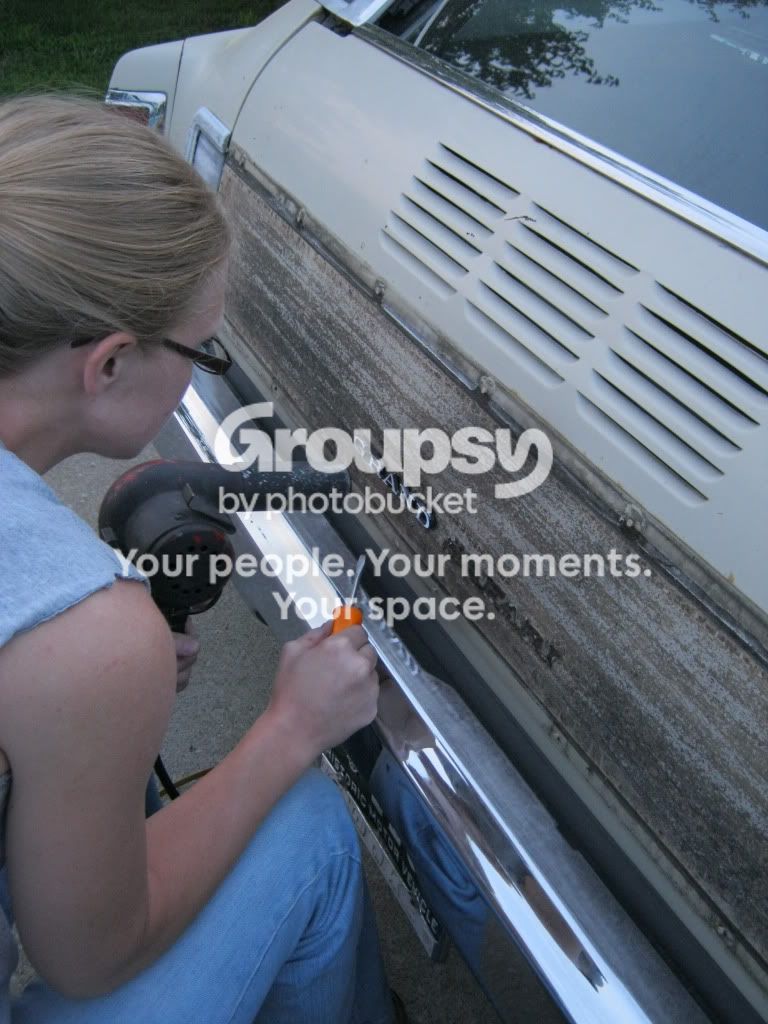

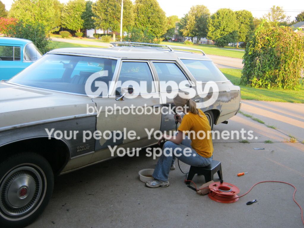

    After a few minutes April said her arms couldn't take it any more so we switched and she started on the vinyl.
    [​IMG]​
    She got all of the driver side door finished and started on the rear door.
    [​IMG]​

    I see in your pic, your wood is pritty much sun baked on allwready. I'm wondering if the heat gun as close as it's being used may just be adding to the problem....your baking it on even more?:huh: It's clearly dry and hard, and your doing a repaint anyways.... mite be a idea to try a chemical soulution to"soften" the wood then scrape and clean. Mineral spirits, some sort of paint stripper, etc.

    Oh and just so you know the woodgrain will take the paint off in places i really don't think the heat amount is a factor mine did the same.it's like it chemically bonds to the paint in places.

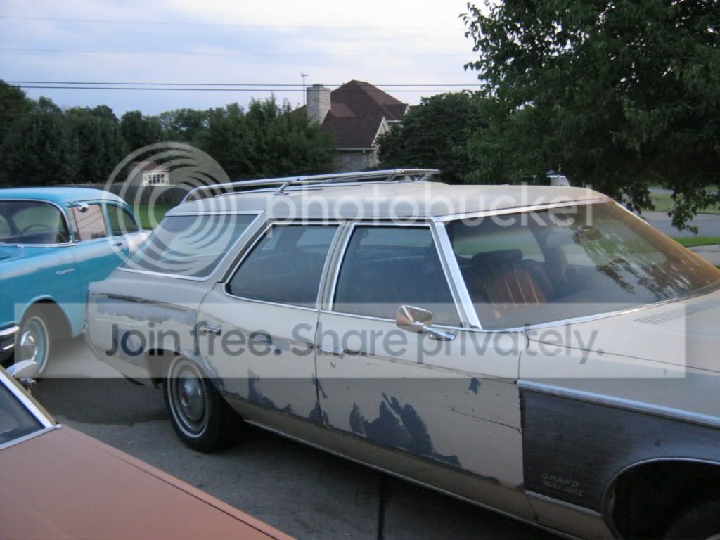

    Here's a few more pictures of the continued process.
    I had the air conditioner replaced on my '78 Caprice. After about a month the "new" compressor from O'Reilly's went bad. Today I took the new bad one off and got a new, new one. As I was filling it with fluid today it locked up before I even put it on the car. So while I was handling all that, April started on some more peeling.

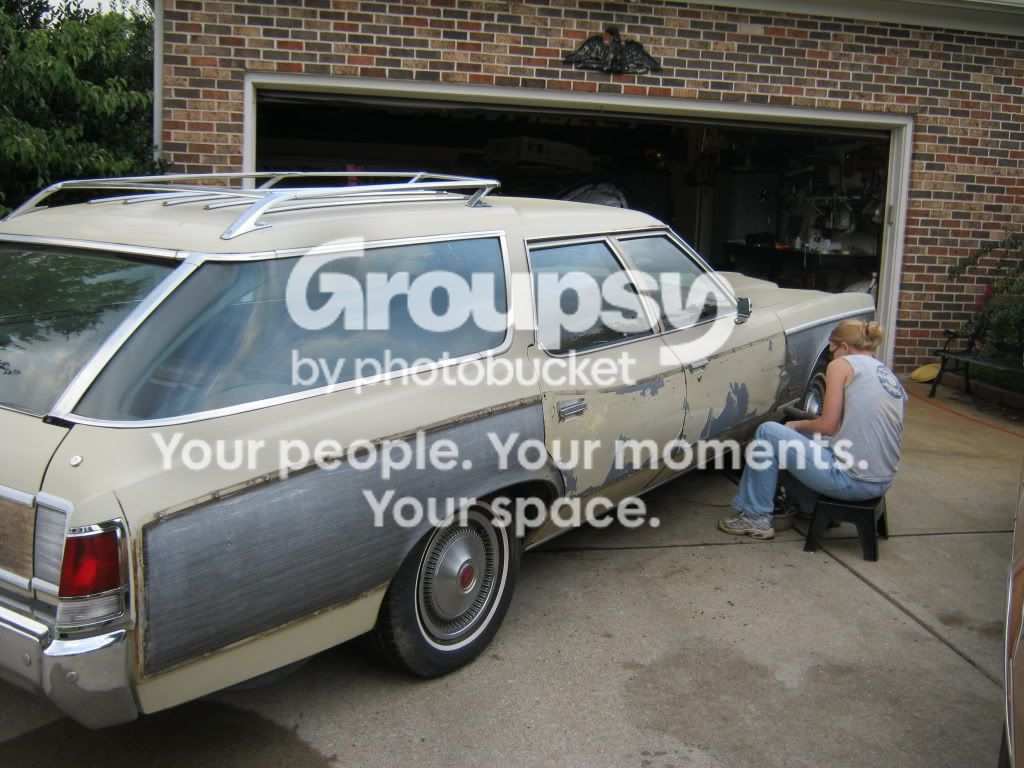

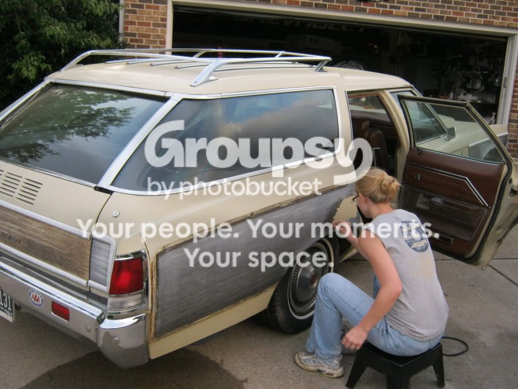

    I bought one of the eraser wheels. I bought the one that looks like a tractor tire and had to go to the hardware store to make a piece for it to fit to my drill. It worked well. My woodgrain is in very, very poor shape so anything above the belt line was really bad. After getting as far as I could with The Caprice I started on the wagon with the eraser.
    April got almost the entire passenger side done today

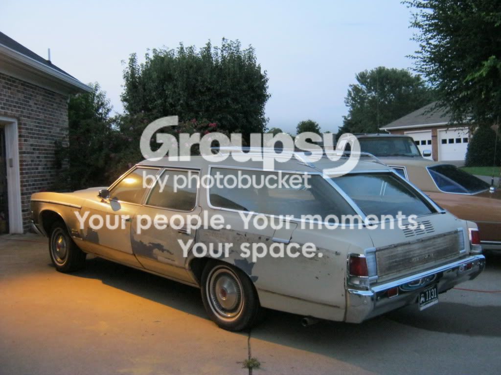

    The tailgate is by far in the worst shape
    And here's the driver side
