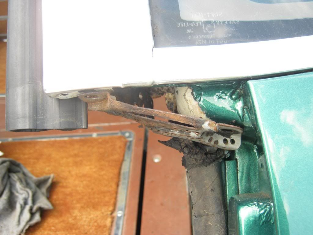

    This is the upper, passenger side corner, where the tailgate raises up against the body. There is a screw on the right that gave me much grief to remove. Also, if you look directly below the visible screw on the left you will see a rusty area. This rusty area is the second screw which gave me a lot of trouble to remove. I had to do this in the direct sunlight and it was very, very hot this day, making this a near miserable task. This, and the comparable corner on the other side of the car, are where I will have to come up with a way to seal against water that is entering the car.
    I am a member of a group of station wagon enthusiasts on the internet that have a forum. One of its members sent me this metal piece that screws into the location you see here. I was very thankful because this piece is nearly impossible to find. Mine had rusted beyond use and pieces can actually still be seen stuck behind the screws in the picture above. I will sandblast this piece, repaint it and use it to attach a sealer that will lock out the water in this area.
    This is the same area with the tailgate closed. You can see the weatherstrip seals against the bottom of the metal piece, but more will be required above it. Also, though not visible in the picture, the big problem is that there are drain holes in this area in the tailgate and the window rubber and the tailgate rubber must be modified and attached in such a way that they will drain the water into the holes. They currently just allow the water to pool up at the base of the window. My window/tailgate switch broke yet again and finally got so bad I had to stop work in this area.

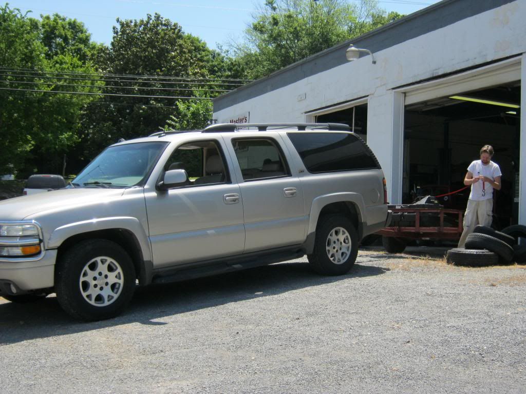

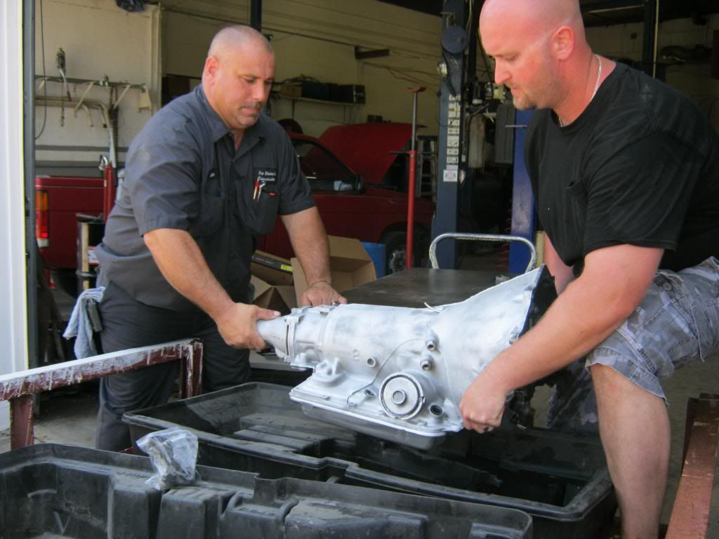

    After a lot of searching I finally found a reputable shop in Kentucky, coincidentally in the same town that we used to have the dealership. Dad went with me when I delivered it. A little over a week later, Jacob went with me to pick it up.
    Fortunately there was plenty of help to load it into the transmission case I'd brought on the trailer.
