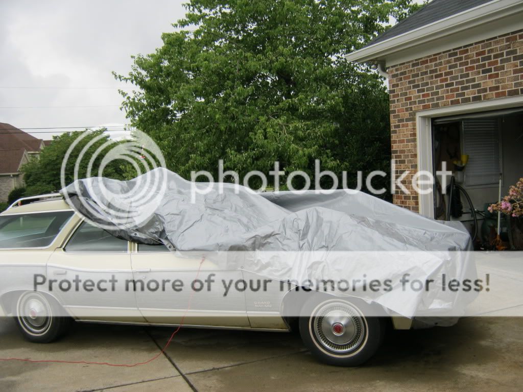

    Since it was raining last night April helped me take the hood off today before she left to go into town. We've nicknamed the car The Clamshell, or The Clam.
    The hood looked massive sitting in the garage.
    The storm came shortly after the hood came off so this is how The Clam had to ride the storm out. The string had broken so I had to make due with what I had.

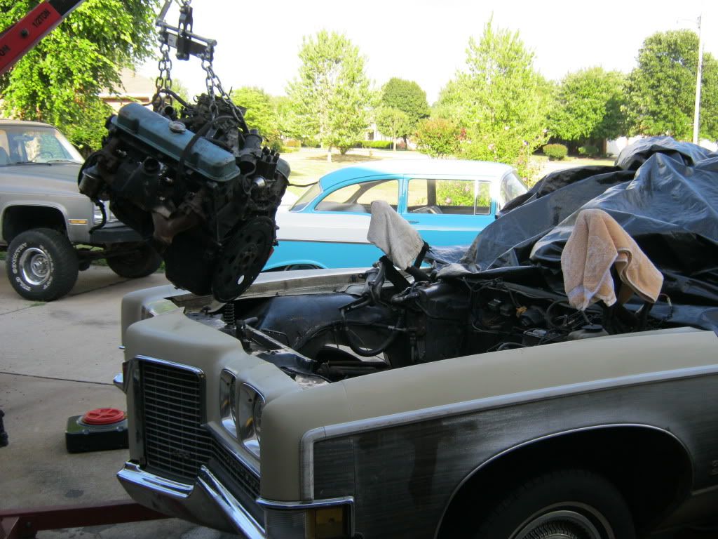

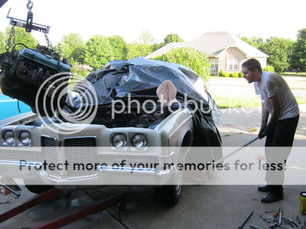

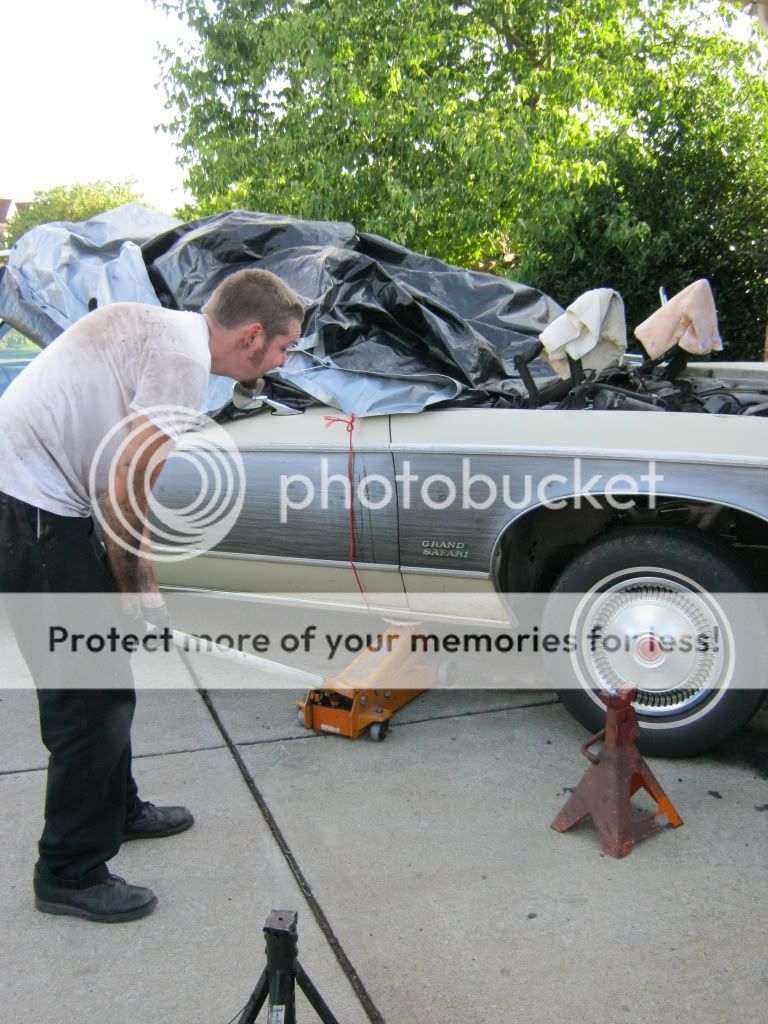

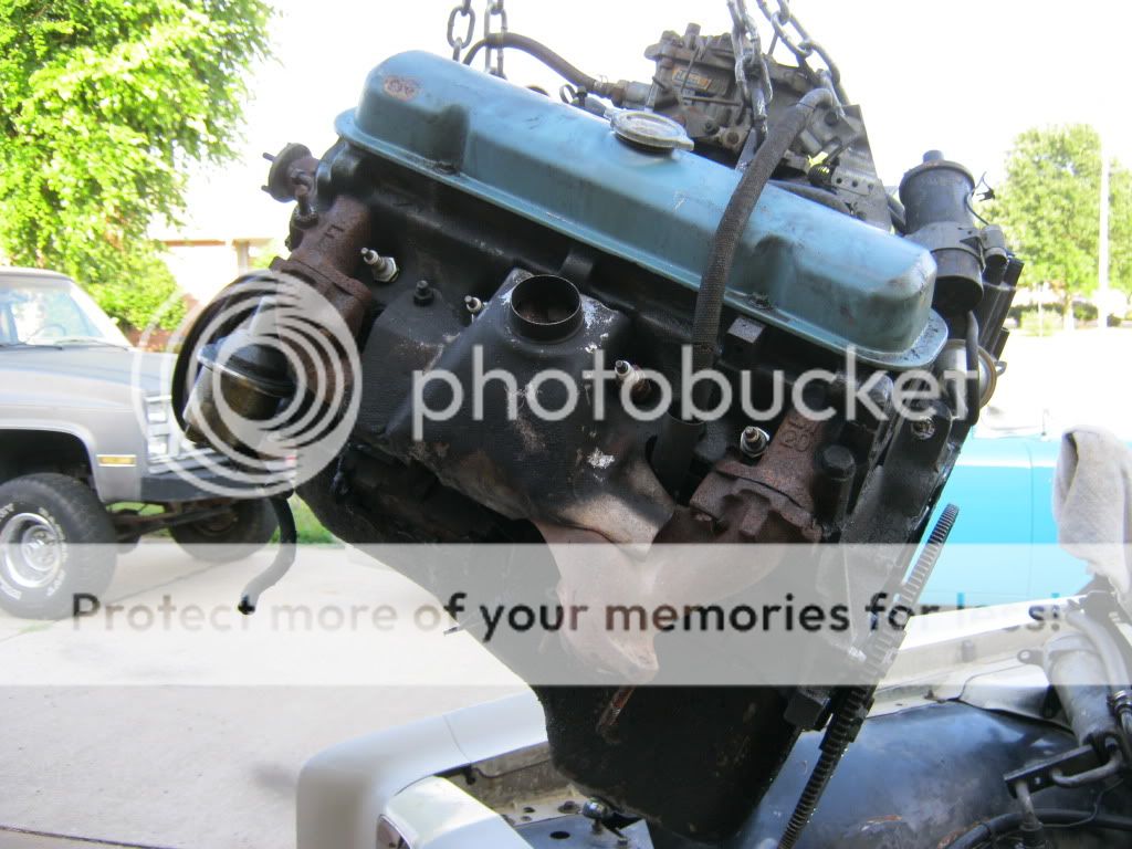

    After getting the rest of the wires and bolts photographed and unbolted or unplugged it was time for the engine hoist. The A-arms sat so low I had to jack the car up to slide the engine lift under the car. I had kitty litter embedded in my head from scooting around under the car.
    I didn't really have any major problems getting the engine out. It was difficult, but not more so than any other typical engine pull. The only problems I had was one hidden bell housing bolt that I first thought had been left out by a previous mechanic. I couldn't get the engine and trans apart and after a lot of searching finally found the head to the hidden bolt. The only other problem was one exhaust flange bolt broke off; All the others were easy. If only 1 out of 4 exhaust bolts give trouble, I call that a success. April came out and lended some picture taking assistance. Typically, she would have been out helping but she's throwing a party for a bunch of ladies tomorrow so she was busy cleaning the house all day.

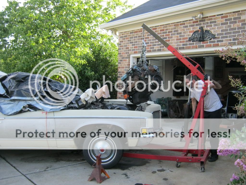

    The massive 455 in all its glory. I knew it was heavy but I was still surprised at just how much the front of the car sat up after it was out.

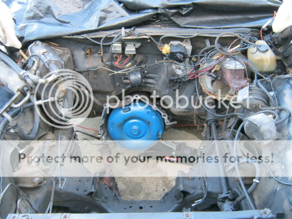

    Here's a picture underneath the car. I'm really surprised at how solid the underside of this car is.
    And there she was. It was no small chore getting it back into the garage to await a good degreasing. My cousin gave me this engine lift. It has come in infinitely helpful. He used it once when restoring his '56 Chevy. He loaned it to a friend who bent the wheels, so it won't roll straight, but I don't care, if I didn't have this thing I would be dead in the water. One good thing about laying in all that antifreeze was it really did cool a person down.

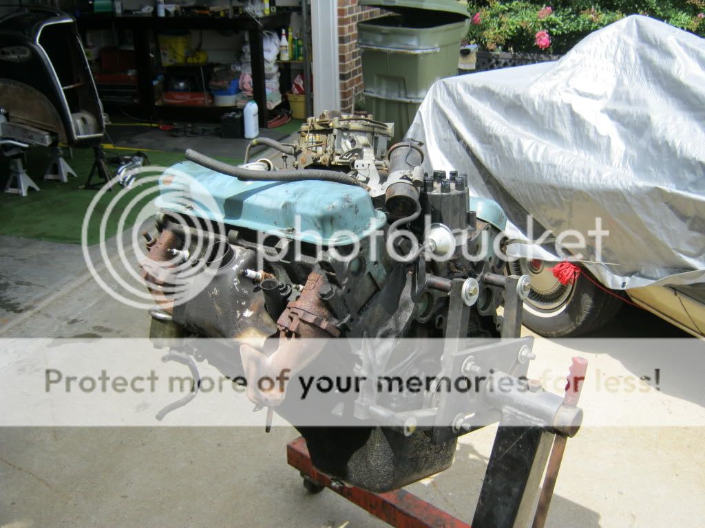

    I got the engine on the stand and degreased
    As you can see the bottom of this thing is some kind of funky

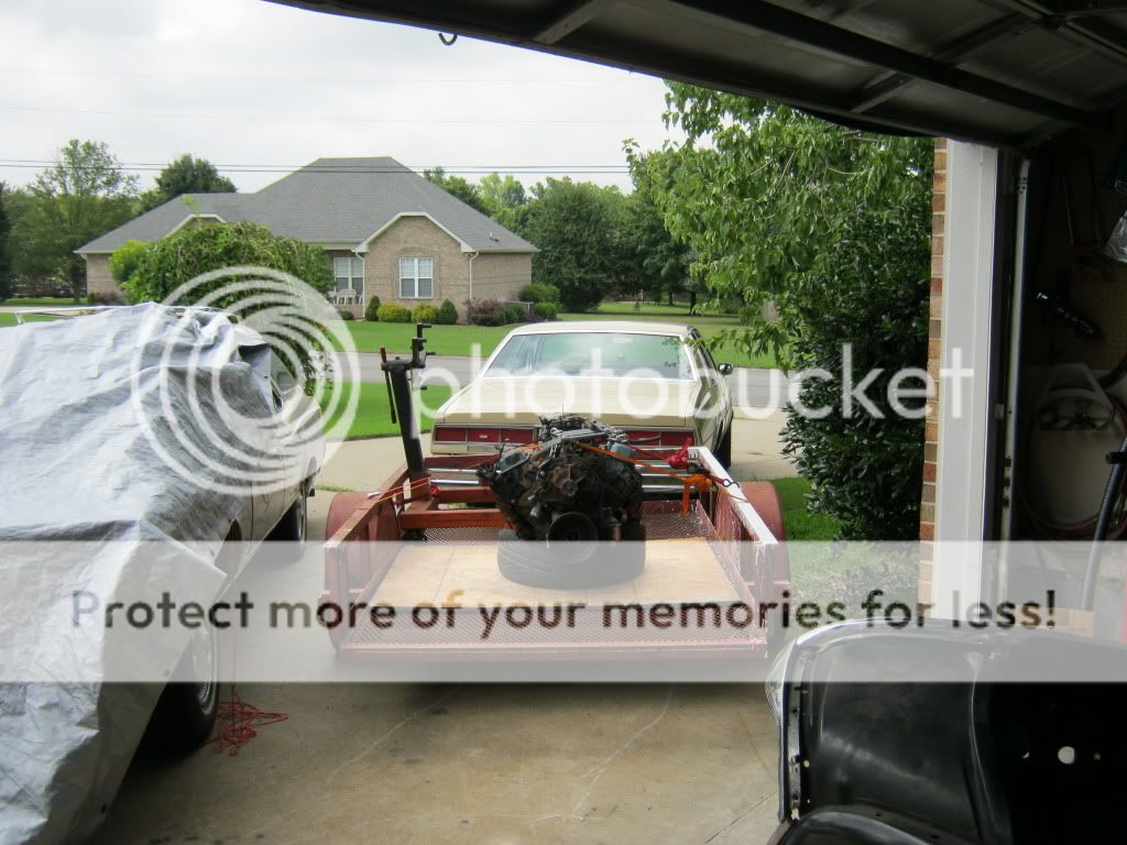

    My wife is helping a friend plan a wedding 40 miles away, so we traded Caprices so I could have the trailer hitch and haul The Clam's engine down to my friend's house to get a rebuild.
