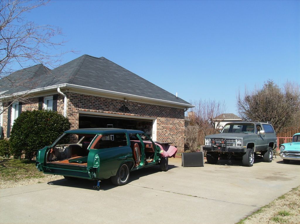

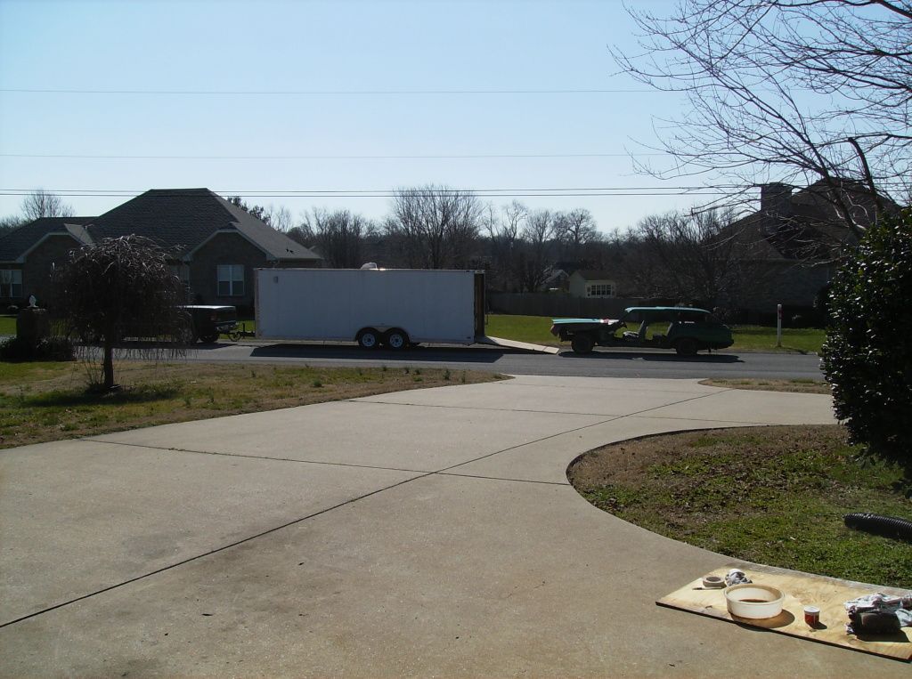

    Then I pulled The Blazer back as far as I could into the driveway. I ran the cable out and winched The Clam up the hill little by little, making sure to go down and steer when necessary. As those familiar with using a winch will know, the rug is for safety. If the cable were to break it can sever arms and legs, or heads, which I can't imagine would feel very nice at all, so the rug stops the recoil.
    [​IMG]​
    I pulled it up as far as I could. A little later on my neighbor Rick and his friend happened to be in Rick's driveway so I asked if they would mind helping me push the car the remaining few feet. Even though the hill doesn't look that steep in the pictures it was enough to prevent me from being able to push the car by myself. Also, the fact that the tires are low contributes to the fact the car is difficult to push.

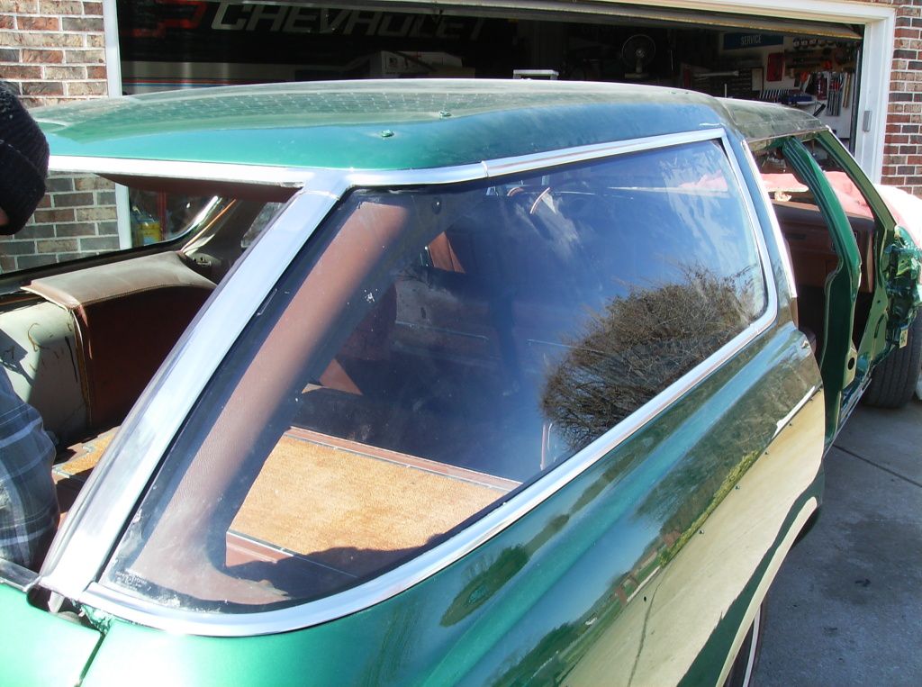

    If you own a clamshell wagon, this next part is very exciting. The rear window and tailgate seals have long plagued owners of these wagons. They are not reproduced, there is not a big enough demand to get a company to run a production of new ones, and once they deteriorate, which almost all have at this point, they leak water into the rear causing rust issues as well as ruining the electric motors and mechanisms that operate the tailgate and window. Member LowLow37 discovered that the cowl/hood weatherstripping from a late 80's Chevrolet full size, G20 van can be modified and used as a substitute, so you can all thank him for this amazing news. After a little research I found that the van's weatherstripping is interchangeable with the trucks and blazeers that share the same bodystyle as my Blazer.

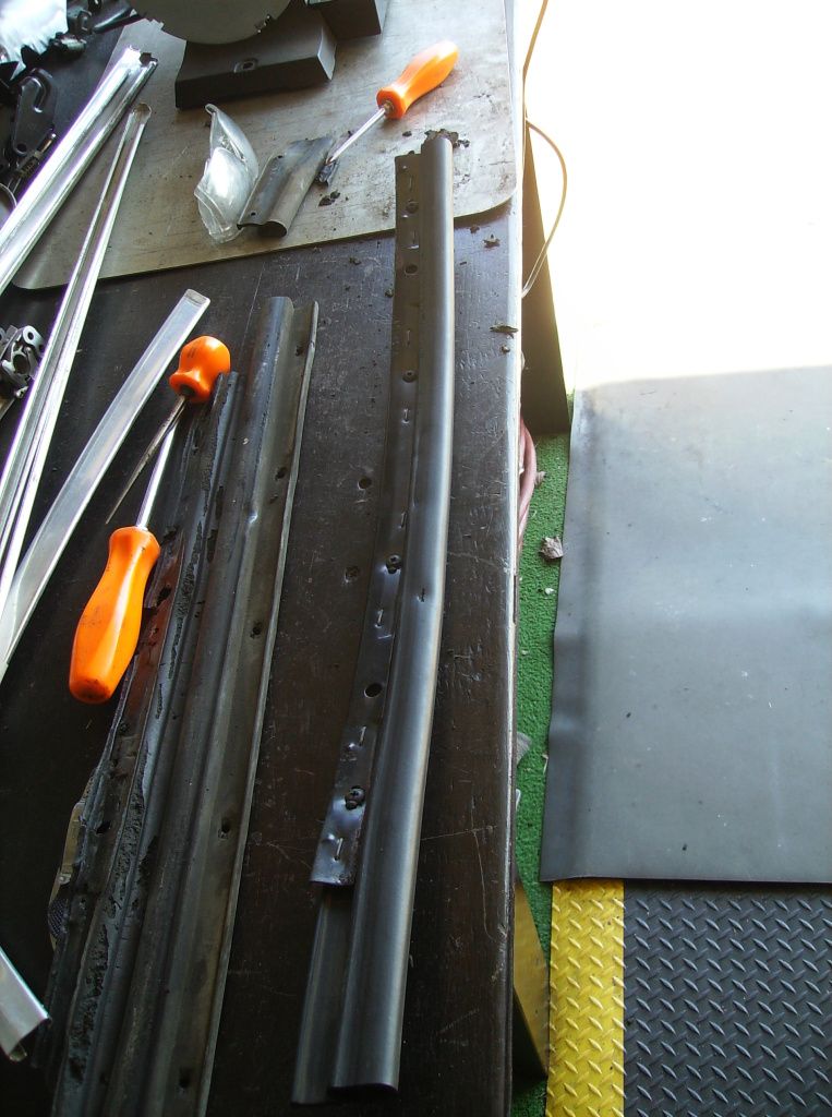

    Yesterday, because it was raining and I couldn't get any real work done on the wagon I went to the Pull-A-Part yard and got three of these moldings. I found that the van weatherstripping actually requires a ratchet but the trucks of the same year are held on by plastic tabs. Because I had looked at The Blazer's weatherstrip before I left and had seen the plastic tabs I didn't take any sockets with me. Because of this, I didn't get any parts from the vans but that worked out just as well because after a close comparison I feel the truck weatherstripping is actually shaped better and it is much, much easier to remove. It essentially just pulls right off once you get one end started. These moldings are reproduced and I could have bought new ones however when these moldings are new they are rather large and round in shape. Once they have been on a truck several years, smashed by the hood being closed, they take on a shape that not only fits the car better but actually is aesthetically much better shaped for the portion that can be seen from the outside of the window.

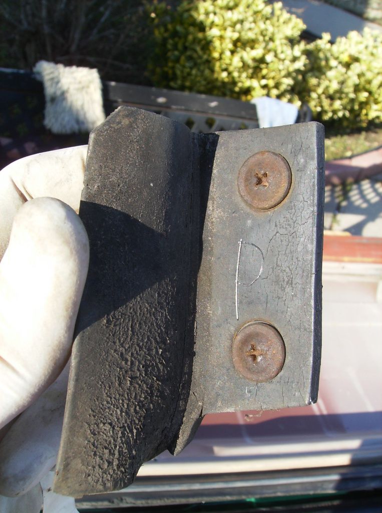

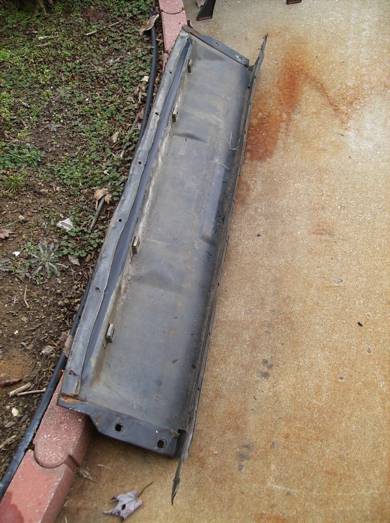

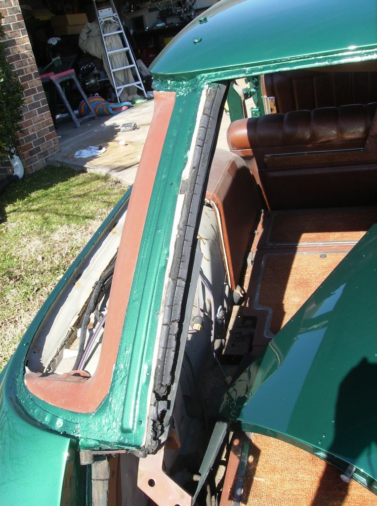

    The old rubber is held to the car by a metal plate that mounts to the inside of the rear pillars with screws that go from the inside of the car out through the rear pillars. I used the original screws because I had been warned that using screws that were too long would leave dents in the chrome trim that will eventually cover the rear pillars.
    When you remove the old rubber and clean it off the metal plate this is what you end up with.
    [​IMG]​
    Even though these rubber moldings are pretty old they have remained in good shape because of their original location on the trucks. They are mounted to the bottom of the hood, tucked up under nice and safe and away from any real sun or water damage. After cutting one piece to the right length I used a little soap and water and it looked almost as good as a brand new piece. Here is a picture of a dirty piece next to one I just cleaned.

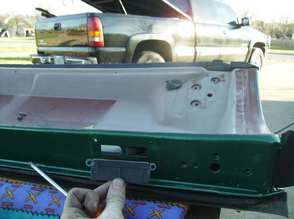

    With all that finished I began putting all the pieces back on the tailgate. This was the very first step in the process of reassembly and it felt good to finally be going in that direction rather than taking things apart.
    [​IMG]​

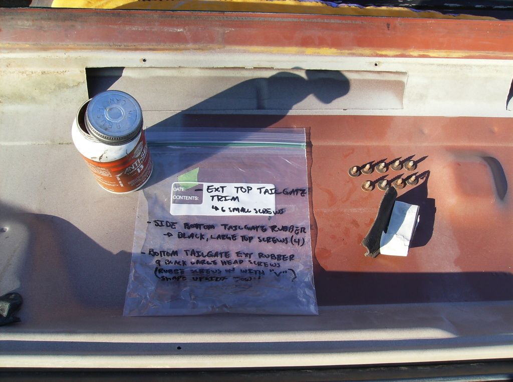

    Fortunately, past me had left detailed instructions on where each part went and which screws to use. I'm glad that he was aware how little I'm able to remember when it comes time to put these things back together.
    [​IMG]​
    I actually have no memory what so ever of these pieces being on the tailgate. The bag I had them in let me know they went on the bottom sides of the tailgate, but I couldn't remember which way they went or which side they went on. After I took the tape off I saw that past me had left present me a "P" and "D" on each one, indicating passenger and driver sides. Even though sometimes we don't get along, past me can sometimes be pretty smart. Future me is more of a wildcard. I never know what that guy is going to do.
    [​IMG]​
    I don't really know what these pieces do but they have "Do Not Remove" stamped into them with raised letters. It seemed that the tailgate could drain any water that might get in it much better if these weren't there but I suppose because of the warning I should trust whoever went to the trouble to put it there and put them back.
    [​IMG]​

    Nice work my friend! lol and those do not remove pieces are in fact drain covers there are 2 rectangular holes on the TOP of the tailgate at each end of the rubber where the window seals. I belive those 2 holes and those drains let water free flow thru the gate so it doesn't accumulate at the window bottom. I like to take and blow my gate out 1-2 times a year to get the dirt and gumbah's outta there!

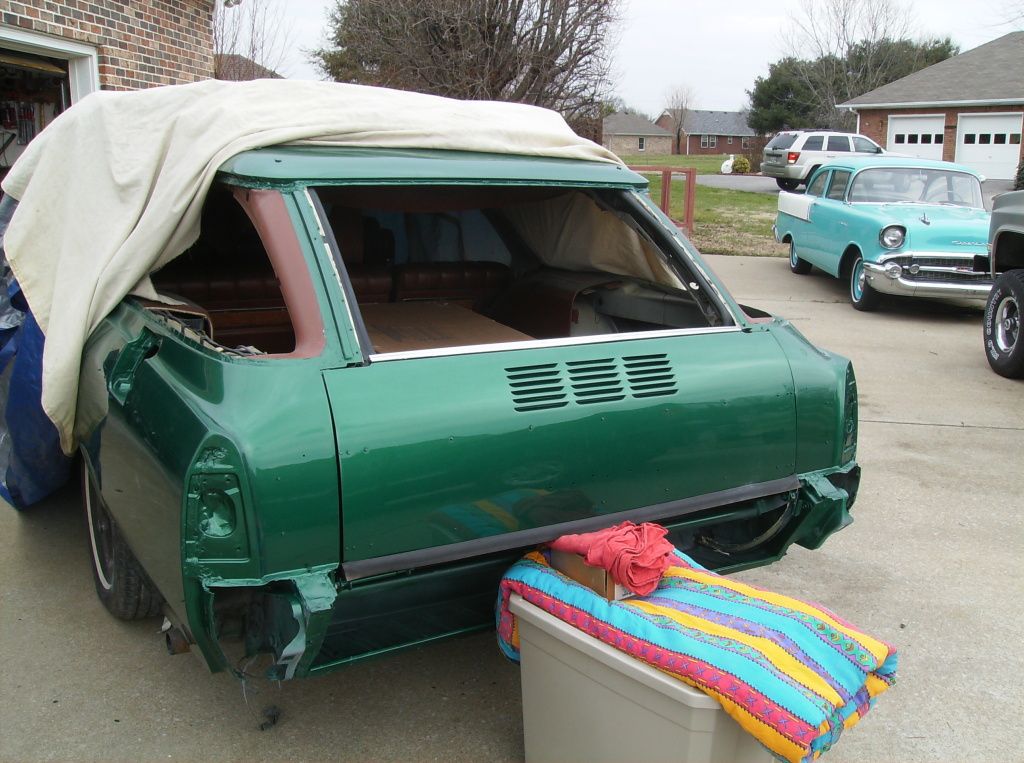

    It was time to get the tailgate on. To prepare for that I had to lubricate the tracks for the rear window and the tailgate. Both of these features are known to cause trouble if not kept lubricated, but especially the tailgate due to the fact that the force of the arm that raises the tailgate comes from one side rather than being equally distributed to both. This can cause severe binding and even tearing of weak metal if not kept clean and greased.
    I did both sides of the window track.
    [​IMG]​
    Then I did both sides of the tailgate tracks. Surgical gloves are a lifesaver here.
    [​IMG]​
    After finding a prop the right height and making sure there was plenty of cushioning between it and the painted surface of the tailgate I began bolting the gate into place. For some reason I had a temporary type of mental dyslexia and switched the passenger and driver side in my mind, causing me to put the bolts in the wrong side. I used plenty of anti-seize on all the bolts I reapplied today. I first started all the bolts in the tailgate and then took them back out one by one to apply the anti-seize because of the alignment of the gate as it was bolted on.
    This is how a mere mortal tailgate would appear when open, but not a clamshell. This is just the beginning. You can see the shims sitting in the back that I finished yesterday.
    [​IMG]​
    After getting it bolted up I did a few very careful test slides to make sure there was no rubbing.
    [​IMG]​
    After checking the alignment I propped it up so I could measure and trim the new rubber strips I installed yesterday. I also had to have it propped up because the tailgate motor is what holds the tailgate in place and it had to be up when I installed the motor if I wanted the tailgate to stay closed.
    [​IMG]​

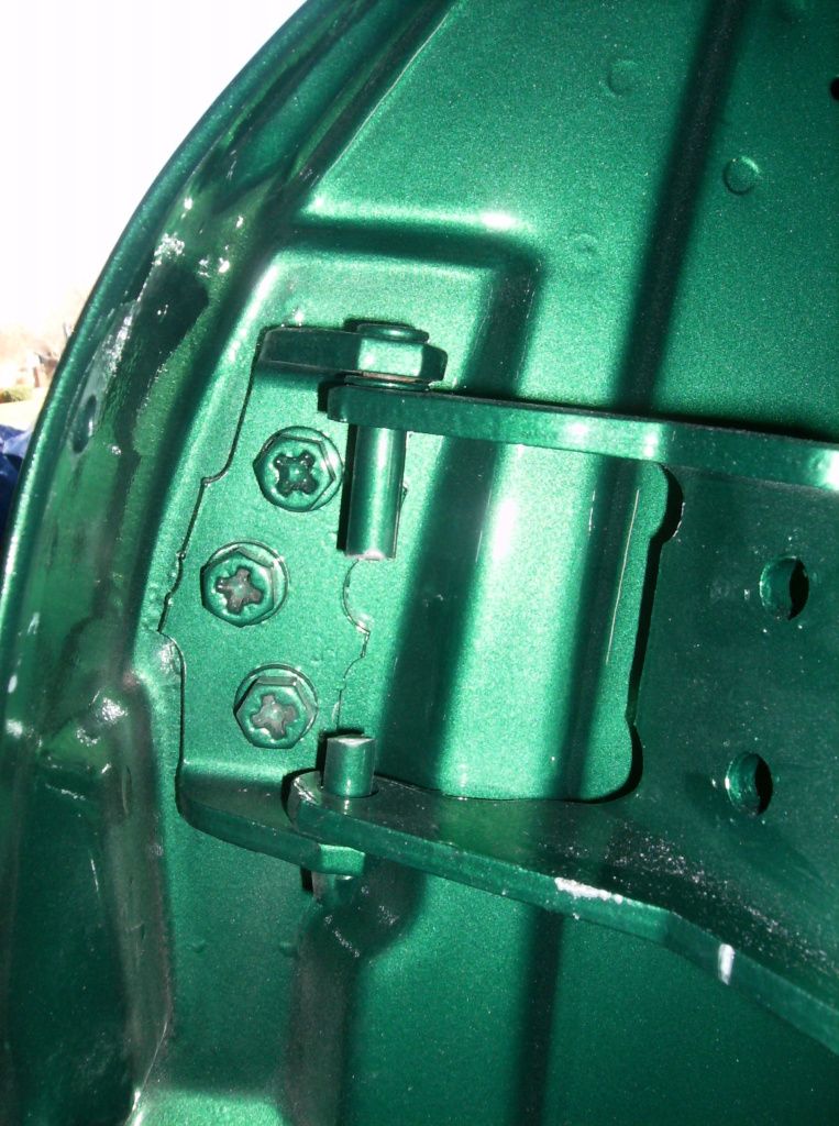

    While I was manually rolling the window down I noticed that one of the bolts to the track was loose. This would have caused the window to sit too low and not make contact with the rubberstripping so I raised the track and bolting it back in place.
    [​IMG]​
    With the tailgate propped up as far as it would go I installed the tailgate motor, but didn't hook any wires up yet.
    [​IMG]​
    I was pleased with the alignment. The gaps looked very good. These tailgates can have a tendency to sag on the passenger side but this one doesn't appear to have any problems.
    [​IMG]​
    [​IMG]​
    [​IMG]​

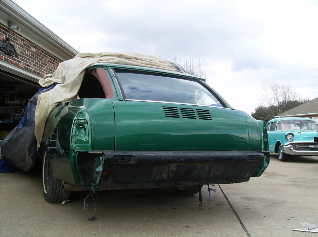

    The very first thing I did this day was glue the rubber back on the rear pan and let it dry. The nosy cows had torn it off one day when I had sat it next to the barn and gone to lunch. Fortunately they didn't tear or otherwise damage it, though it did get a good coating of cow snot. After I finished with the tailgate and window I reinstalled the much-heavier-than-it-appears rear pan.
    [​IMG]​
    After installation.
    [​IMG]​

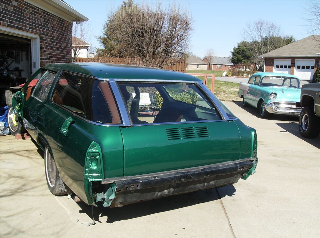

    I didn't put the rear bumper back on because I want to clean and polish it while it is off. Also, I called the window company and they are going to be here early Monday to install the windows. Today is Friday and I will be gone all weekend so that meant I had to finish polishing the rest of the window moldings.
    Until Monday The Clam will have to ride the storm out under the tarp.
    [​IMG]​

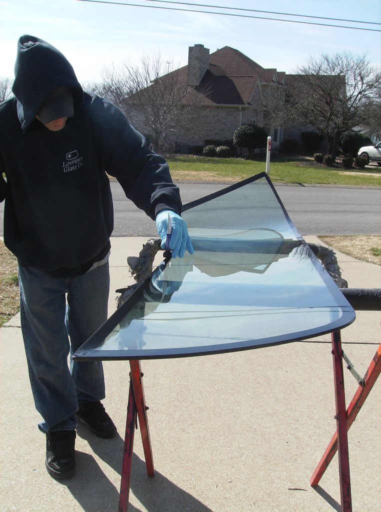

    The guys came today to install the windows. They both turned out to be really nice guys. They soon found out that the brand new clips I ordered were useless because even though I ordered the correct clips they are cheaply made and not shaped exactly right which made them have a loose fit which in turn would not allow the moldings to snap into place.
    [​IMG]​
    He applied a black coating over the windows' edge that protects the window glue by blocking the sun's UV rays. He explained to me that they legally are no longer allowed to use the same type of glue that was used originally on these cars. The new type of glue is much, much stronger.​
    [​IMG]​

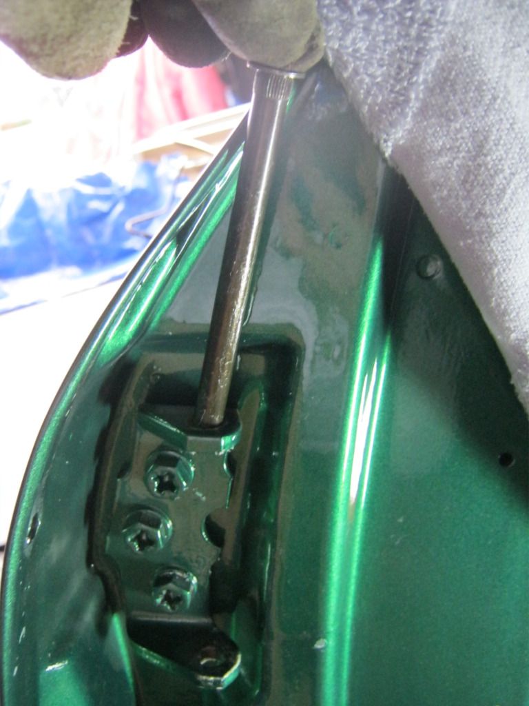

    After lunch I went to the parts house and picked up some door pins. I wasn't able to grind the head off of the pin so I cut the middle section out so I could use a punch to hammer each side out​
    [​IMG]​
    [​IMG]​
    Although the computer at the parts house said that all the pins were the same I was not surprised to find that they were not. The bottom pin for the rear door is supposed to be smaller than the others so I had to mark the new pin, cut it and then bevel the end​
    [​IMG]​
    I had to chisel the head off of the bottom pin to remove it. If you take into account the height of the head, these old and new are now the same size​
    [​IMG]​
    Removing the bottom pin was quite a challenge. Putting the bushings back in wasn't very difficult though. I used a socket to lightly hammer the top one into place and because I couldn't get access with a hammer for the bottom I used a pair of vise-clamps to squeeze the bottom one into place​
    [​IMG]​
    [​IMG]​
    When it came time to replace the top pin I ran into another problem. Because of the curvature of the door I wasn't able to hammer the top pin into place. I had to remove this part of the hinge from the door, install the bushings and pins, and then reattach it all as a whole. It took a bit of time to get it lined back up exactly as it was, using the paint outline as a reference. If I didn't get it right I'll have trouble getting the door back where it should go.​
    [​IMG]​
    Despite trying every idea I could come up with, with every tool I had on hand, I couldn't find a way to get the spring back in. I even tried compressing it in the vise and holding it with zip ties, but that didn't work either. I'll have to borrow a tool used to compress them I suppose.​
