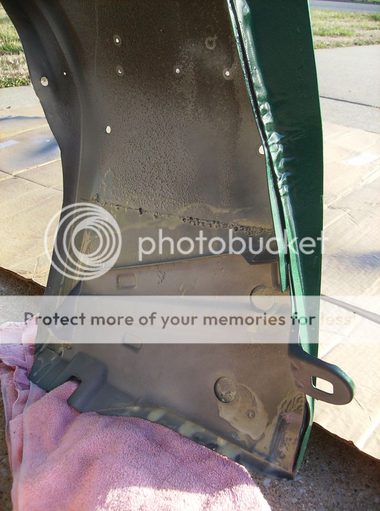

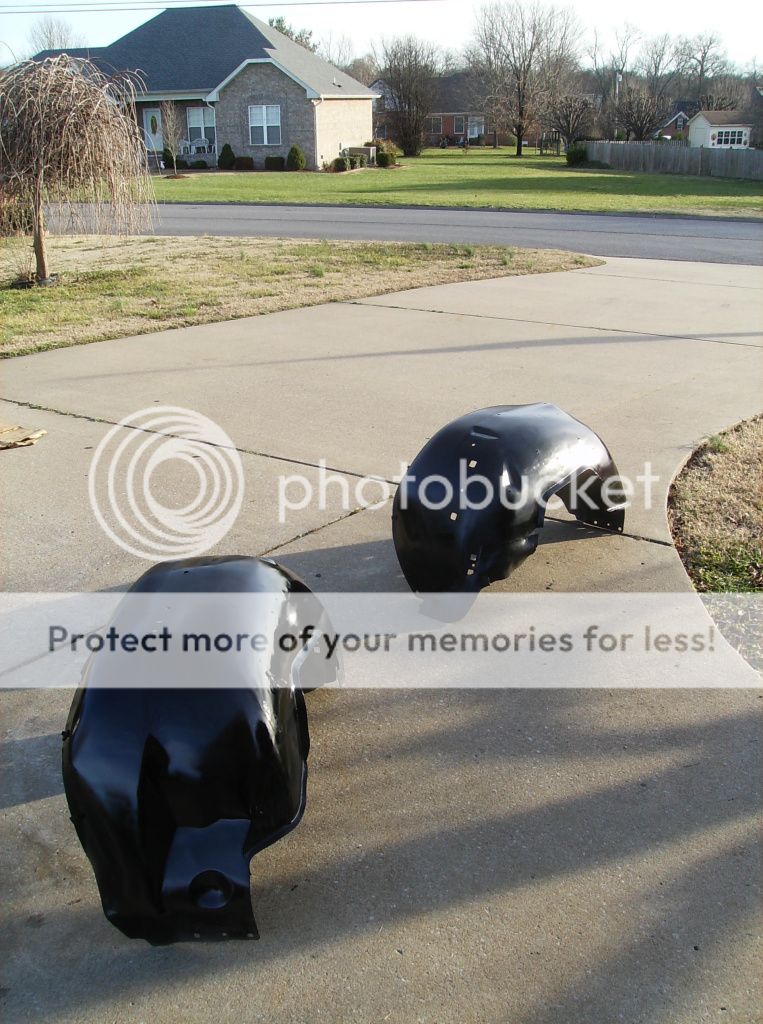

    Today was decently warm so I took care of a few smaller things. First up was getting the fender wells cleaned up. First I scrubbed them with soap, water, and a brush. Then I hit them with some sandpaper and water to get them ready for some primer.
    [​IMG]​

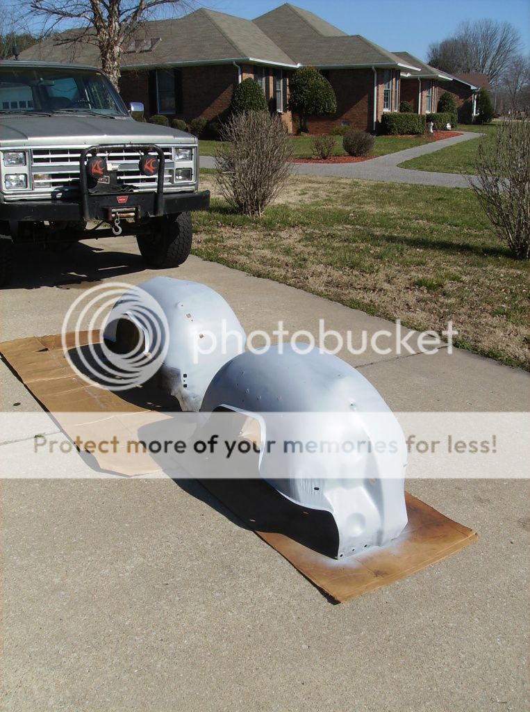

    Then came the high heat primer.
    [​IMG]​

    While at the bodyshop it was recommended that I coat the patch panel with a special rust preventative substance that came in an aerosol can. It sprays out in liquid form and leaves a film over the surface. They advised me to spray it and let it run down behind the brace. I continued until it began running out of the bottom, under the brace. This area should be completely protected now.
    [​IMG]​

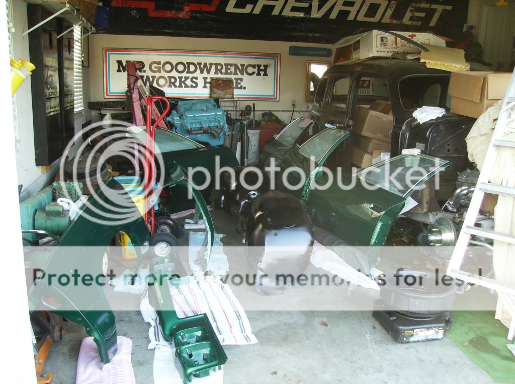

    Here's half a garage full of parts anxiously awaiting to be turned back into a massive station wagon.

    I LOVE seeing people this hardcore about what they are doing! MOST people would skeet some body color paint over those inner fenders and call it toast.
    THIS is is the art of automotive lovemaking!

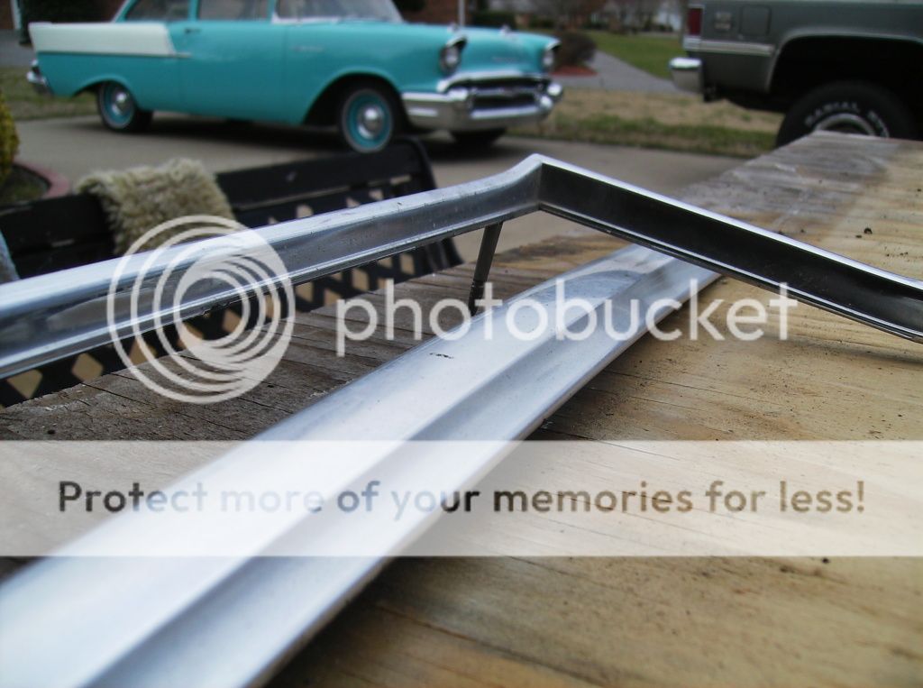

    There is a big box a trim that has been taunting me from the side of the garage for a couple months. Each time I walk though the garage it whispers, "You know, eventually you're going to have to clean us. Each and every one of us." Then is laughs like the bad guys used to in movies from the 1980s.

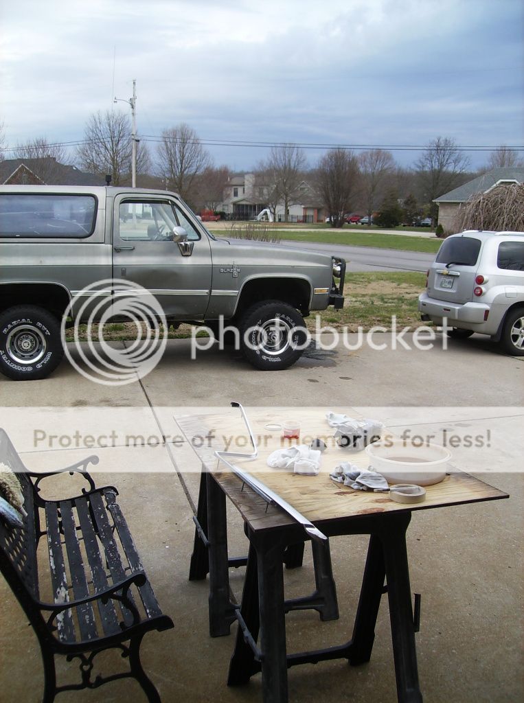

    I set up a high class, mobile, all purpose trim detail shop right there in my driveway. You can observe the kitty litter soaking up the coolant under The Blazer, evidence of the fun I had with the water pump, giving a nice ambiance to the park bench adorned work space.
    [​IMG]​
    I believe while this car will be a daily driver these details make the difference between a decent looking car and a good looking car. When it is all together and finished the polished brightwork may not be something a person will consciously notice, but it will give an overall greater appearance that those who see it will subconsciously be aware of leading to, in my opinion, an overall much better looking automobile.

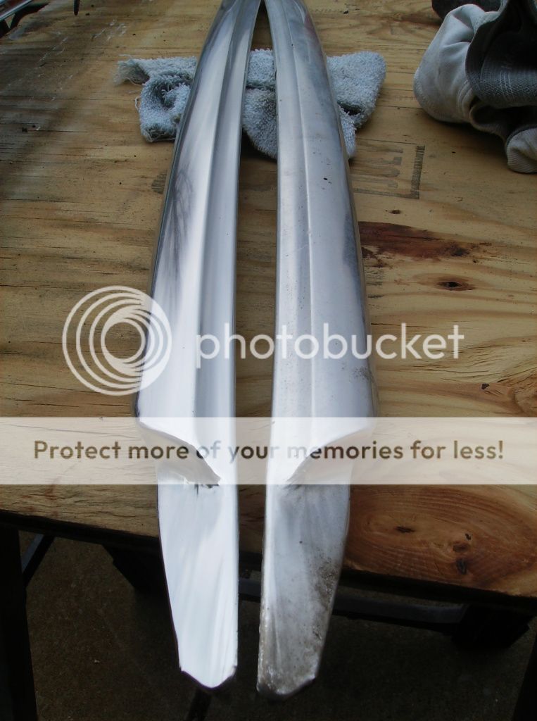

    For the aluminum pieces I would first wash them with water and then clean them with polish. For the chromed metal pieces I would first go over them with fine steel wool and then come back with the polish. I didn't bother taking many pictures because once you've seen one pair of dirty chrome pieces look shiny you've seen them all. The end result doesn't show up on camera quite as well as it does in person but it at least gives a small idea of the difference.
    [​IMG]​
    [​IMG]​
    I didn't finish all the pieces today as the air outside began to get too cool and I could tell that if I stayed out any longer I would be asking for a sore throat. Fortunately my super amazing work station is, as I mentioned, mobile, so I moved it into the garage to finish up a couple more pieces and then packed it up and called it a night. It was very nice to work on something that involved getting to sit down for a change.
