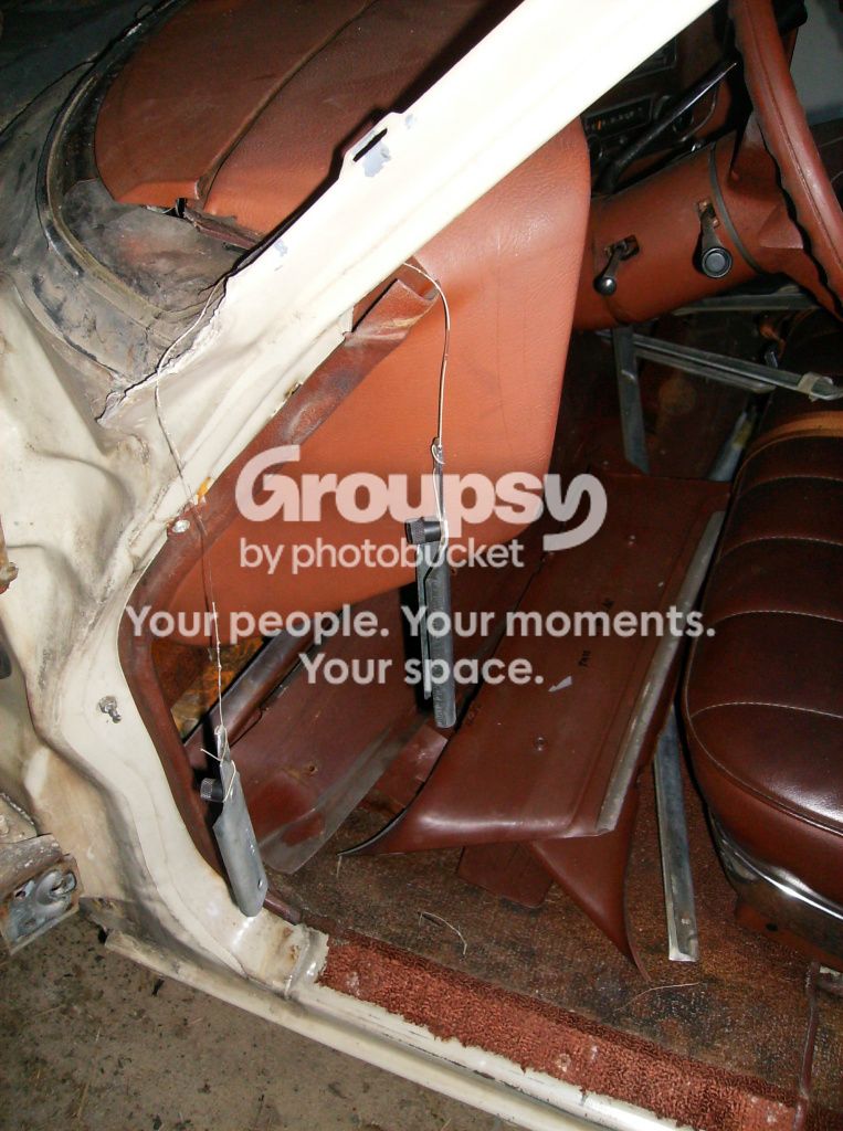

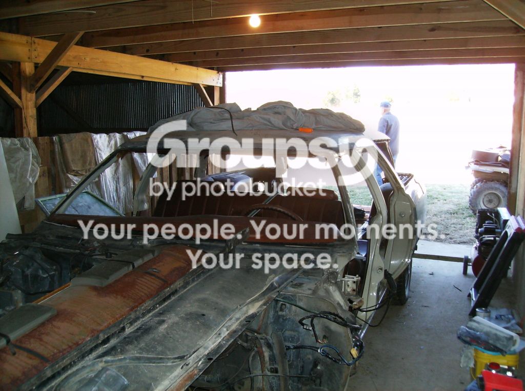

    This past Saturday dad helped me remove the remaining windows from the car. He borrowed this tool to help with the job and it came in very handy. You push the wire behind the windshield and then attach it to one of the handles and then each person pulls back and forth in a sawing motion to cut through the seals and sealer. It had a wire on it when we got it but it was in pretty bad shape and lasted halfway through the windshield, which we tackled first. After that I started using old guitar strings I got from a friend. This is definitely a two person job. As I mentioned before the previous owners had crammed as much filler behind the mouldings as possible to try to stop a leak. It would have been much better and cheaper in the long run if they had just had the windshield removed and fixed correctly, but they didn't and it left me with a big mess to deal with. I thought the windshield would be the hardest but it turned out to be the easiest and in fact in the areas where there wasn't any extra filler it was almost downright easy.

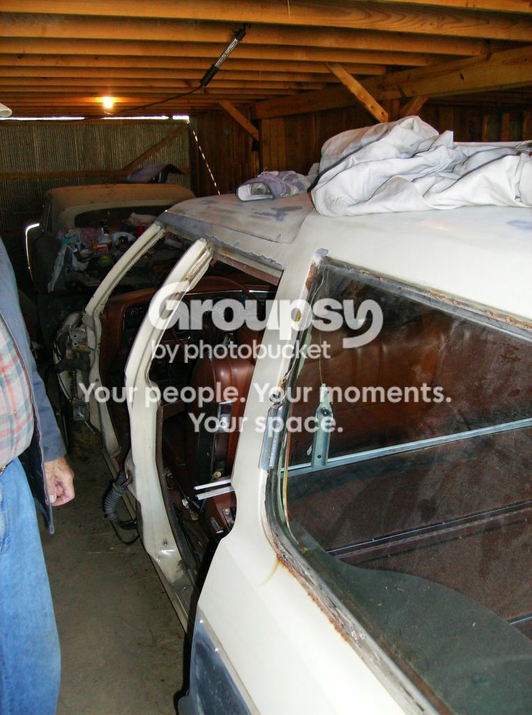

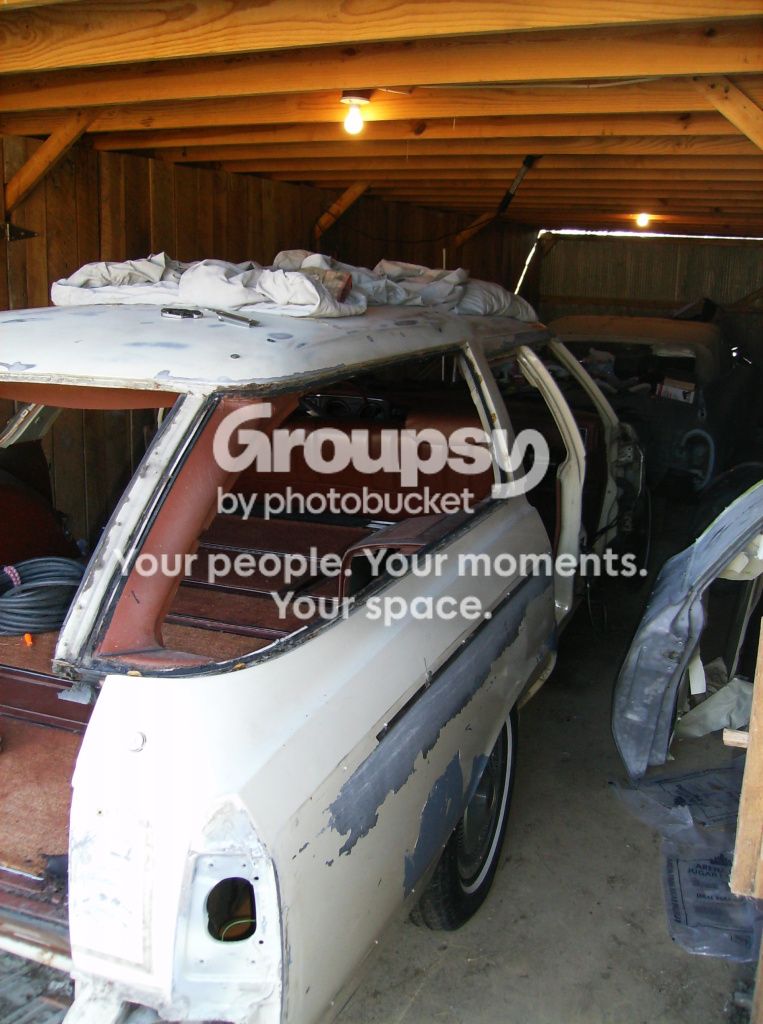

    After the windshield was handled we moved on to the side windows. I thought these would be easier but they turned out to be much harder. The corners were very hard to get to along with the rust on the bottom and also the extra filler that people had added to try to stop leaks made these very difficult. The rear curve really gave up fits until dad came up with the idea to run the strings behind the top of the glass and back out the bottom to be able to get around the rear corners.
    [​IMG]​

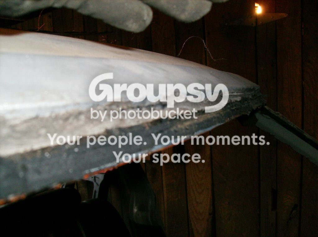

    Guitar strings definitely weren't made for this type of work and when we encountered rust or filler they didn't last long at all. I had relatively new strings on my guitar but fortunately I had this extra guitar at home that already had one broken string on it so we cannibalized it for our purpose. We ended up using 7 strings total, counting the ones I was given. The problem with the top 4 strings is that they were wrapped in copper which made them more coarse and better at cutting however the copper wrapping would come loose and then cause problems.

    The passenger side was actually really easy compared to the time we had with the driver side. There was much less filler, less rust, a few spots that didn't even seem to have sealer and also I used a razor to pre-cut the sealer. All this made for a much easier removal. We used a couple feed bags for protection and stored them in the loft.

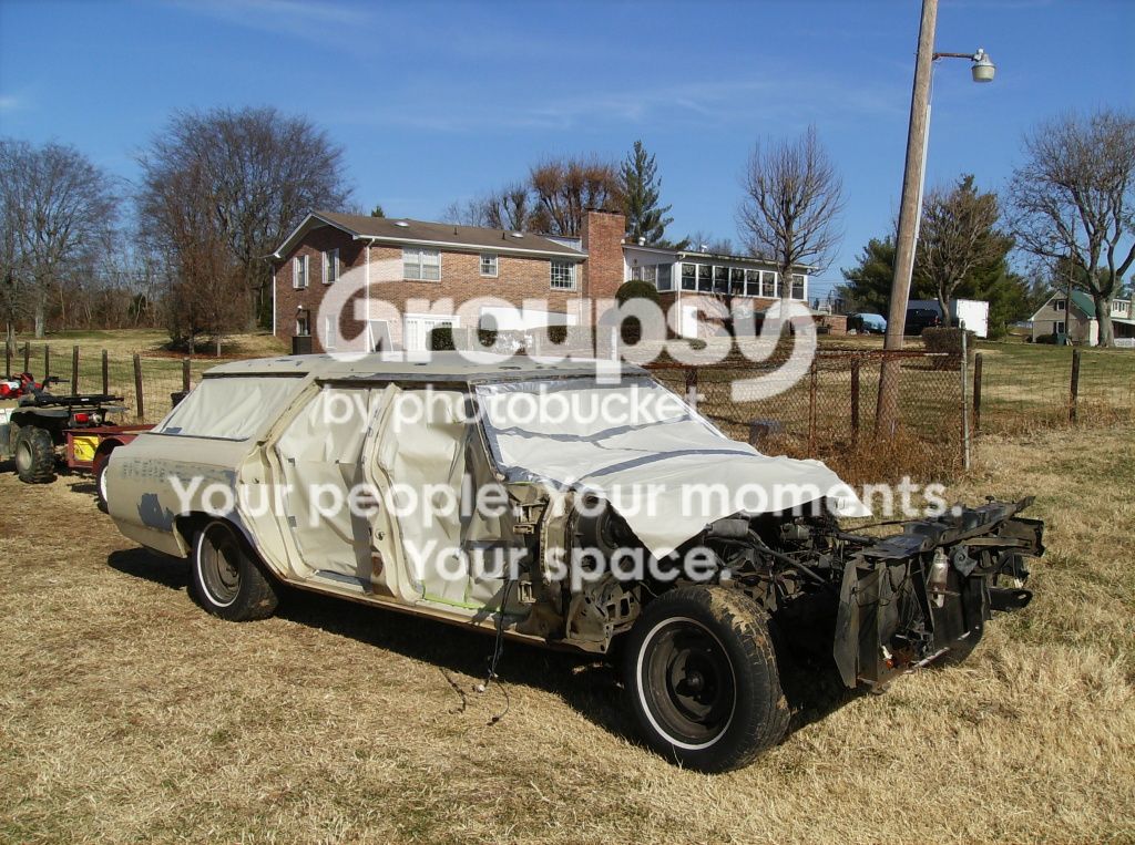

    Here it is sans windows. It's really beginning to look nothing like a car, which is pretty scary and more frustrating as I realize just how much further I've gotten into this project than I ever planned or wanted to. I hate to say it but had I foreseen this we wouldn't have bought the old clam but we're already this far in. I just hope I'm able to keep costs down so I don't have to sell it to get our money back.
    [​IMG]​
    [​IMG]​
    It only took around 2 1/2 to 3 hours to get all the windows out. If we had the right string and there wasn't any filler I think this would be a very quick and easy job. After we finished we went to see the new James Bond movie, Skyfall. We have seen every Bond movie in the theater since 1995 and I also have every ticket stub to every single movie I've seen since that same film in 1995. After 17 years, it's getting to be quite a stack.

    Another thing vetterman in that compartment where the rear door goes down in.on the right side where that pile of crap is there should be a factort elongated hole appx 4 inches long and anywhere from 1/4 to 1/2 inch wide DO NOT SEAL IT! thats your drain and as u see you need to keep it clean or you get what you have a PILE! lol
    Also all you guys pulling your own glass these windshields the ones WITH the antenna in the glass PUT your pull wire in at the center of the bottom by the antenna there is soft sealer there and it slides right in! the ones without antenna your SOL

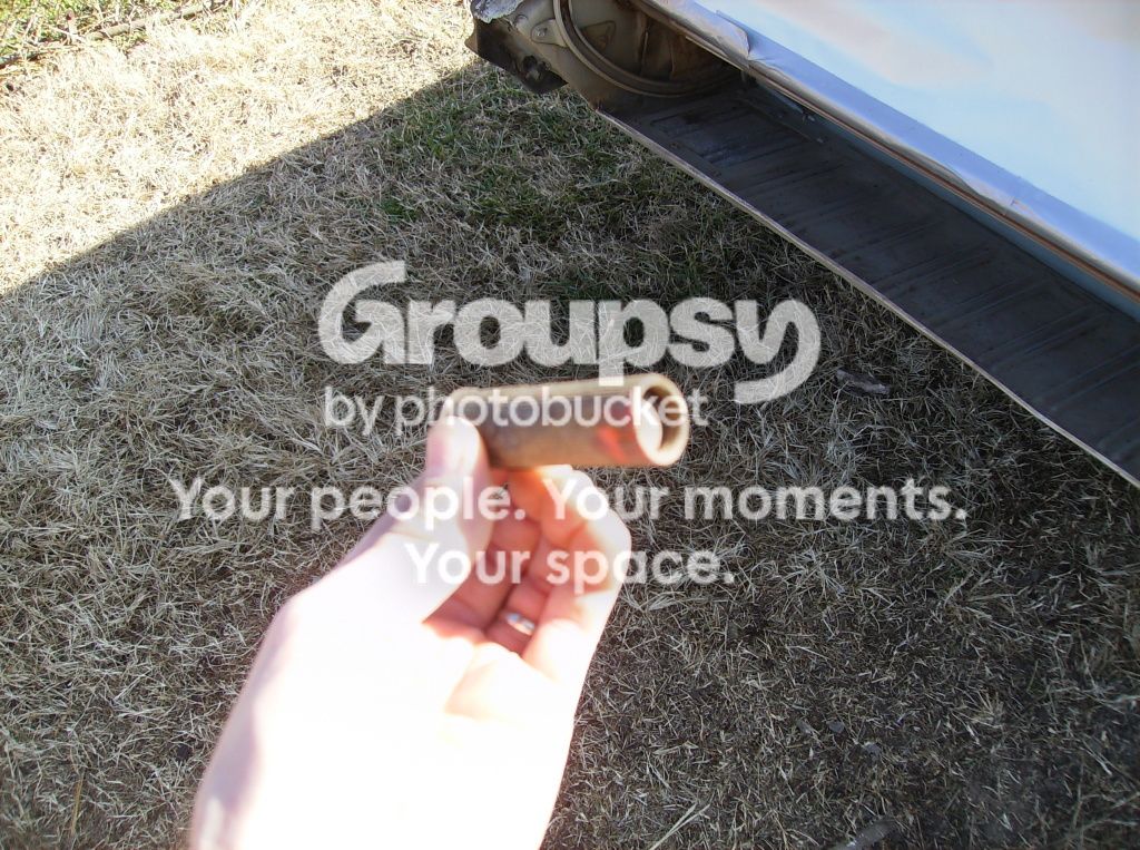

    Here was a surprise. This is the bottom storage area where the tailgate goes when it is retracted. It was filled with dirt and rocks. It was so thick and compacted, in fact, I had to chisel it away with a screw driver. I used a vacuum cleaner to suck up all the loose dirt after and soon noticed something wedged under one of the tracks. It was covered in dirt and all I could tell was that it was round. At first I wasn't able to tell if it was part of the car or something stuck. So far in the fenders and body panels I have found two matchbox cars, two sparkplugs, an antique screwdriver and hammer and a couple other small odds and ends, so there was the possibility this could be something foreign to the mechanics of the automobile. After a little prying I saw it wanted to come loose but was stuck so I ran the screwdriver up into the drain holes that are right below the object and began pecking it loose. When it finally came loose, I found out it was a live shotgun shell. I'm lucky I didn't blow my face off, or at least give myself a heart attack had it gone off. I don't have any pictures of what it looked like at first but after cleaning it all out I put it back where it was just to show the location of what I'm talking about. It was so old and dirty, there was no way to tell what it was at the time. It looked more like a piece of round wood.

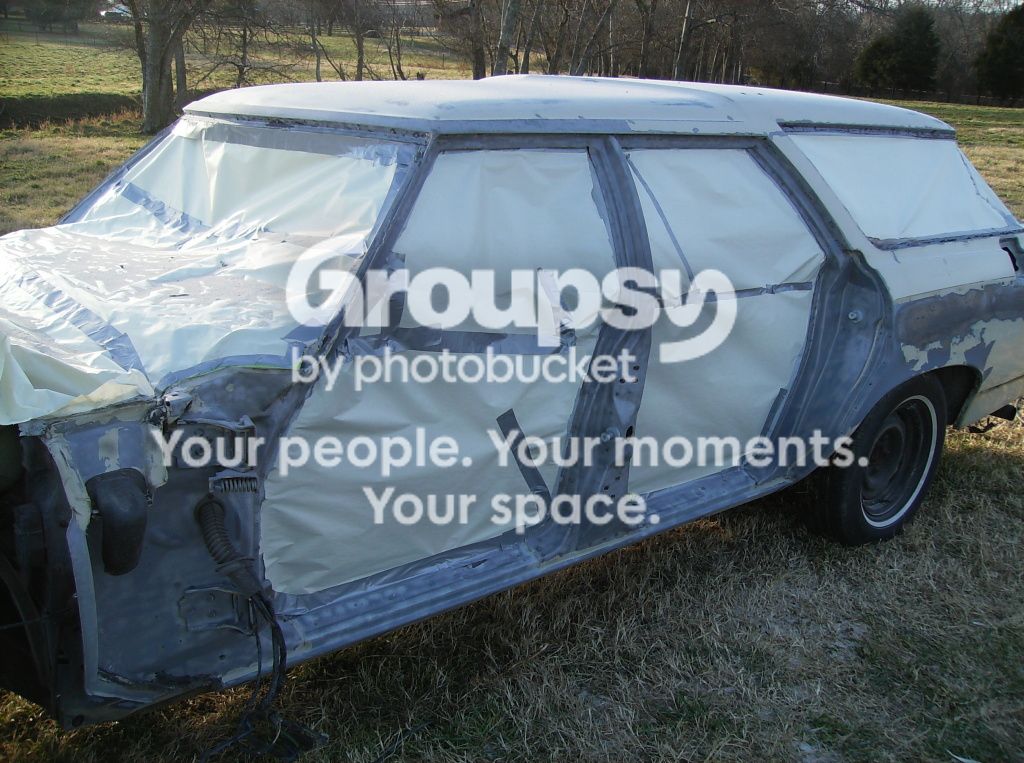

    It took an entire day to tape off all of the openings to the car and cut paper to fill the gaps. I know it won't keep all the sand out but it will keep most of it out. I go through about 4-6 bags of sand during this process and without these holes covered the majority of that would be inside the car.

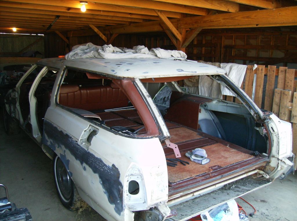

    I finished all the door jambs, windshield channel and rear window channels and gas door opening. Next will be the quarter panels, tailgate storage area and small parts of the rear. Here are some before and after shots.
    [​IMG]​
    The areas that are still body colored are actually areas of seam sealer. This is a sealer used by the factory to seal body panels together and keep out dirt and moisture. This will not sandblast away, which is a good thing, however it will not change color when sand blasted. By blasting it I'm basically just cleaning it so it cane be primered back over.
