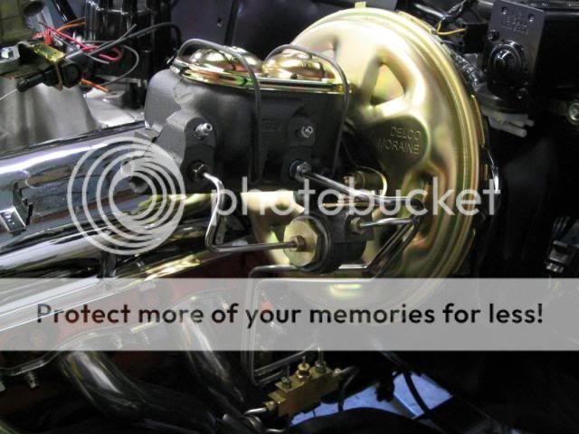

    I also would suspect that an icorrect Master Cylinder, propotioning valve, or rod being the issue, or a combination of 2 or more. If the peddle has exessive travel it would lead me to think that a manual brake master cylinder was used, anouther possibility could be the wrong proportining valve, the GM 67-69 disc brake systems used the same master cylinder as the drum brake cars, they just added a delay valve to the rear drums. That let the front brakes operate slighty faster than the rears preventing rear wheel lock up. You can see the delay valve up by the Master cylinder of this 67 Chevelle in this picture. What looks like a propotioning valve below is just a distribution block with the warning light switch.
    The 71 and later systems use different Master cylinders for disc or drum brakes, and a proper proportioning valve. The one pictured below is not stock, but the valve is the same, and is usually mounted on the inner frame rail below the master cylinder, and combines the distribution block, and the warning light switch into the proportioning valve.
    I would double check the P/N's of Master Cylinder and Proportioning valve (and Type of Valve)
