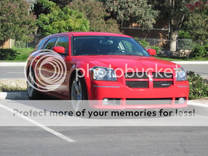

    Went to see what kind of Ford you have (got 2 '71 Mustangs here) and noticed your Magnum. Love those, glad we were able to secure one before they went away. Guess I can post a pic, it is a wagon after all...
    Mommy's Red Monster:

    Ooooo.... Nice SRT. Love my Magnum...
