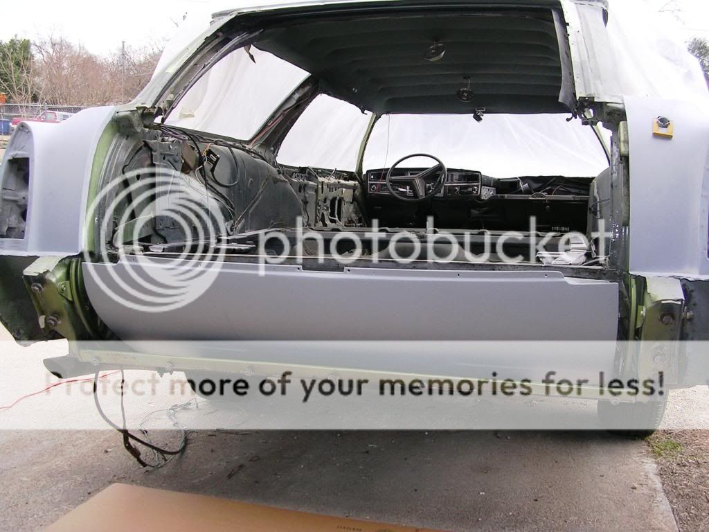

    Hey guys,
    I want to show the tailgate workings as I reattach the tailgate to the roller mounts and regulator arm.
    Hopefully, this will show how simple this tailgate assembly really is, and take some of the mystery out of how it works. :2_thumbs_up_-_anima
    This first pic shows the regulator assembly with motor.
    This is the regulator mounting arm.
    The tailgate is ready to be attached.
    This is the LH roller mount. It is attached to a crossbar over to the RH roller mount. A nylon roller rides in a curved track mounted in the tailgate stowage area.

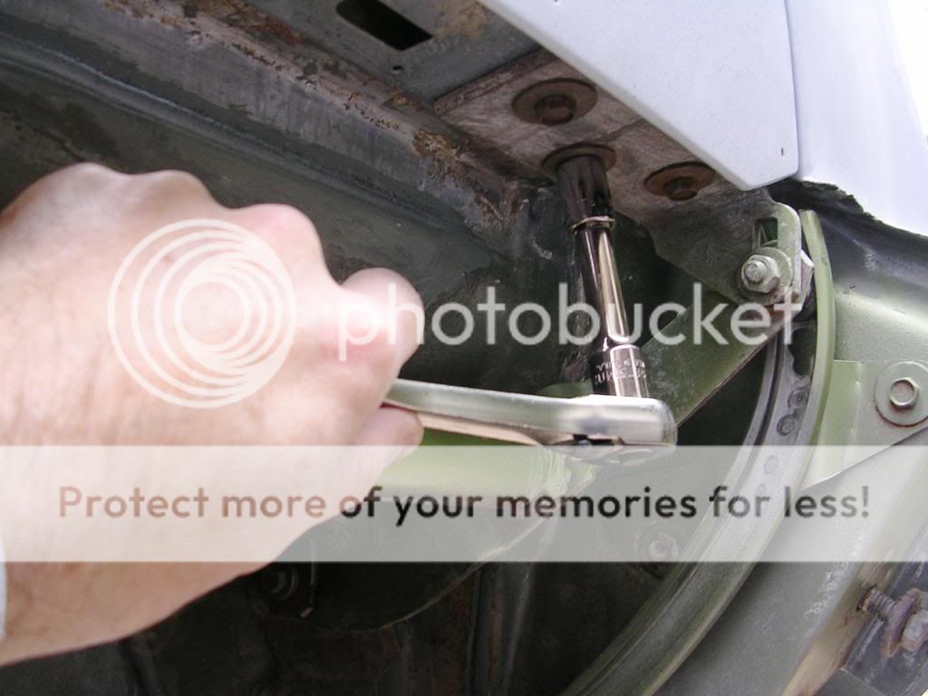

    Three 7/16 bolts attach each roller mount into each lower corner of the tailgate.
    Once all the bolts are in place, but not tightened, pivot the top of the tailgate upward to meet up with the regulator arm. Three large phillips screws attach it to the inside of the tailgate...tighten just fingertight.
    Now the tailgate can be adjusted for fit.
    This shows the striker and locator...I had this part out for cleaning. I also adjusts, and will affect alignment.
    Now the tailgate is in place and it lines up pretty nicely. Goes ahead and make sure all nine bolts are now tight.
    I will show the lowering and raising of the tailgate in the next post.
    David :)

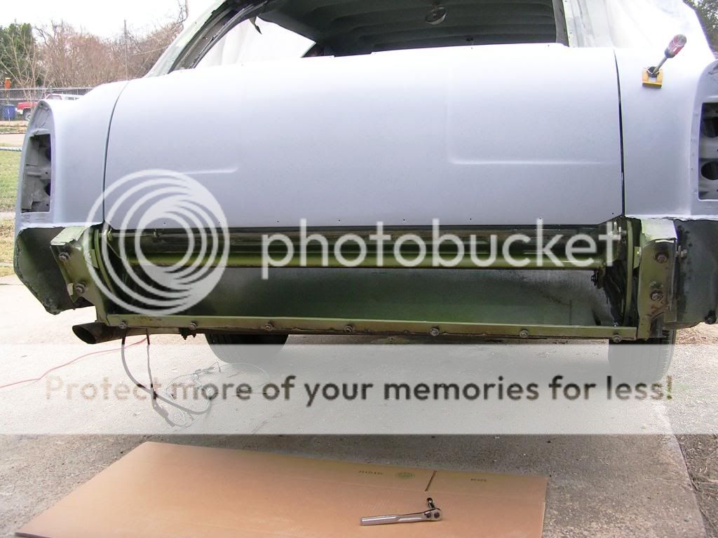

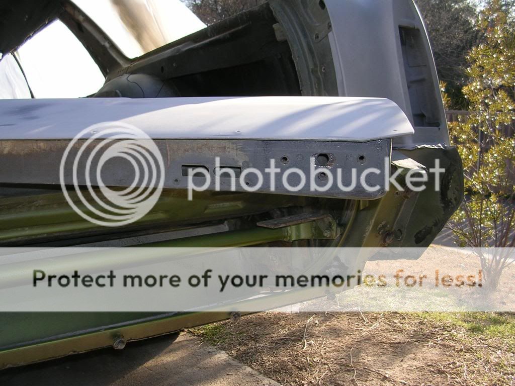

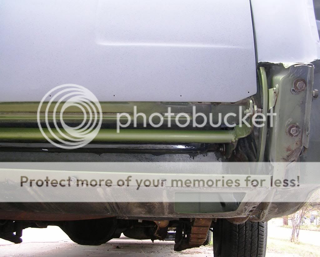

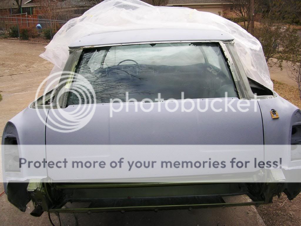

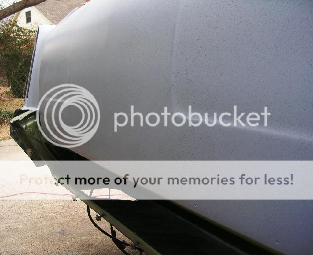

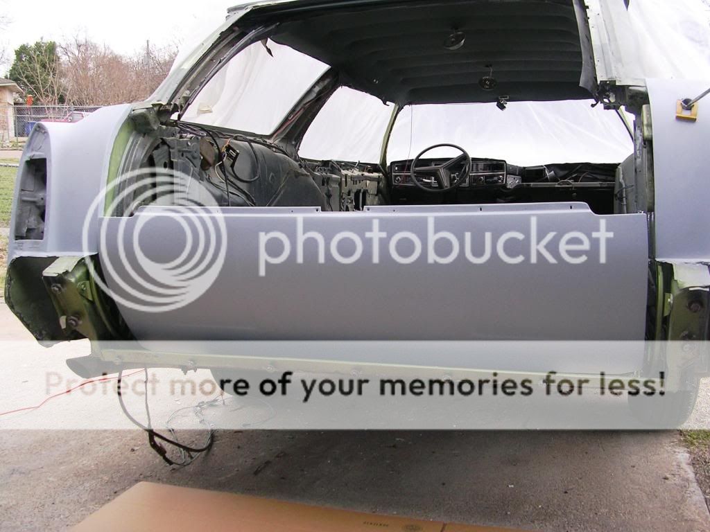

    This post will show the lowering of the tailgate as it glides down into it's stowage area.
    Now, raising the tailgate.
    The RH side as the tailgate is lowered.
    My next post will show some of the problem areas of this system. :slap: :disagree:
    David :)

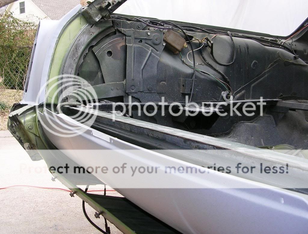

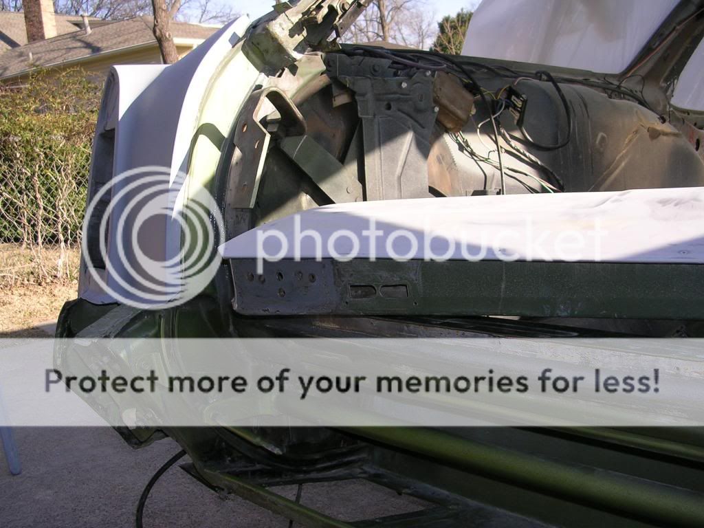

    These are some of the potential problem areas of the clamshell tailgate system.
    The bottom mounting point of the tailgate panel on the LH side is prone to stress cracks and tearing. Rust can form in the area when dirt and leaves get into the panel, and then trap moisture.
    The LH side of the tailgate is under stress when the regulator arm pushes and pulls the tailgate.
    If the tracks are not lubricated, the stress is higher.
    Once this mounting point tears, the tailgate is out of alignment, and the regulator and rollers have to struggle to open and close the gate, causing more stress to the entire assembly.
    My tailgate was broken in this area, and I had to insert new steel, and weld it up.
    Easy fix...and without it, I would have never been able to align my tailgate.
    It was very noisy and sluggish in operation, no matter how much I tried to adjust it.
    Notice the LH roller mounting shaft is at an angle instead of parallel to the bottom edge of the tailgate.
    Not the best pic to show this, but see how the shaft is parallel to the bottom edge...it is not bound up and struggling anymore. That tailgate lines up.
    I had no idea this mounting area was torn until I removed the tailgate.
    RH mounting point...it was fine.
    The tracks should be cleaned of old dried lubrication and dirt, and relubricated. The cleaner everything is, the better.
    The LH roller mount actually moves on this shaft, allowing lateral movement. This is also a point that should be lightly lubricated.
    Hope this helps!
    David :)

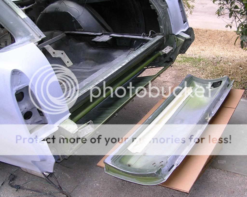

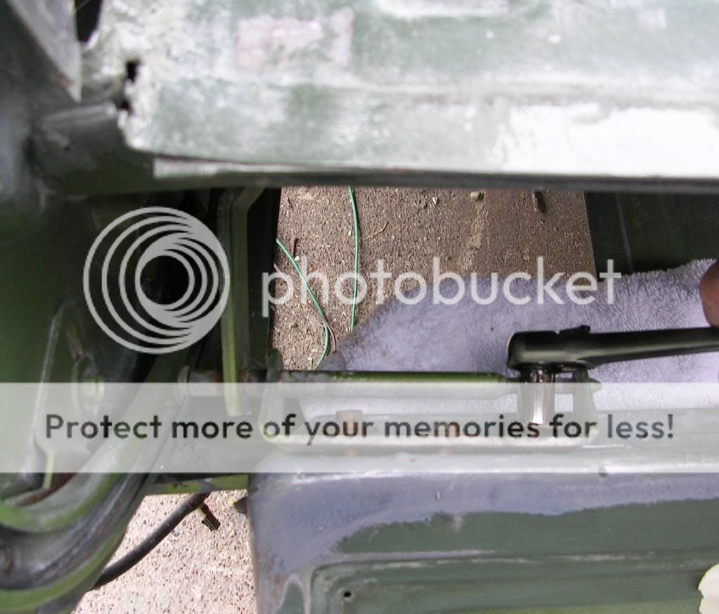

    Hi Paul, welcome! :Welcome: Glad you found us!
    It makes me smile to know that you are finding my photo guide useful in working on your clamshell tailgate.
    I removed my torsion bar when I was going through the system, because water had collected in it's mounting channel, creating a trough, and rusting the torsion bar. I soaked the bar in metal conditioner, and then coated it in Por-15.
    I would remove the torsion bar when removing the tailgate. It frees everything up so you are not fighting against it's subtle pressure. Plus, unless your wagon has stayed amazingly dry in this area, it will probably need attention in this area.
    CORRECTION: I was incorrect in advising removal of the torsion bar when removing the tailgate. It is not necessary. The torsion bar assists the regulator with lifting the tailgate for closing, for both electric and manual operation.
    Removal of the tailgate is accomplished solely by the removal of the three large screws attaching the regulator arm to the gate, and the six roller mount bolts-three each side- on the bottom.
    However, it is still advisable to check the torsion bar and it's recessed housing for corrosion.
    When removing the tailgate, putting a bolt or small tool in the keyhole-shaped holes in both roller tracks is advisable. Doing this will help you from having to hold the gate up after removing the three bolts that attach the regulator arm to the tailgate. The tailgate will want to roll down on the tracks as soon as the upper arm is unbolted, and these will prevent the rollers from moving downward more than a few inches.
    Make sure you have towels or something to perhaps protect the outer finish and trim from possible damage, if you have to stop in the middle of removal or installation, say, to retrieve a tool, etc. Gloves are helpful, too.
    Take pics, and show us what you are doing! :clap:And ask more questions! Questions are good!
