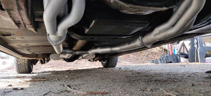

    So exhaust is finished. ended up only being bits of the kit used. Buddy put in a wideband o2 bung, but the location isn't going to work, since 90*. Will be enough to get the EFI kit started though. Overall pretty happy. May end up putting on quieter mufflers, since its a bit much first thing in the morning.
    [​IMG]IMG_20200307_135726 by Jacob Ronald, on Flickr
    Took the car up to VT to go snowboarding. Cruises way easier at 70ish. 15ish mpg, even with the mountain driving. Ride with the new helper shocks and attached swaybar was a lot better! Ordered a set of the Moog load carrier springs for the rear to help control it a bit better. Hoping to get them in this week, for another trip north this weekend.

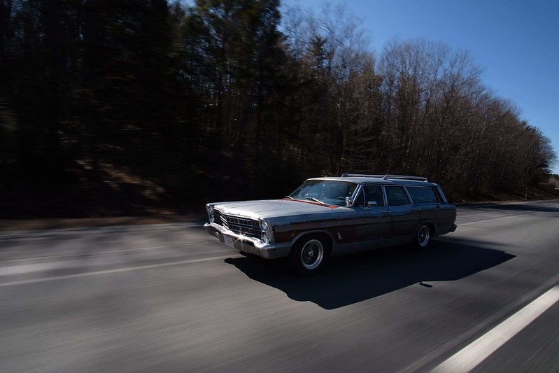

    Back from the trip, and mostly trouble free - with the upcoming time at home, going to likely get a start on redoing the wiring in the car, with appropriate weather proofing. Friend took the roller photos - lighting wasn't cooperative, but still looks pretty good to me.
    Have everything to get started with the EFI install this week. Hoping to have it apart tomorrow given the good weather, and continue it through the not so good. Coil died on me today, but thankfully was next to a Napa that had one on the shelf.
    Looking at autocross capable wheels/tires - planning on the Nexen 275/40/18 in the "drift" compound. ends up being slightly shorter than the 215/70/15s I have on there in this photo (27.1 vs 26.7), but significantly wider. During test fitting, noticed rubbing on the upper control arm with the 15x8 +0 bullitts I had on there (with a 7mm spacer to clear the calipers). Test fitting a single 18x10.5 +22 with a 2" spacer shows similar wheel spacing. I've run the 15x8s with the spacer upfront to see if pushing the 215 out 2" would rub, and no surprise it does on the inner fender hex heads.
    I did run into a small issue before leaving for the trip, Was going to swap the radiator out as it was leaking a bit. unfortunately, the transmission lines were twisting with the fittings, so stopped before damaging anything. I've used inline tube in the past for my 97 f250, and they make stainless lines for the galaxie / country squire. Started with just the transmission lines, but will likely get the brake lines when it comes time to convert the rears to disc, and service the fronts.
    Going to mockup a shroud for a 16" electric fan, if I can get molding supplies.
    OrthmannJ likes this.
  8. OrthmannJ
    16,609
    4,754
    Even with "bad lighting" your car looks fantastic in motion.

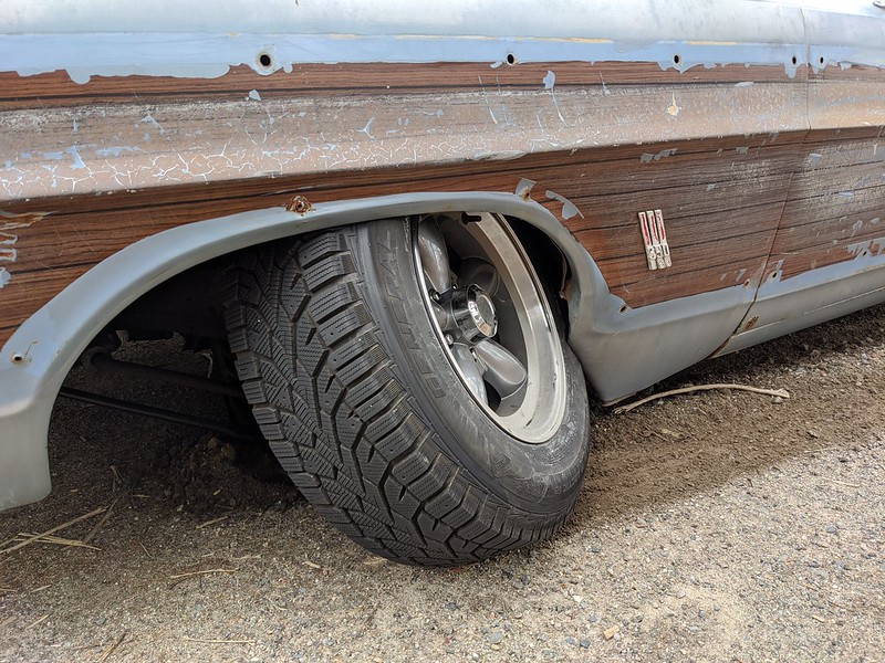

    Welp, Slight setback this week - took the car shopping before MA closed up more shops - pulling back towards home, lower ball joint decided it was no longer friends with the arm:
    [​IMG]IMG_20200323_113635 by Jacob Ronald, on Flickr
    Unfortunately, wheel pushed back into the fender, so its bent / misaligned with the door.
    [​IMG]IMG_20200323_113639 by Jacob Ronald, on Flickr
    I've been fortunate to have gotten all the travel I did on original parts - worrying about this, I had already ordered an SKFbearing set for the front, along with new rotors / pads. Was procrastinating on the upper / lower arms - had found OEM style stamped replacements for $270/side for the lowers, which with the autozone discounts came down to ~$400ish for the pair. Since I was planning on the coil on shock conversion (and have the shock / spring setup sitting at the house already, trying to get hands on the updated aftermarket lowers, so I don't need to reinforce the stud pockets.

    Holey carp man! Bet that scared the daylights out of you. It totally stinks that it caused some body damage, but I'd say it could have also been a lot worse. Looks like your time frame for some upgrades has moved up slightly.
  13. Doghead
    13,821
    5,783
    How sloppy was the steering, before that happened? I had the same thing happen on my Super Beetle. But, on the right-hand side. Losing control of the steering was quite frightening. Especially, because the steering was tight with that new Hecho en Mexico balljoint which popped out. That was my lesson for going cheap. When I returned the balljoint to where I bought it, the owner seemed embarrased and exchanged it for a German one

    Exactly - could have been, way, way worse (like on the highway offramp earlier that day, or on the ski trip in VT the weekend before in the mountains).
    Steering hasn't ever been exactly "tight", but thats comparing it most recently to a 1990 miata with a manual rack. Just assumed any play was part of the steering box that the seals have failed in (see the sludge in the photo above). While the tires were wearing evenly, I was noticing a hair more rub on the drivers side I should have investigated.
    I still had some steering after this - jacked the car up, took the wheel off, and lowered it back down on a 4x4 sheet of plywood and moved it to its current location. Those joints in the steering dont look any better. This isn't ideal timing for everything, but needs to be done to go safely down the road.
    Its a chance to clean up everything under neath at the same time, and plenty of downtime coming.

    This, to me, looks like the perfect opportunity to pull the engine in prep for the replacement engine, and then pulling the clip off, both to fix or replace the fender, but also to rebuild the steering and suspension.
