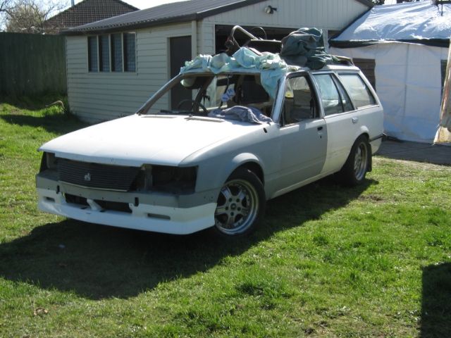

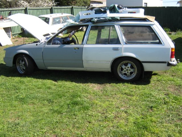

    Well springs finally kicking in so will start getting some work done on the old girl soon, having a spring clean in the garage at pres. Fired her up a couple of weeks ago, started no worries just stale petrol being a pain so got some fresh petrol in her & today a new set of spark plugs. Started 1st pop & purring like a kitten - sure need to get an exhaust on her though i no that much....
    Will be doing this & another i've been working on as well, i'm addicted to these things that's for sure. I'll keep this updated as i go, mite start a thread on the other one soon to.....:)

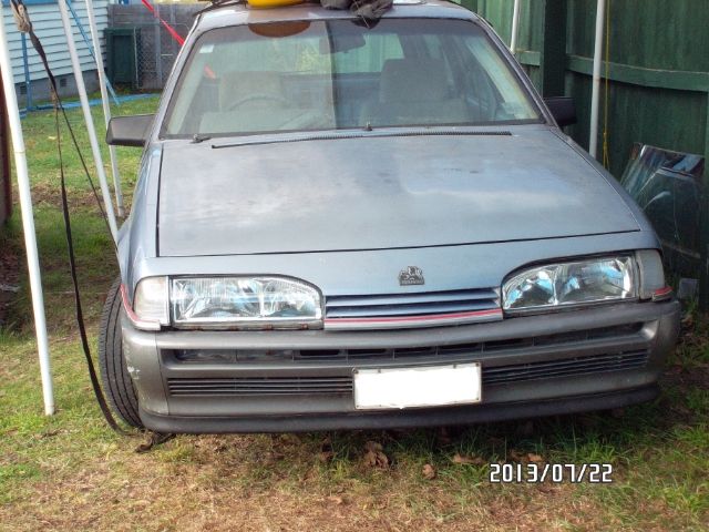

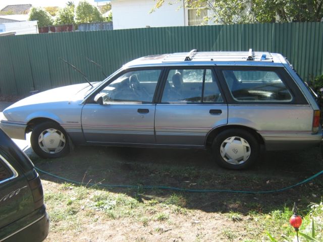

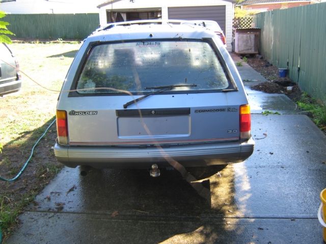

    Thought i'd chuck up a couple of pics of wagon number 3 i'm doing some work on as well, this ones an 87 Commodore. It was the parts wagon i bought for spares & silly me washed it revealing a really tidy wagon under all the crud, guy i got it off was going to demo derby it so she's had one very lucky escape lol......

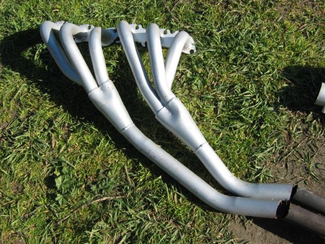

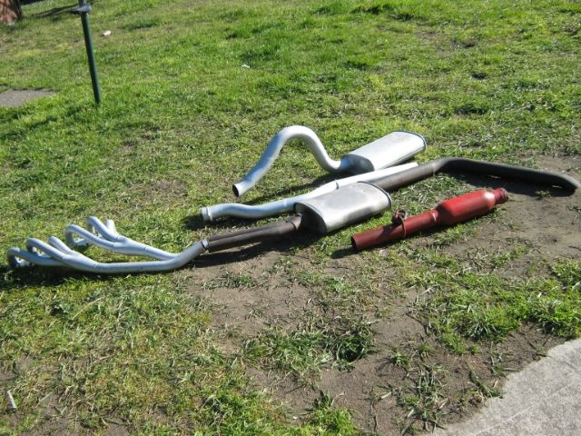

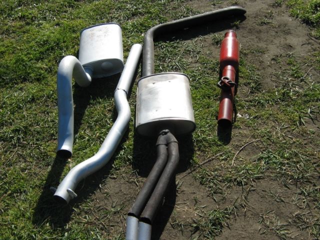

    Scored some more goodies for the old girl today - set of flows & a heap more pipe. Was on a track car that got the turbo treatment - he's got a heap of other bits i'll be grabbing over the next couple of weeks as well. Getting quite a good collection of bits in the shed for her now:)

    Started on the exhaust side of this, took the old exhaust manifold off carefully as to not break any studs only to find someones already broken 3 so that will be a mission to sort at some stage. Broken off flush with the head which is a common Rb fault - good news was the Extractors fit with no mods needed so that was a bonus. Will get some flanges for the exhaust soon then mig her all up, will be a straight through system so should sound the goods.....

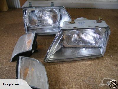

    Bought some more bits for the old girl today, going to try out a stage 3 chip in her. Was going to buy a cam as well but a good deal came up on auction so i swooped on that for now, brand new Vk Lights & indicators for $140 delivered. To good a deal to turn down, should tidy the front up bigtime......
