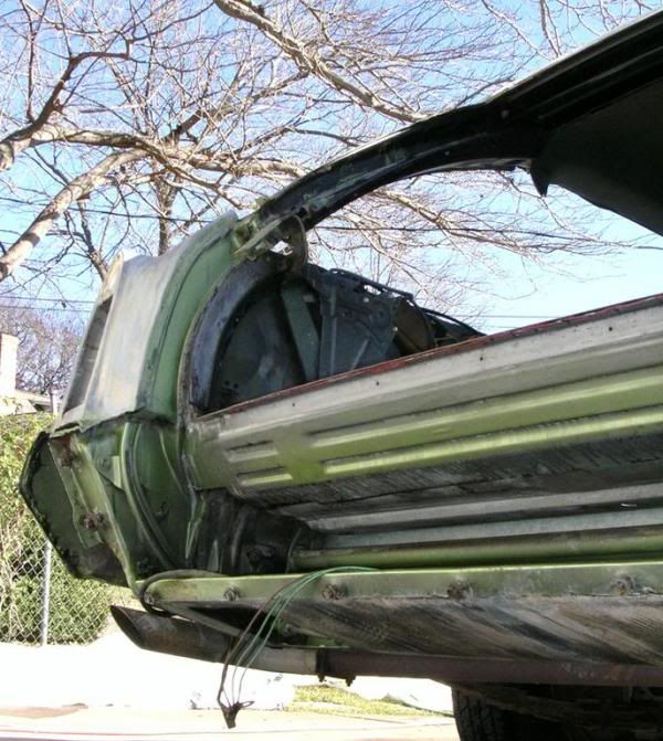

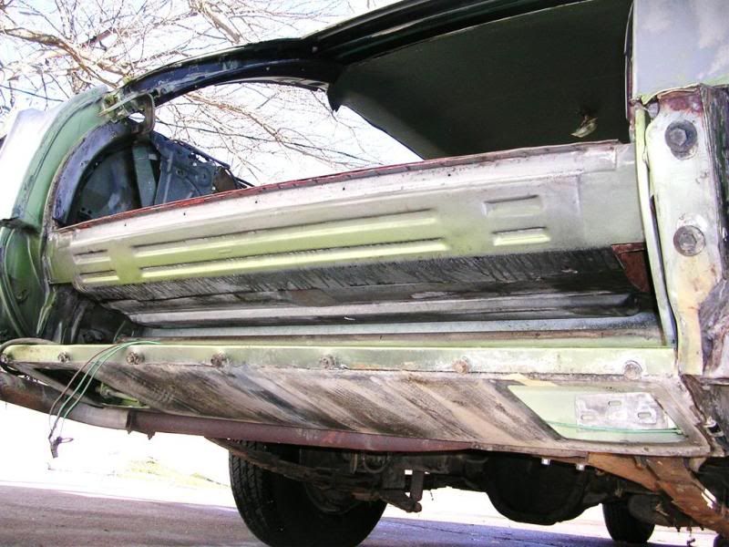

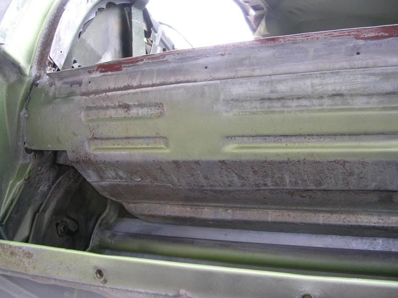

    More pics of the lower tailgate storage area. GM used galvanized steel for some of the pieces back here, but barely blew any paint up in this area.
    I have been scrubbing this area with PPG metal cleaner and PPG metal conditioner and a scotchbrite pad to get rid of the surface rust. The red in some pics is a stubborn seam sealer that I am still getting rid of.

    That seam sealer might have a silicone content too. There's no legal remover for that, and I can't recall what the 'illegal' remover was. A bodyshop supplier might know. Gasoline used to work to soften it up.

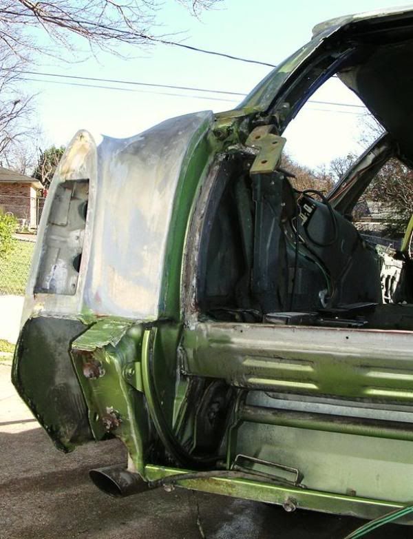

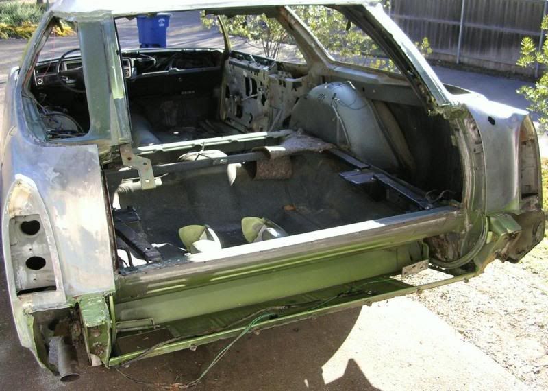

    Luckily, this red seam sealer doesn't have any silicone in it, it is just hardened and quite tenacious.

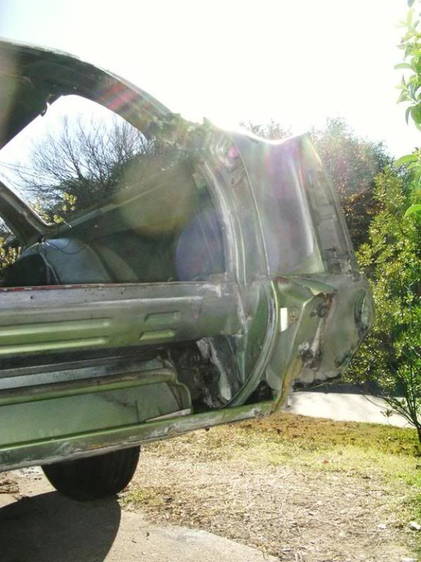

    Today, I continued to work on the back of my wagon, cleaning the all the nooks and crannies.
    These pics show the extensive use of galvanized steel in the areas under each taillight housing, and the entire tailgate storage area.
    I am sure glad these areas used galvanized steel, because paint is sparse.
    I haven't stripped any paint back here, just scrubbed with Marine Clean and a little plastic brush, and it is clean, bare metal!

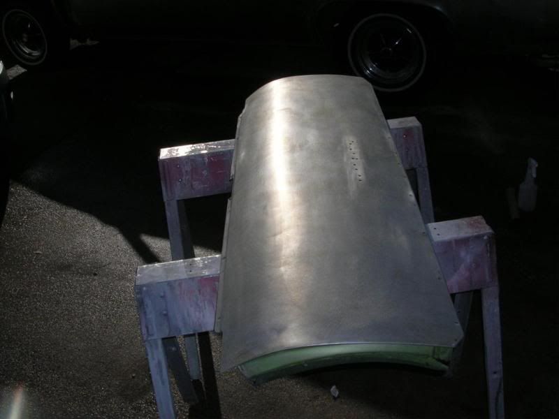

    I finally stripped my tailgate and cleaned it up. I had to weld in a new piece of steel at the LH lower corner where it mounts to the roller.
    Tomorrow, I am working on my RH fender :smash: ...pics to follow.
    David :)
    PS. It was in the mid 40's today...headed for 27 tonight. Glad it was sunny. I wear longjohns on the cold days and always have on latex gloves, so it is all good. Tomorrow will be warmer.

    David, vinegar is a good pre-primer etcher for galvanized, after all the cleaning is done. Looking better every day.:bowdown:

    I am surprised how much galvanized steel is actually in the build of these wagons. Shows me that the General wanted these wagons to stick around for a little while. Still, painting them properly, coating everything, would have made a big difference in rust prevention.

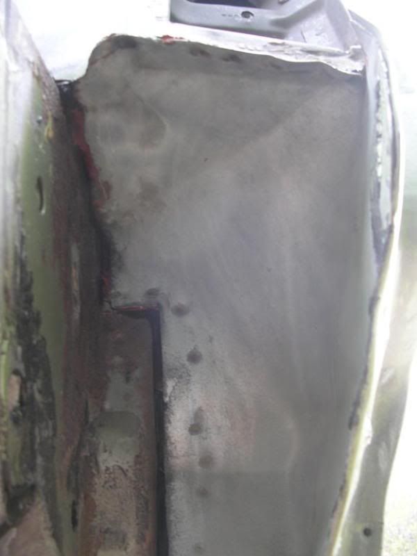

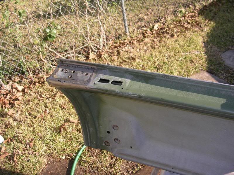

    I just came in from the cold, been working on my RH fender today. It had some ugly damage to the leading edge, that I found upon stripping it. I cut the whole upper end cap off and welded in a perfect piece from a damaged parts fender. It's much better now.
    Working outside has been nice today and yesterday, but as soon as the sun starts to go down, brrr!
    I work on this thing every day I am off, weather permitting. Anything 40 and up and dry, I am outside trying to get at least something done.
    It is really all I think about, and I am always planning my schedule around working on it. I am having more fun working on this wagon, than with any car I have ever worked on.
    It is still in bare metal! I condition all the metal about every two weeks, and it stays looking great.
    Not much to take new pictures of, but progress is being made.
