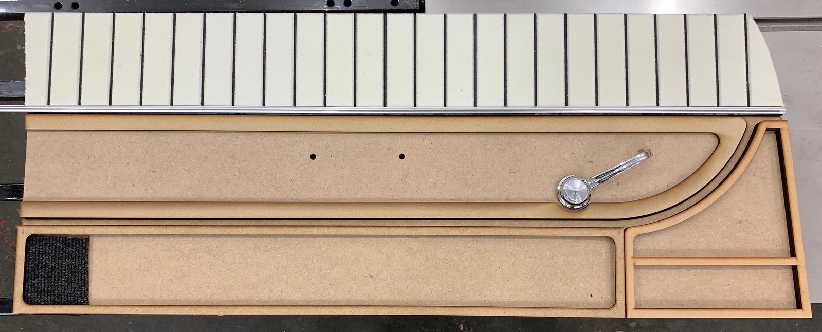

  14. Nova66mussl
    Nova66mussl Active Member
    Jan 8, 2019
    87
    64
    44
    East Wenatchee, WA
    Here is a pic of the door panel design.The lower right is the speaker grille.
    [​IMG]image1 by Patrick Brown, on Flickr
    OrthmannJ and ModelT1 like this.
