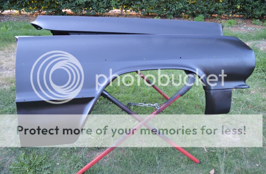

    Thanks Rev and Wagonmaster - plenty more detail to come. On to the left fender:
    This is original to the car and was in pristine condition until my wife's motorcycle fell forward off its stand and left this:
    The fix was to lay it flat on to the ground and using a bolster, pop it back out on the body line:
    I then lifted up the lows from the back side using a slapper and a heel dolly:
    As expected, dents mean stretched metal so I ended up with a high spot.
    Rather than resort to heat shrinking with an oxy torch, I tried out a stainless steel shrinking disk, spinning at 1800rpm on my buffer. Heat up the high spot with friction from the disk...
    ..and cool immediately with compressed air:
    Kept shrinking and caressing and checking with the body file.
    I got there in the end but I'm too slow to make a living out of it!
    From there I thought the panel was good-to-go however a closer look at the bottom corner showed some rust pinholes. After a bit of poking around I decided to open it up. I'm glad I did:
    Fortunately the inside brace and bolt hole were fine so just a outside patch needed:
    Fenders done!

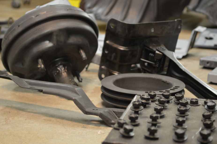

    Then it was back to prepping the engine bay parts that need to be semi-gloss black (not shiny brushed-on black!)
    The garage filled up pretty quickly with parts waiting for semi-gloss black:
    More parts ready including some seam sealer on the hood frame. (Grey parts are tie-coat over existing POR15, black is etch over bare metal)
