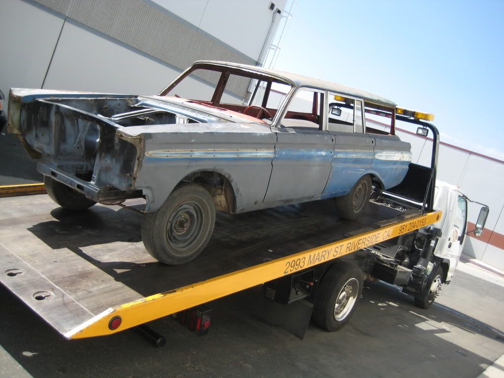

    I bought the car in the begining of July, a friend of mine was building a 1962 Falcon 2 door wagon (surf wagon) and it looked great. I started my hunt. I love the unique front end of the 64 Comet and I always wanted one. I fell into a 1965 Mustang Fastback so thats what i built first. My love for the 64 Comets never went away so I started looking for a Comet wagon.
    I found this wagon near Simi Valley, I paid 1000 dollars for her. She started and drove into the trailer..........I lied she made it too the trailer but not up the ramp. I drove her right to my buddys resto shop for her first evaluation.
    The car was born in Los Angeles and started here all her life. She was used for towing as there was a heavy duty hitch and a brake controller still in the car.

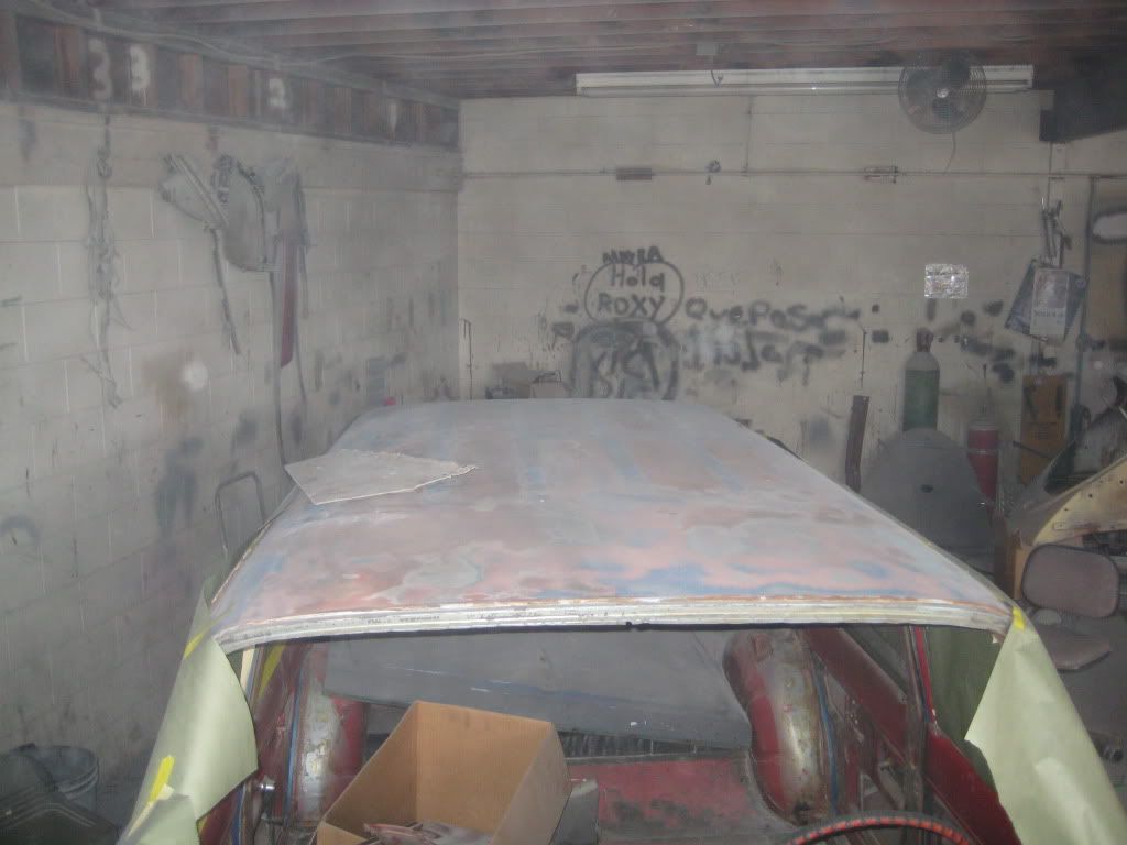

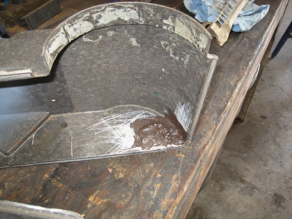

    When we got her up on the lift I took off the hitch and took a look around, the floor was solid as a rock, the roof...............that was a little different story

    It appears that the only bad section is the roof along the rain gutters from your pics....hopefully that rot hasn't extended into the inner structure....appears that you can cut out that section and carefully weld in a patch panel being careful to not warp the metal....I have a '65 falcon wagon and know full well about roof rot from my forum that I posted...good looking wagon considering age and should be a nice project to get back on the road

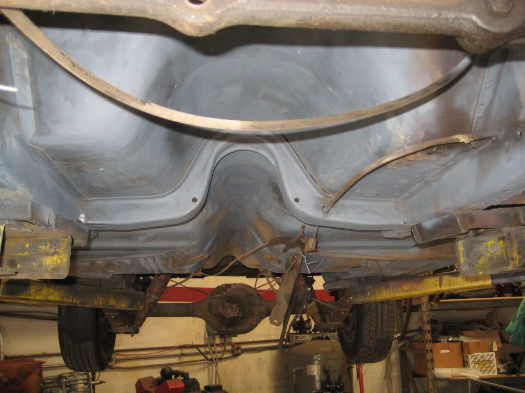

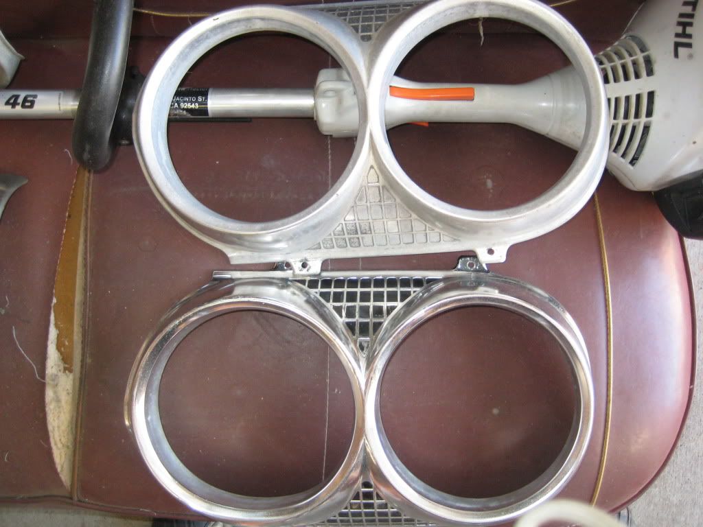

    When we started teh tear down, we did the outside first, stripped all the bumpers, all of the grill assembly, headlight buckets etc.
    We took out the front windshield, the front windows and vents, the tail gate interior skin and the 2 miles of trim on the outside of the wagon

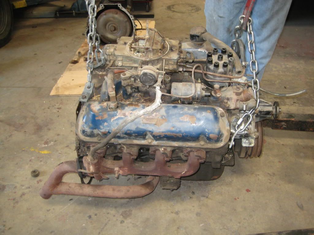

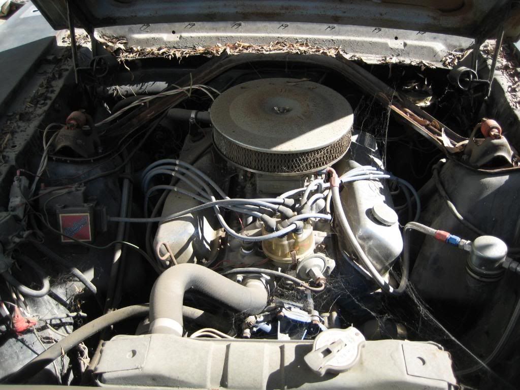

    WE then moved to taking the motor out........this is a Challenger V8 which is an early 289 with a 1.12 6100 4bbl Carb. This carb was taken from the 352 v8. This is a factory set up with a C4 trans, it was rated at 210 HP. By the way I just sold the motor and trans to a local mustang restorer.
    After the motor was out I started to clean the underside and the engine compartment, here is the way the engine bay looked after I pulled the motor
    And then after a turn with the wire wheel to both the engine bay and the underside, I had to prime a couple of spots that I went down to bare metal

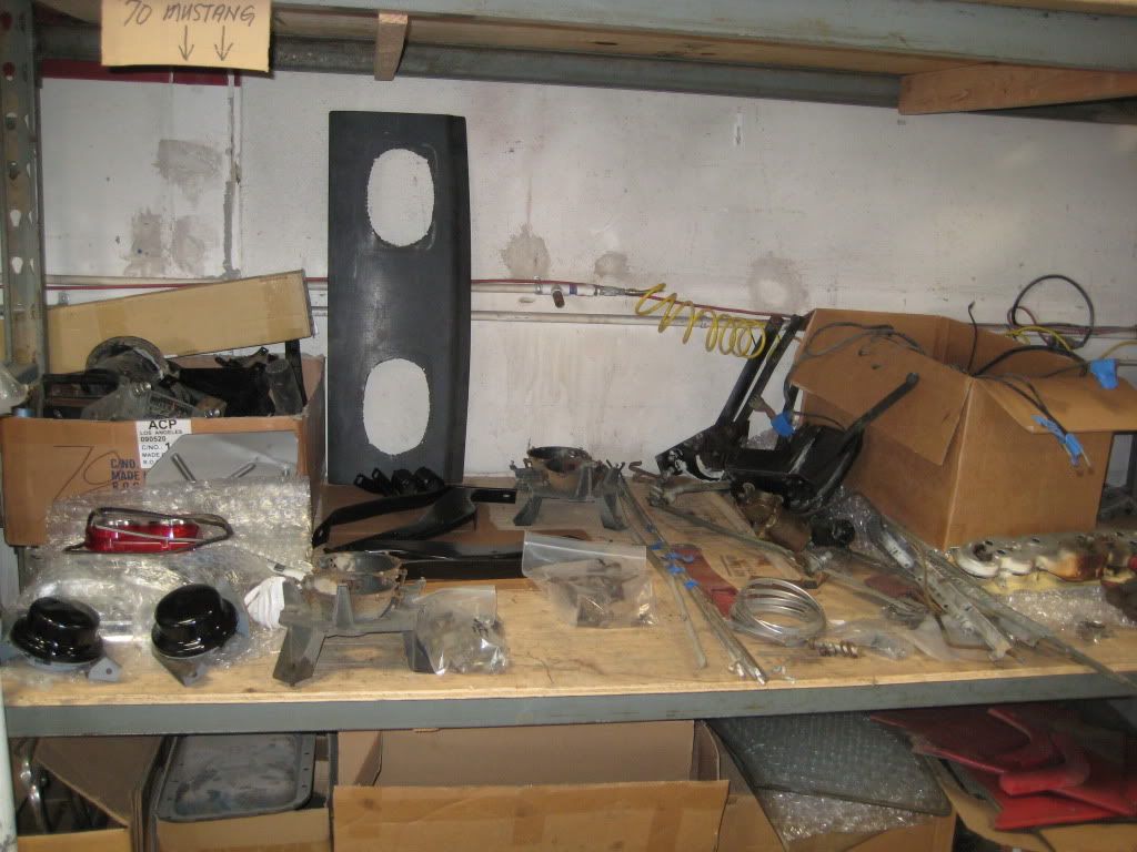

    I pretty much had all the exterior and interior stripped so I started to rehab all of the parts taken out, I have a full shelf of parts at my buddys shop, it is kind of overwhelming. It all has to be done so one day at a time.......besides the painter said he may have the wagon for up to 3 months, he is giving me a good price as he will do the car in between other jobs... Here she is heading to the body shop.

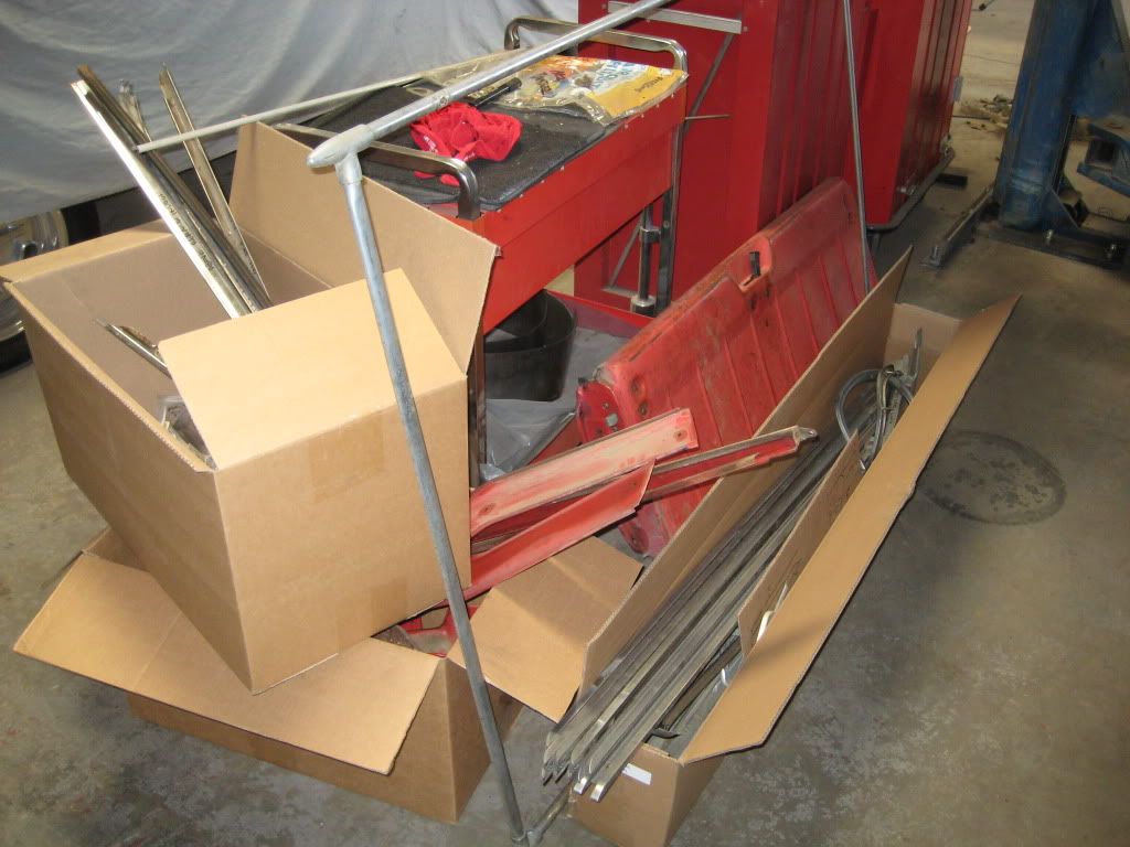

    And I began the hunt for parts needed for when the car is back and ready for reassembly. Some of the parts I needed was a passenger side tail lamp assembly, an "M" gas cap, as well as a piece of exterior trim here and there.
    After a good search I hit gold on Craigslist.
    Here is my early Christmas gifts arrived this week!

    The guy i bought the parts from would not separate them so I had to buy the gas cap, three tail lamp assemblies, 2 extra tail lamp lenses, and some tail gate trim that I really didn't need. So if anyone is looking for some wagon parts I have tail lamp lenses and all the tailgate trim, as well as 2 passenger side tail lamp assemblies. Back to the resto up date. As i mentioned I started with the heater box, It was cracked and super dirty, so I had to fiberglass the cracks and I sanded and painted the rusty interior doors and doghouse.

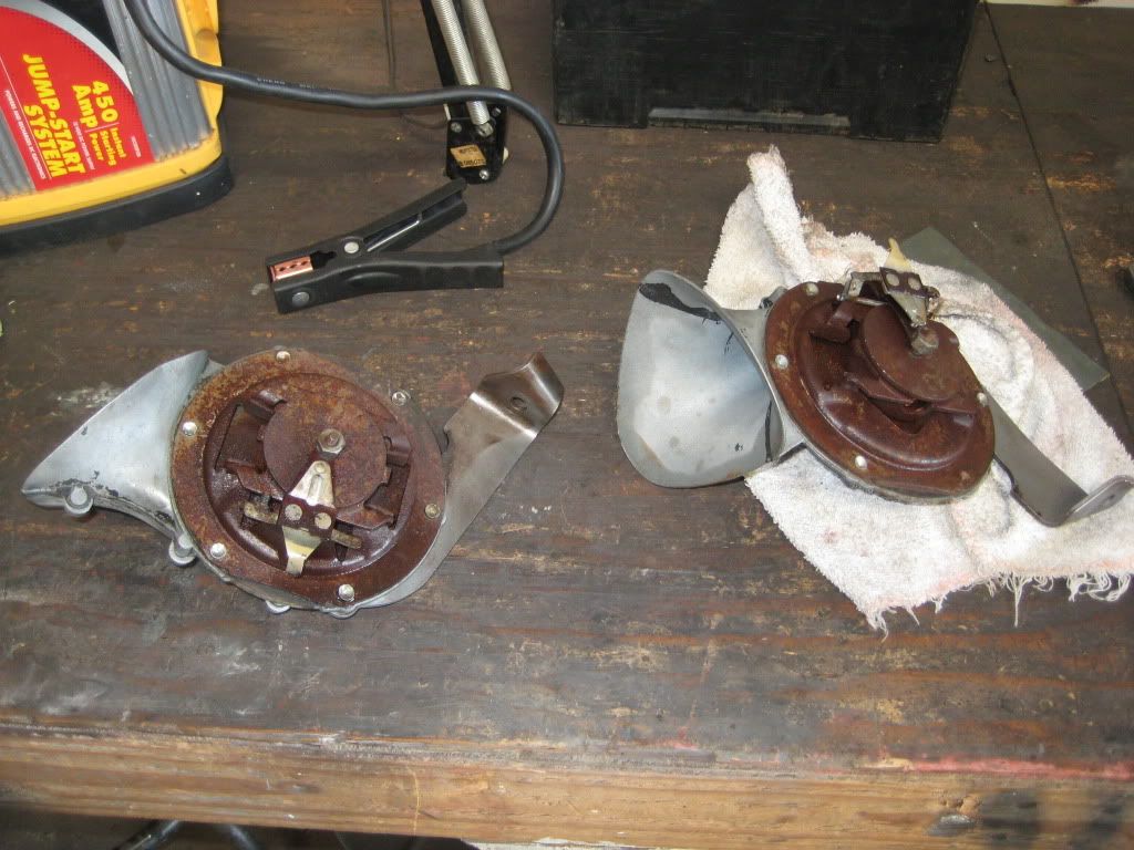

    I peeled off the cover and put 12 volts to them and.................nothing. I proceeded to soak them in WD-40 and took off the adjuster nut (didnt even know that existed). After a good soak tried again...nothing. One of the older guys at the shop came over and started to mess with the adjuster nut and then...............they worked. I put power to them a few times an hour to loosen up the rusted horn....but now they both work, I love the sound of the old high low horns, my son has them in his 62 Fairlane.

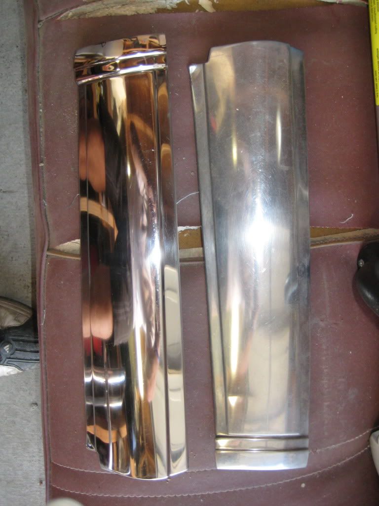

    I also broke down and bought a buffing wheel in order to polish some of the 2 miles of trim on the wagon at home. Here are soem before and after pics of the trim pieces, One polished one not, see if you can tell the difference
    This little baby took me an hour, I discover through the local paint shop that all the side trim is anodized, so i had to burn through the anodizing to get the piece to shine. I was told to de-anodize the piece first then polish. I will try that on the next few pieces

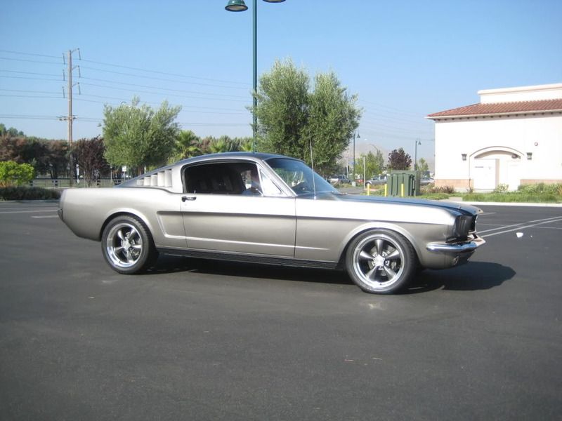

    As far as powertrain, I am taking the motor out of my mustang project, another 289 5 bolt, as well as the trans, C4 and transplanting it in the Comet. The mustang will get a new Ford Racing 306 Crate Motor (allready ordered) and a World Class 5 speed.
    Here is the donor car and a pic of the motor.
    Mustang
    motor
    And a fun picture of the mustang motor as I found it before the resto.

    I actually took off Thursday and worked on the Comet both Thurs and Friday, I became well acquainted with Mr Sand blaster and Mr Primer. And finally Mr. Duplicolor, here are some pics of the finished products from the last 2 days.
    I will also include some pics of my 2 friends projects being completed at my Buddy Bruce's shop.
    Here are some pics of the stuff I blasted and eventually painted.
    I would normally clear the heater box but it was cracked so bad I had to do bodywork to it, so I had to paint it flat black, it turned out pretty good

    A picture of some of my finished stuff as well as the stuff I still need to go through

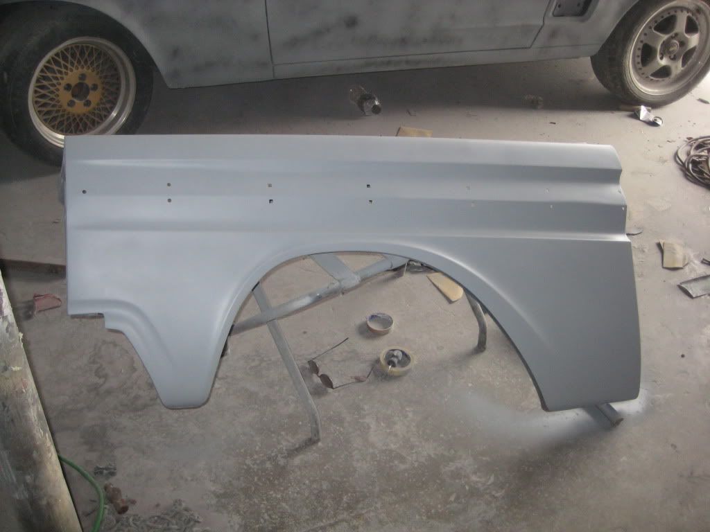

    I also went to visit "Kathy" at the body shop, not much done just started on the front fenders?

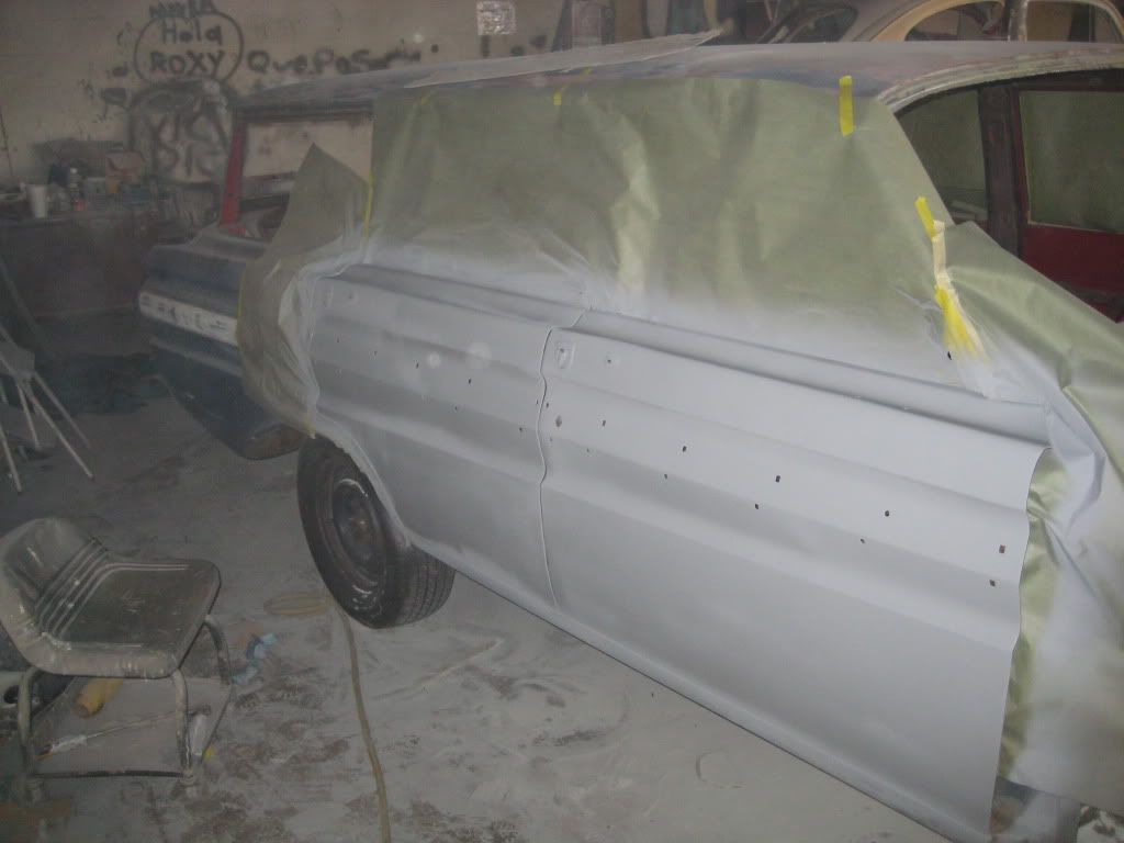

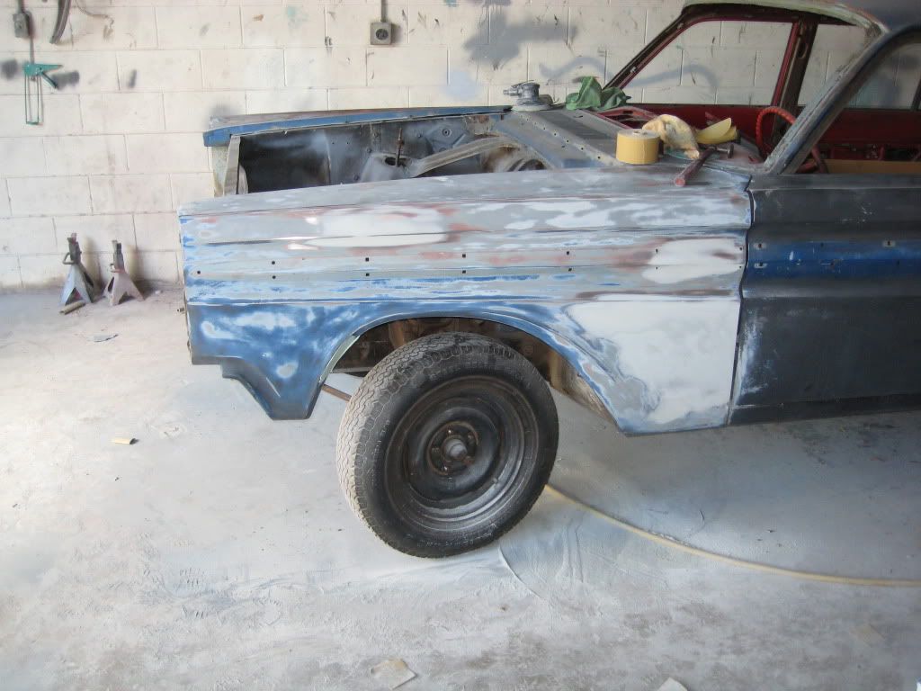

    Went by Body Shop today
    Some pics from body shop today, the owner works on all the panels, he wont do the metal repair, he is leaving that up to the youngsters. Here is what I saw today, getting excited.
