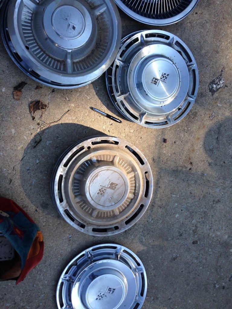

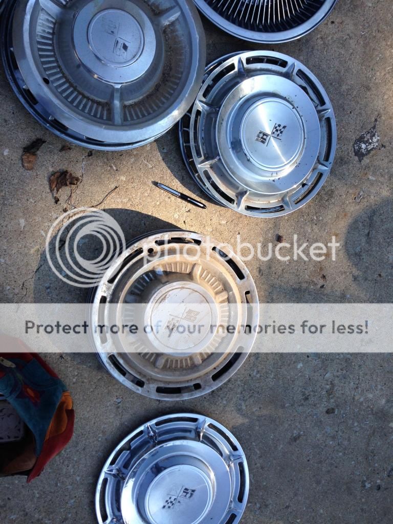

    Bought the hubcaps today. I THINK the dirty one in the middle is the correct one. Does anyone know? If not, I can trade these out.
    Hubcap shops are fun, aren't they?
    [​IMG][​IMG][​IMG][​IMG]
