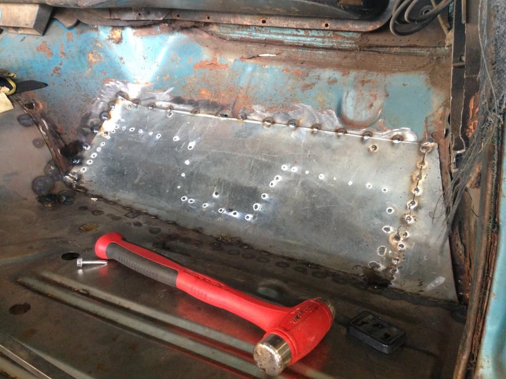

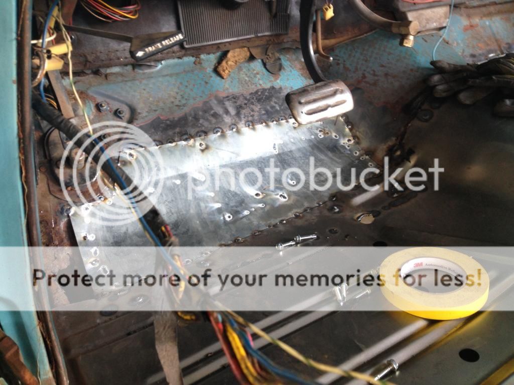

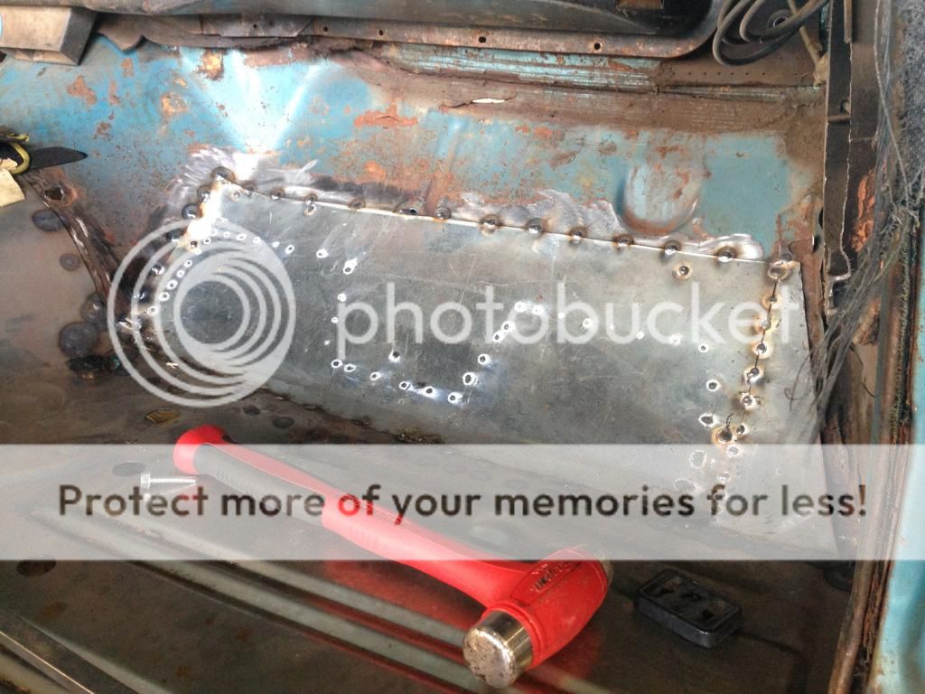

    Here are a few photos from this morning. The toe pans have been fabricated from sheet metal, are tacked in and will be welded in next. Here is the driver side:
    And passenger side:

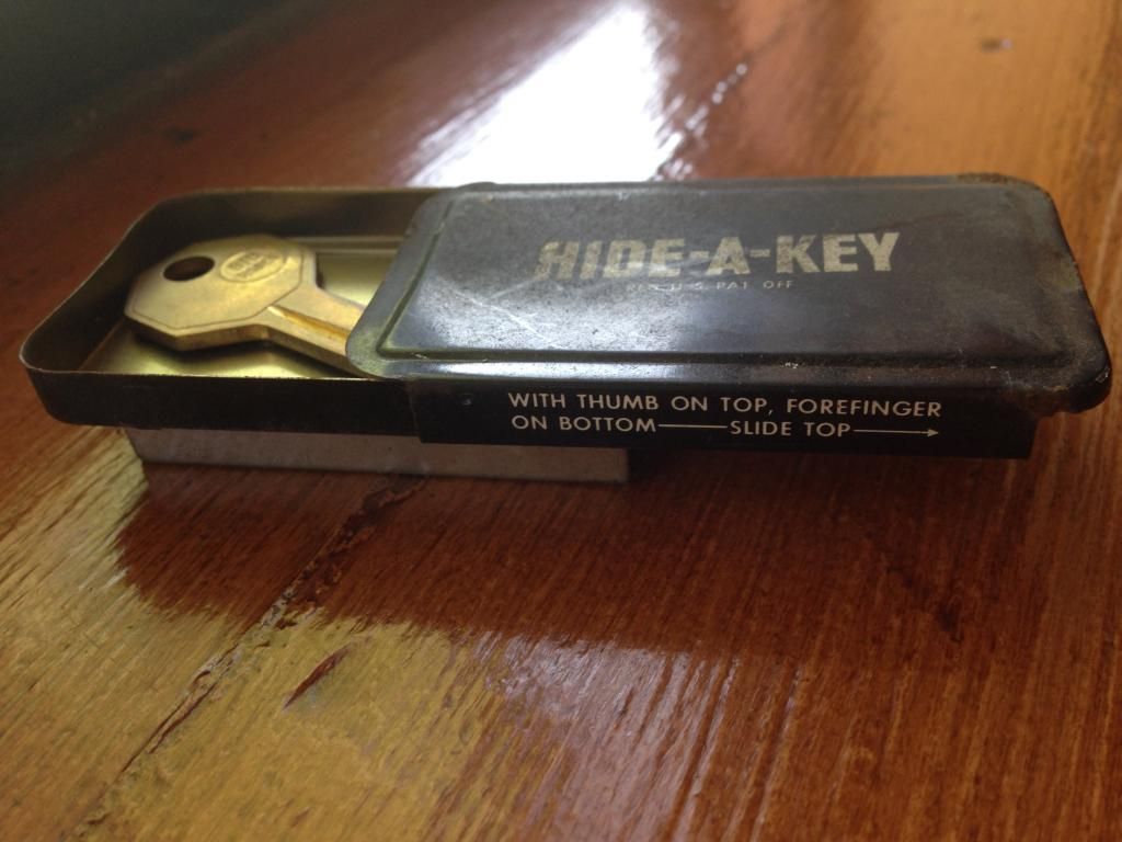

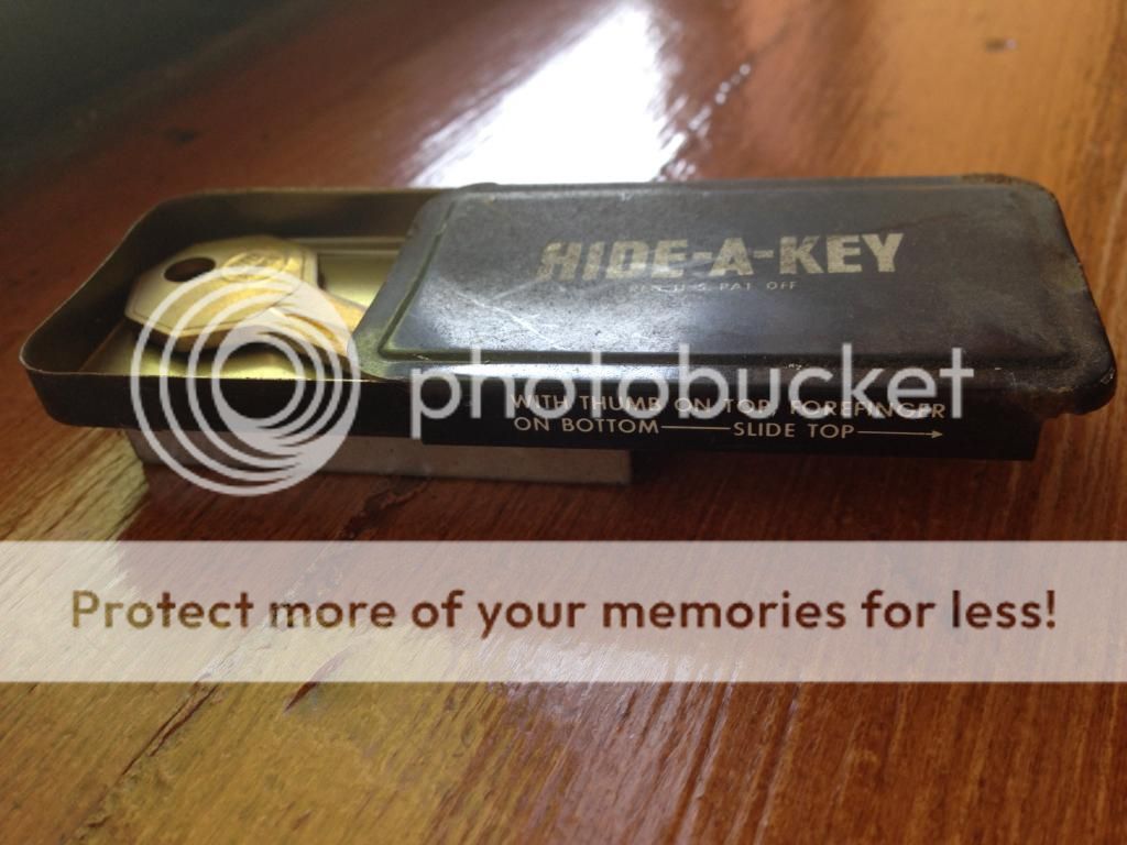

    Look what Rianna (shop owner) said the guys found this while taking things apart on the car. Wonder how long this had been stashed away?
