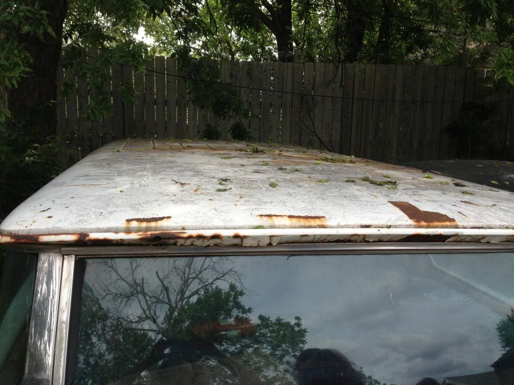

    The rust looked pretty bad...

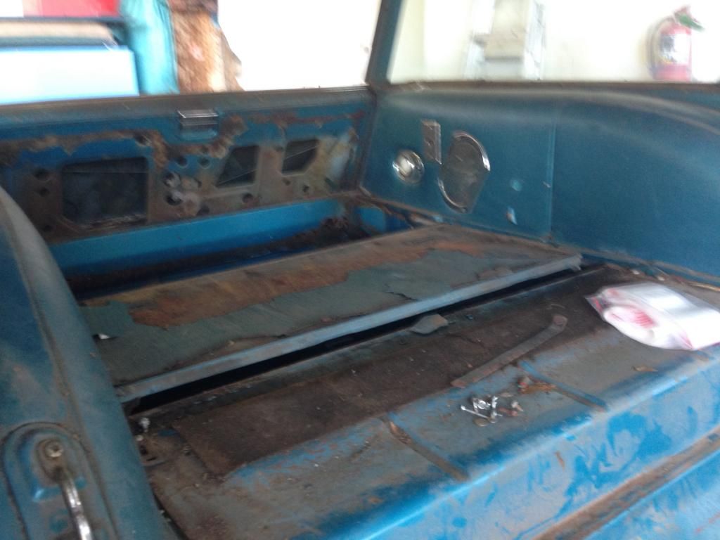

    And the interior was grim.

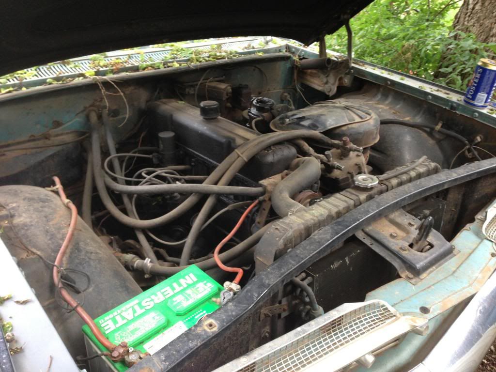

    And under the hood... the original Blue Flame straight six. I scraped a bit of gunk away with my fingernail and uncovered a bit of bright blue, the color the engine was painted.

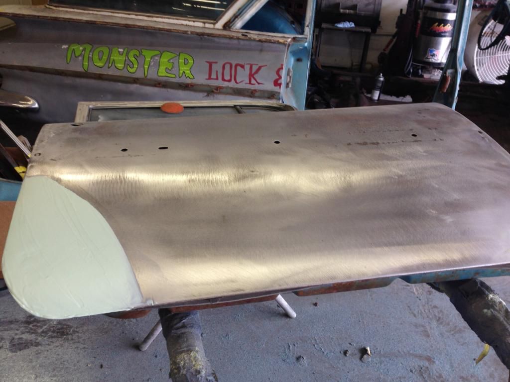

    After a couple of weeks, the crew had started removing trim, sorting through to see what could be salvaged and what would need to be replaced. Then, off came the doors, the seats, and the front fenders.
    This doesn't look good, but isn't really a surprise, either. New floor pan is on the way. The shop owner will fabricate some pans for other areas that had rusted through, like the wells behind the rear wheels in the cargo area.
    Happy news - the rocker panels were rusted through, but the doors were fine. New panels can be made - I wasn't able to find replacement panels in the correct size.

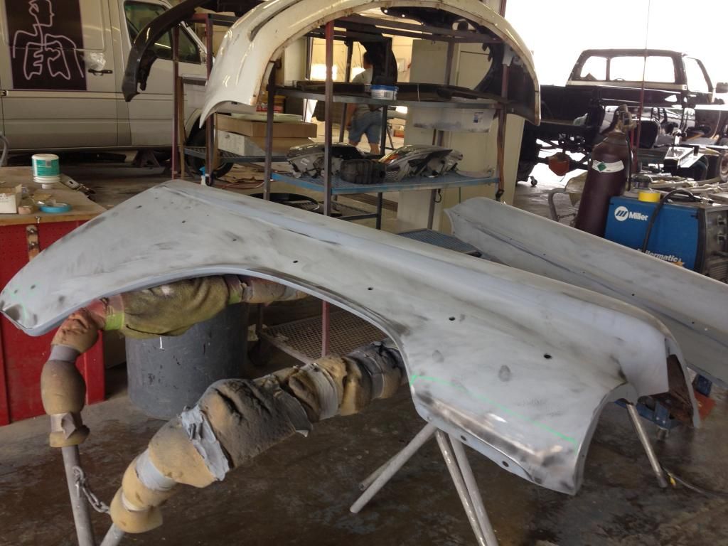

    Front fenders - going to bare metal....
    And getting their first coat of primer.
    Sanded and ready for another coat.

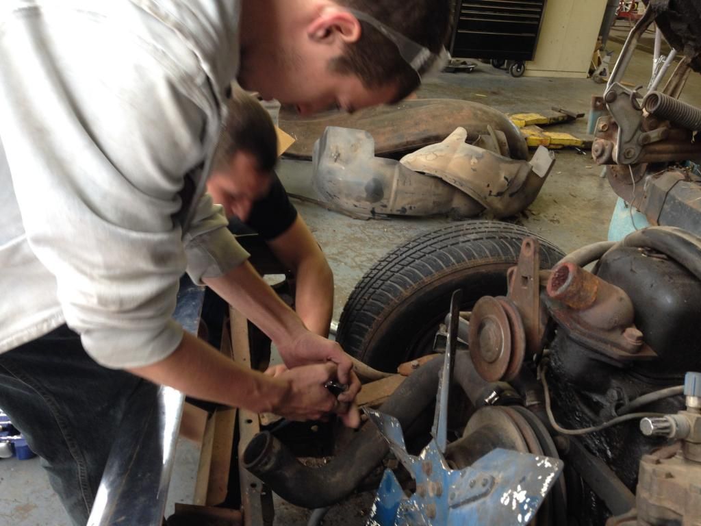

    The engine awaits assessment. The stuff that drained from the radiator doesn't look too good! At this point, we know it has problems. The guys suspect a cracked block but are going to have it looked at by an engine guy. I had hoped it could be saved, but if this is the case, I may consider a V8.
    The guys working to remove the bumper.

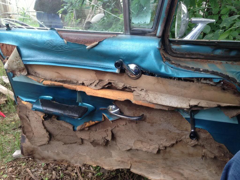

    It was fun to discover the original upholstery beneath the seat covers. I contacted a few places that specialize in classic car upholstery, and looked over their samples, but ony SMS Auto Fabrics in Oregon had the exact materials for the '59 Kingswood, even down to the jute-backed real linoleum for the cargo decking. So, the complete interior has been ordered from them.

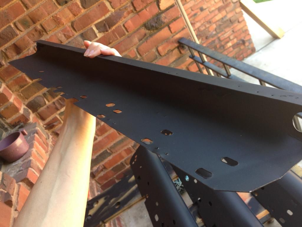

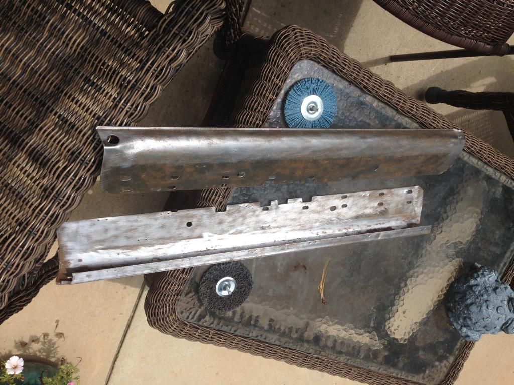

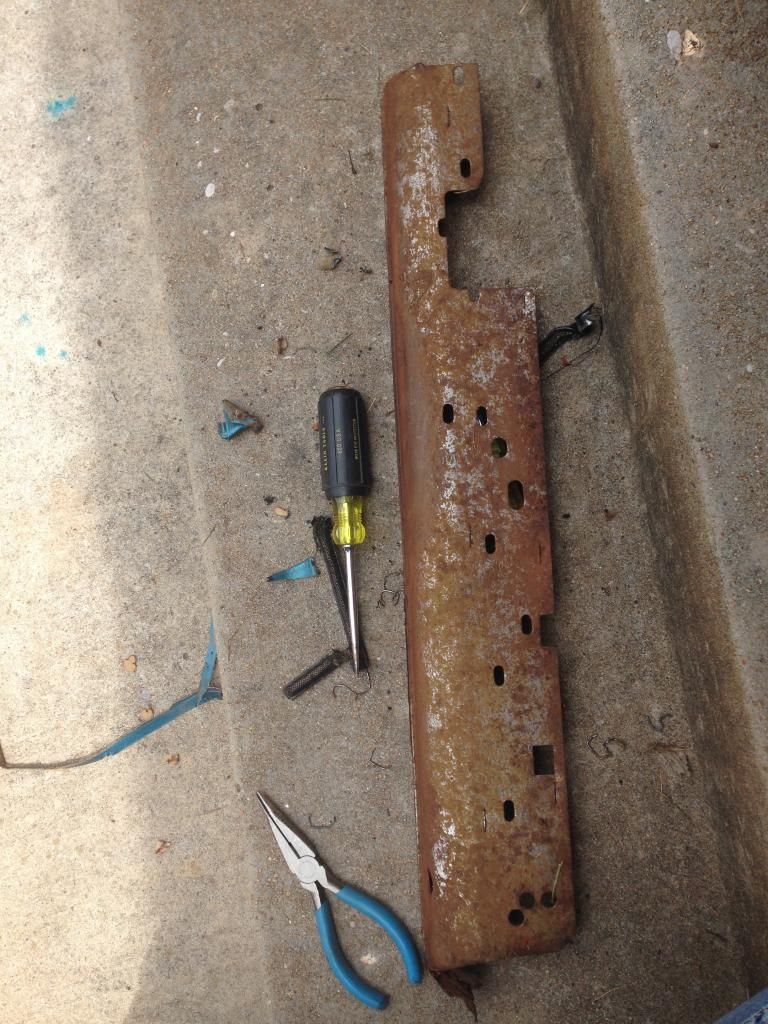

    I sent off the upper door panel rails to SMS Auto Fabrics yesterday - they need them to build ready-to-install panel sets. The old rails were rusty and covered in 55-year-old stuffing and thick, rusted staples. A chore prying them out. Then we cleaned them up, scrubbing off the gunk with Windex and a wire brush, and primered them with Rust-oleum.

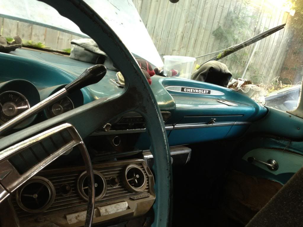

    From the pictures of your dashboard, it looks like it had ac; I assume it was aftermarket though I could be wrong. Anybody know if Chevy offered factory ac in '59?

    We were told the ac was aftermarket or dealer-installed. I don't know if the car was available with factory ac. We definitely want a good air conditioner, though. That's something else I'll need to learn about... not sure if the existing ac equipment can be used, or if we'd be much better off getting a newer, more efficient one.
