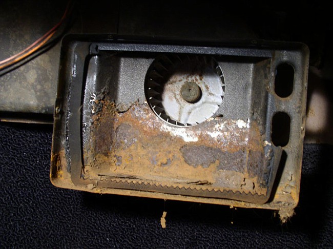

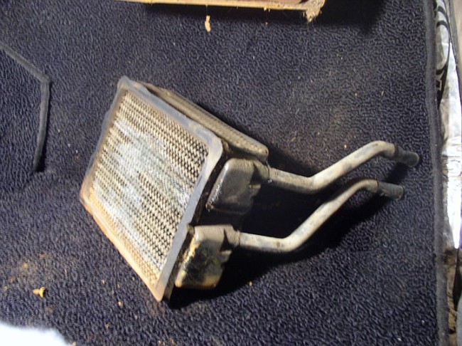

    Okay, before I buttoned'er all back up for the rain I pulled the heater core.
    Monday I plan to take it to a local radiator shop for a pressure test. Hope I don't have to replace it as it looks expensive.
    The inside of the housing has a strange looking water line suggesting that maybe the lower half of the car may have been underwater at one time. The face of the unit, this was a "recirculating" unit as opposed to a "fresh air" unit, has a great patina all over it and that won't be changed for the moment. But I don't mind fixing the core and having heat.

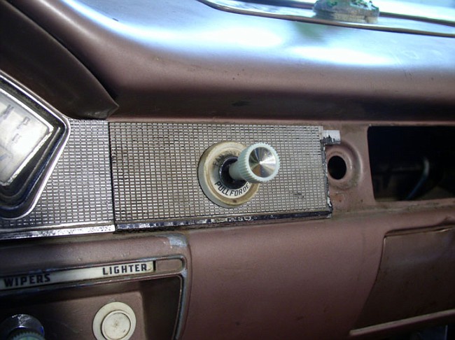

    Contols are nothing more than a two speed fan. Knob is pulled out to direct air to the now non-existent defogger vents.

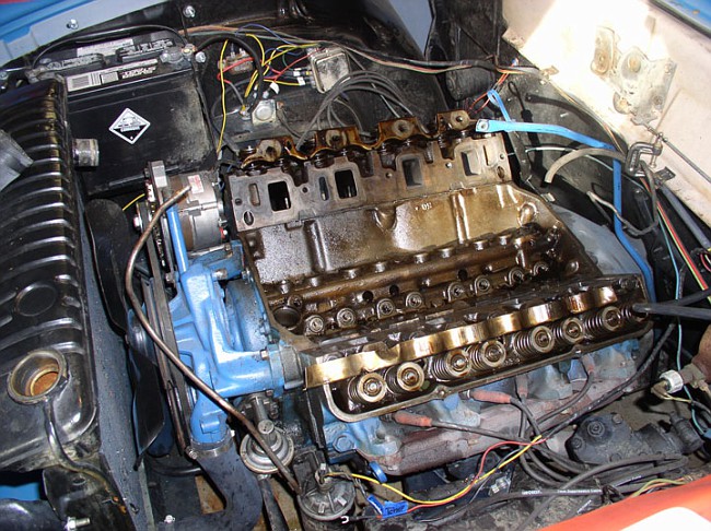

    Took the wagon out for a last spin with the old Motorcraft 2bbl carb. Hit Glen Volz at Salem Speed Shop up for a 1" aluminum spacer to give clearance for the carb linkage and to see how our T-shirts are selling.

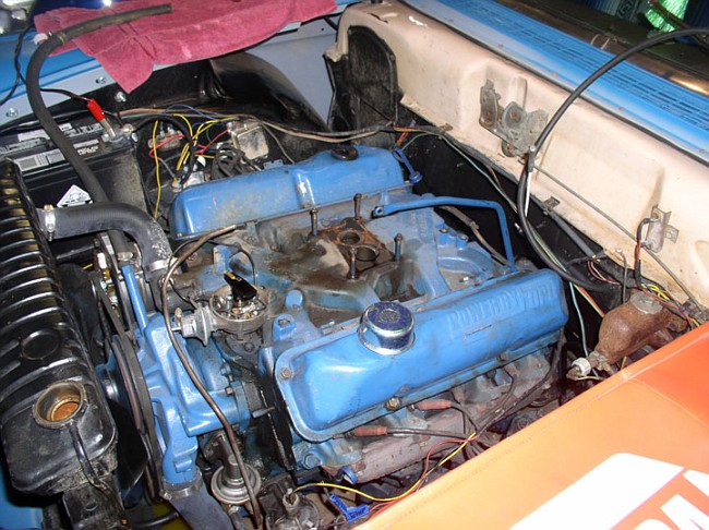

    After running a few errands I pulled the car into the garage and started pulling the engine apart...

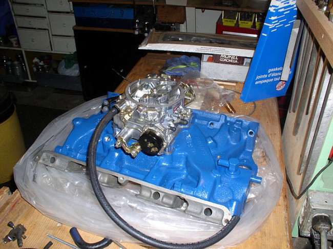

    The plan is to fit this 4bbl manifold with the attending Edelbrock Carburetor. Should be fun.... :dance:

    Wow, that ought to "wake up" that engine!

    Now that's a PLAN!:thumbs2:

    Salem Oregon
    Coffee break!
    Now comes the fun part...
    ...remembering where everything goes again.

    The giggling pin goes into the laughing shaft...;)

    Vacuum wipers: the old original engines frequently had combination fuel/vacuum pumps to provide more 'suck' for the wipers. They still weren't that good. If you do find a good electric replacement, let me know...the '57 Ford vacuum motor can be replaced with a GM electric unit but the '58 setup is different. Maybe a street rod place has something.
    I think your 'high water' mark in the heater core box may have been from a leaking heater core.
    It's been so long since I was up under the dash in my '58 - wasn't the defroster duct some molded cardboard piece? I seen to remember I had to reshape mine because it had gotten wet and sagged...if you haven't torn yours to bits you might be able to salvage it (or maybe find a salvagable one in an antique auto wrecking yard). I don't know of any available reproduction part.
