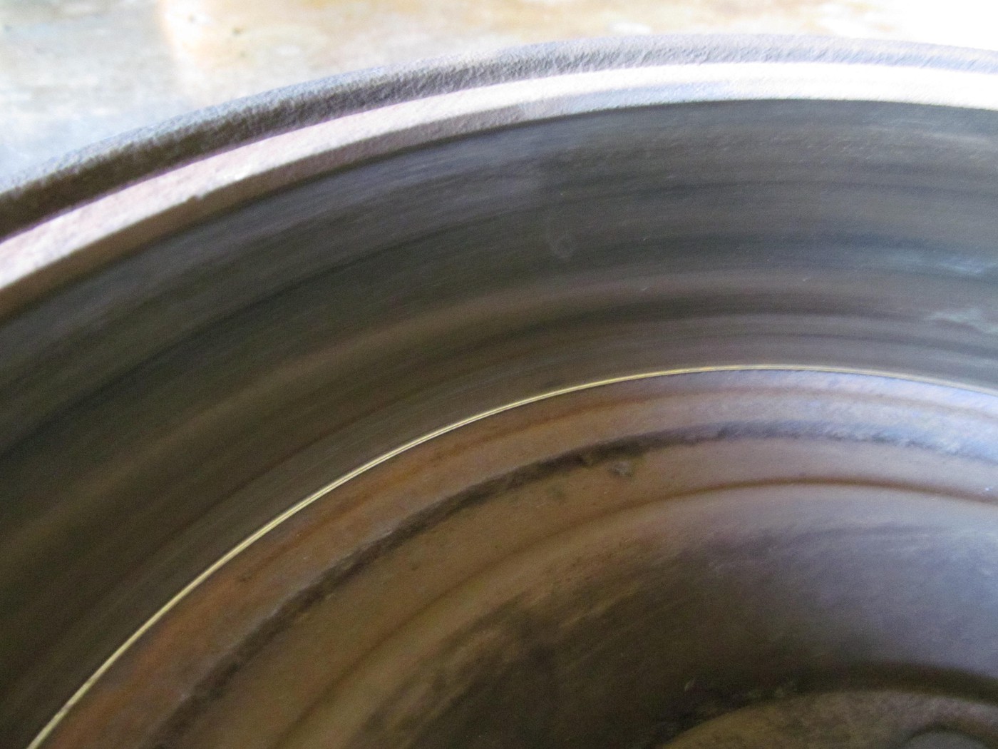

    Started last Monday, or was it Sunday? Anyway, I noticed a bit of brake fluid on the ground under the left front tire.
    CRAP!
    Doesn't end there.
    Pulled the hub off and... broken return spring!
    Plus the shoes were on backwards to boot. This is the drivers side and the shorter (primary) shoe is suppose to be in front.
    So.... new shoes were purchased about two years ago knowing it was getting close to time.
    Parts cleaned, drums were clean and smooth.
    Installed new shoes, new wheel cylinder, new return springs... ready to go.
    Or so you would think....
    Forensic evidence shows that the metal shoe is digging into the drum.
    Tried grinding with a die grinder and disc sander. That helped in straight line but turning the car resulted in a terrible grinding.
    Good news tho, the brakes work FANTASTIC.
    Here is an example of old shoe vs. new shoe. Clearly they are 1/8" wider than mine. The only other shoe Car Quest had was a 1/4" smaller than the old ones.
    So... Monday, in 97 degree weather, I removed all four shoes from the front and set about cutting them down by 1/8th inch.
    Some might ask... why not find a correct set?
    Well, I'm a guy and I have power tools.
    Band saw and grinder threw sparks for a few hours.
    But once I was done... the car drives like it never has before and brakes are super quiet and FANTASTIC!
