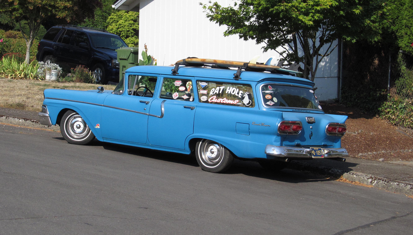

    Fotki is back up!
    Here is the wagon yesterday just before I changed the oil.
