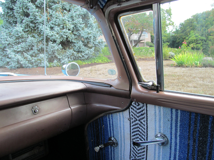

    Tuesday last I finally received the needed new window glass.
    Changed out the door glass, door felts and runs on the drivers door.
    The glass in that door had a couple major cracks in it and had begun de-laminating around the edges when I purchased the car two years ago. The felts were totally gone, rotted out years ago, and the glass panel rattled with each bump and when the door was closed. I used folded bits of paper jammed into the slot to keep my sanity for a long time. But the day I slammed the door too hard and totally shattered the panel... is when I set about collecting the bits to do both front doors.
    Process took about 10 hours to do (just one door) because some things just required a lot of experimentation to figure out retrofitting the new parts in the places of the old. But... the new glass rolls up/down smoothly and doesn't rattle when the door is closed!
    Still have to put in the down stop and re-attach the door panel this evening.
    I'll do a full step by step with photos very soon when I do the passenger door. Hopefully Monday (Labor Day) morning.
    Till then, I love having quiet glass and no cracks!:yahoo:
  14. Jairus
    Jairus Well-Known Member
    Jul 15, 2011
    1,292
    117
    145
    Salem Oregon
    Well, this is not the full up step by step I had planned on posting. Sorry.
    The second door didn't turn out any easier than the first... plus I had some retrofitting to do to get the felt strip attached to the newly painted interior frame. But.... both doors are now done!
    One of the tips I can share and the only step I took pictures of... was the clips that hold the back and upper sloted rail.
    The rail comes long and has to be cut down and bent. I used the glass to make the "L" bend and cut it to length to match the old one pulled out.
    But there are 5 pop in clips on the old one that needed to be removed. This clips hold the rail up in the door frame. They were factory tabbed to the old rail. Only way I could get them to attach to the new rail was to clear off the rubber molding and silver solder all 5 in place. The lower end (12" long channel on the back of the door couldn't be tabbed to the old rail so I used epoxy and let it set up for a couple hours.
    The one step of forming and tabbing took about 2 hours to complete and install for example.
    Not a project I want to do again. Think I'll live with the rear door glass... for a while.
    But the nicest thing I accomplished, besides clear window that roll up and down is the painted frames!
    I know its a small thing, but I've lived with the bare metal/slowly rusting frames for TWO YEARS now! Like the center pillar and the rear door frame for example. Those I might pull and paint during the next few weeks since thats not hard to do and we have no shows coming up.
    Note the Bali Bronze doesn't quite match the dash? The paint shop mixed it up from formulas as a replacement since the old paint is no longer available.
    This will necessitate my painting the dash eventually. But... it's pretty faded on top anyway.
    For now... the "Surf Rat" lives with fewer rattles! :yippee:
