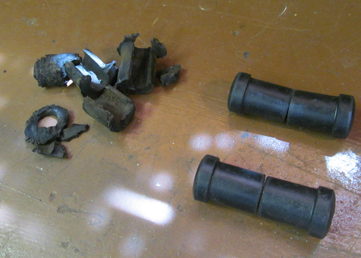

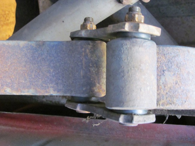

    Fourth fix, while the left side was up in the air was to replace the rear axle shakle bushings which were making thumping noises around turns and were pretty much wore out.
    Anyone can clearly see the 55 year old bushings just couldn't last another 10 minutes.
    Now THAT is a beautiful sight!!!!!:2_thumbs_up_-_anima

  7. Hanswurst von Plumpskloh
